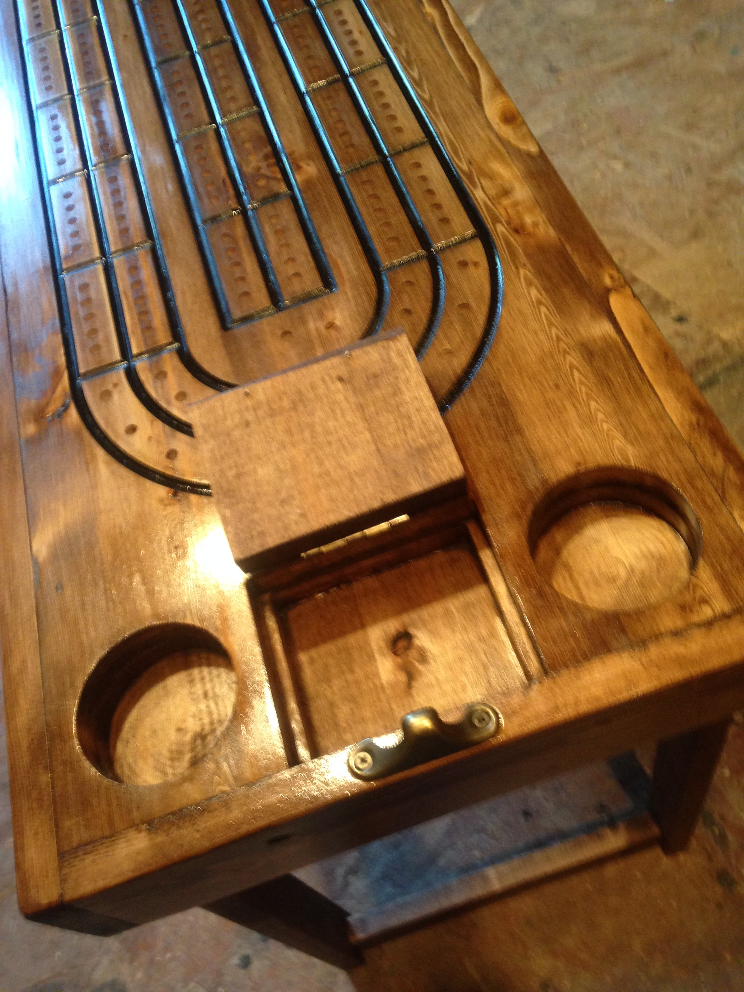

Man…I love this thing. Spit this crib board out in 32 mins. 31.75" length of tracks of tracks (total board 42.5"); .25" holes @ .50" depth. All with fusion 360. Tracks done with 3/8 core box bit on a traces tool path @ .0625 depth…FR 40"/min. holes done with deep drilling full retract pecking tool path @ 0.125"/peck.
I see many Cribbage boards in my future. That looks nice.
Thanks; will post the finished project; have drink holders, place to store a deck of cards and pegs yet, and folding legs.

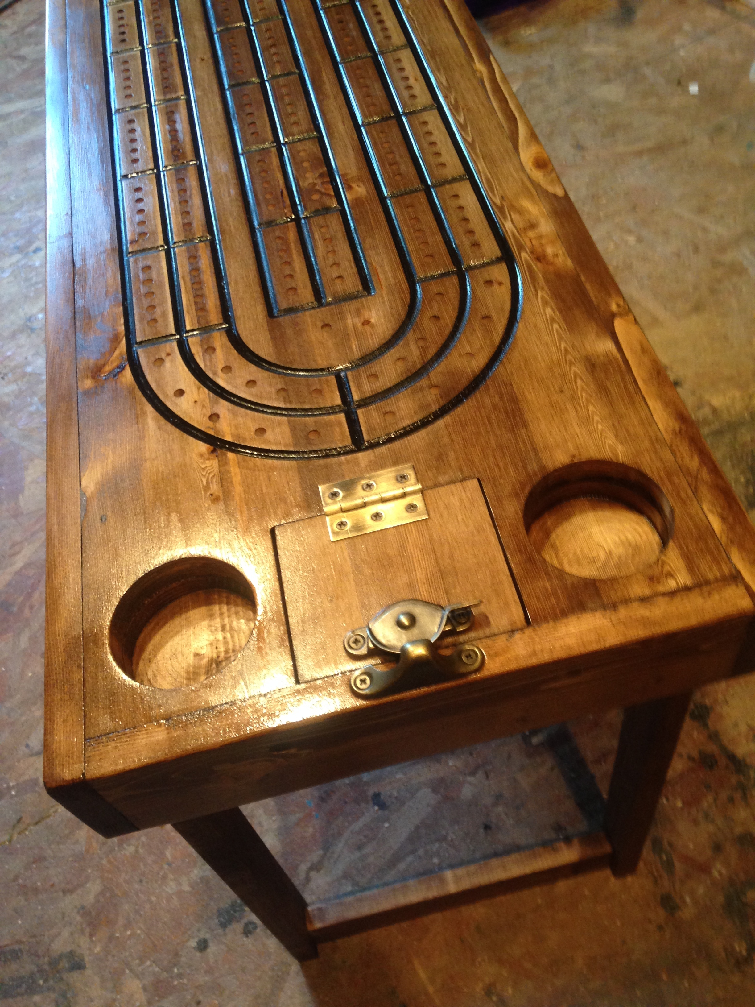

Finished project; milled in some drink holders, place for cards/pegs, and some folding legs.
