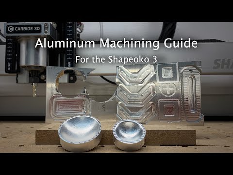

Winstons videos are a really good starting point for speed and feeds, but depending on which machine you have, you may be able to go a bit faster.
