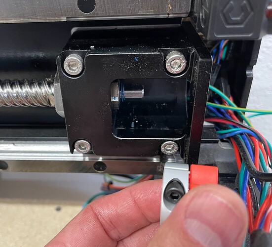

Later, when I started up my machine, it wouldn’t initialize. I don’t remember the exact error but basically it wasn’t clearing a limit switch. I turned off the machine, manually moved the gantry to clear all limit switches, then turned it on and checked all switches with a piece of metal. They all lit up fine. In the diagnostics menu, they also showed the correct status when testing. I figured out it was the X limit switch that needed clearing and noticed a jerk when the X axis was changing directions. Turning the machine off again, I manually moved the gantry on the X axis and noticed it had sloppy play when changing directions. The shaft was loose and the motor would turn for a bit before the shaft engaged, causing it to not fully clear the limit switch when initializing.
I figured out it was the ball screw shaft but it took me awhile to figure out exactly which thing needed tightening. Here’s how you do it:
Remove the X axis stepper motor and coupler, which requires loosening both the collar screw and a set screw. Once the motor and coupler are removed you can access the shaft bolt:
Once those are off, you can tighten the shaft bolt using a 16mm (I think) socket with an extender. You should have a tool that came with your machine that prevents the shaft from turning when you tighten it:
Reinstall the the coupler (tightening both the collar and set screws), the motor, and make sure all screws are nice and tight and you should be good to go!
