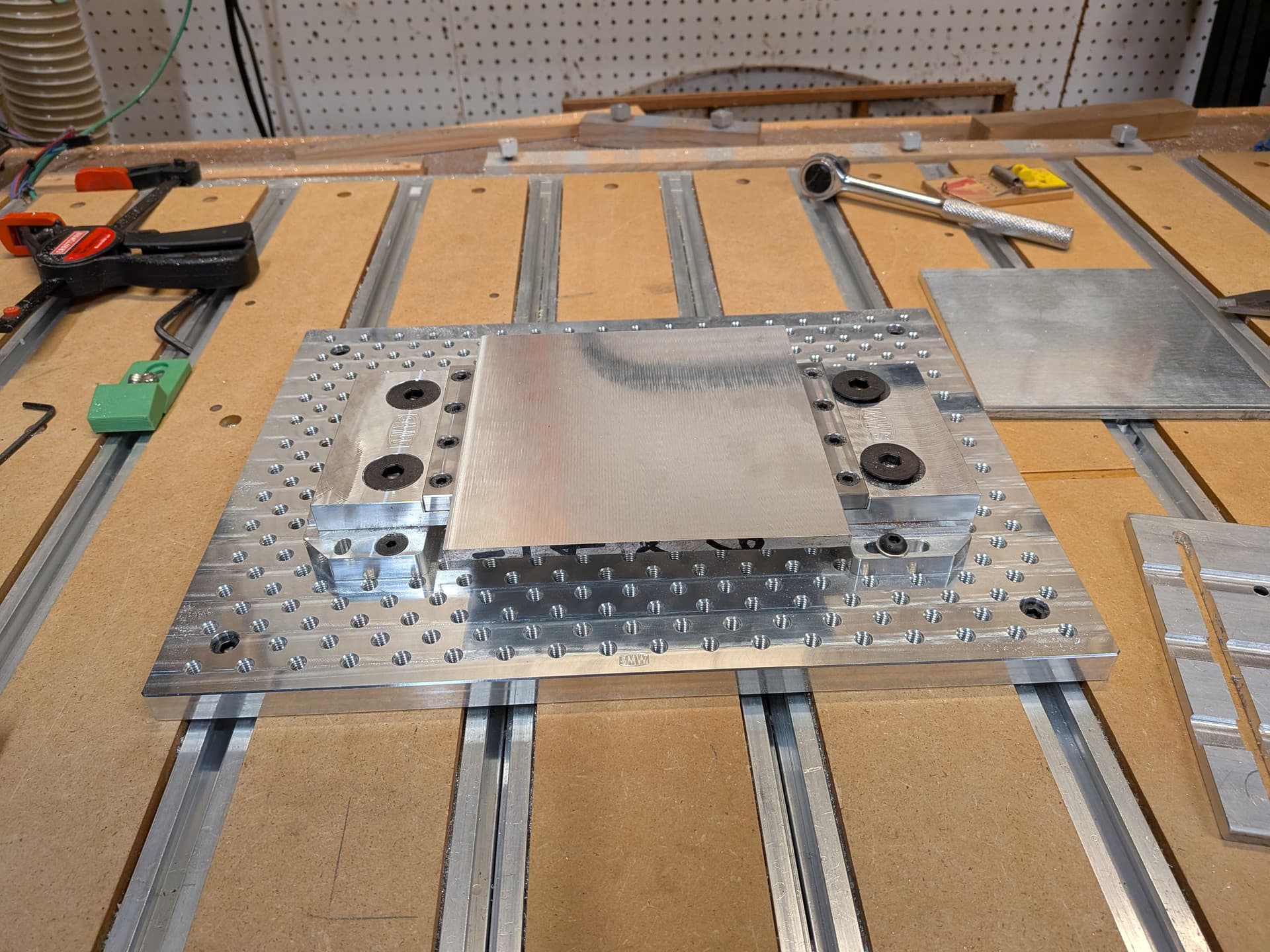

I did splurge and get a custom SMW fixture plate and Gen 3 hobby vise. Yep, I like it.
The OEM setup is to cut the MDF and mount to the top of the tracks.
I went with mounting onto the MDF ( after surfacing the whole table ).
I had to get longer SHCS then what SMC sent.
I will take a little possible slop in the tolerance for flexibility of a full clean surface.
I would assume you would have to face the tracks anyway to true up the mounting.
That’s metal :metal:

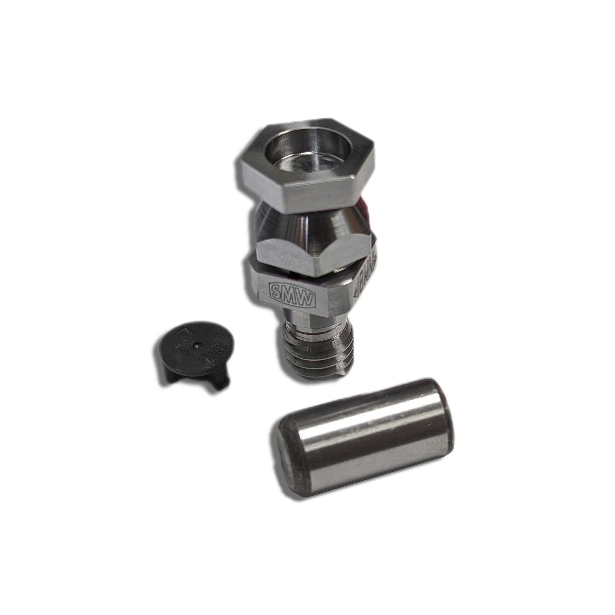

Now you just need some nice low profile machinist jacks to put under those long spans. The SMW ones are really clever but we’re still missing the M6 variants :smiling_face_with_tear:
Maybe that would be a decent entry into @Tod1d community challenge :thinking:
What is a machinist jack ?
Funny you mentioned that . I was drilling holes ( pecking ) and noticed a bit of deflection.
Thanks for the education and new search term !
Oh yeah. That looks interesting for a few reasons. M6 version looks for be available.
I can’t believe they didn’t send some kind of newsletter out for them. I’ve been waiting forever for :melting_face:
The cost is a bit much but given the quality and general usefulness of the rest of their system, I’m going to bite the bullet and order a couple.
I’ll let folks know how they work out.
Yeah machinist jacks are useful little things. It’s surprising how much flex you can get out of a relatively short span of unsupported aluminum.
Especially if it’s something like 1/8” stock :grimacing:
I am listening to the plate vibrate right now cutting a .270 slot with a 1/4 278 bit.
