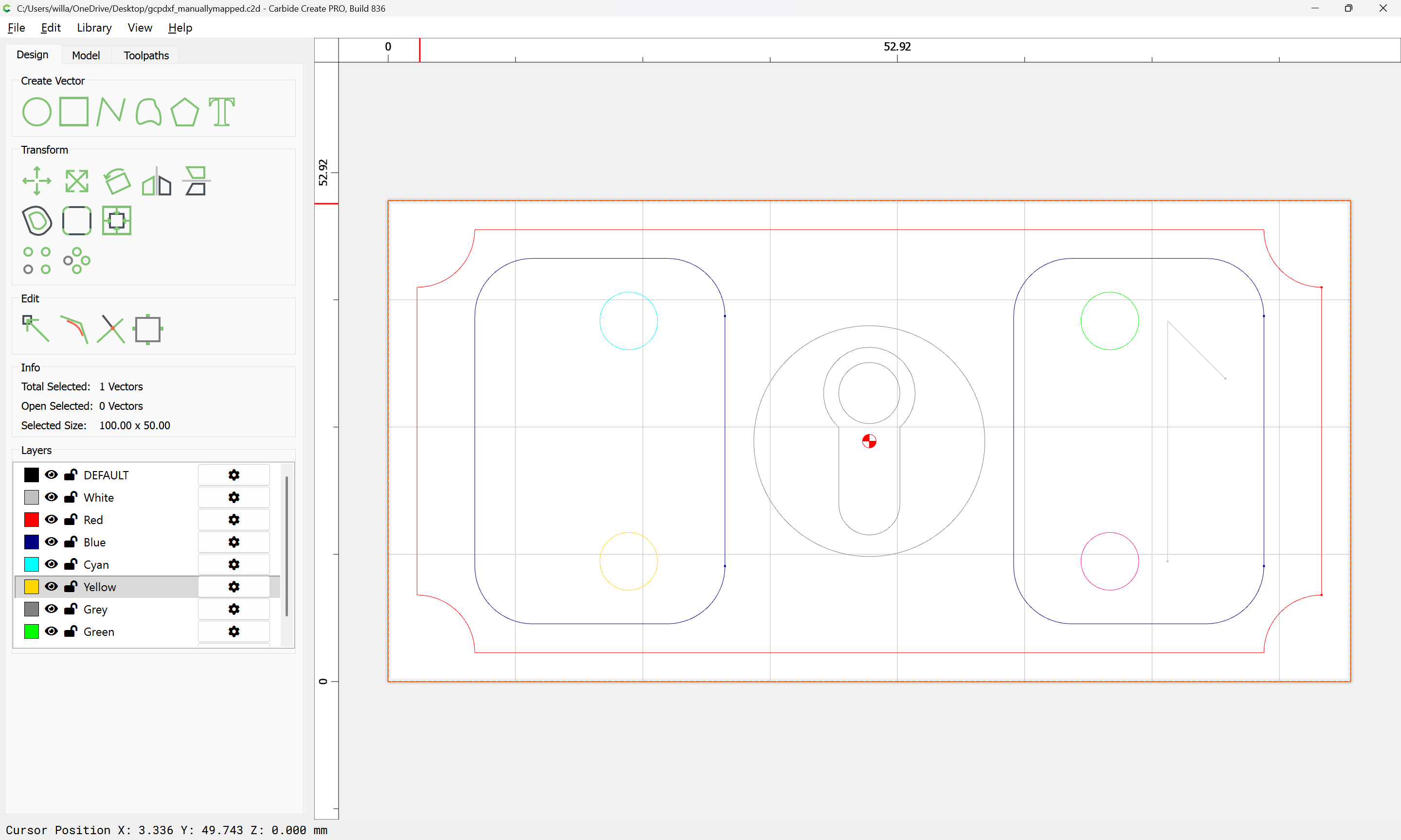

Flattening first then vcarve in same program
I’ve found this discussion back in 2021 and wonder if things have advanced since then. Continuing the discussion from Start depth after a flattening job?:

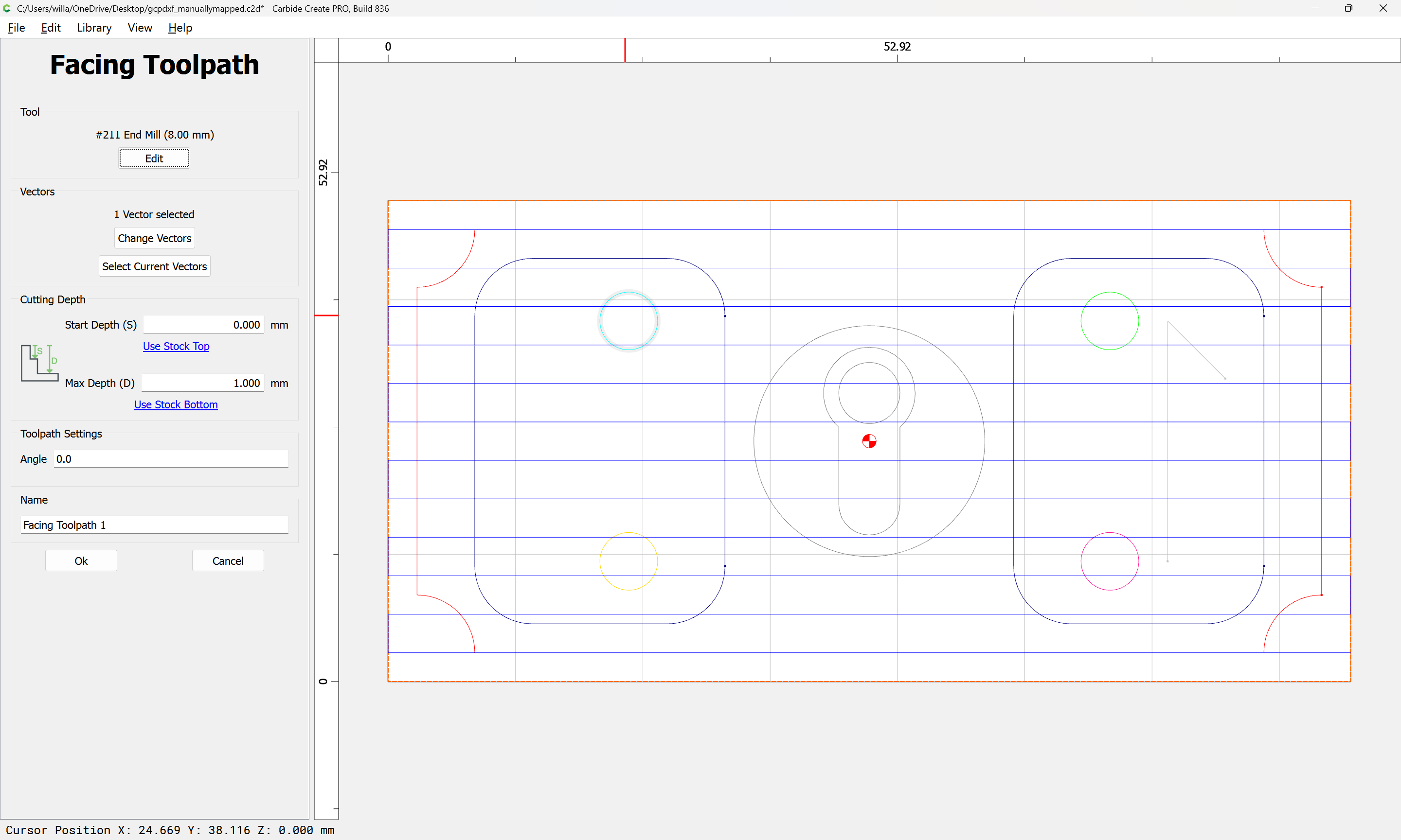

I’m hoping to create a single program file to first flatten a surface then start the vcarve. Currently, I use two separate program files. We should be able to seamlessly go into the machining the vcarve once the flattening tool path is complete. I’m pretty sure [the paid version of] fusion can do it. I’m using the Pro version of CC.
Thanks!

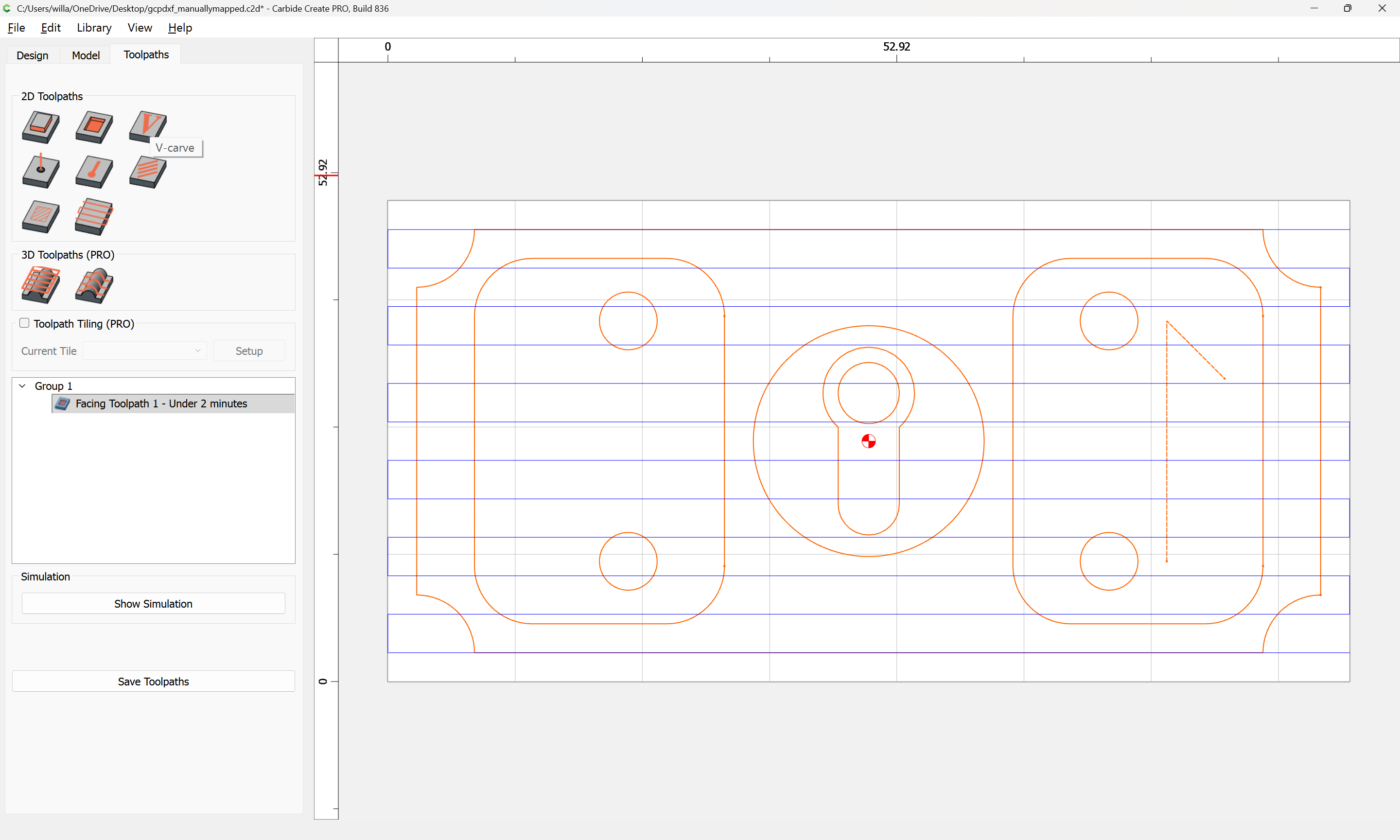

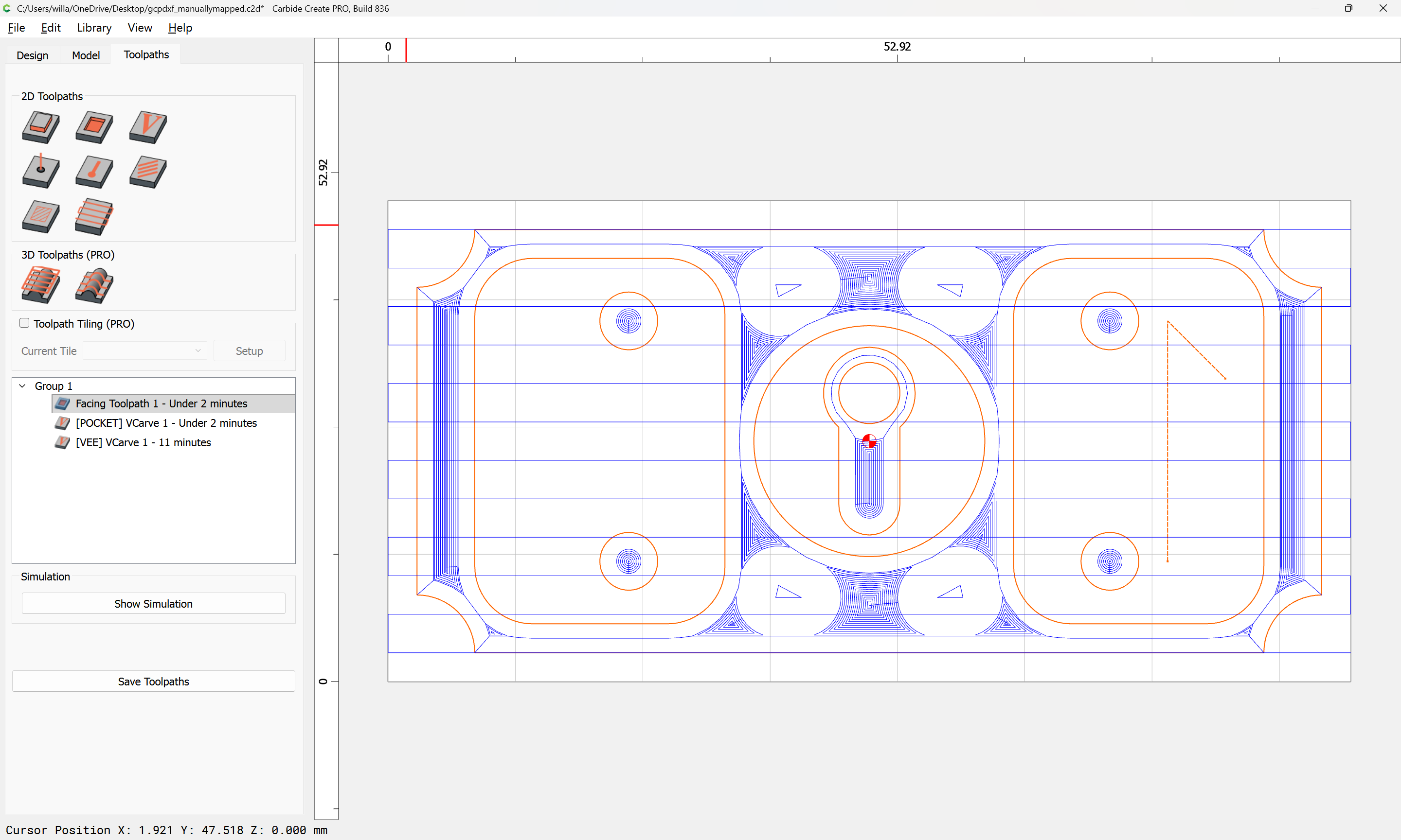

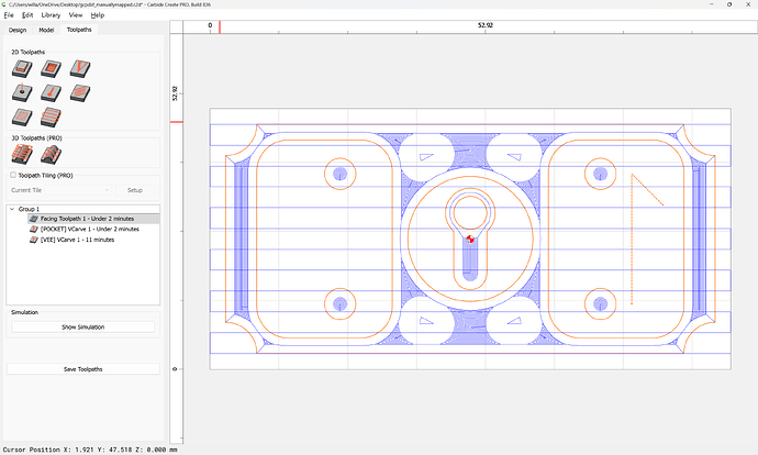

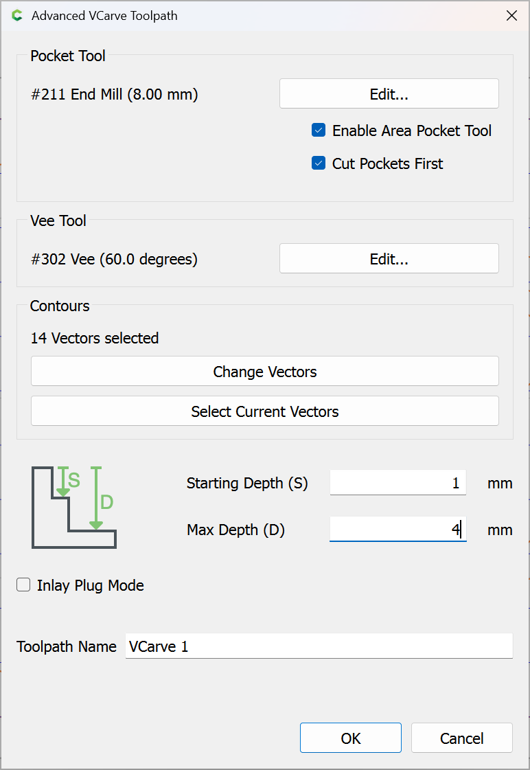

Yes, this can be done — just put the V carve operation at the bottom of the flattening operation, so:
So, if I’m flattening by 0.050" and my vcarve depth is 0.25" then my starting depth for my vcarve is 0.050" and max depth 0.30". Makes sense. Thanks.

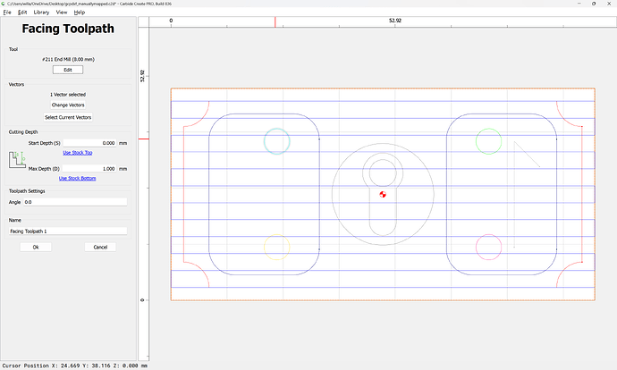

It should be the same as for any other V carve — just start at the depth of the flattening operation and add that depth to the Max Depth.
Will,
So, my max depth of the facing tool path will be 0.000 but my z zero will include the facing cut depth. Then the vcarve tool path will start at 0.000. Is my understanding correct?
Thanks
If you can assign a toolpath at that depth, then yes, that should work.
