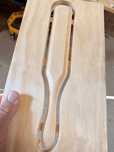

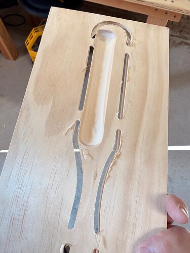

Well I/m back again with a failure. I’ve been trying to figure out a flip method that works best for me. Ive seen most of the videos but wanted to try what I thought was a “simple” approach.
For the top side of the spoon, the “bowl”, I set the tool path zero to bottom left and using Biot setter set X,Y and Z to bottom left. This carve went great.
For the bottom side of the spoon I flipped the stock so bottom left of stock is now top left iand I set the tool path zero to be top left. I then rest X,Y and Z using bit setter in the top left corner.
Well that seemed logical to me but didn’t work. See pictures below. Can someone please explain to me why this method doesn’t work??? I know there are other methods but this seemed like it should work. What did I do wrong?

Thanks Tod. I have an L corner bracket to make sure the stock once flipped is in the same exact corner. The vectors are perfectly centered in CC. I carve the first side after setting x,y and z in bottom left corner. I then flip the stock vertically, reset x,y and z to bottom left corner again then carve. I created this simple example and I just can’t get it. Here are a few pictures of what I’m doing.
An L corner will only register once against a given corner and will only work if the stock is measured perfectly and positioned exactly for both sides.
So even if the stock is exactly 8” x 14” and the design is perfectly centered (middle of design is at 4”) and the stock is snug in the L bracket, this won’t work?
If the dimensions are exact, and the manipulation is precise then yes it will work.

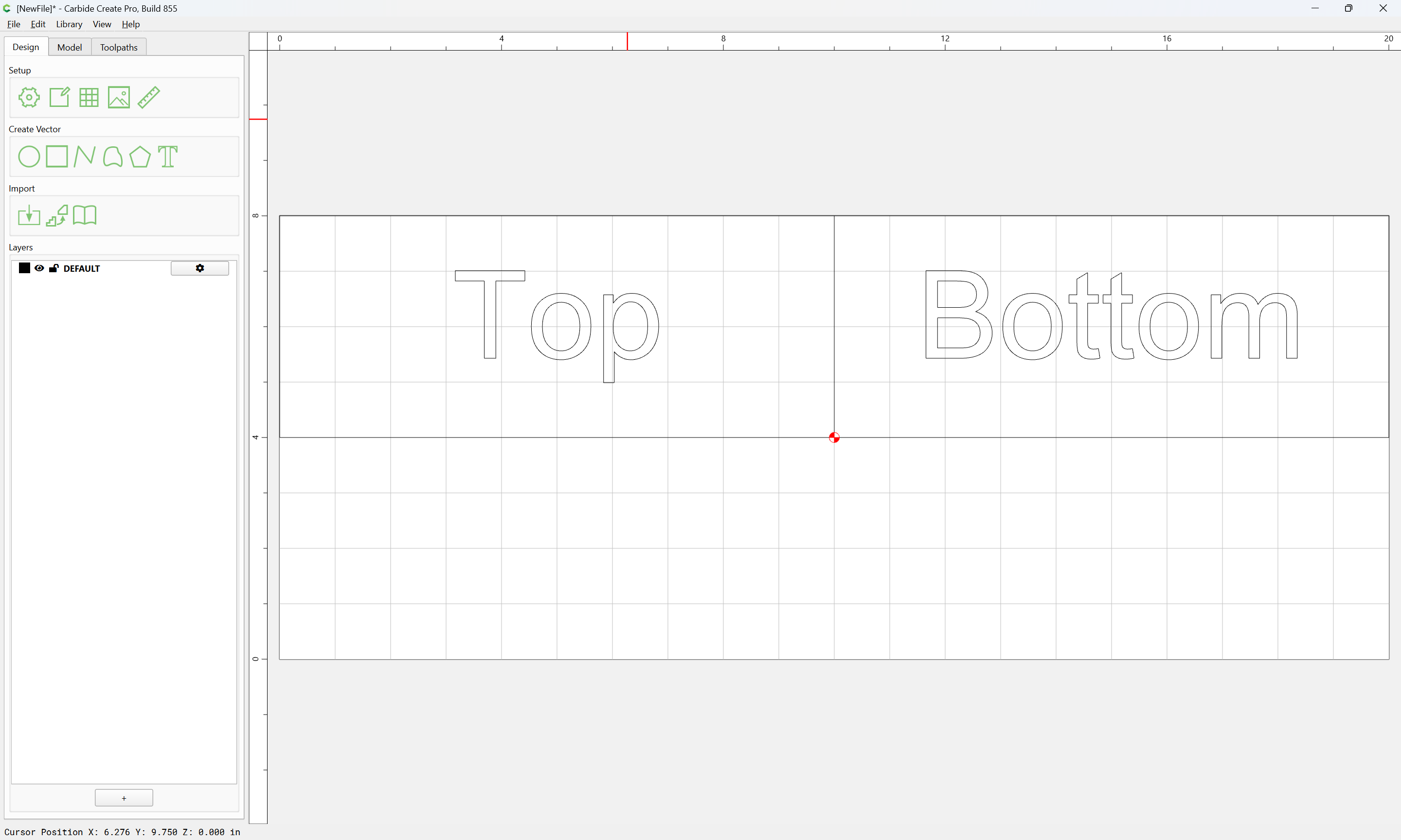

Maybe instead use Lower left and then Lower Right by using Center?
Something like:
Cut the bottom first using the jig, then rotate the part, then jog over by the actual width of the stock and re-set the X-axis zero.

Purely from an observational (and trouble shooting) standpoint…
Just using a ruler, which of the two cuts is NOT centered. That will likely help indicate where your problem is. (From the photos, hard to tell but it kinda looks like the first cut might be centered and the second is offset. If that’s the case, then the setup (zero) or design of the second cut is likely where the problem is.
However, if BOTH cuts are off center (and in opposite directions) then your issue is more “global”. Like the measurement of the stock, setting of the stock width, or the zeroing operation itself…
@evanevery First of all, thanks for responding. The first carve, recess, is perfectly centered. The contour profile cut is off. Both are centered in CC.
I’m a carpenter by trade and I’m used to judging spacing, etc. so with that being said it does not look centered on the stock. It could be the parallax effect but it seems a bit off.
Thanks @shawnoel for the response. As far as I can tell it’s centered at 4" on the Y axis and 7" along the X axis. This is within Carbide Create Pro. The stock is 8"x14" so that looks right. The first side carved is perfectly centered on the actual stock but the flipped/second side is way off centered.
