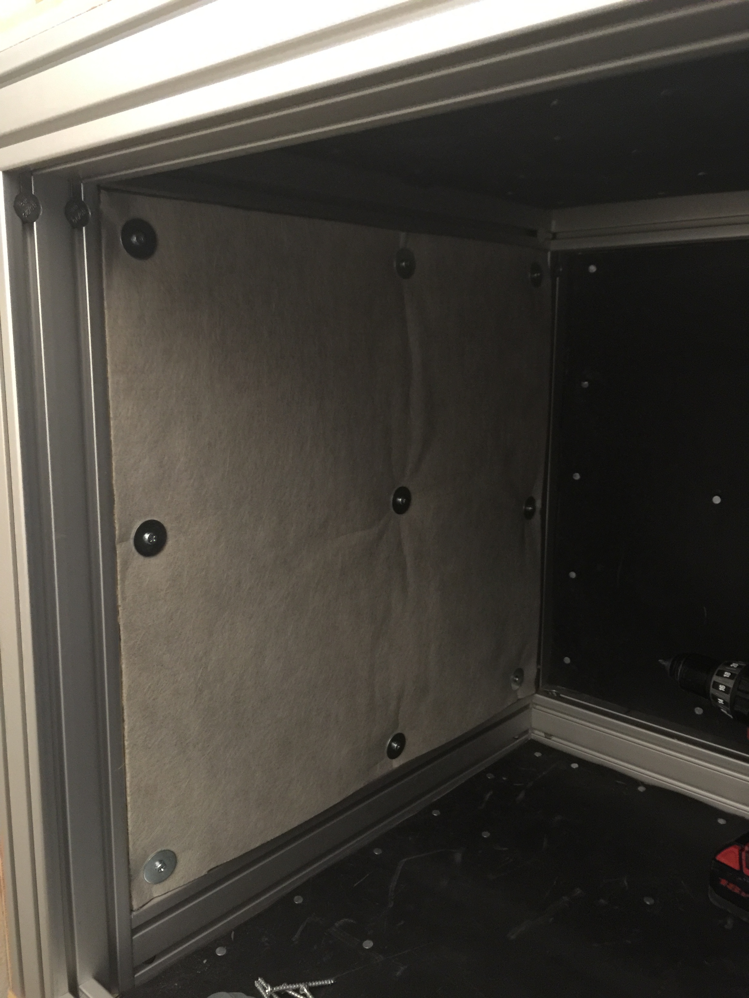

I’ve been working on an “extreme” enclosure - 30 dBa of suppression - recently. It’s not cheap, but it’s AWESOME. The enclosure sits on a separate stand. It’s all about MASS, LAYERS, and effective use of materials. The walls are 3.5" thick and have 5 layers of sound suppression - outer skin, Green Glue - inner skin, Accustiblock, Quiet Fiber. Here is a peak at the work in progress:
Table:
0.25" Accustiblock (superior to MLV) layer (the 2" Quiet Fiber batts can be seen above):
2" Quiet Fiber inserts:
No need for Quiet Fiber on the bottom - the deck of the CNC machine will reflect most of the sound up and towards the sides. Anything that comes back from those areas will be severely attenuated and will not survive passing through the walls.
The machine will sit on 30 Duro Sorbothane isolators to kill the to low frequency vibrations that the mass doesn’t.
