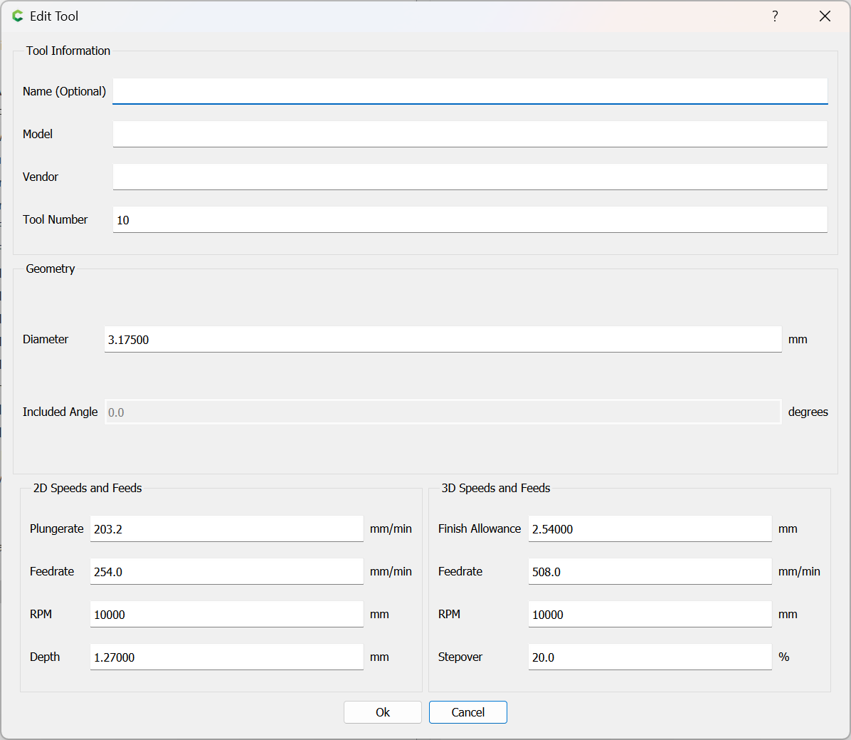

hi, are there forbidden characters in the tool descriptions?
I added a tool with 1/4" in the description and when running a file when it calls for a tool change out it is only described as #10
What did you number it as?

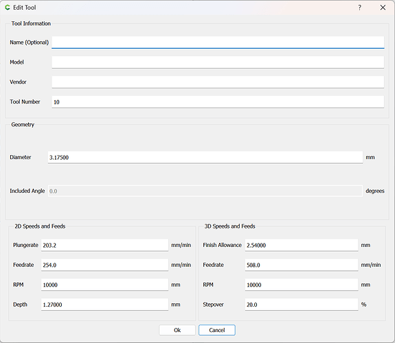

Post a screengrab of the Tool Edit window?
I have since changed it to 250 to see if it would show up but not yet
it shows the corrected description in CC Ill retry tomorrow. I’ll recheck in Motion
For custom tools you must have a unique number and only a unique number. CM does not understand custom tools with descriptions for the tool only unique numbers.

The Edit Tool window:
