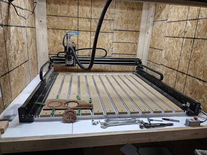

Front right corner of my machine lifting up
I have a brand new s5pro 4x4. I built a cabinet for it to set in. If I run the gantry to the back of the machine the front right corner of the machine will lift up a 1/16 of an inch. To me and my simple newbie mind that means the machine is sitting on a non level surface. Which means I need to disassemble the whole thing and level out the surface that the machine is sitting on.
I just need someone with more experience than me to tell me yes that’s what will fix the whole thing you stupid newbie you should have used a 4ft level instead of a 6 inch level.
My solution for this sort of thing is to put the machine on a sheet of foam which takes up any unevenness or lack of level, allowing the machine to find its own level on the yielding surface.
Well that actually sounds better than hand planing like I was going to. What thickness would you suggest using and I’m assuming that you’re talking about the 4x8 sheets at the local big box store.
Thank you for the information. This has been a very crazy experience for me. I’ve never spent 5k for a tool and I’ve had it put together for 5 days and haven’t even been able to use it.
Usually I use the “Anti fatigue” puzzle mats such as one can buy at Harbor Freight:
https://www.harborfreight.com/4-piece-anti-fatigue-foam-mat-set-94635.html
3 such pieces worked well under my 4x2 SO5 Pro — for a 4x4 you’d probably want 6 (two packs).
You can buy the rigid foam at big box stores and other building supply stores. The offer .75" and 1.0". I would get the 1.0" but the .75" would work. Because of the size of the SO5 you might need to get two sheets of the foam. I dont have an SO5 so I dont know if they have leveling feet but if they do I would remove them to let the machine sit down on the foam.

I also have my S5Pro on Harbor a freight anti-fatigue mats. Works great. You can also just shim between the machine and bench. :slight_smile:
Nathan, you are absolutely right about this forum. Nothing but very helpful people who love using their cnc machines and passing on the knowledge they have. Looking forward to see what you make on yours.
Logically, I don’t think what you have described is absolutely the unevenness of the table vs. the 5PRO machine.
Since its a new machine, have you done some squareness / level checks on the machine itself to find out if its been assembled correctly?
After having my 3xxl on foam for years I went a different route. When I built my 5 4x4 I squared and tightened everything. The went back and removed half the slats and shimmed under all the cross bars.
The machine is also screwed to the table on the corners so it can’t move.
Thank you for all your help. I went with the 4x8 1/2inch sheets from lowes and it solved the problem. I let it settle in for a week and I can run the gantry to any position and the bed doesn’t move at all.

The first time I turned the machine on and translated the transom to the back, the machine launched a corner up 4" or so. I thought I had squared the machine, but the transom showed me the real square. This is on plywood so there is no slippage.
So I shuffled it to settle on the table, shimmed the bottom and all is good.

Wow sounds like you were in a bind lIterally and figuratively! I figured out my problem was inconsistency in the OSB thickness. The cabinet bed joists were perfectly level but the cabinet dimensions are 7ft X 7ft. I had to use two sheets of osb one was the full width of 4ft and I had to cut the other down to 3 ft wide. The first time I turned the machine on and moved the gantry to the back, the corner that was sitting on the small sheet lifted just slightly. The thickness of that sheet was about a 1/16th difference and the styrofoam boards resolved the problem and took a lot of the echo and vibration noise out of it. Would have all been avoided if i had used some good sheets of plywood but that would have ran the price of my cabinet up from around $350 to who knows how high. My local price for a sheet of 1/4 inch ply is almost $30 and half inch is close to $47 a sheet cabinet grade is $80+. So I opted for 1/2 inch OSB and add my veteran discount into it and they were right at $15 a sheet. But I learned a good lesson dont assume that OSB is truly dimensional; some sheets are + or - on the tolerances.
