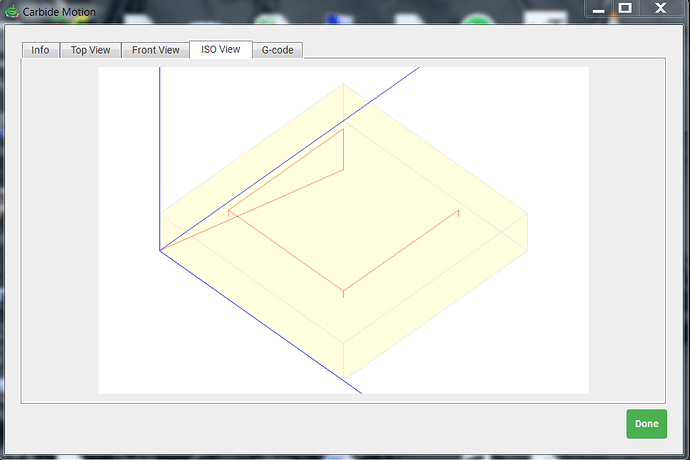

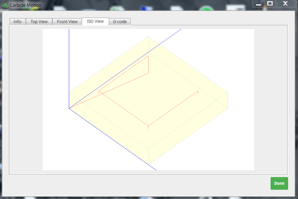

I loaded the G-Code into Carbide Motion and loaded the #112 tool. Immediately the Z-axis rapid plunged the tool into what was luckly a pre-existing hole (that was there for irrelevent reasons) and the bit crashed on the shoulder rather than the tip.
I hit STOP and had a closer look at the preview, which looks like it wants to start from the base of stock and work upwards in the first hole.
The other three holes look like they would work as expected.

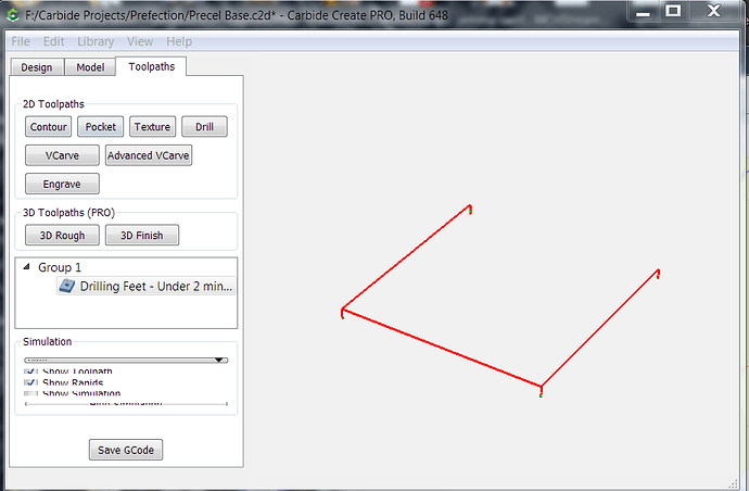

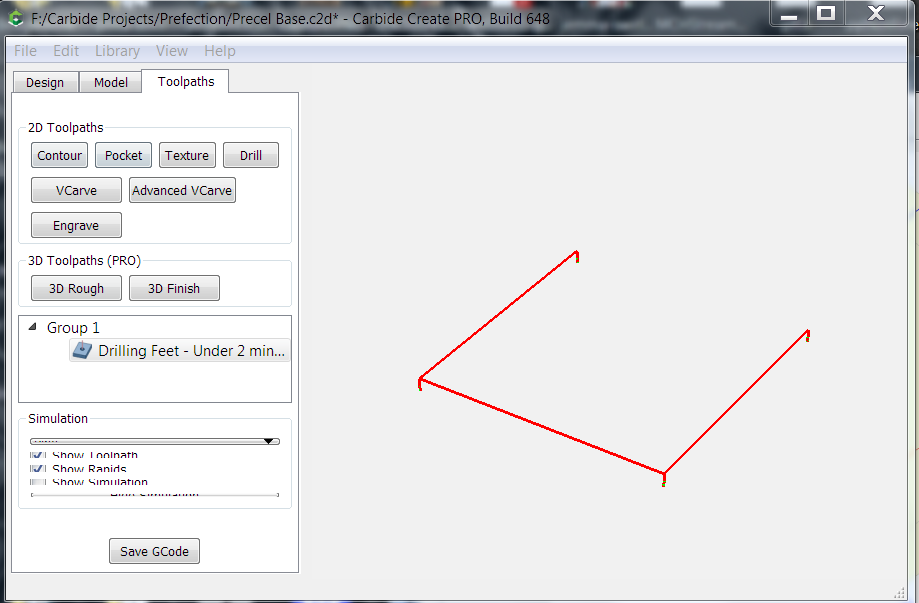

The toolpath in the Carbide Create simulation shows the four holes all the same.
This looks like a bug to me.

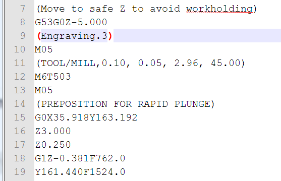

Here is an extract from the G-Code
Capture4
Line 15 would appear to be the culprit

If I do almost exactly the same thing but use a pocket operation, the dive to Z0 at line 15 is simply not there and the toolpath behaves. This is what I ended up doing.

I’m still calling it a bug. I think it is trying to set an initial position “over the first hole” but it is forgetting to include the stock thickness in the initial Z position. (I have been a coder for around 40 years and that’s where I’d be looking.)
