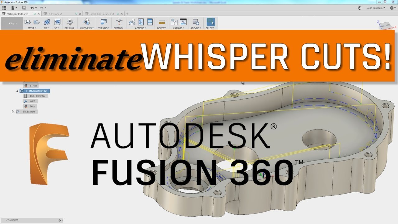

That is a very irritating behaviour watching the machine cut air, NYC CNC did a video about that
