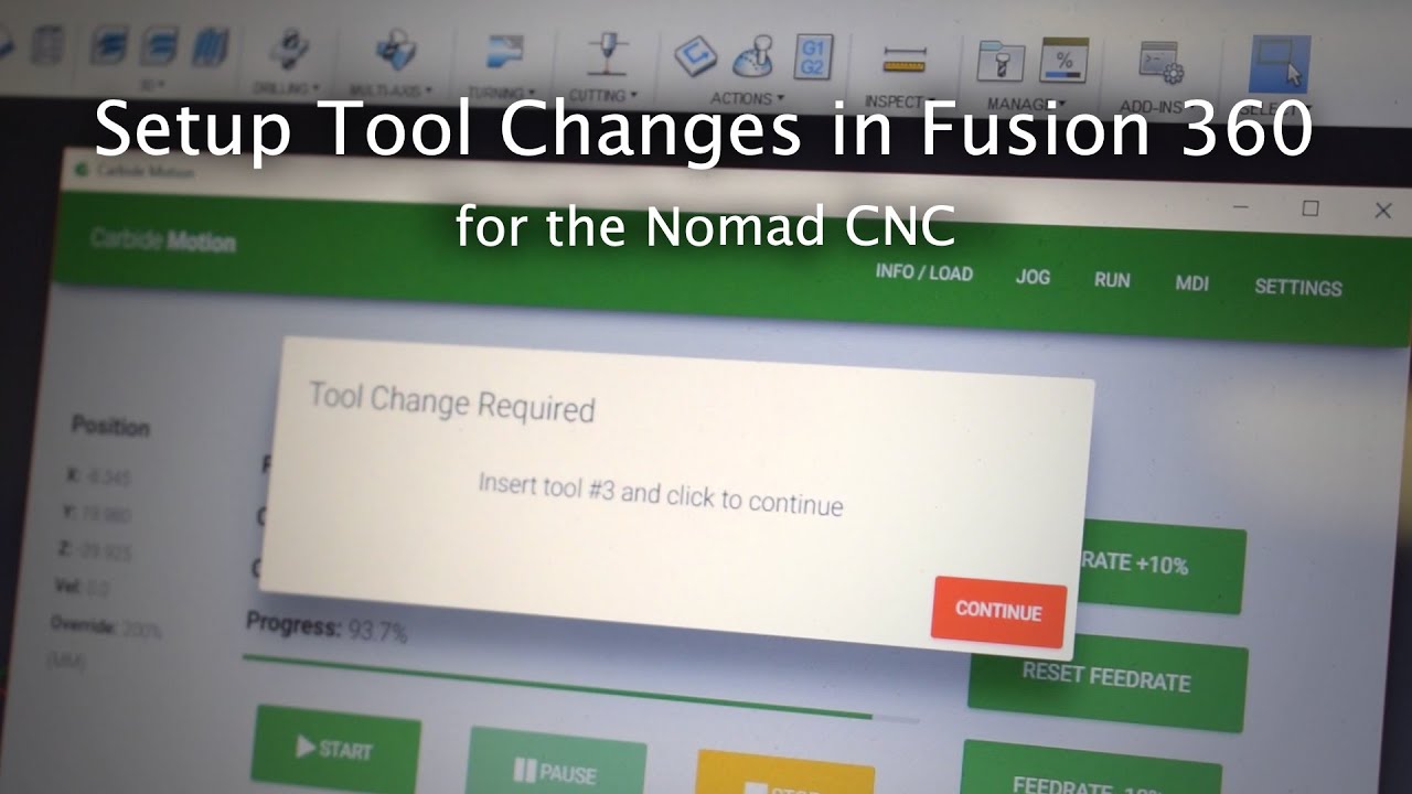

Does the video:
still work/apply?
If not, @wmoy could we update that?

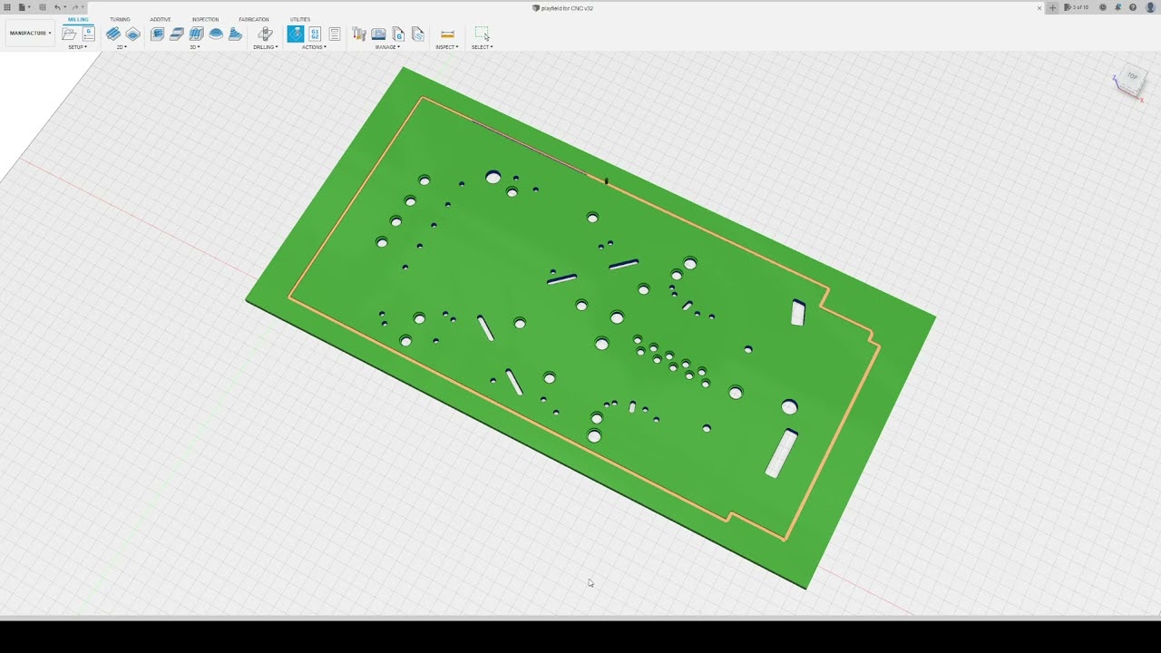

yes, as others have said you can see the simulations, although I haven’t looked through to see if you can have the simulation pause at tool changes, it will just run through. here is a test one from a few years back. 3 tools in here if I remember right

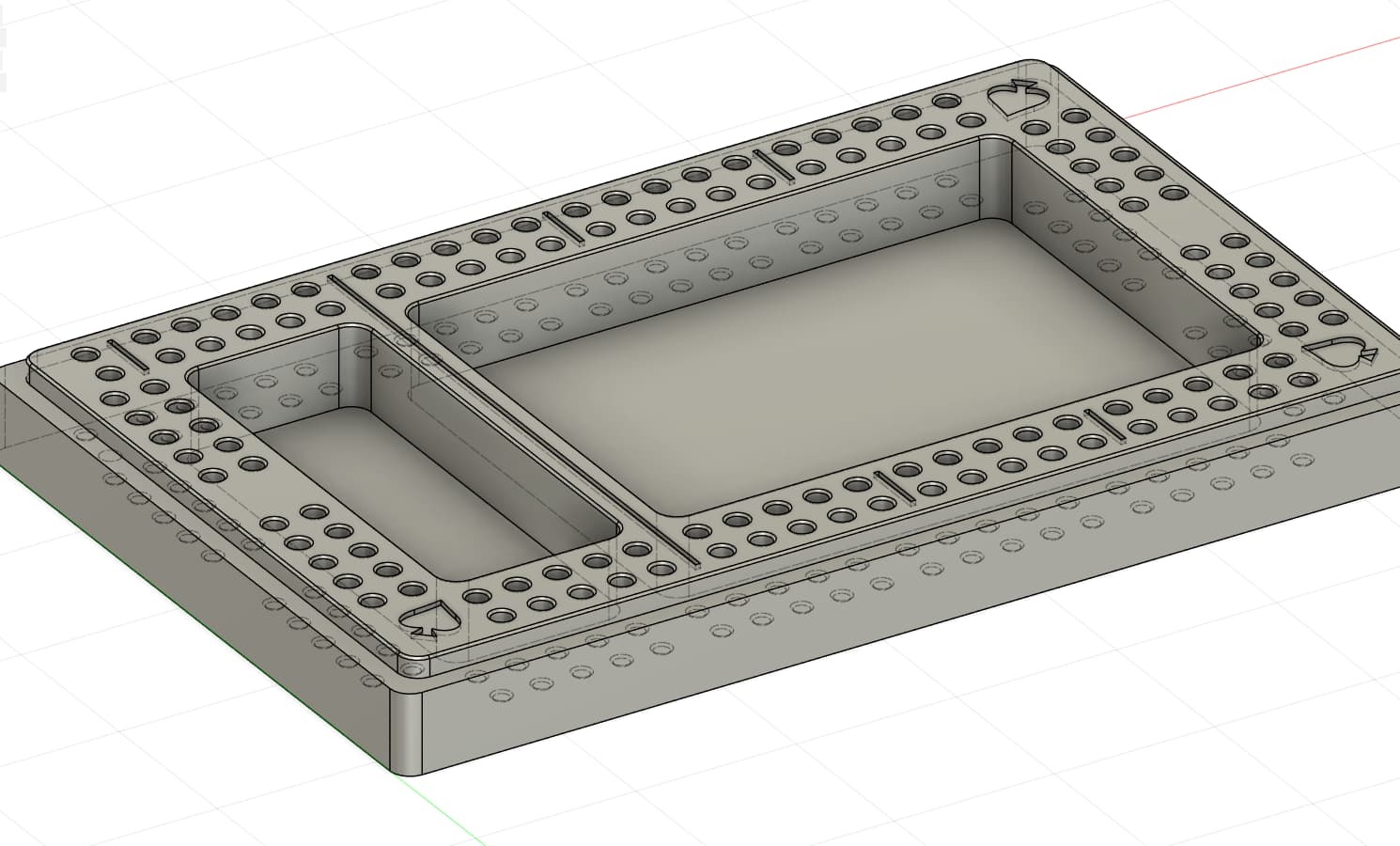

Thanks for all the answers! It ended up being easier than I expected to create tools, plan tool paths, and preview the cut order. I’ll probably do a much simpler design for the first actual gcode so I can test that zeroing, tool measurement, and my Fusion-defined tools work as expected before I try milling this relatively complex design.
I suppose I’ll have tens or hundreds more hours to spend to tweak all of my finishing and other settings. Spend 10 hours in design to save 10 minutes of sanding… right!?

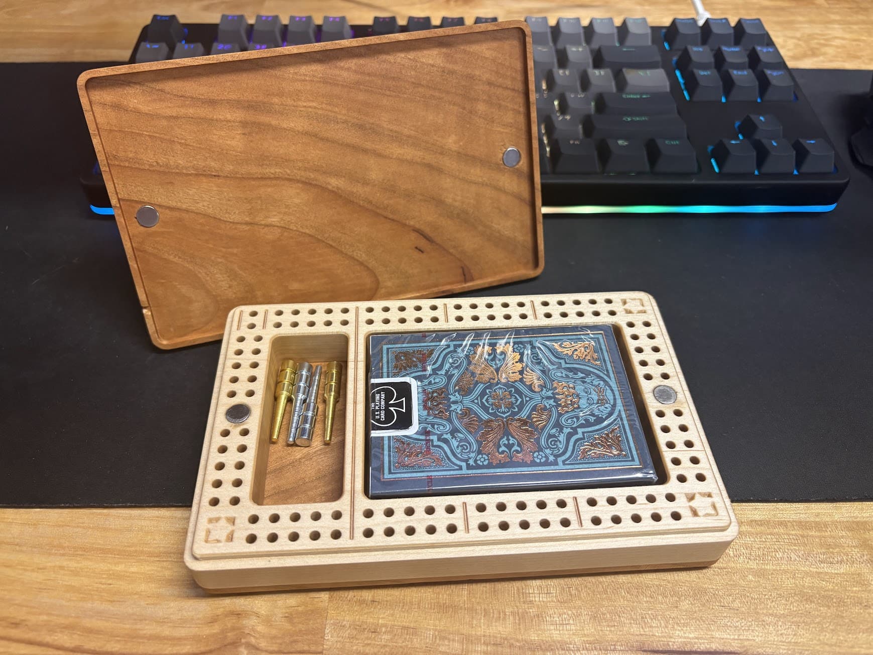

Bonus pic of the prototype. I designed this in CC Pro and I’m happy enough with it. But I need to tweak some precise tolerances and do a better job at finishing passes because the prototype required way too much sanding and assembly time to produce more than a few.
The updated design will mill the base out of a single piece of wood, do better finishing passes, and chamfer via the machine. I’m waiting for some new magnets to come in to get precise measurements before I add those to the design.
My goal here was to make a really condensed travel cribbage board that looks great and puts most of the work on the machine and not me!
