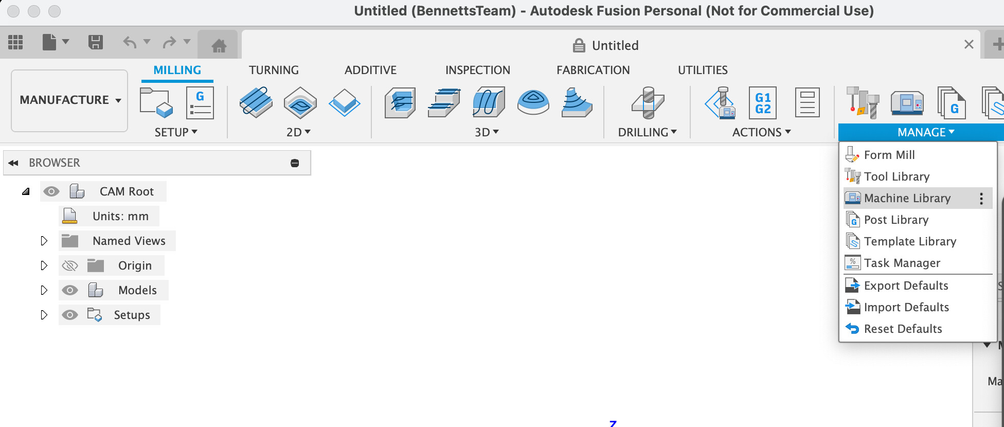

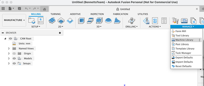

Download it, then import it into Fusion by going to the “Manufacture” tab and select Manage->Machine Library, like this:
You’ll get a dialog box. In My Machines, choose Local, then hit the “+” sign and choose “Milling.” Then choose “Post Processing”:
Then click the Folder Icon for “Post” and find the file you downloaded.
You might want to then go back to General and the other items there to customize the size and stuff for your machine.
