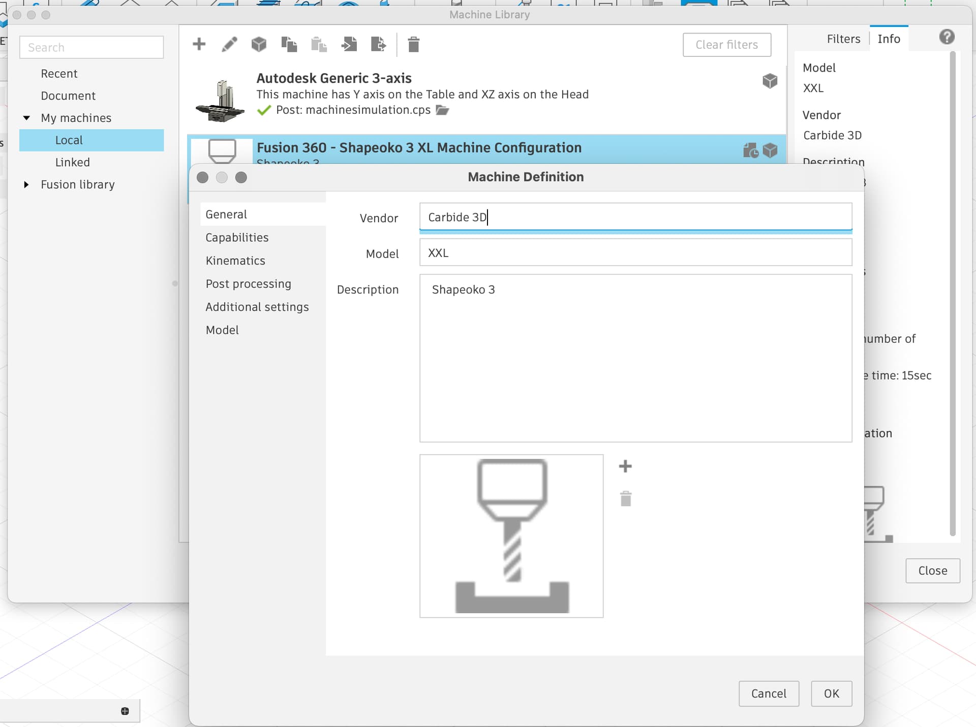

There’s a few threads where we’ve discussed trying to use the Fusion machine models (mostly with @neilferreri 's help) but mostly determined it was more bling than actual use to us.

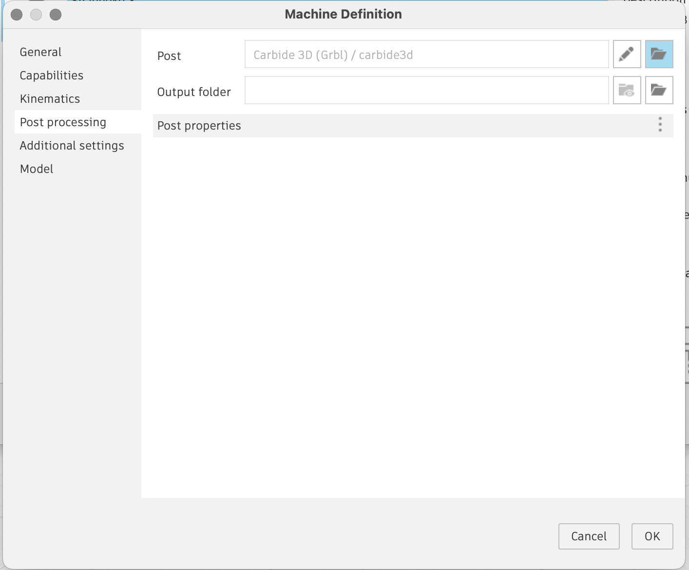

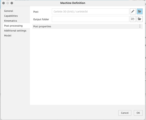

You can create a “machine” in the library for you to select rather than just the post processor.
You’ll need to select the Carbide 3D post processor (or I think Neil may have an improved one). You can also set your default post output folder here which can be handy.

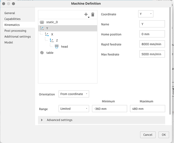

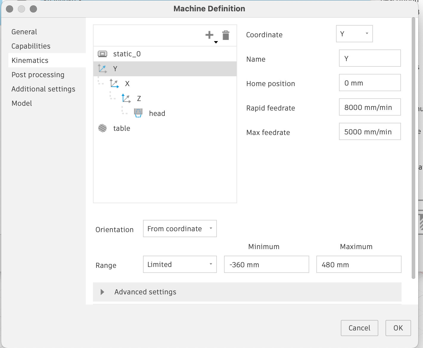

You can set the X, Y, Z movement ranges, but I think this is only relevant if you’re doing the machine simulation thing, which I’ve not bothered to do.

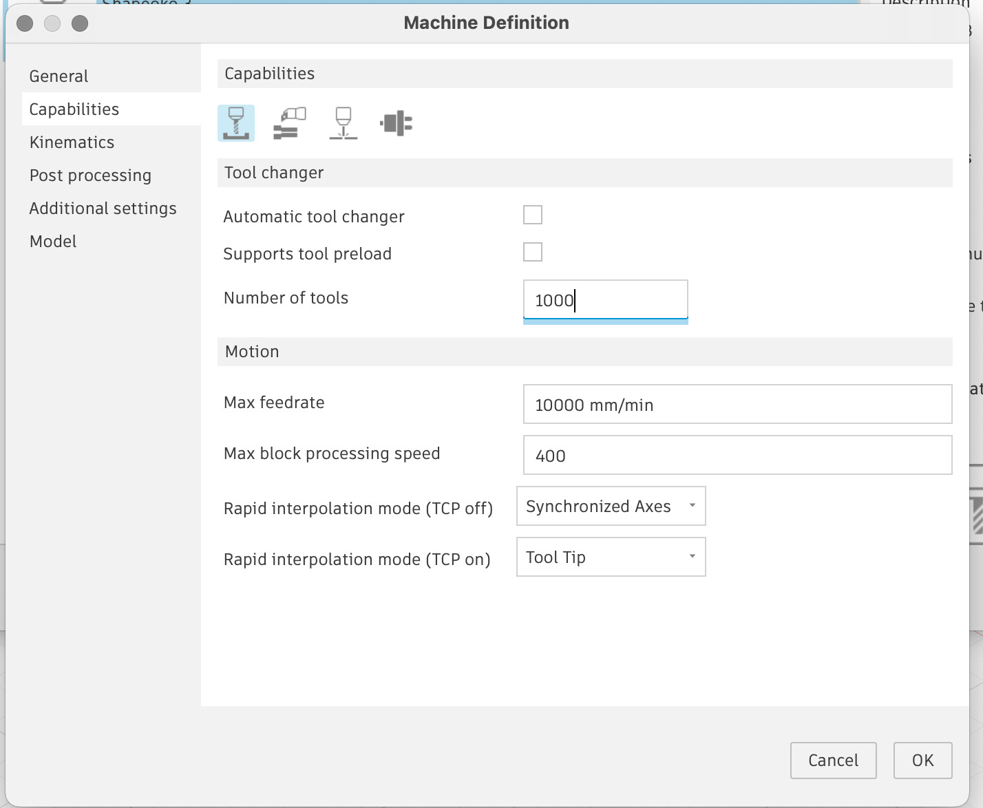

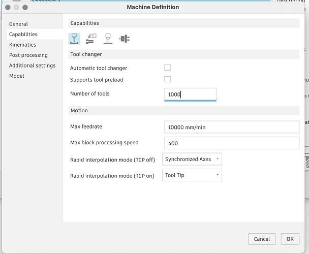

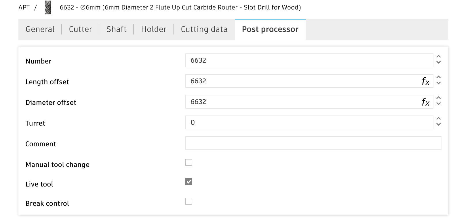

I find it useful to tell Fusion that it has a 10,000 tool changer as I’ve used four digit numbers for my Tool IDs based on the vendor’s part numbers, that way you don’t get a yellow warning saying you’ve selected an invalid tool ID on your Post.

The Machine setup has been discussed, but doesn’t seem to be needed — just use the carbide3d.cps and keep the bounds w/in the machine envelope.
