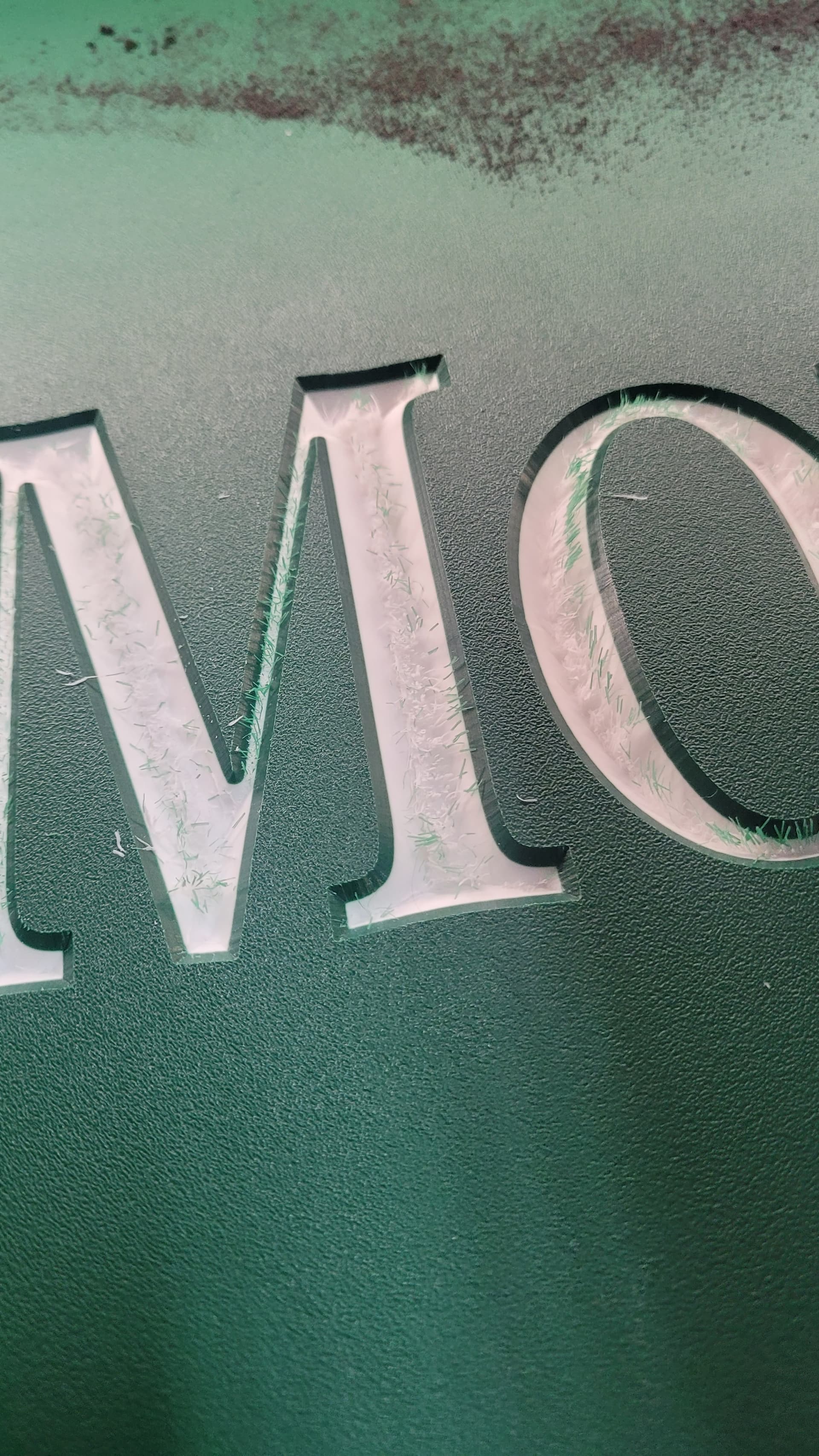

Fuzzy v cuts color core
Anyone know what I am doing wrong? Vcarve, V-Bit (90.0° - 1/2") spindle 20000
3/4 Color Core.
Try your slowest RPM, and a fast feedrate. Smaller stepover for the clearing might help a bit.
You’ll probably still have some, just the nature of that material.
Stiff nylon brush & some elbow grease to clean it up.
Usually, wiping down w/ a microfiber cloth removes the worst of this sort of thing in my experience, and w/ a modicum of care, isn’t likely to damage the cut design.
