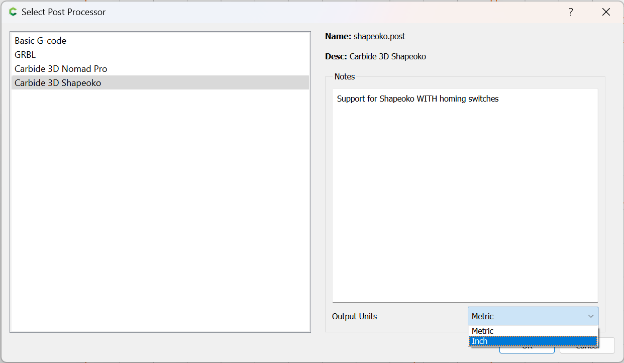

Yes.
This is done under Edit | Select Post Processor:
thanks got it that was ease to fix thanks again
