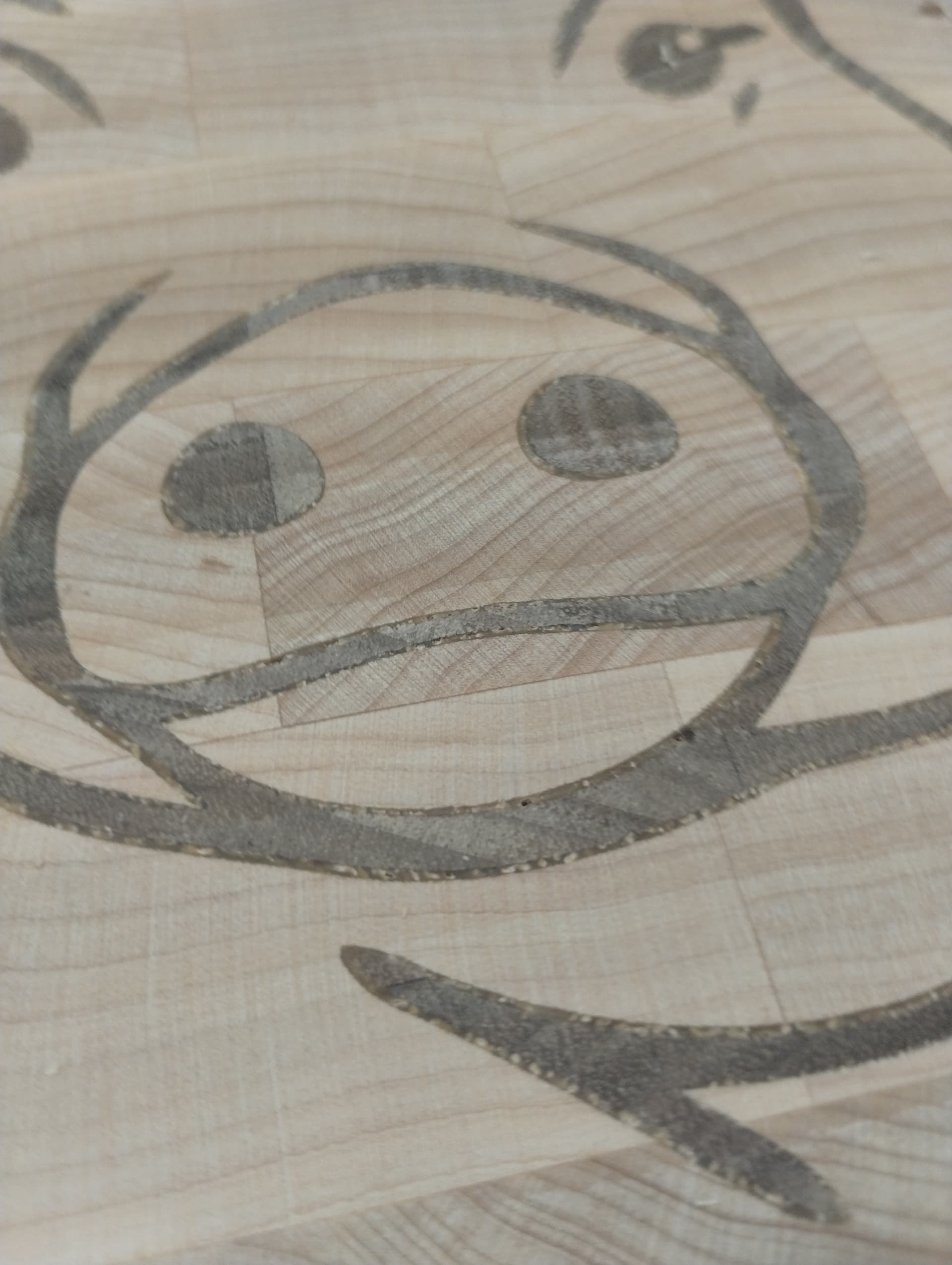

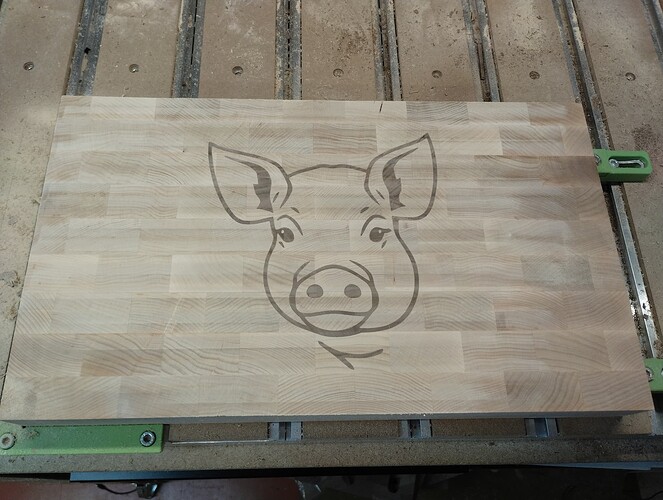

There are some gaps between male and female parts that I had to fill with glue/sanding dust, appr. 0.5mm, still visible. It is my impression -of course I cannot proof it now- that the male elevations are of the same height than the valleys on the female part are deep. So the glue gap (?) is not big enough, and the male and the female part cannot touch each other on the flanks but rather the male part dives down to the female depth. Could I express what I mean? Is there any way to alter this in the settings?
Advice is appreciated.

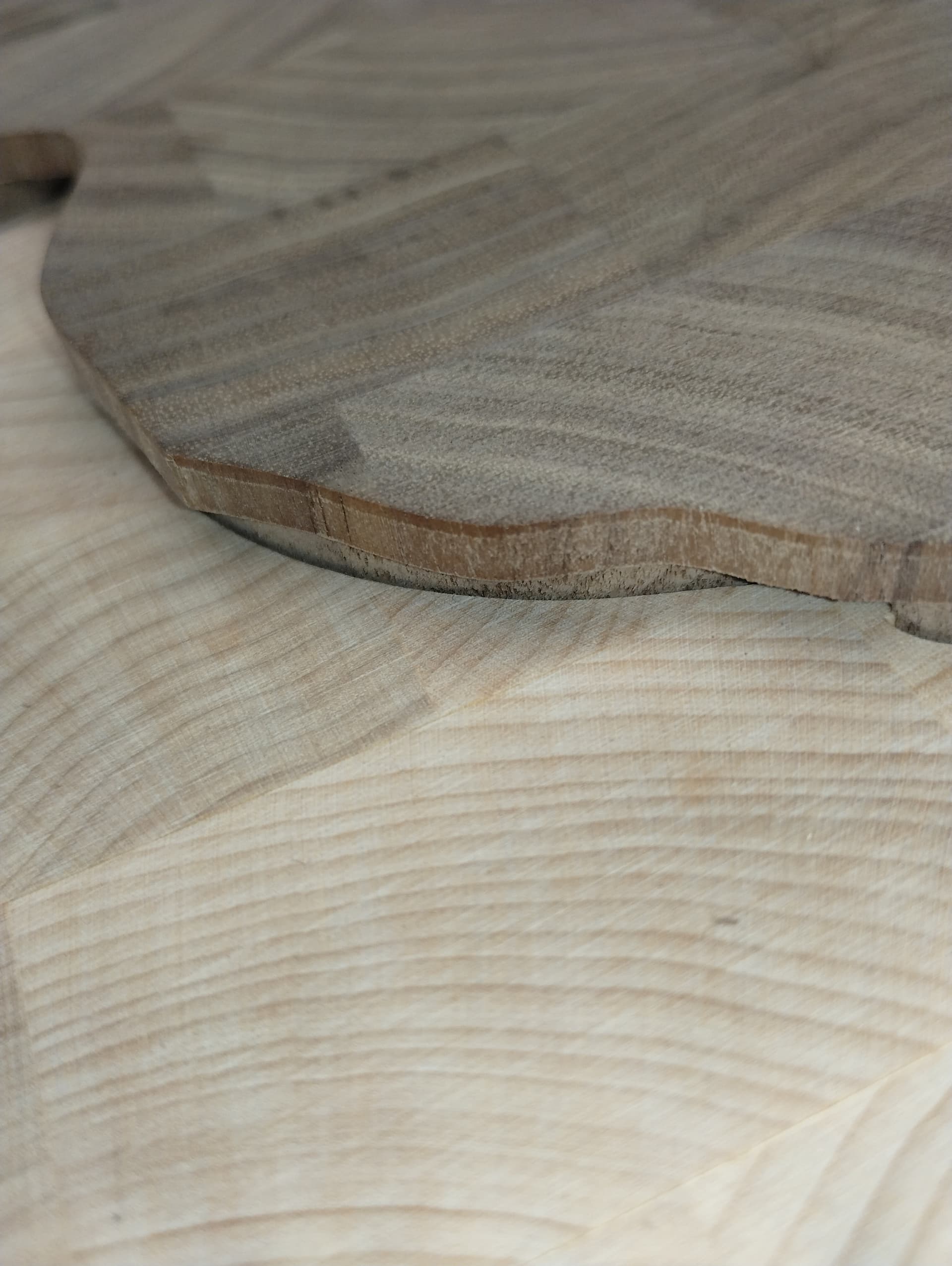

Certainly when I put both parts together there was a goo saw/clamp gap of 1.5-2mm.

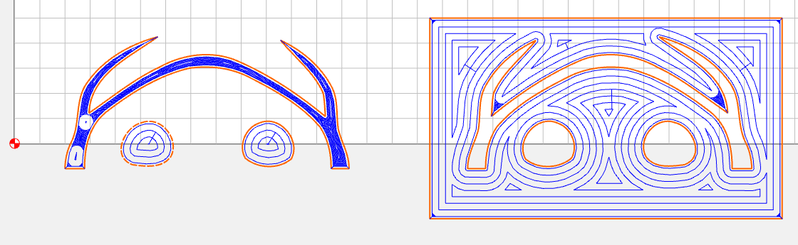

Red values are female, blue values are Male with “Inlay Mode”, Green is Male without Inlay Mode (the old way).
You didn’t comment on the tool. Is it a perfectly sharp point? If not, what is the diameter of the tip?
You’re using 6mm for the female, and 5.5mm for the male. So your “glue gap” is only 0.5mm
Those gaps look to be at least 0.5mm. With a 20° tool, that’s a depth offset of 2.8mm.
To correct this by adjusting the Male settings, Set your plug depth to 1.7mm, and the top gap to 5.8mm (subtract the correction from the plug depth, and add it to the top gap)
To correct it using offsets, offset the vector inward for the female 0.25mm, and offset it outward for the male 0.25mm.

If you clamp the male back down & take 1mm off the top, does it fit better?

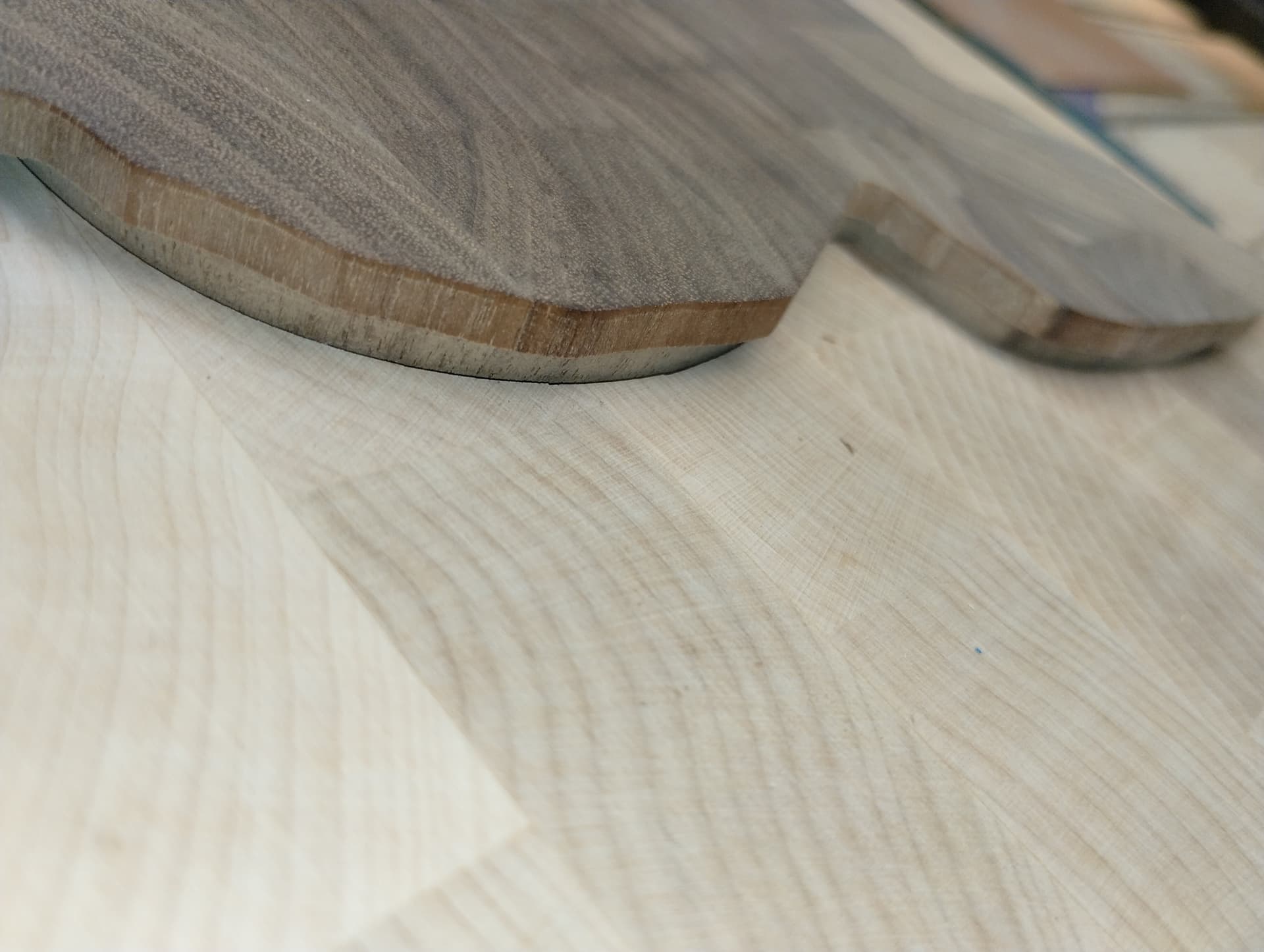

You an also try some test cuts like this, with a smaller detail & hanging off the edge of the stock so you can see the cross section when you fit them. Cut the female & remove it from the machine. Cut the male with a Top Gap of 6mm, and a plug depth of 0.0. Leave the male clamped & fit the female to the male. Adjust the cuts on the male & recut until it fits right.
I just took a chunk of your design, but it could be as simple as a circle or square overlapping the edge.

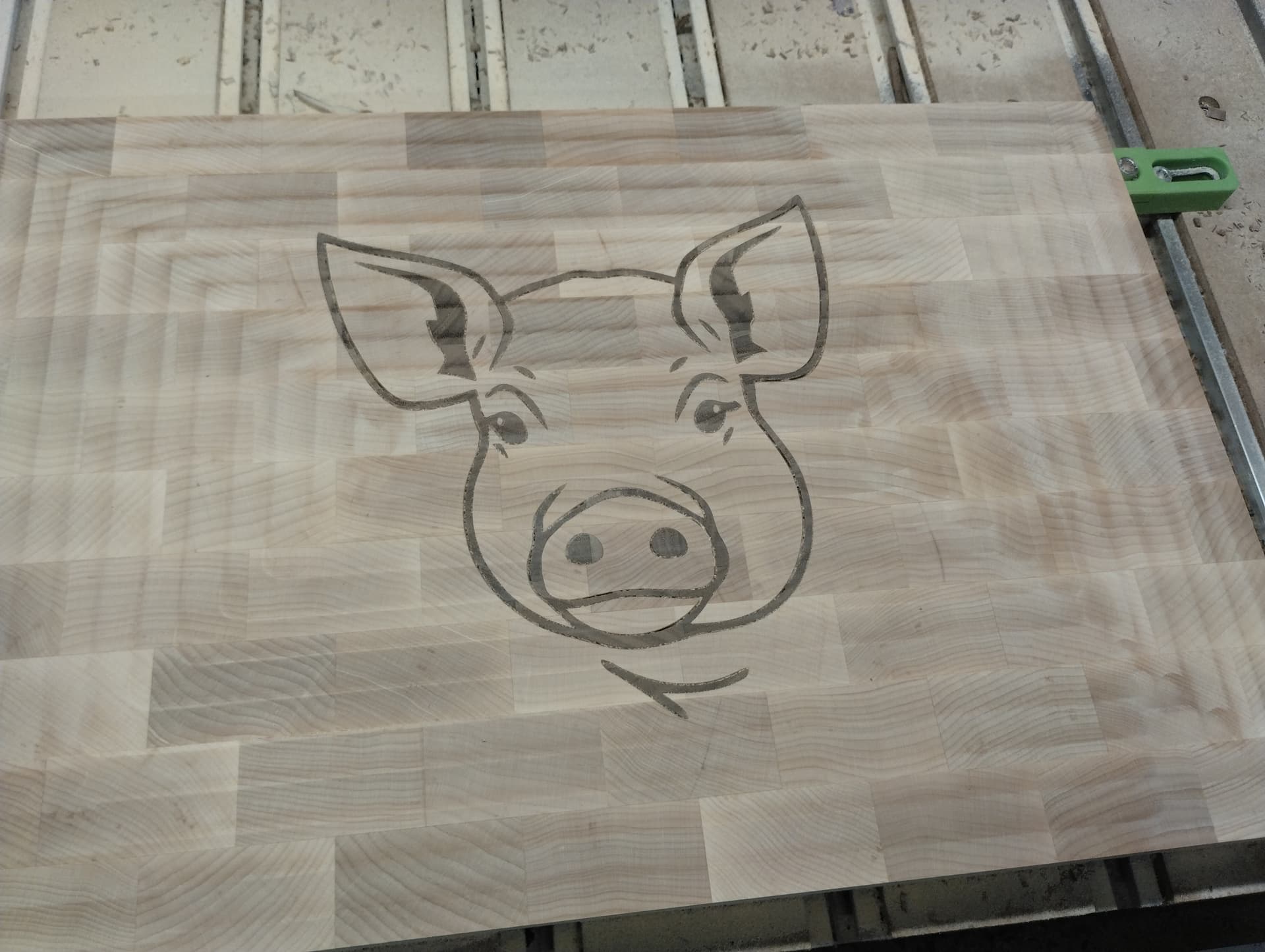

Tod: Yep. I took stepwise 1.5mm from the male part, and eventually now it fits snug, I think… Glued, dries now. Next days the plug will be flattened, will report back by then.
The idea with cutting corresponding parts on an edge, and see like a cut through… Great! TY!

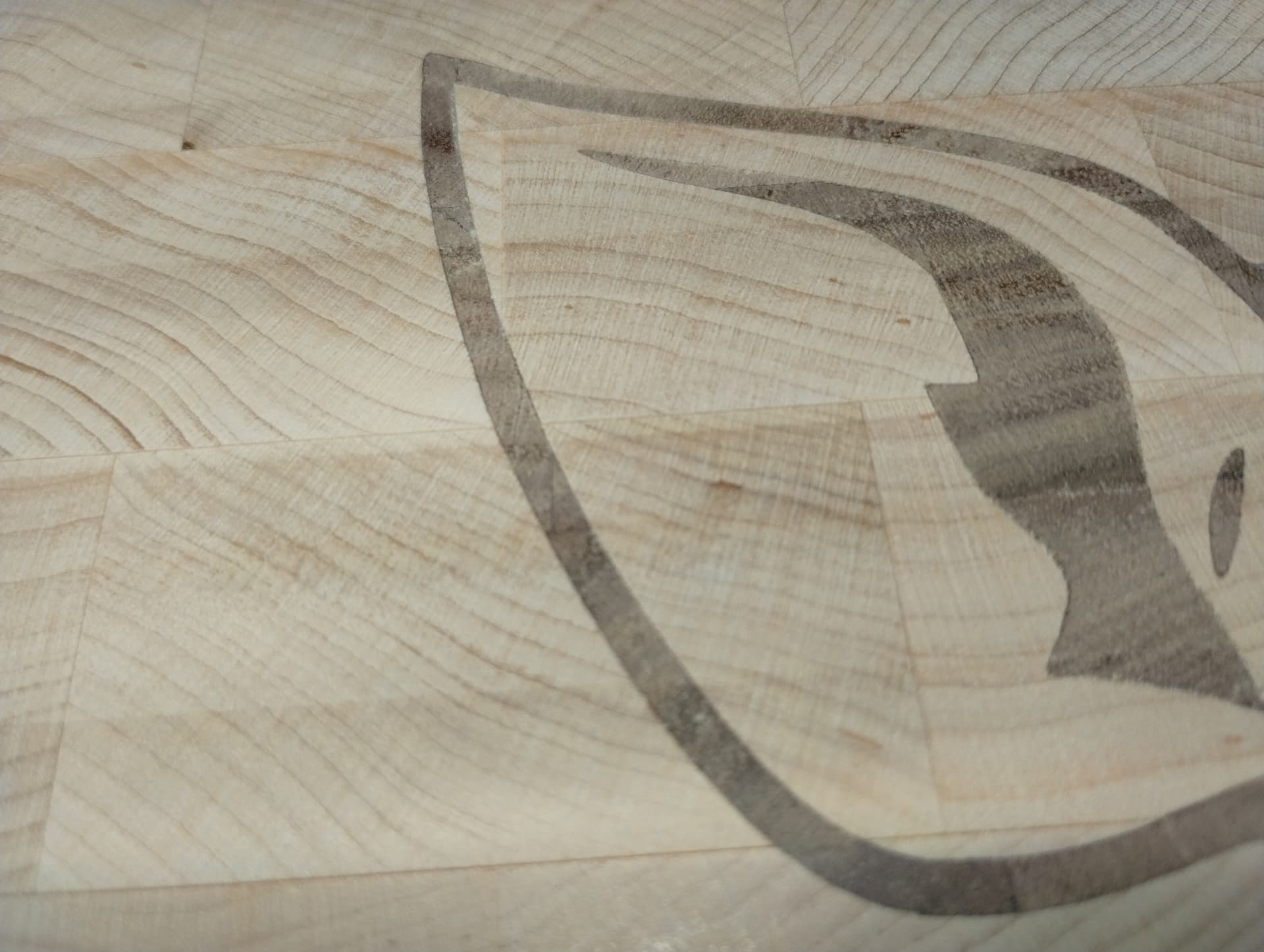

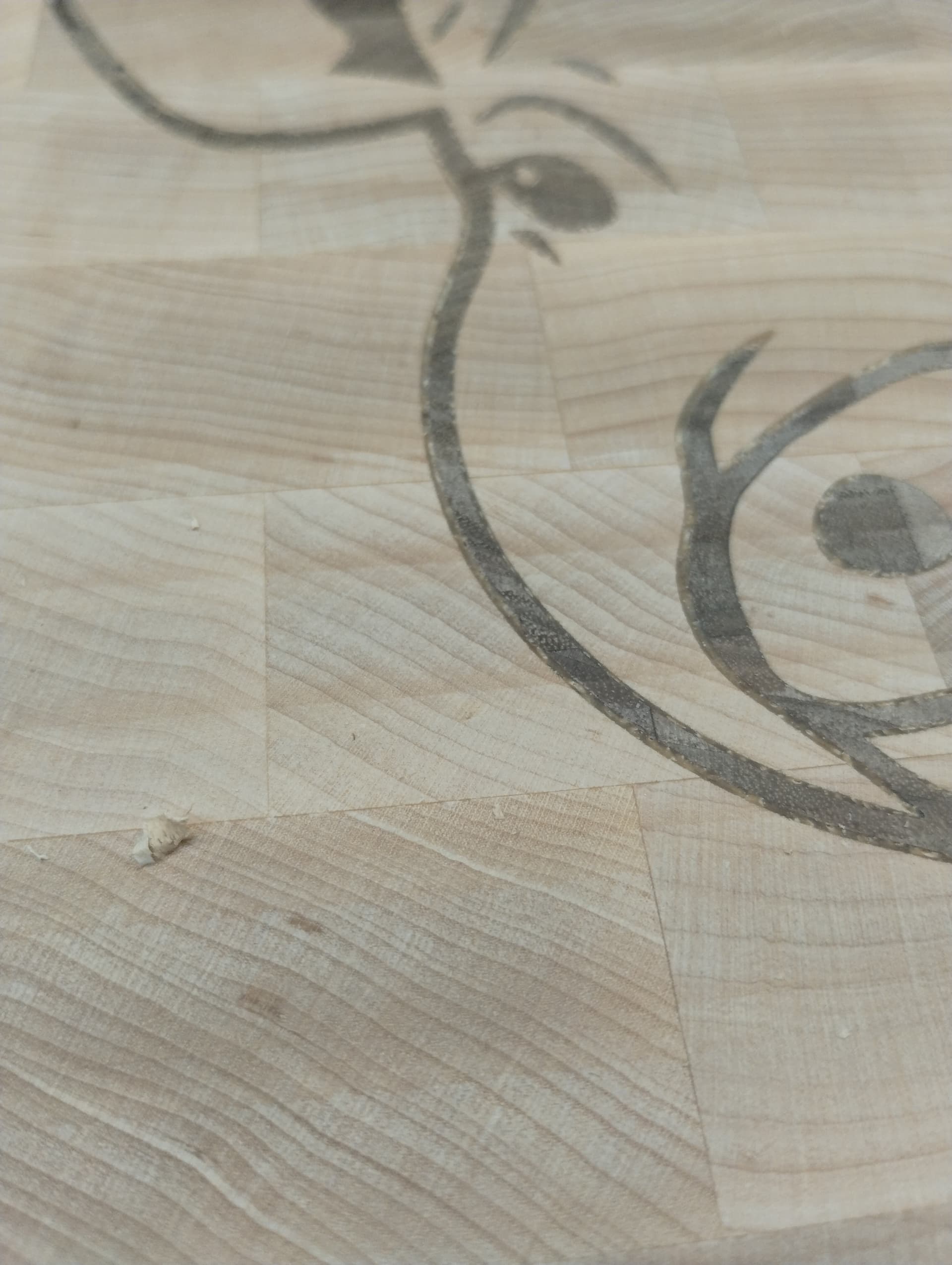

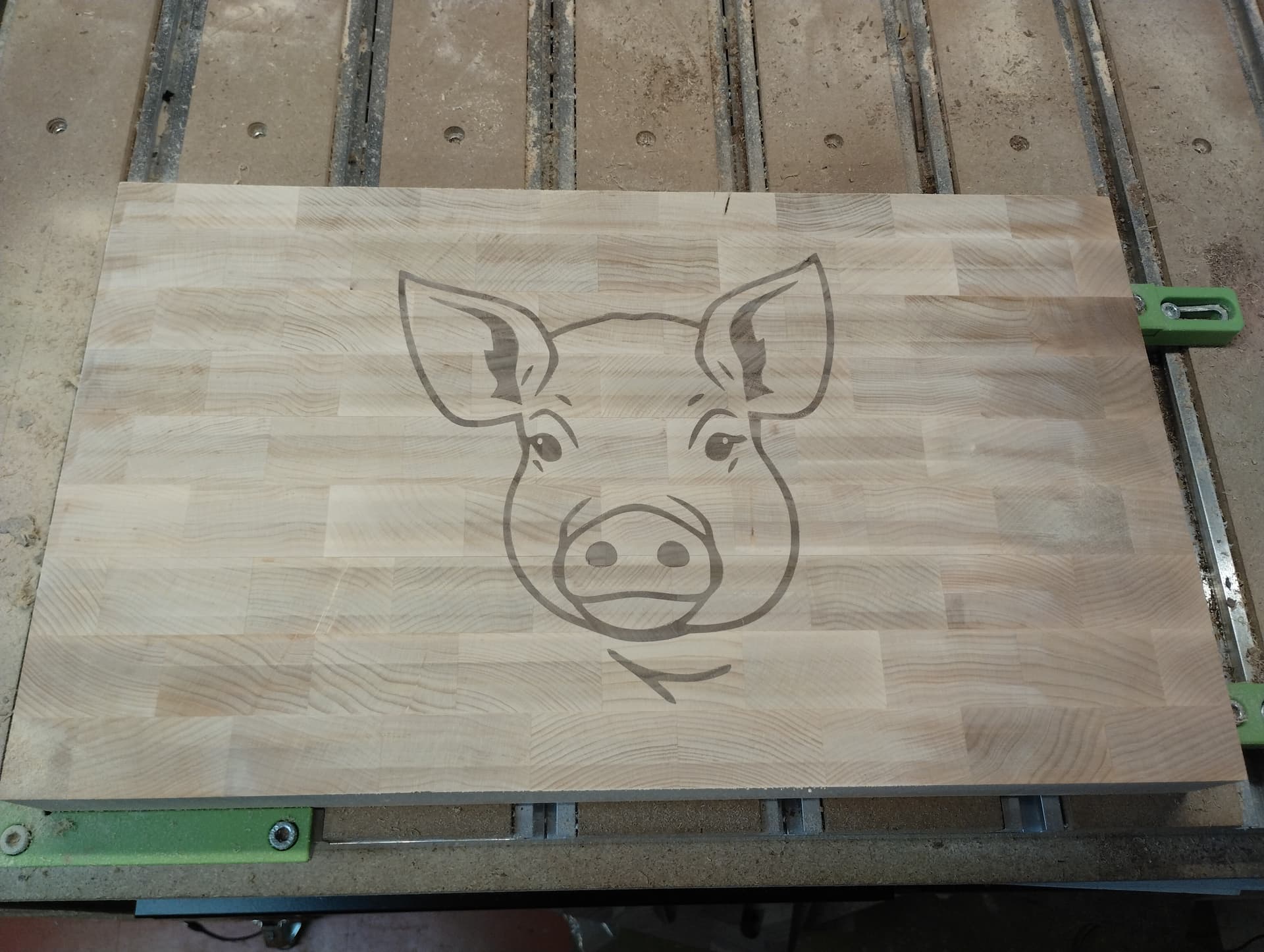

So yesterday I glued it, and cut off the upper layer of “him” today 204h later. So far all good, just an observation: in areas that were not ventilated glue is not dry, still liquid. Recommend to drill holes in those areas in the plug part. Will let it dry over night, and flatten the surface finally. Report back then.

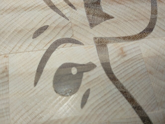

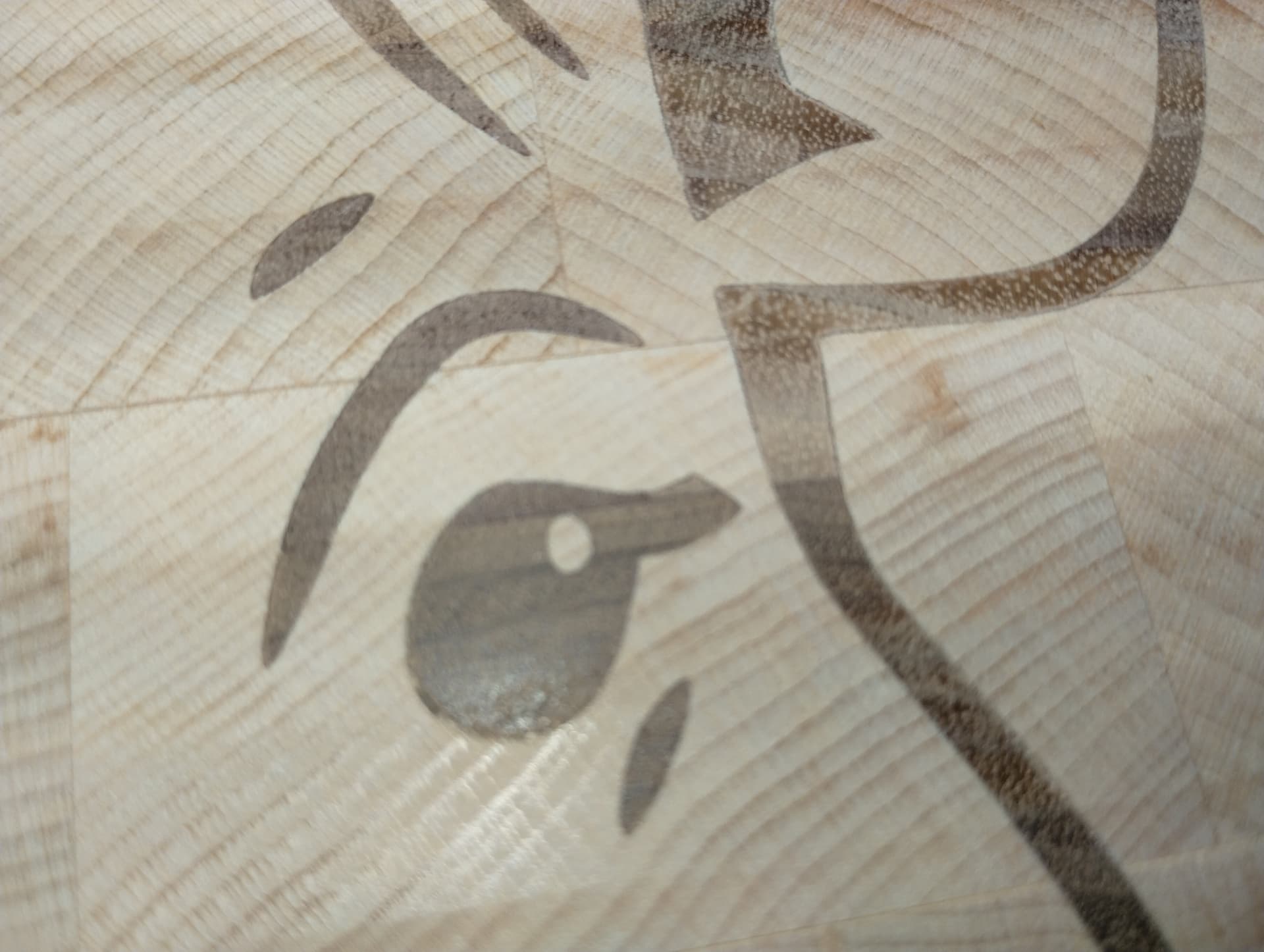

Tod: THAT! is EXACTLY the quality and precision I expect from items that leave my shop, presentable to my wife:
Thank you VERY VERY much!
And also of course to 7Alpha!
You guys are simply the best!
Turned out very, very nice. Good job.
