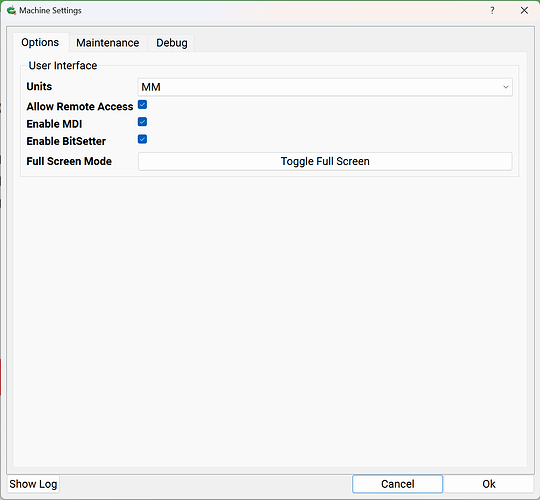

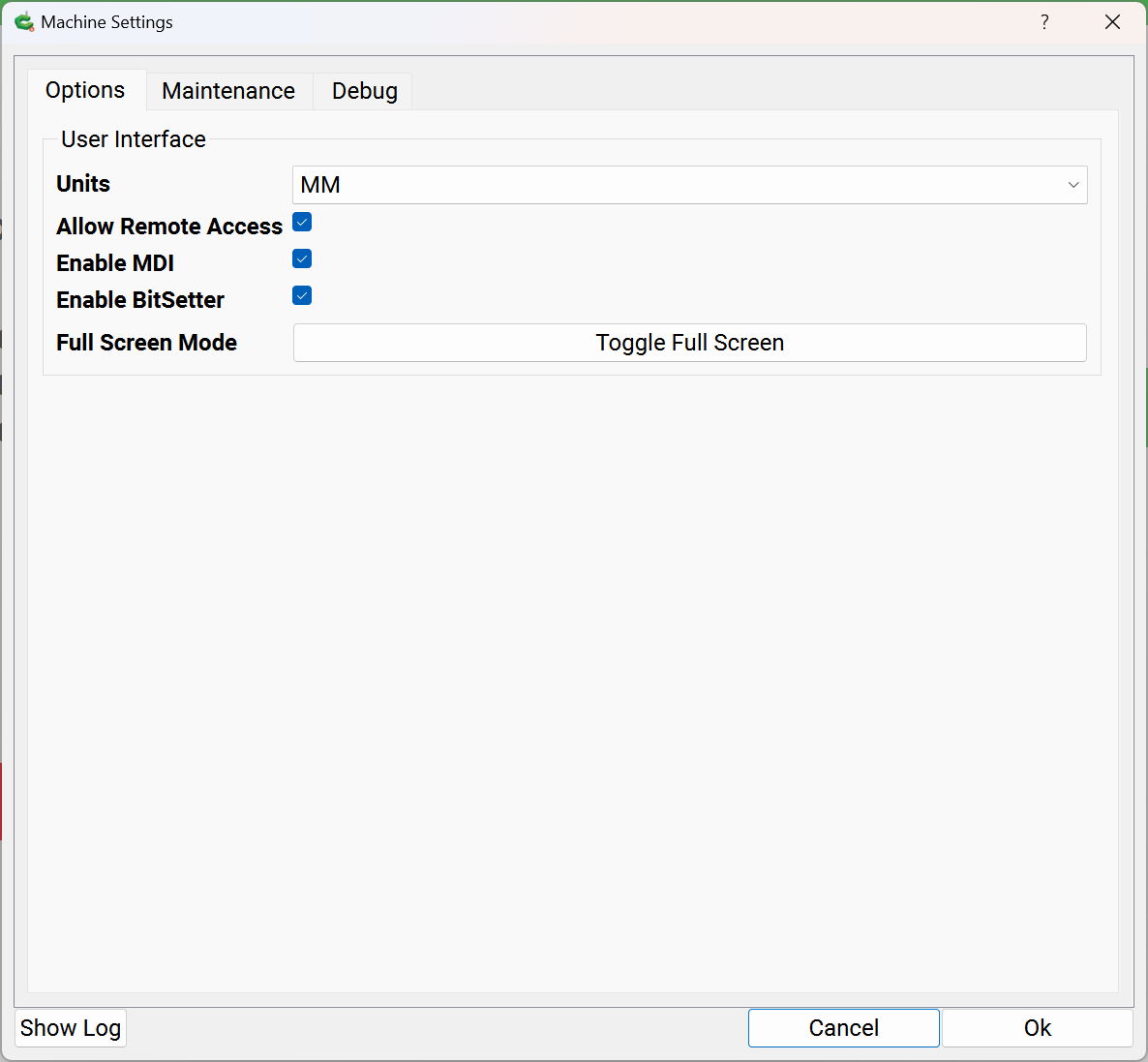

Hard Limits is a Grbl setting (which should be off) — to disable it in Grbl 1.1, if need be, enable the MDI under Settings:
then send the setting to disable Hard Limits:
$21 = 0
