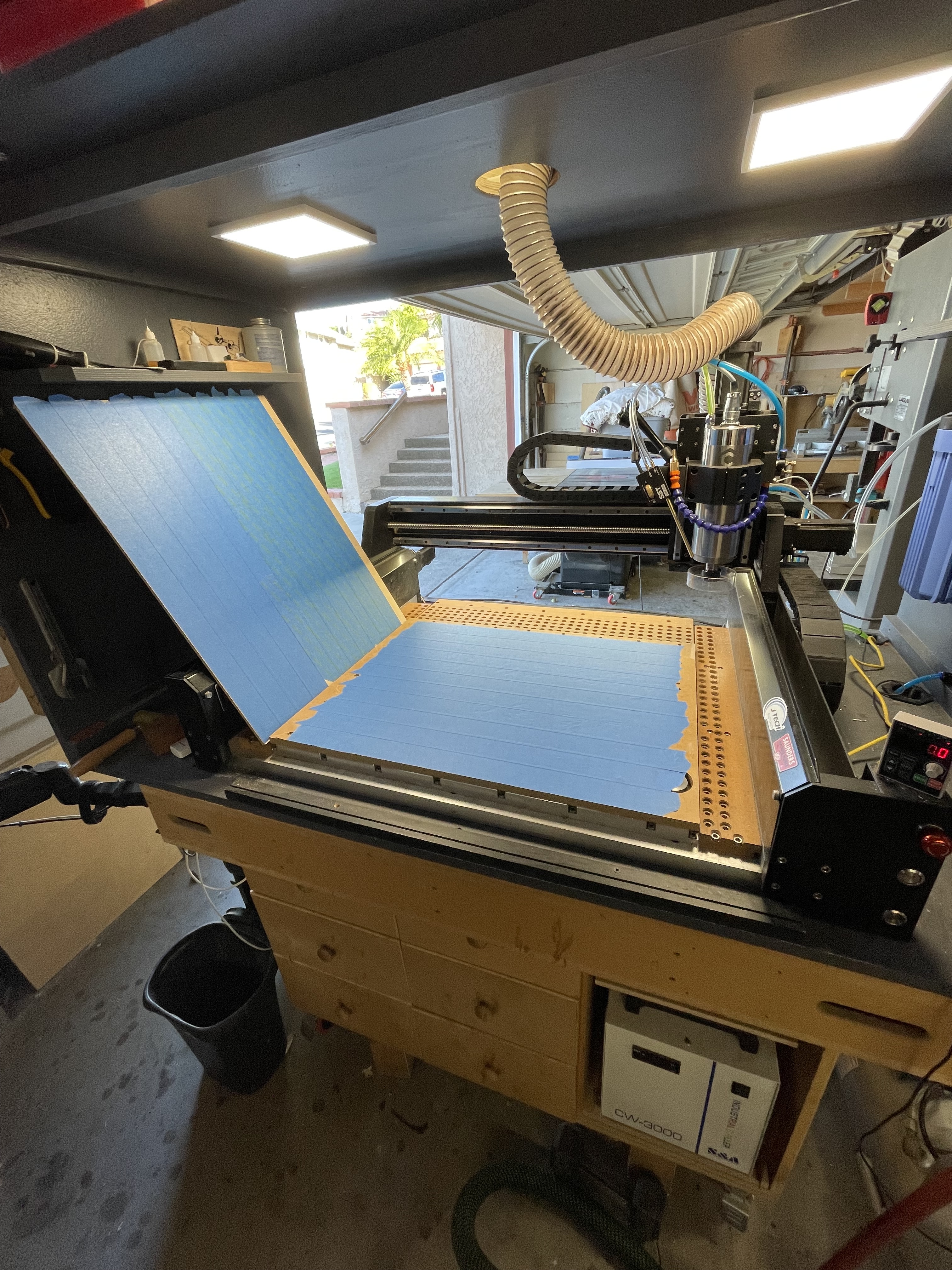

My preference for jobs such as yours is painters tape and CA.

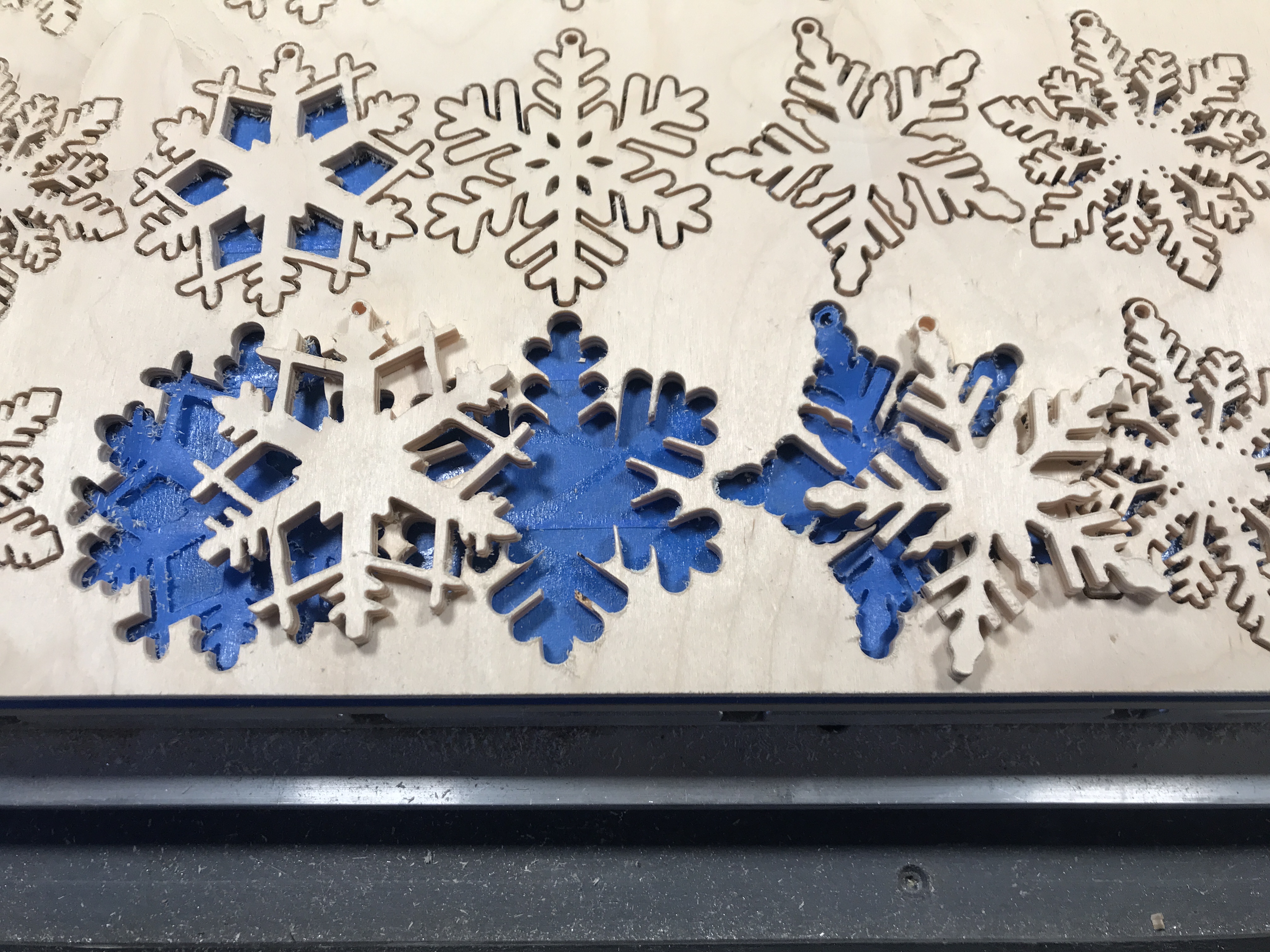

My daughter has tasked me with cutting 160 paintable ornaments. Can’t imagine tabs for that job.

What’s the runtime on those ornaments? Looks like it would take a while.
About 2 and a quarter hours per 24x20 sheet. Haven’t messed much with feeds/speeds since I have only two 1/16” cutters and I need to finish this by Saturday.
Running 50 ipm @ 22k, .125 doc. 1/4” stock.
Not too bad. Hopefully the cutters finish the job.

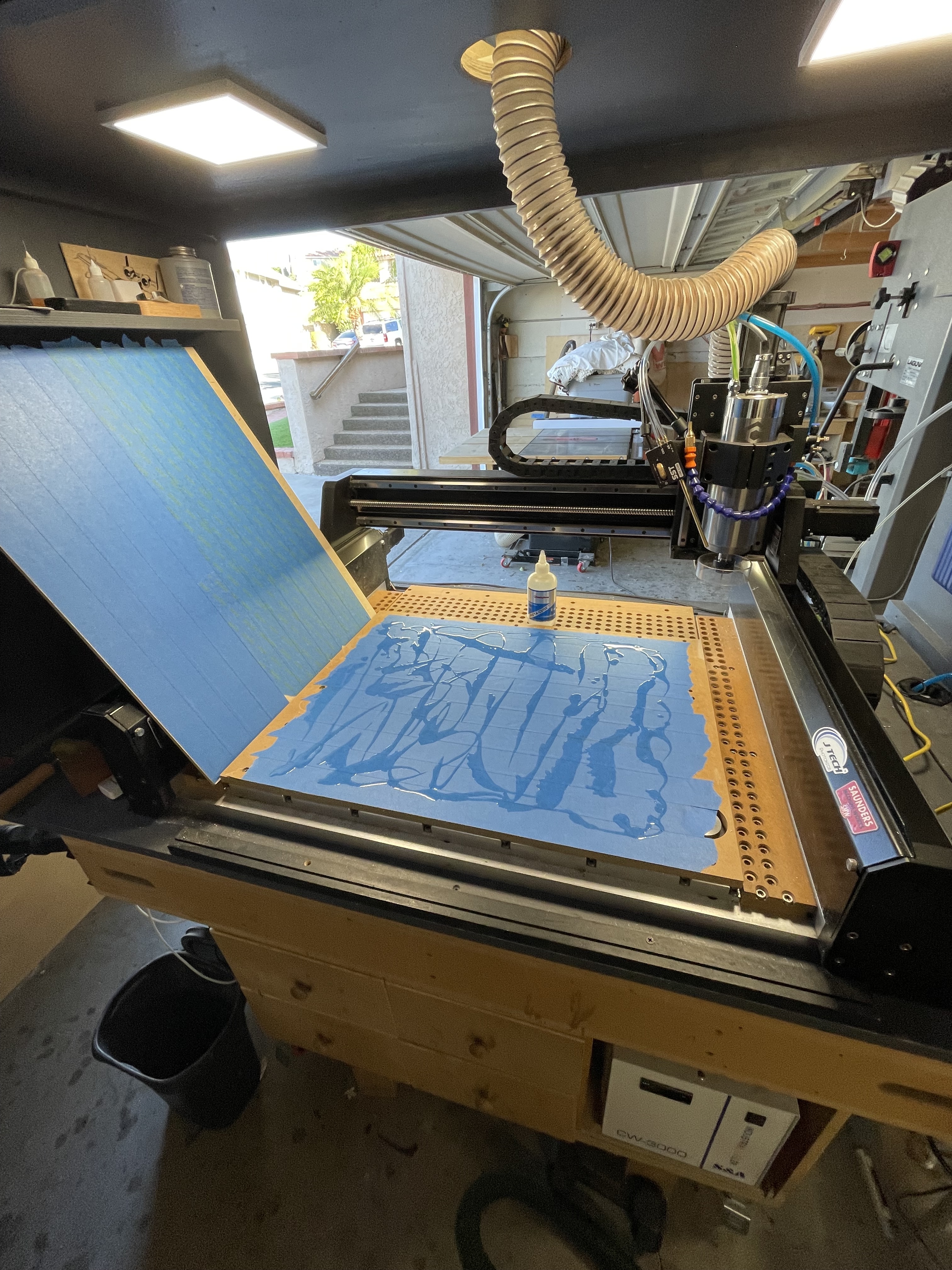

So you put the painters tape on the spoil board then put the CA glue on top of it? I’ve never user it. How does it remove from the project? Do you have to mix the CA glue with an activator.
Painters tape on BOTH the stock and wasteboard. It just peels off the part and wb when cut is finished. It helps to set your Z-zero to cut through just one layer of tape. That gives a nice clean edge and easy to remove part.
For larger sheets like these you want to spray an accelerator on the side without CA.
