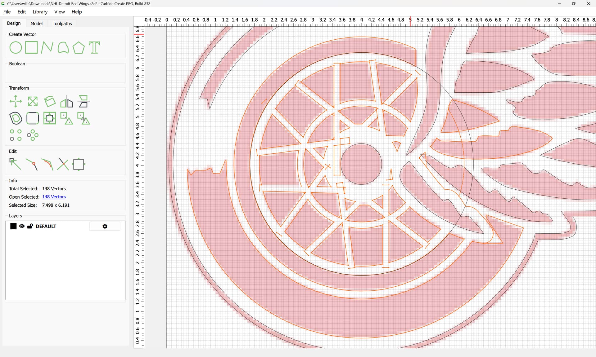

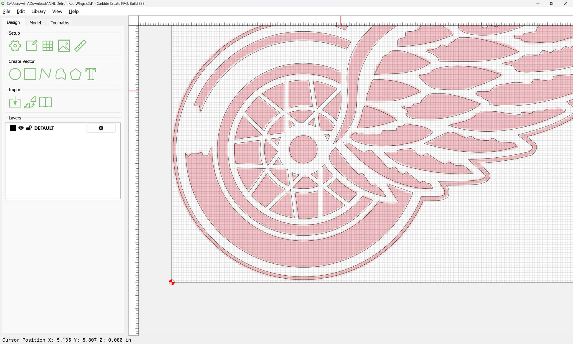

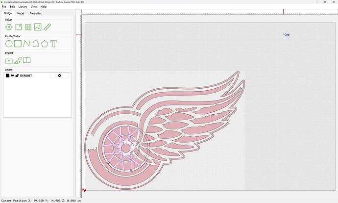

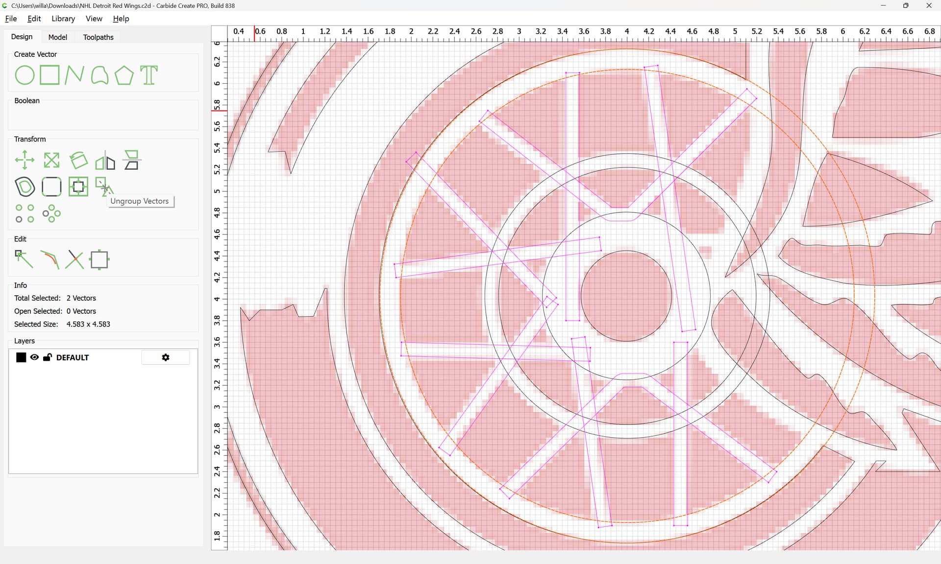

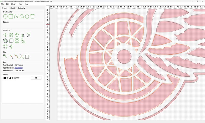

I have been getting better with design but this geometry has stumped me. Any help would be much appreciated. the wheel’s spokes are my issue
i attached the file and you can see my attempt
TIA
NHL Detroit Red Wings.c2d (284 KB)

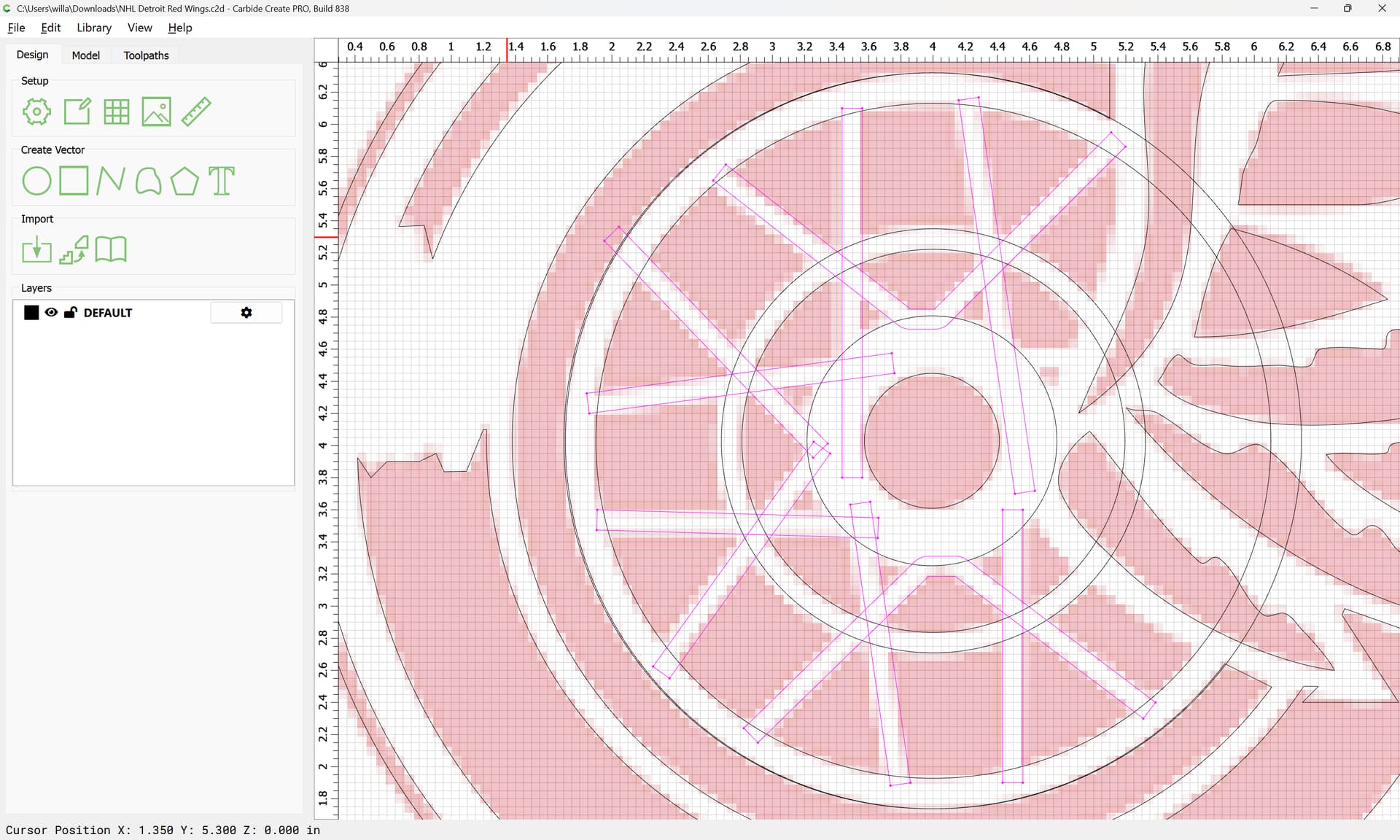

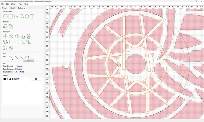

The spokes are not closed. Note the open vectors in my image. Are you trying to vcarve this?
What i would like to do is pocket all white which will allow all remaining to be red.
So, a red board, pocket and paint the pocket white

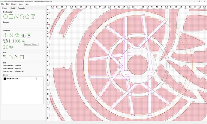

Opening the file we find:
Zooming in we get:

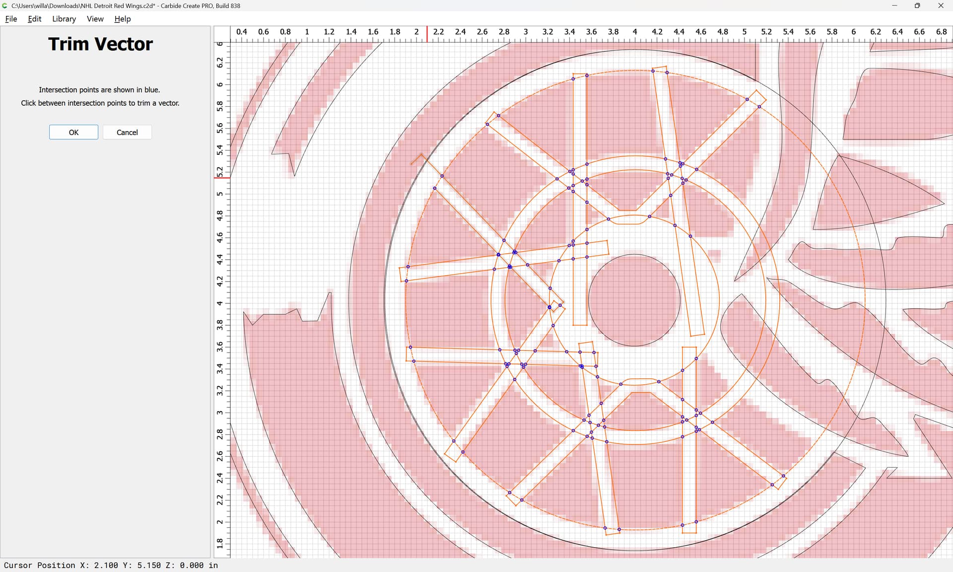

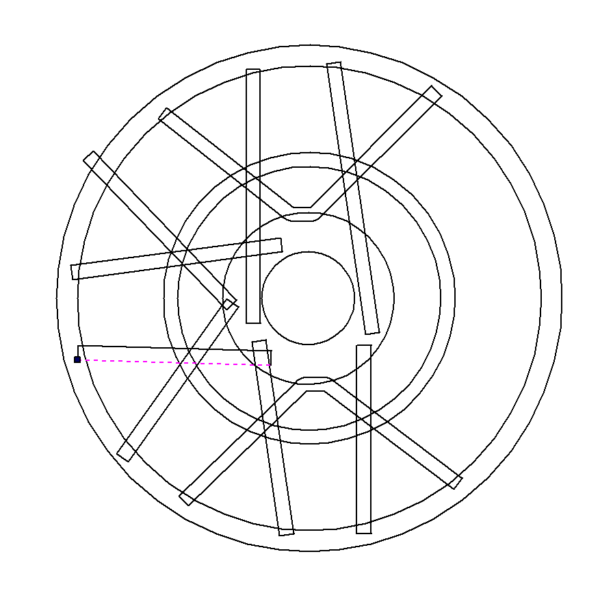

Ungrouping where necessary:

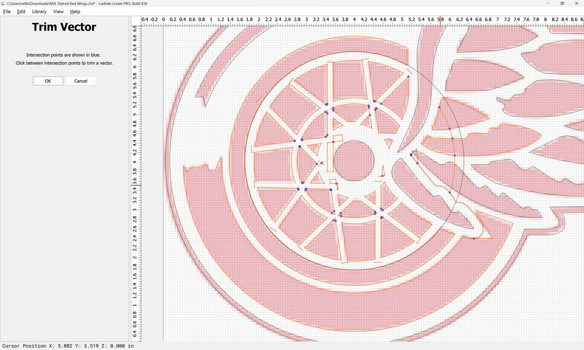

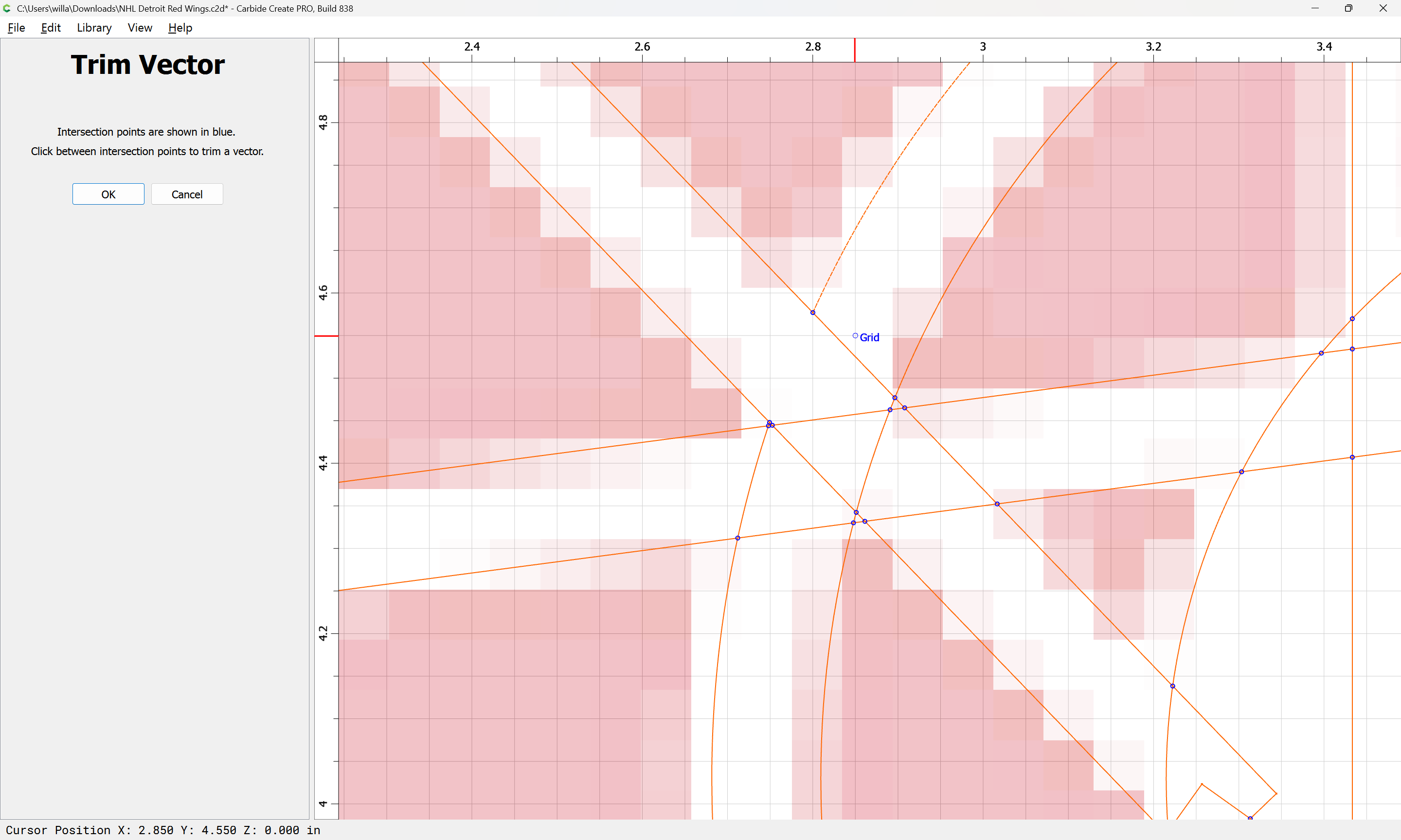

we select the geometry in question:

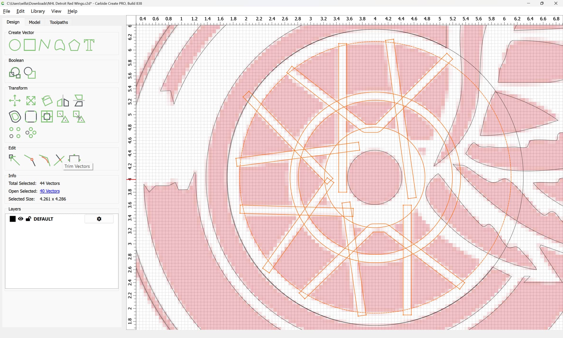

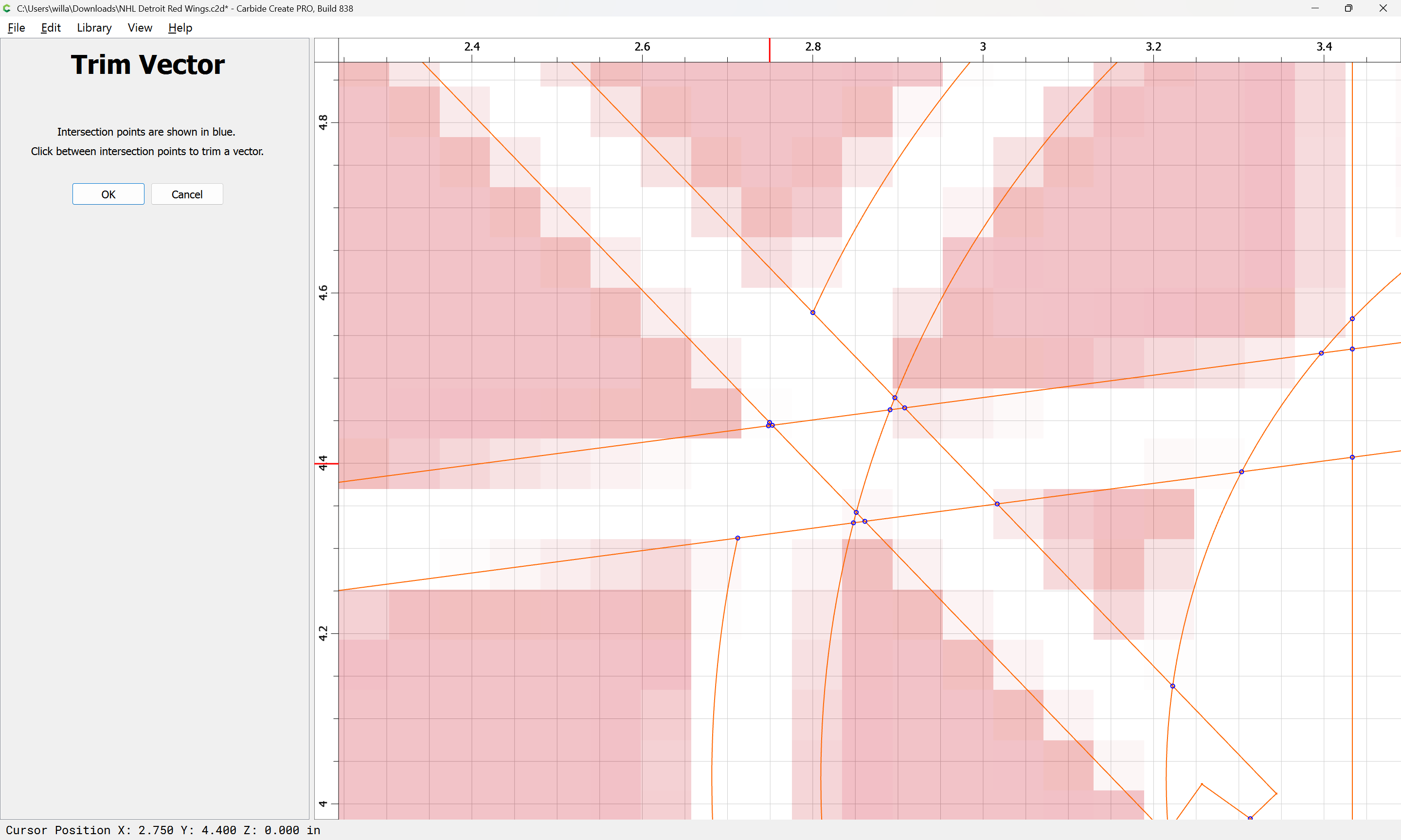

and use Trim Vectors:
to remove what is not wanted:

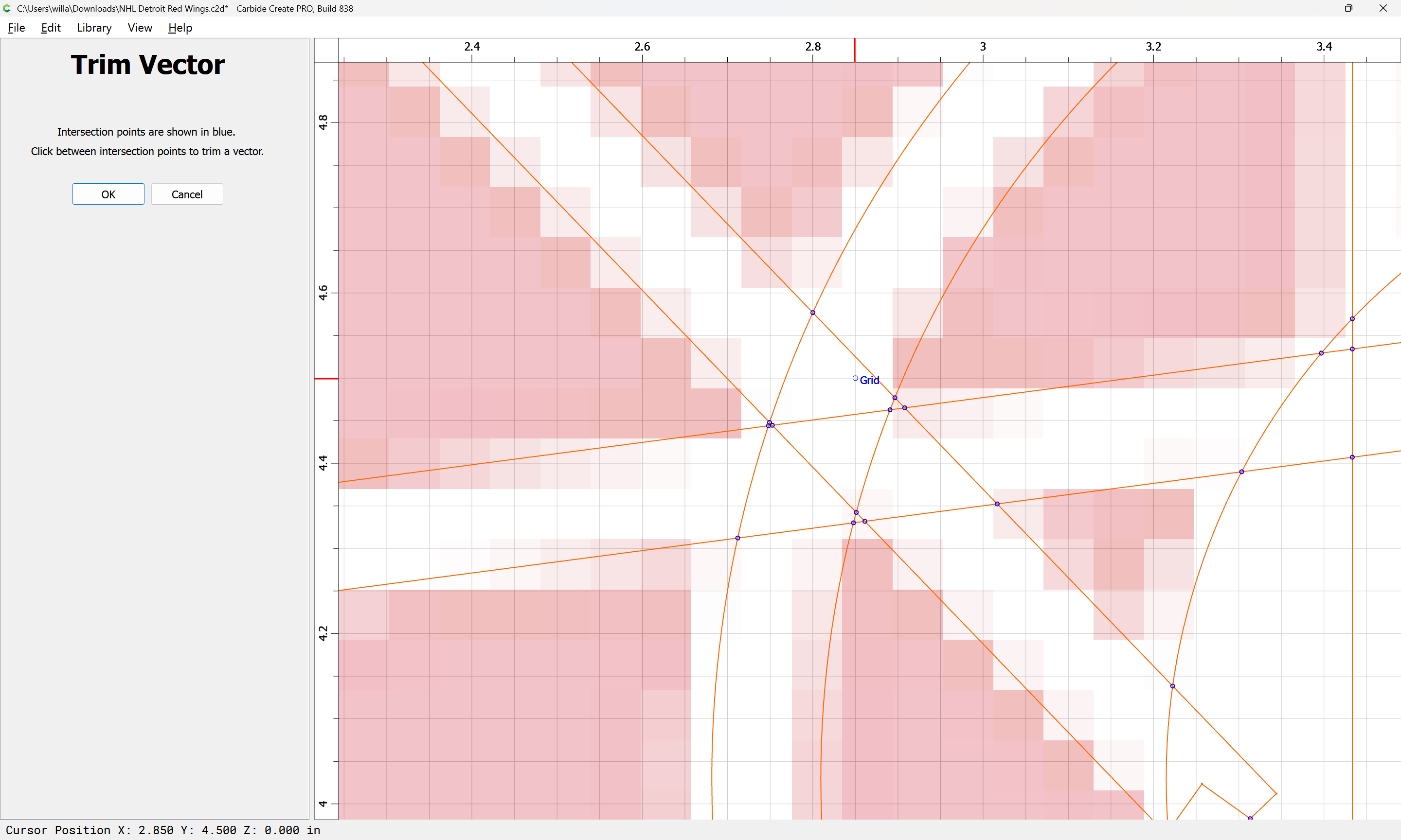

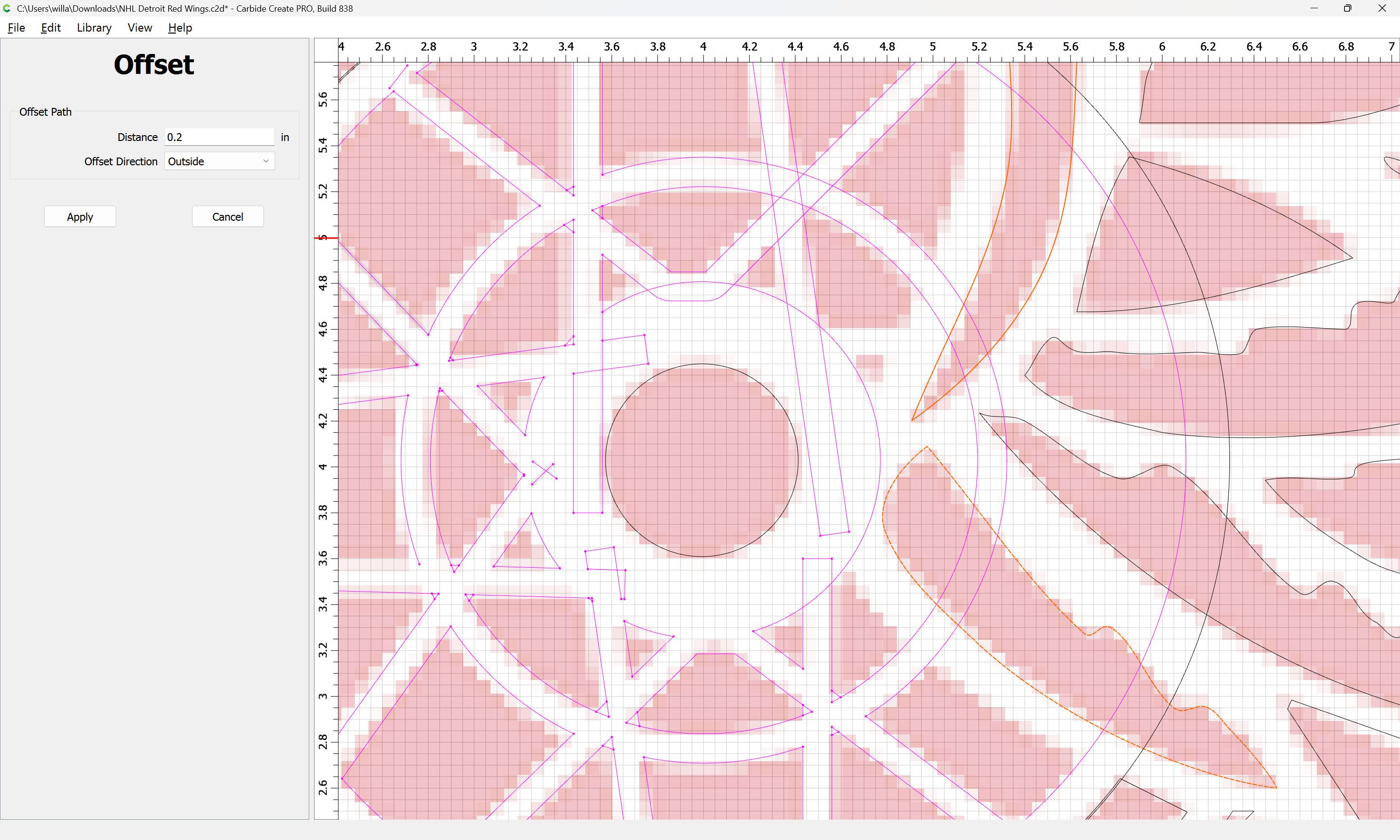

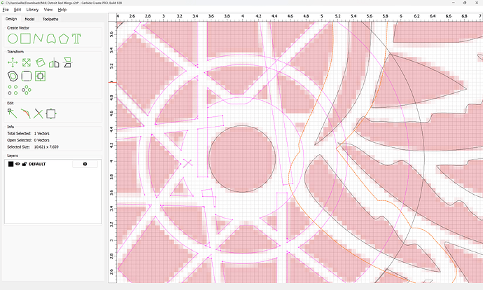

Zooming in where necessary:

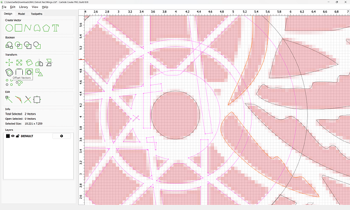

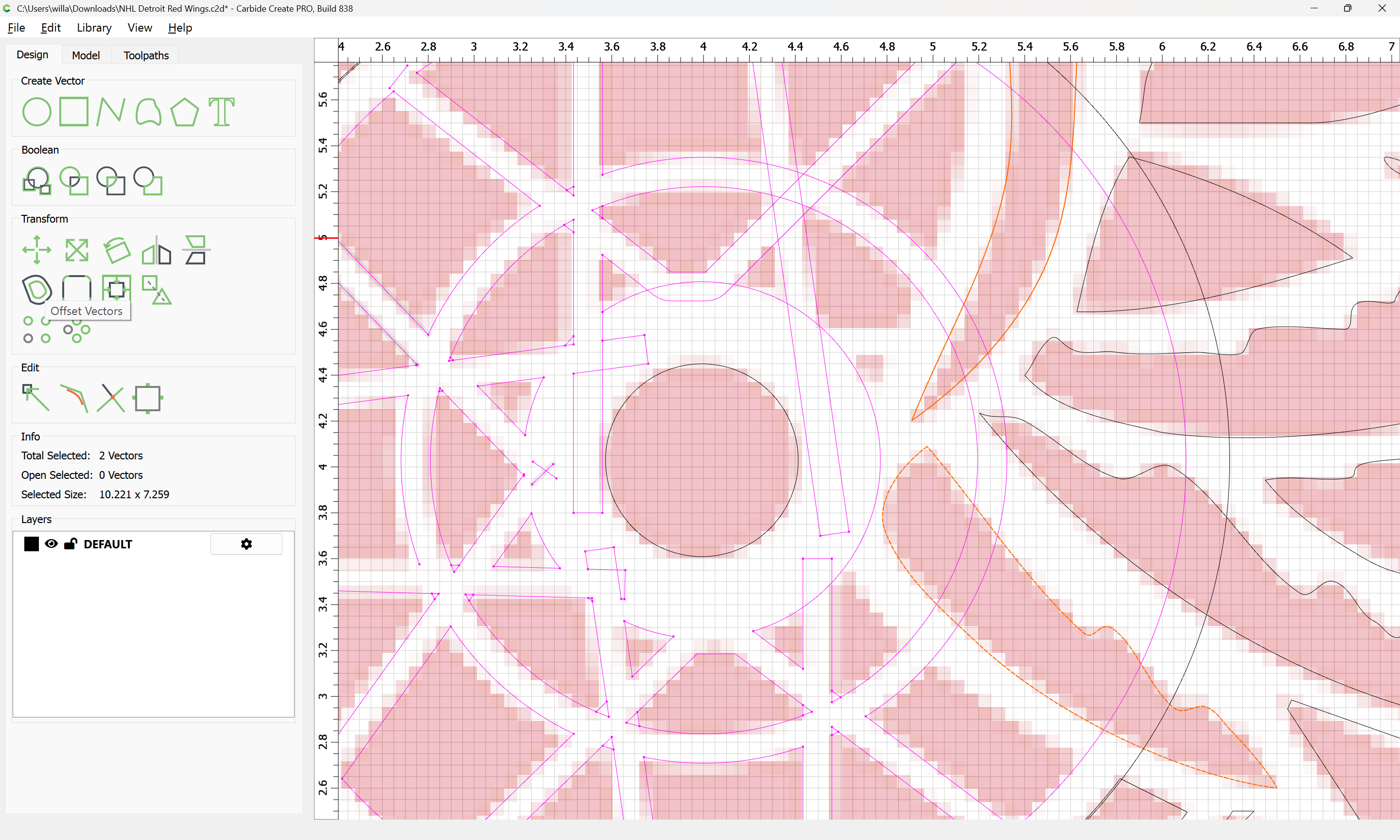

If need be, select geometry and offset:

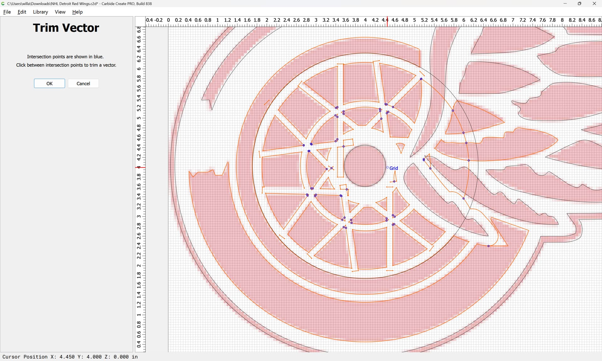

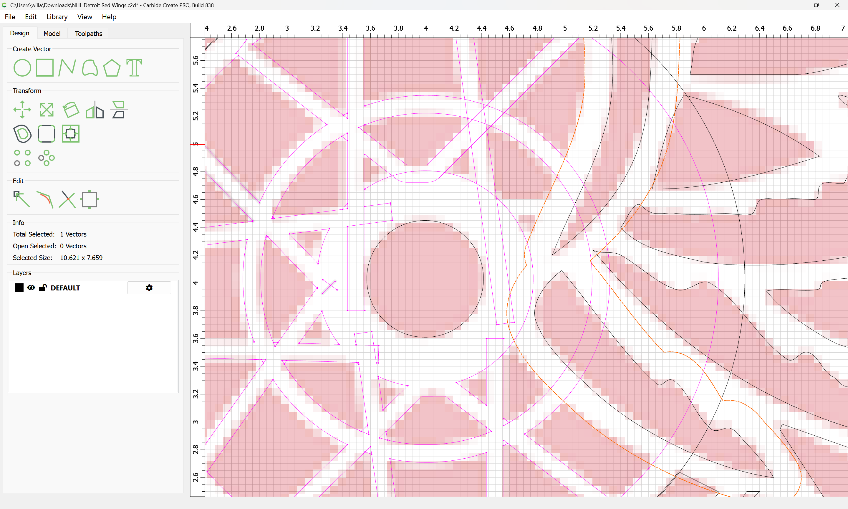

or draw in additional geometry adding to the areas which one is trimming continuing until one arrives at:
Clean up and delete where necessary:

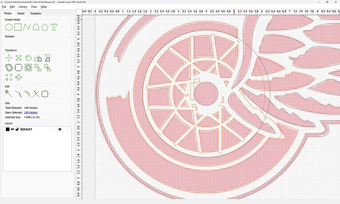

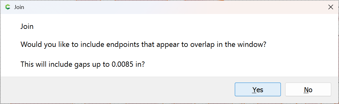

Then use Join Vectors:
Attached as a v8 file.
NHL Detroit Red Wings_v8.c2d (288 KB)
wheel spokes
I think I would pocket the spokes separately from the circular wheel vectors, that is, two separate tool paths. just trim the spokes as needed.

When i select the design to pocket, it selects everything that would be red. Is there a feauture that would do the reverse and pocket all white.
I mean, it selects it all perfectly, i want to hit 'opposite ’
That problem is Figure-Ground Reversal:
Offset to the outside or remove the outermost perimeter from the toolpath.

I selected the second most outer perimeter line and then pressed shift and added everything else inside that line. It worked. As far as this project is concered, it worked.
