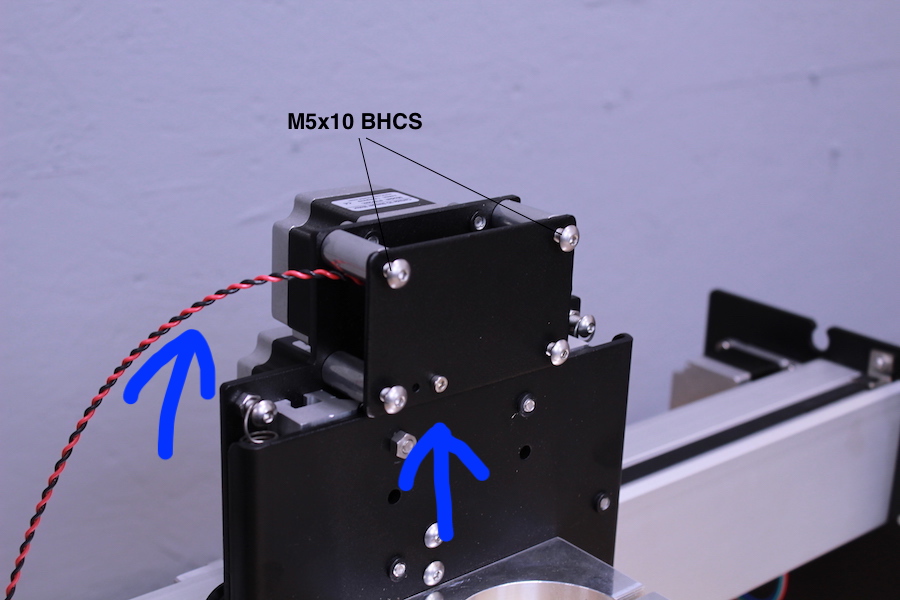

Also looking at the website of the space there is a picture of the Shapeoko where there is black and white wires running along the axis maybe there used to be limit switches on it? https://www.heliosmakerspace.ca/space-and-equipment
The reason i say there is no limit switch on it is because when i go Z+ all the way it just slams into the top.
The switches which are provided w/ Carbide 3D kits are configured as homing switches only — soft limits are implemented when jogging in CM4, hence the terminology confusion.
Some of the 3rd party kits work as hard limit switches — but if doing that sort of thing one wants to use shielded wiring.
The pictures everywhere are not great, if you don’t know where the plate goes. Follow the wire with the blue arrow, it’s the only pair twisted like this in the area (up behind this plate). The switch itself is located at this screw (the other blue arrow) - the screw holds the switch in place.
