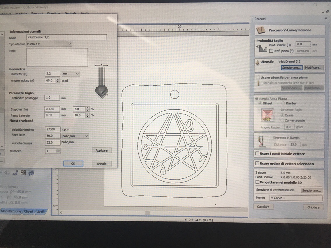

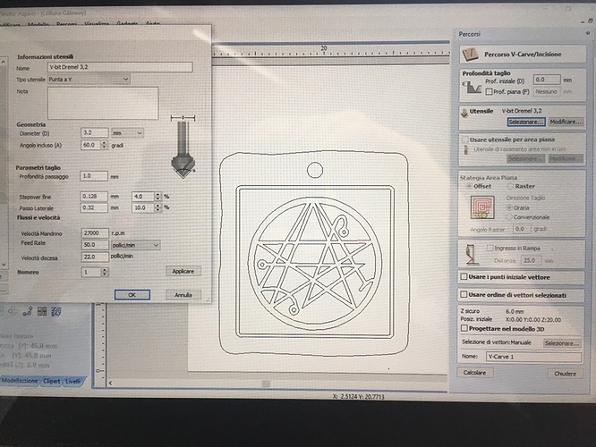

Hello guys
I need your help…some hints…maybe i’m doing something wrong but i don’t understand what…
I’m trying to V carve this
Just the inner circle + the inner square ( 2x2 cm)
I’m using this bit from Dremel n° 118 ( https://www.dremeleurope.com/it/it/fresa-ad-alta-velocità-3-2-mm-95-ocs-p/)
Aspire --> Motion
DeWalt Router 27.000 rpm
Poplar Plywood
This is the result
I have tried many different speeds/feeds but the result is still the same and i don’t know if it is my fault (bit-settings) or wood fault!
I know plywood is not the best … but it is impossible that i can’t reach a nicer result
Any suggestion?
Thanks

Your cuts parallel to the grain are fine. Across-grain or diagonally, not good at all.
That would indicate a problem with your bit and/or material. Plywood is difficult, those veneers can be very thin and even the most experienced woodworkers need to use the sharpest tooling to prevent tear-out.
I’d investigate another bit to start.
Is your project size 2cm x2cm?
My first comment would be to clean up and smooth your vectors in aspire for something this small using node editor mode.
A 60 degree bit is too wide for detail work that small. Use a downcut v bit if possible. Try a 45 or 30degree bit.
27000 RPM is too fast for this toolpath at your feed rate. Try 16000 or 12000 if your Spindle goes that low.
If you want a smooth burnished surface, slow your feed to 25 ipm and increase your DOC to the max depth of cut. If you get burning, increase your feed speed by 10% until it no longer happens.

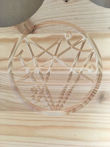

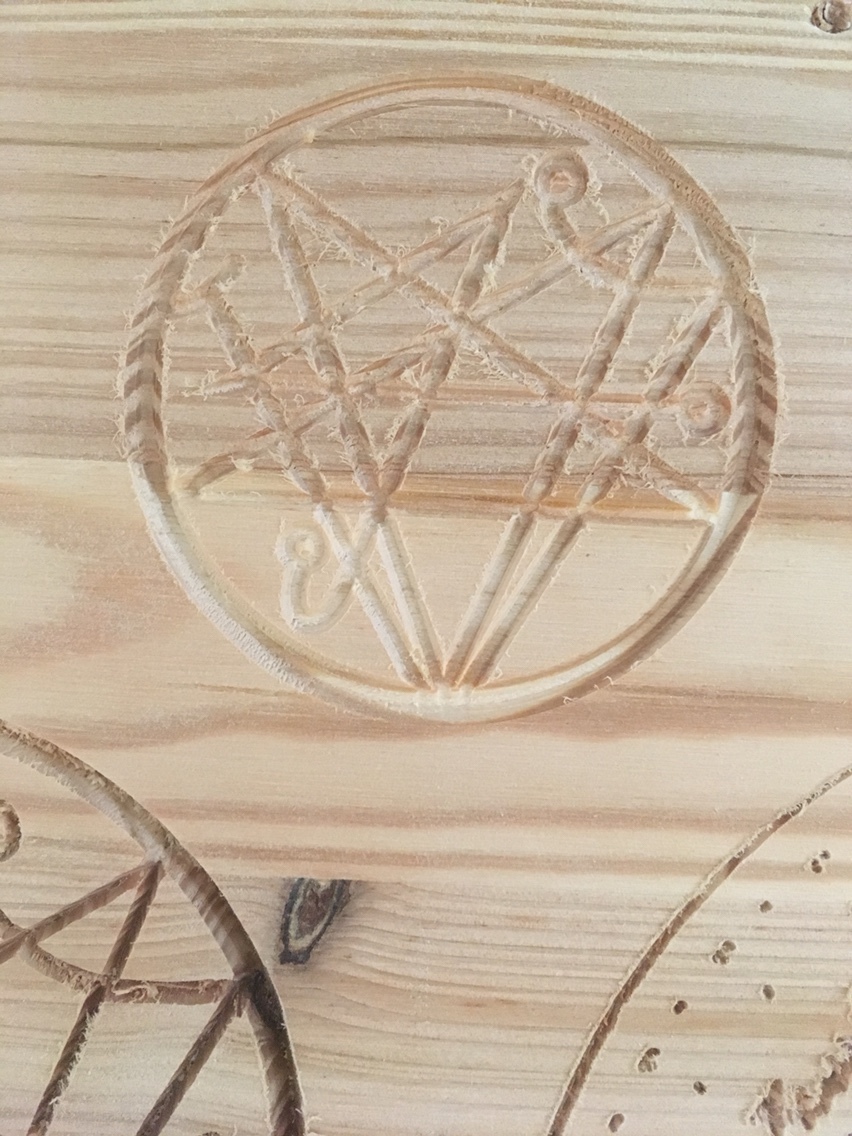

So i changed something… :slight_smile:
-Pine
-Bosch V-Bit 90° (the only other v bit i have now) 3/8’’ Wide - 1/2’’ tall
-Dimension of the drawing 15cm diameter
-DOC 1mm
-Feed 25 ipm (+30% on motion)
-Speed on router 27.000rpm but on Aspire is set on 16000…does this make any changes??? i simply turn on-off the router and set speed manually with its trimme…r
this is the result …soo good, very smooth cut

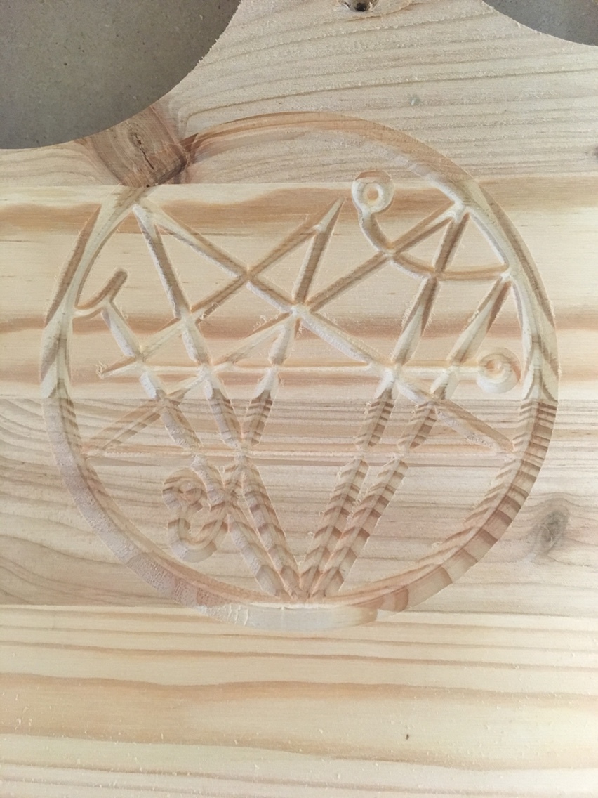

Same settings but on smaller drawing - 6,5cm diameter → bad result
I’ve changed DOC and Feeds but i can’t reach a sharp result as the 15cm diameter one
is that because it is too small for the bit i use? or i’m doing wrong settings?
Thanks

For smaller engravings you want a sharp end.
http://www.ebay.com/itm/60-degree-angle-x-1-4-carbide-bits-engraving-and-scoring-tool-2002-2500-060A1-/381670022842?hash=item58dd4e5eba
You can see a flat area in the smaller one, your v bit may have a flat spot or the tip may be damaged.
If you have a flat by design on the bit, you will want to set it up as an engraving bit.
I would recommend a 45 degree or 60 degree bit on the smaller sized v carving.
Please note that wood is a living material and that cutting direction can matter — the piece with the good cut was one orientation, the problem was another, and both cut through the sapwood well, it was the harder heartwood which was the problem (and that only in one orientation).
Please look at: https://shapeoko.com/wiki/index.php/Climb_vs._Conventional_Milling
and the best way to get a nice cut in problem materials is to work out what a suitable roughing clearance to leave will be, then puzzling out whether the finishing pass should be climb or conventional direction, and using a nice, sharp endmill (some materials may warrant switching to HSS from Carbide).

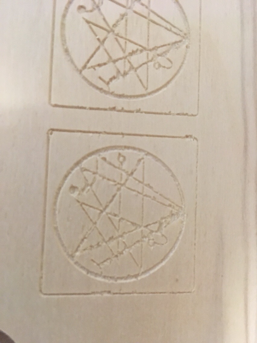

I’m doing more test on V-Carving (waiting for the delivery of engraving bits)

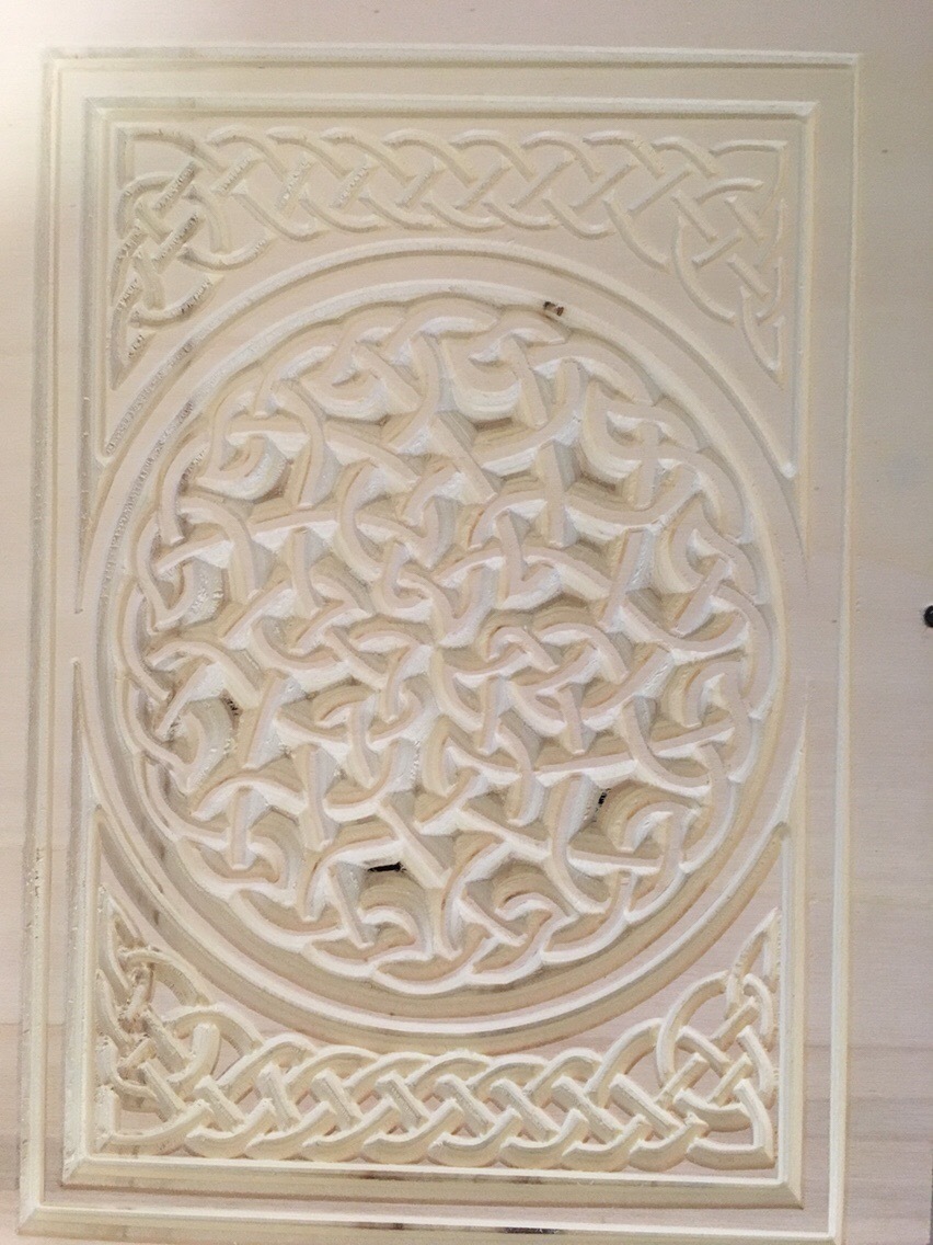

here the one of today
You can see at the bottom of the pic that the v carving is not so good…it goes to much deep…and destroyed the drawing :frowning: same thing you can notice for the external frame that is thin on the top right and deep on bottom…
I thought was because of the waste board leveling… in fact the deeper side is -0.7° and the opposite is -0.3
Is just because of this?? or there is more variables? (the celtic drawing is the same on both areas …copy paste…so it’s not vectors drawing fault)

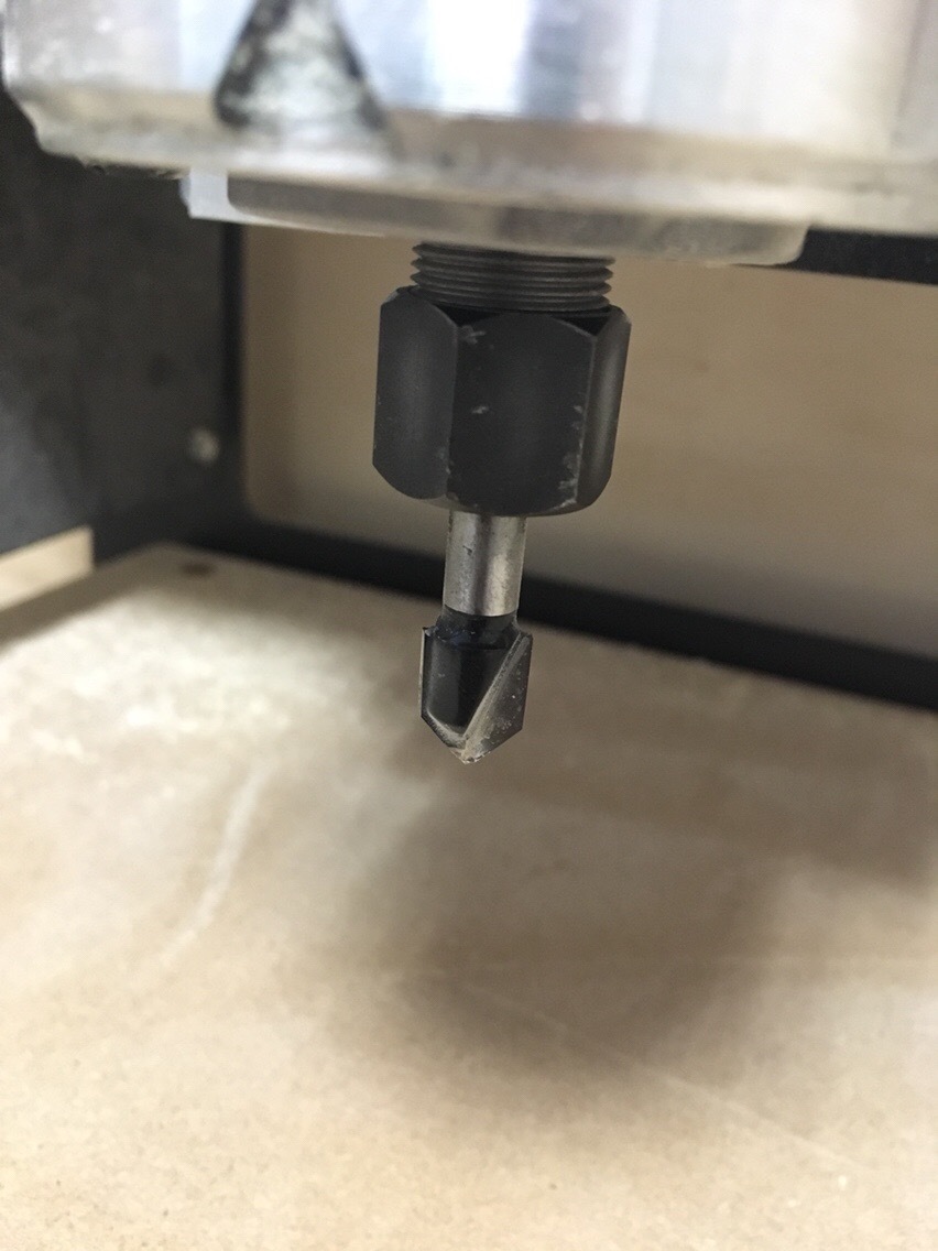

Here the bit i use

I would suspect lost steps due to insufficient belt tension in this instance.
Also check the V-wheels &c.
Just on Z axis? or all?
If you were losing steps on the X and the Y the image would be distorted in those directions.

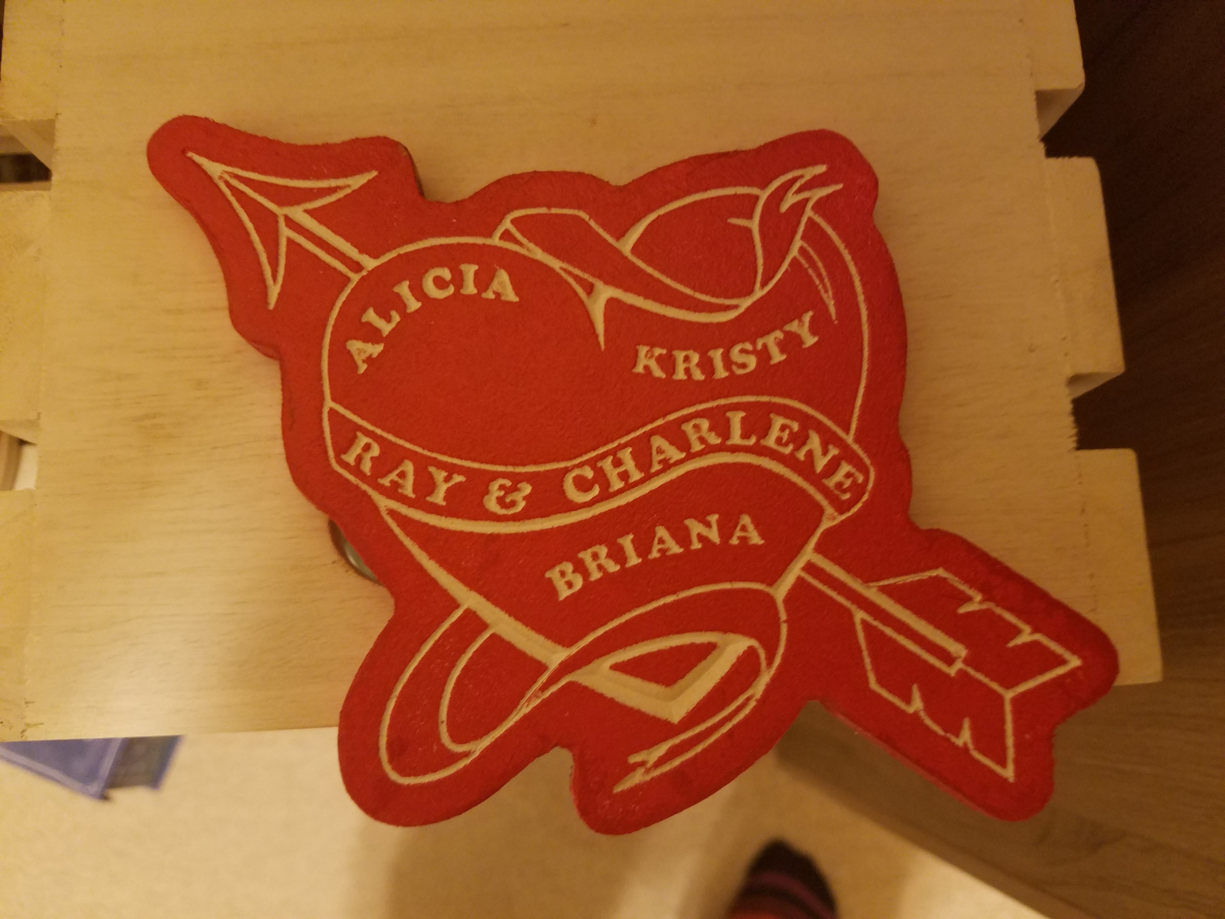

Before worrying that the issue is with the machine, you might want to look at the stock, too. I did a tracing/engraving in some 1/2-inch birch plywood strictly to test the tracing/engraving features in Fusion 360. In the 1/2 inch piece of birch plywood from Home Depot, the surface was so uneven that there were places the bit was cutting air. I ran the same job on a piece of much more expensive Baltic birch and it cut to depth without a problem (about a 40-minute job 16 inches in diameter). One of the things I really like about Fusion 360 when doing tracing/engraving is that once you bring in the SVG file, you select the toolpaths individually and separately. So if it didn’t cut deep enough on certain paths, you can go back into Fusion 360 and select just those paths, lower the Z and recut those on the S03 as a separate job. When I did the Home Depot plywood, I had to do that three times to get the entire area cut to depth.
With v carving, I highly recommend using a sub waste board and levelling it before beginning. V carving is tricky and made more difficult, if not impossible with an uneven work area.
This piece I tried first and the names were blended together because the board was out slightly.
You can see next to it where I flattened an area and then did the piece.
This piece is for my first granddaughter.
All these are MDF, which is the easiest material for v carving but I have done plenty of carving in mahogany also. G/L Ray
