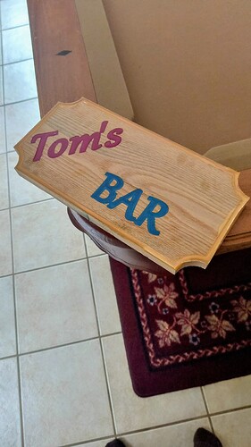

I have an ash board, pocketed with epoxy resin fill. I will McFly the surface flat. I want to glue .060 thick oak veneer then v-carve to get 3 colors . I plan to v-carve thru the epoxy to expose ash.
What glue and method to glue oak veneer. I think wood glues will not adhere to the epoxy. I think Wellwood contact cement is rubber based, I don’t know how that will mill.
If you already have epoxy down, the solution is more epoxy.
As a specific recommendation, I’d suggest finding your local West System retailer and snag the West System User Manual & Product Guide. I only recommend West System because I know their products and have a local retailer. Substitute “West System” for your locally available epoxy.
I would use West System 650. The 650 is a toughened epoxy that works incredibly well with red and white oak. It’s basically designed to secure anything to anything else and it can, technically, be used underwater. Somehow.
