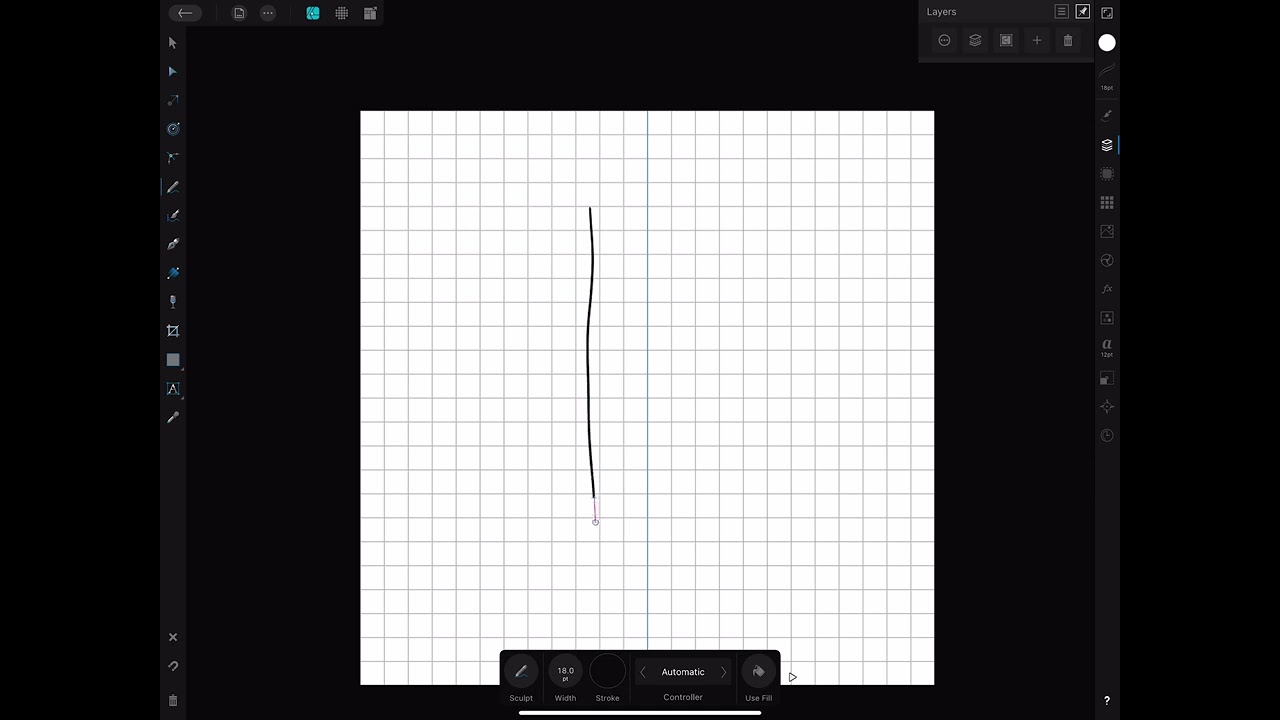

I completely see what youre doing and it makes all the sense in the world. but ive got a problem right off the bat. im running affinity on an iPad, I can’t see why this would create an issue but im wondering if it is. im going to send you a video that shows me fussing with stroke size and then making the line. you can see im in a 24 inch grid and that the .25 inch/18pt line created isn’t a full quarter inch. I think thats where my first problem starts. can you see how I’m ending up with a line so much smaller than .25? is it that im using the pencil and not the pen? yep. hold on one second, I didn’t go back and edit this response so you can see my thought process here. it appears that when I do all the same work with the pen tool everything comes up exactly the same as yours. same when I use the brush. pencil just throws the whole thing off. can’t figure that out at all.
heres the link so you can see what I was doing with the pencil and heres a screen shot of how brush and pen work exactly like all you guys have been showing me. thanks a bunch. now im off to figure out why the pencil behaves so much differently than the brush and pen when set at the same size.
