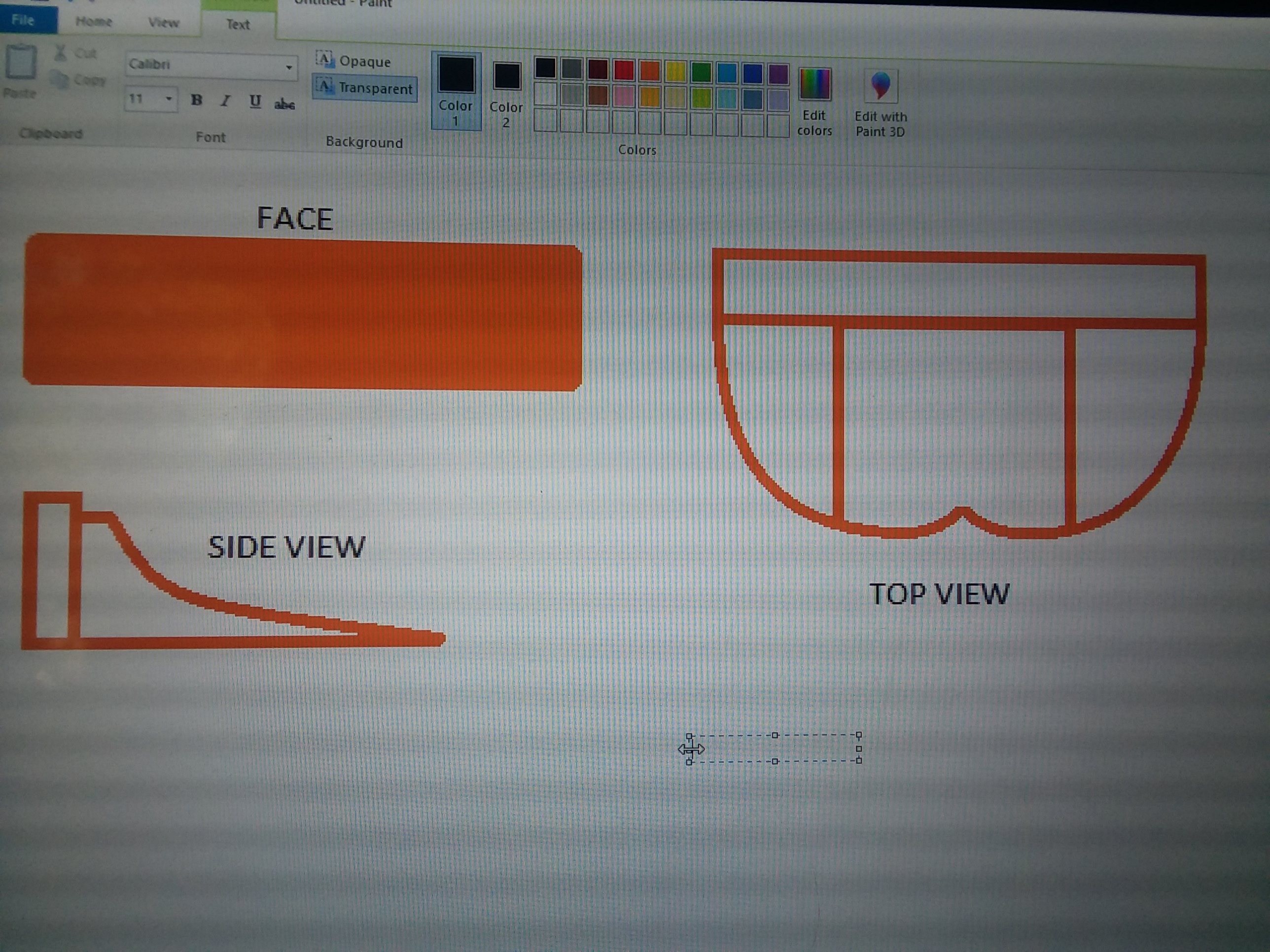

Thanks for the reply. I plan on doing something similar to this design. I would not say i am comfortable using fusion 360, just did some practice off youtube videos part of a 16 part series.
something like this ?

So I dove in deep with Fusion 360 over the past few days and have came up with a design for my golf putter. I originally was planning on putting the face down and then milling the entire putter from my aluminum bar. After designing it I see I may have messed that up by the arc bottom since the cutter wont be able to bend around it…sigh. I also messed up in putting my fillets in there before I was done designing so I had some troubles with that but think I got it mostly solved.

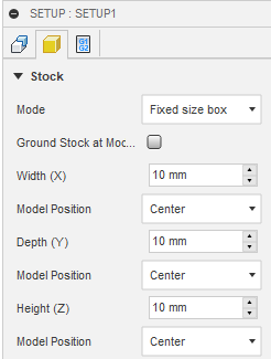

2 - My aluminum bar measures 110mm long x 64.6mm wide x 38.5mm tall, how do I put these measurements in the design so that it knows how to cut the putter out? I would like the project centered in the bar so that I can utilize the extra on the ends for hold down and also tabs.

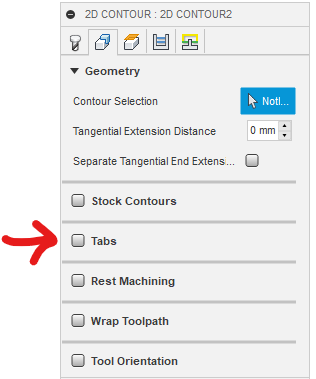

5 - How do I add tabs in Fusion 360? I figured I would put a few on each side so when I flip it over it will still be attached. I can file these or sand them off later during final hand finishing.

  2. Stock Setup–> Fixed Size Box image

  4. 2D contours have a checkbox. Otherwise, model them. image
