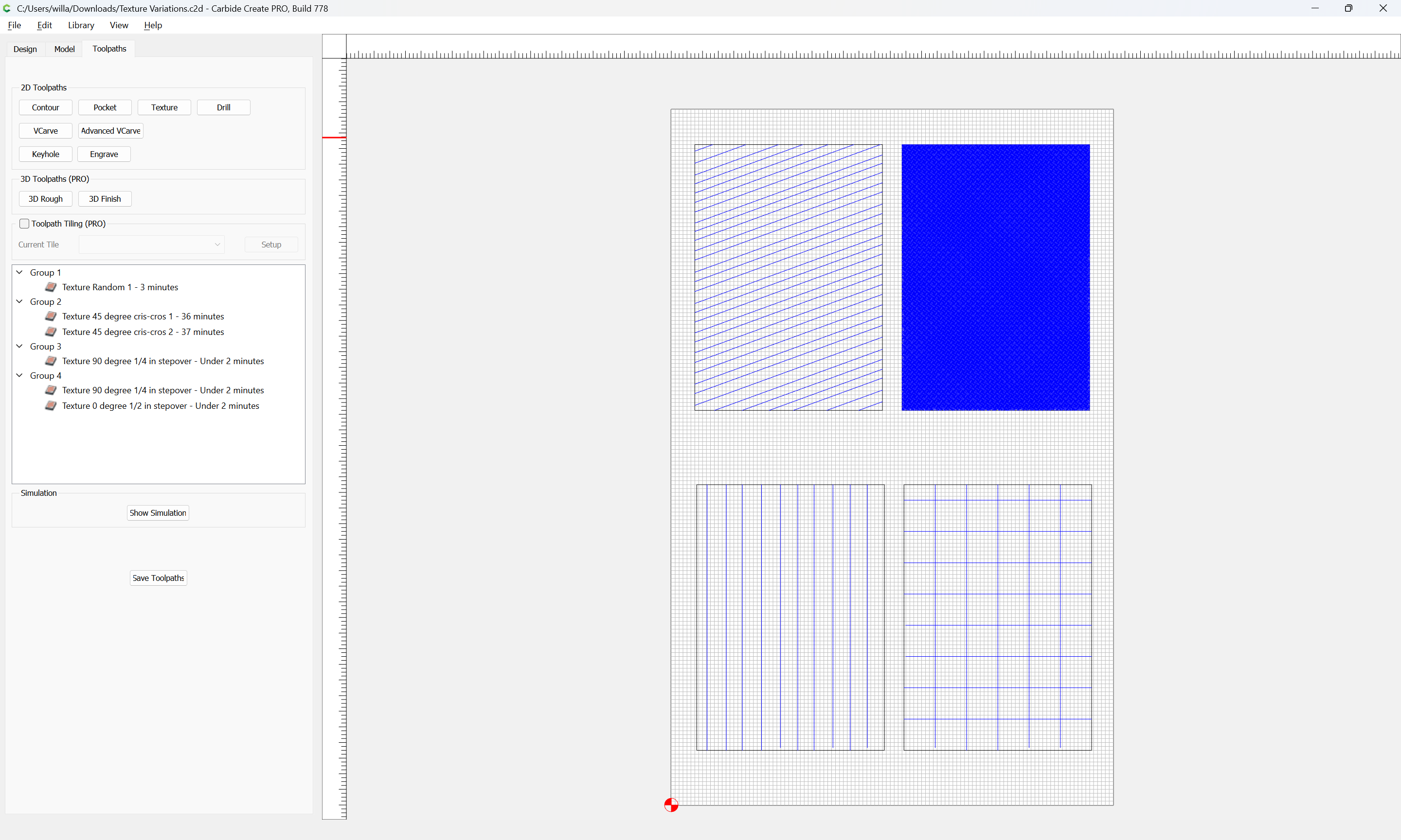

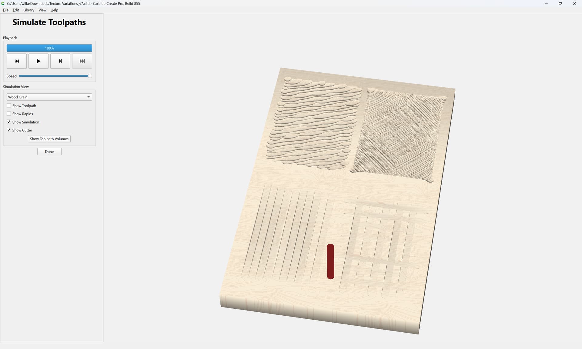

I’m not exactly sure if this is what you want, but it may point you in the right direction.
This is a file I had put together for those beginning to use textures.
Texture Variations.c2d (28.2 KB)

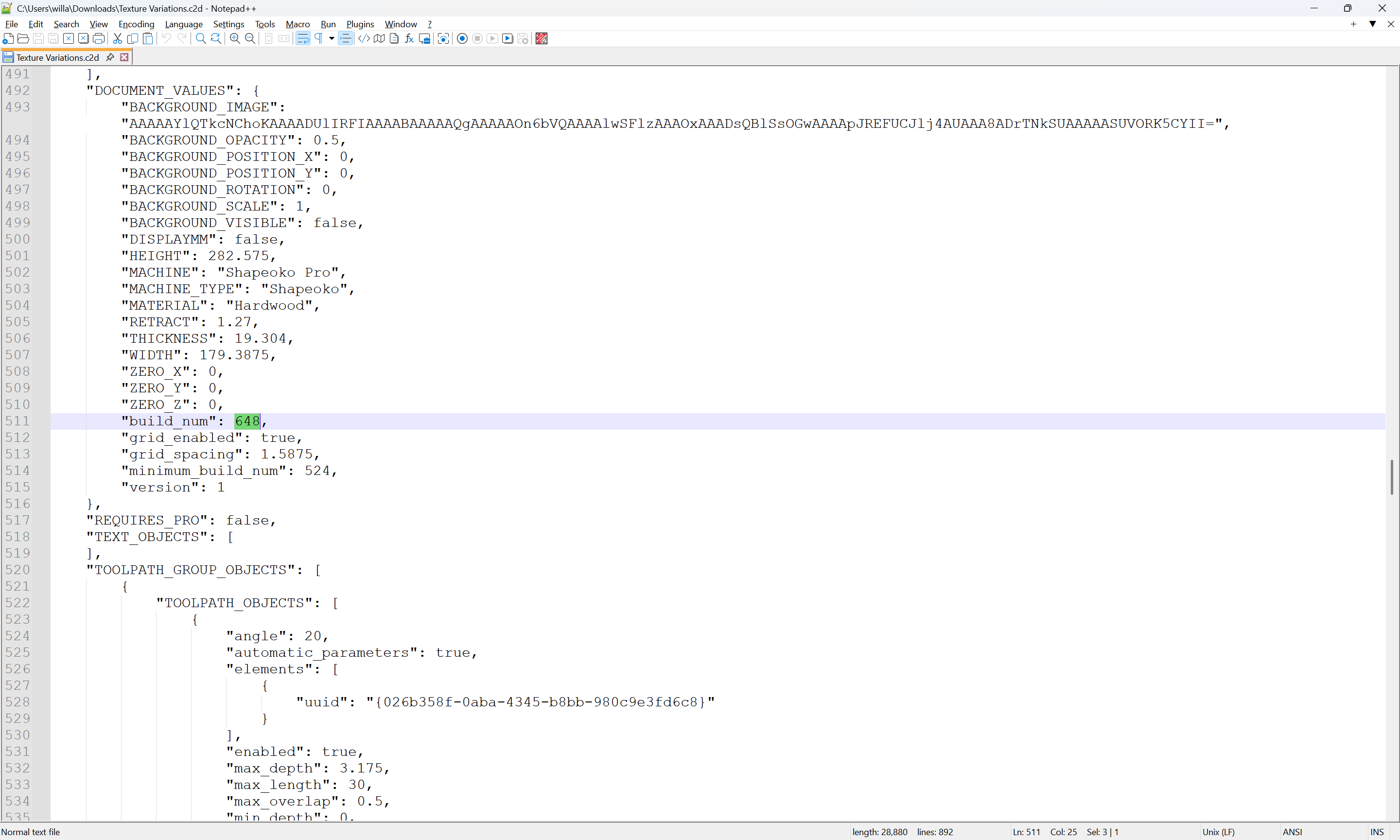

It’s a v6 file:
Open in v7:
re-save as a v7 file file:
Texture Variations_v7.c2d (180 KB)
then open in v8:
Thanks Will, very much appreciated.
