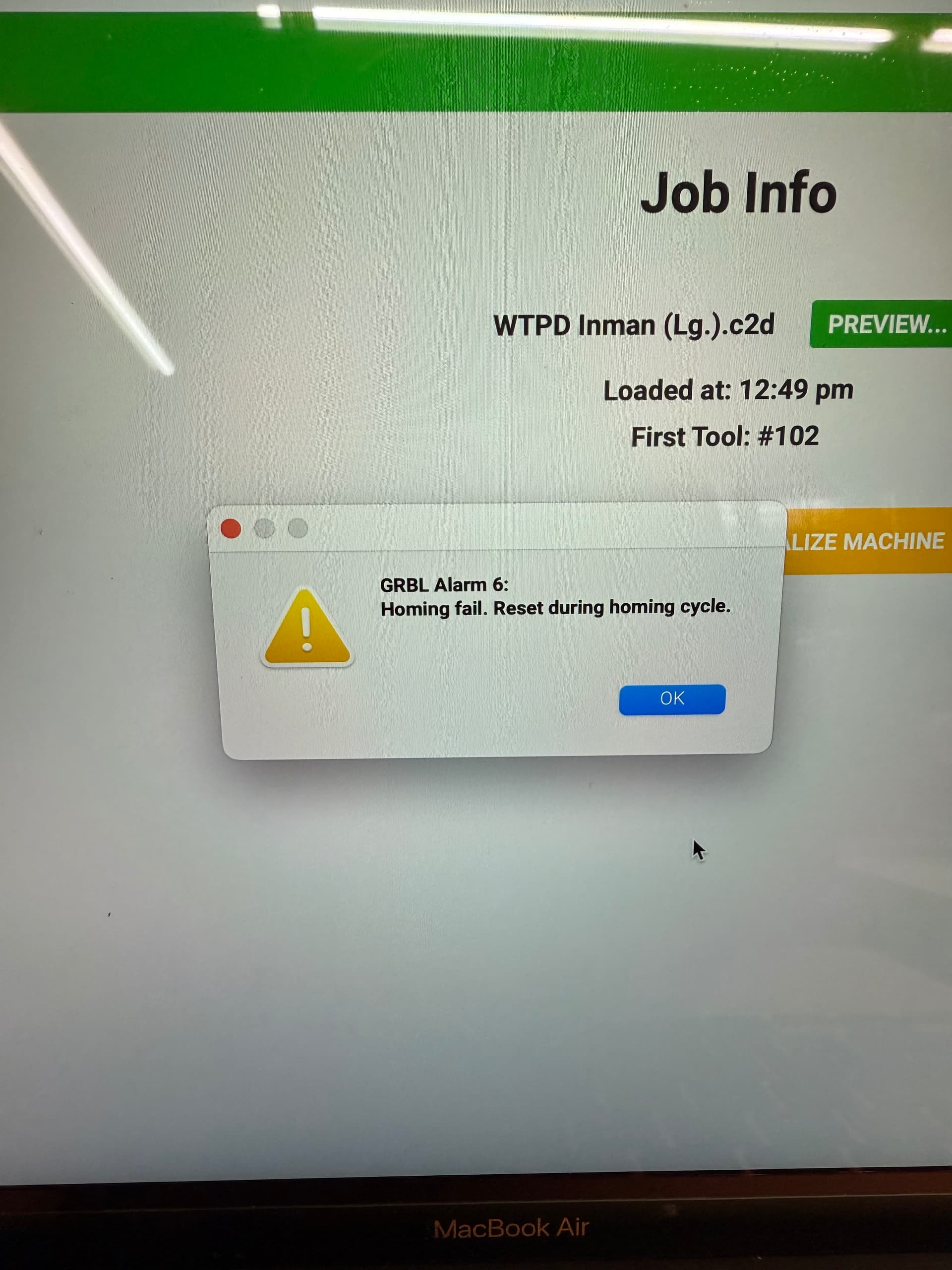

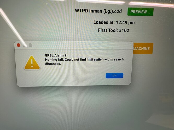

GRBL Alarm 9: Homing fail
Hello. I have been having issues for a few days with my Pro XL. When initializing the machine vibrates and makes a grinding noise. I have throughly cleaned it, re-lubed and greased and made sure all the connections are tight. Once I do that it’s smooth for a short while and goes back to the same thing. I am including a few pics and a video. Thanks for your help./Users/kennethkennedy/Desktop/IMG_3899.jpeg/Users/ken/Users/kennethkennedy/Desktop/IMG_3901.MOVnethkennedy/Desktop/IMG_3900.jpeg

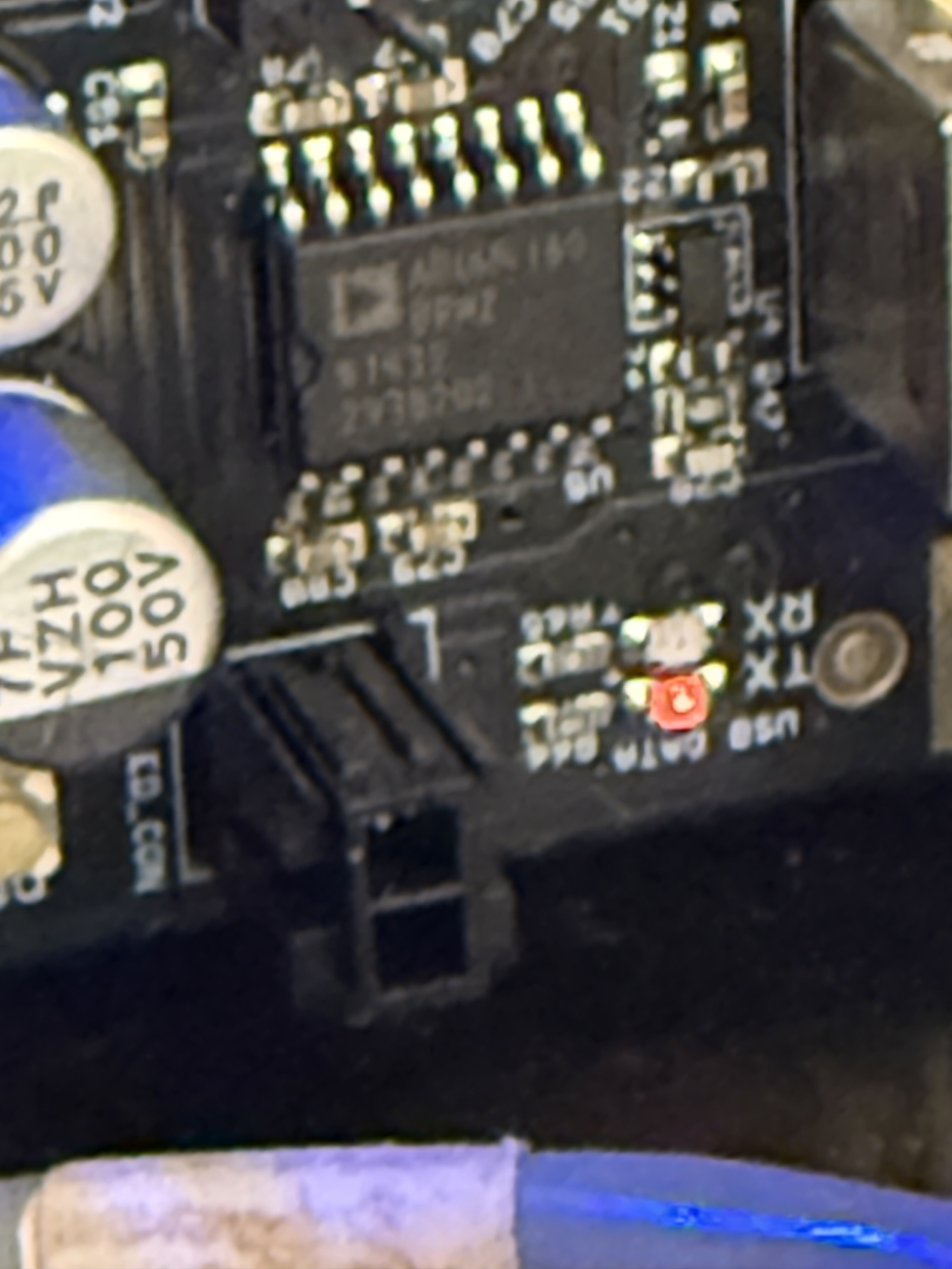

This light is blinking red
TX == transmission and is expected to blink as data is sent.

If it fails to trigger the Y-axis homing switch this would be because:
  • the Y-axis homing switch is bad
  • something is mechanically blocking the switch from being triggered
  • the Y-axis switch is positioned/secured so that it cannot be triggered.
