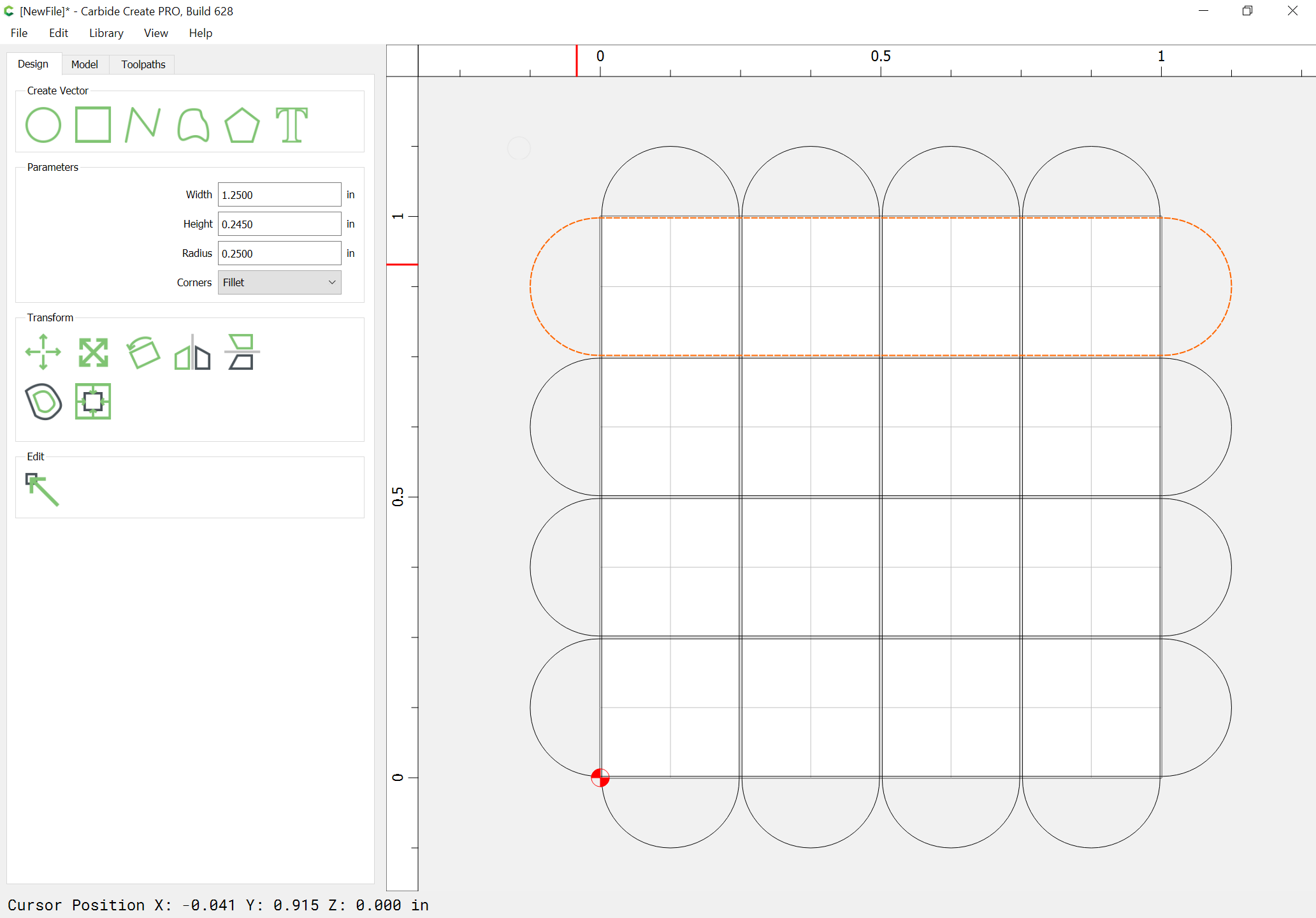

My name is Evan and I am new to carbide and CNC in general. I am looking to make a grid pattern with a v-bit and am able to draw it up how I want it done but am struggling with setting the tool paths. I am able to make the tool path for the outside of the box but can’t seem to get them going for all the lines within the box. I am looking to make a meat tenderizer type of pattern. Any help would be greatly appreciated.

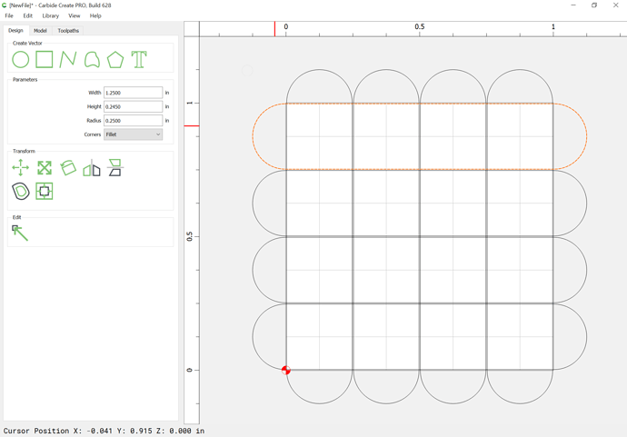

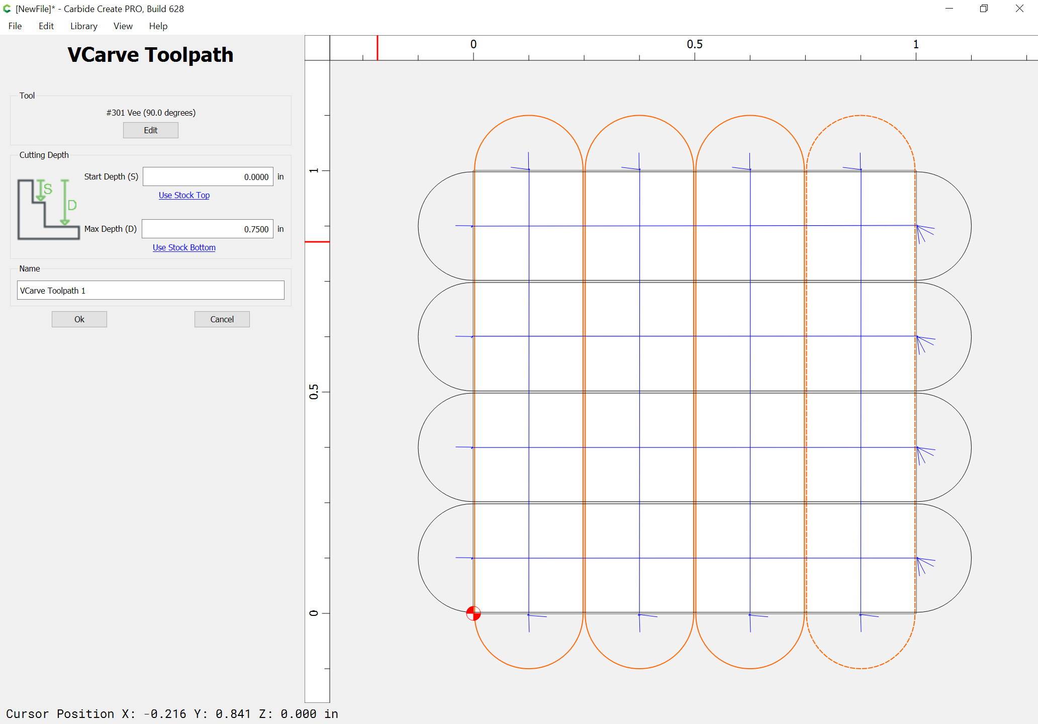

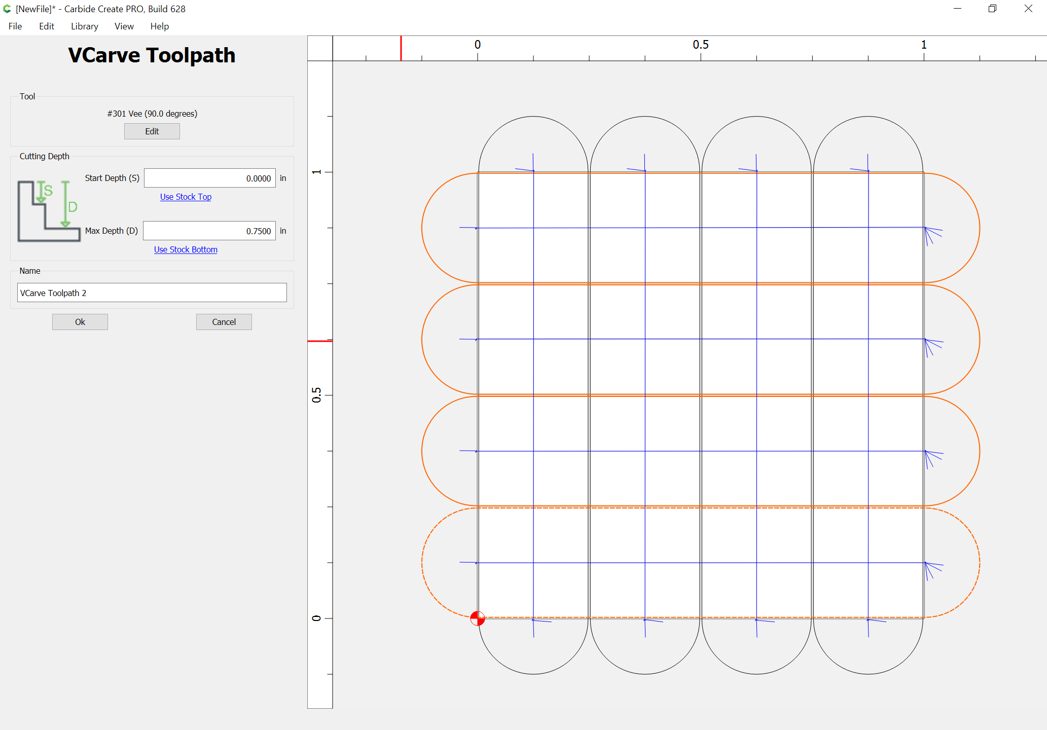

The best way to do this would be a series of rounded rectangles, which are as wide as is necessary to cut as deeply as desired, but which don’t overlap:
Or you can do it this way.

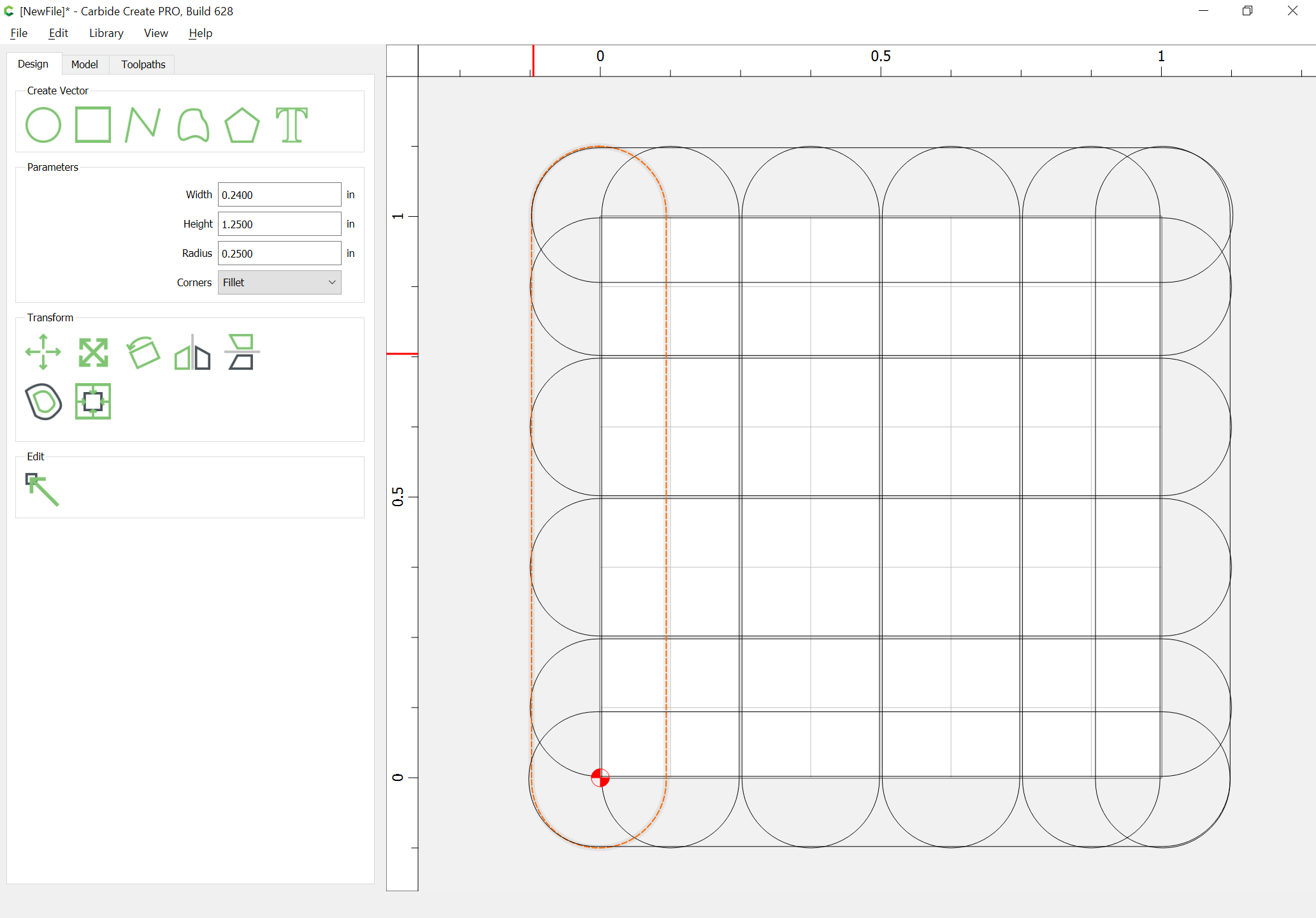

So I got this far, but am stuck on how to smooth out the border? I’d like it to have a v-groove all the way around but every time I try to do that, the tool path shows doing a big “X” right in the middle. Any way to have it not do that?
I think you need to draw two rectangles, that will be the inner and outer edges of your border. Select both, and do a VCarve path on that, so that it VCarves the area between the two rectangles.
Unfortunately, a pair of nested rectangles won’t work — they will overcut at the corners — it might work w/ an Advanced V carving, but it’s just easier to use more rectangles:

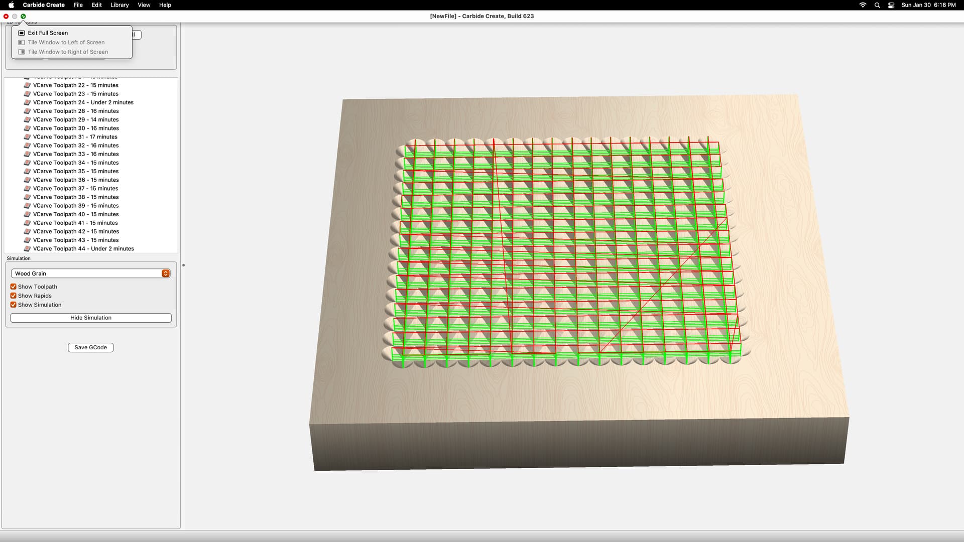

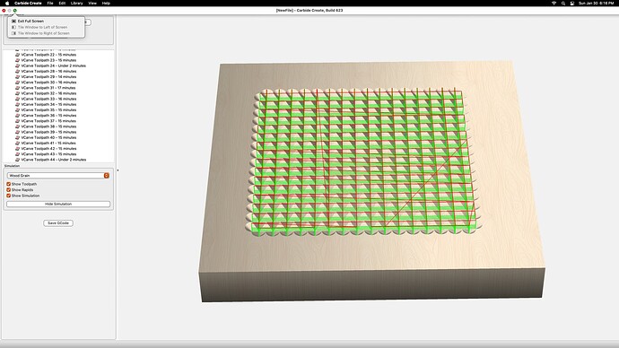

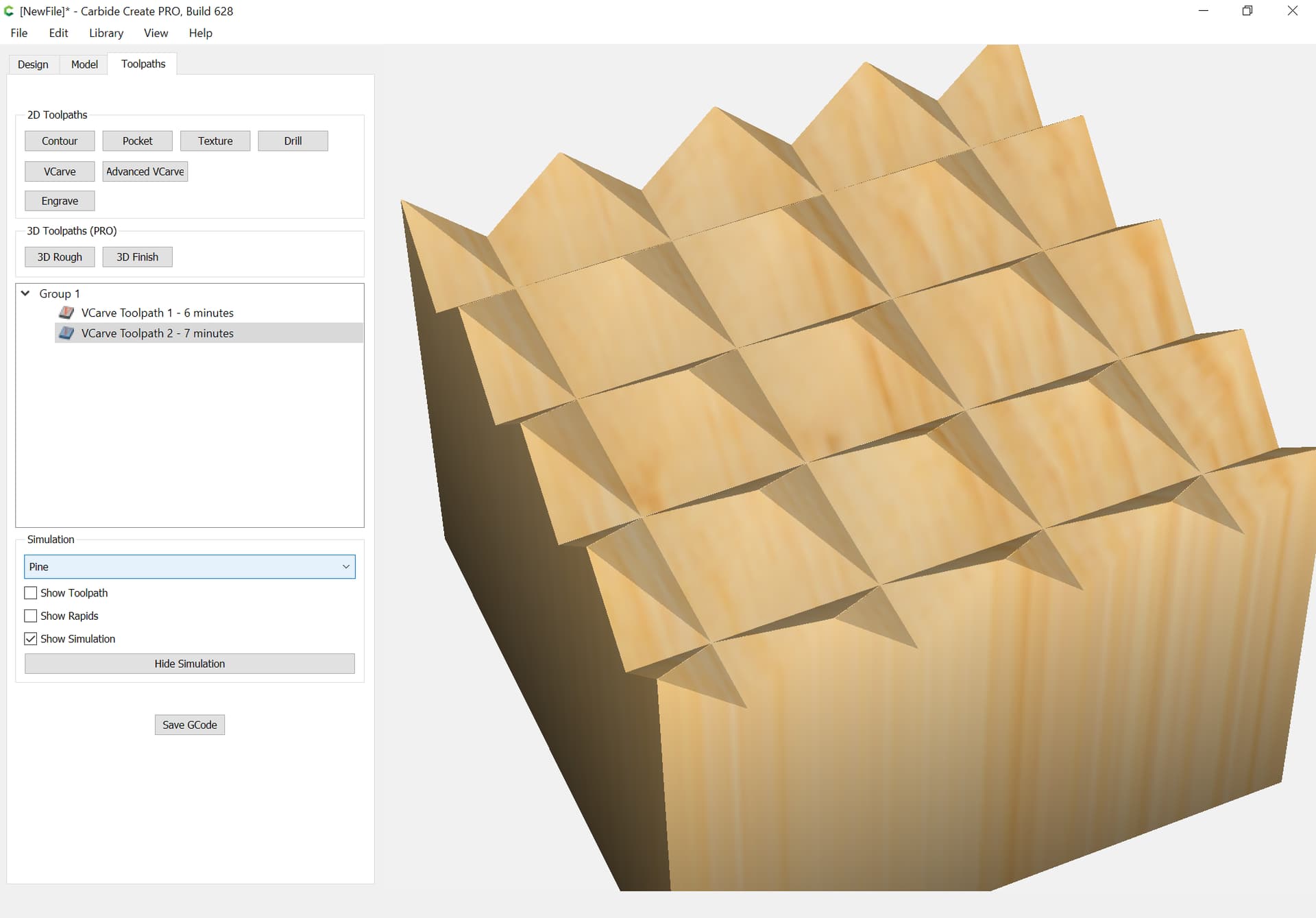

I made a grid for mine setting the stock size to the size of my wastboard and grid spacing to 1 inch in CC. then used polyline tool to just follow the grid. Is there a benefit to the way you have done it here? also I am guessing this is not a grid for the spoil board since it looks like you are cutting fairly deep, just curious.

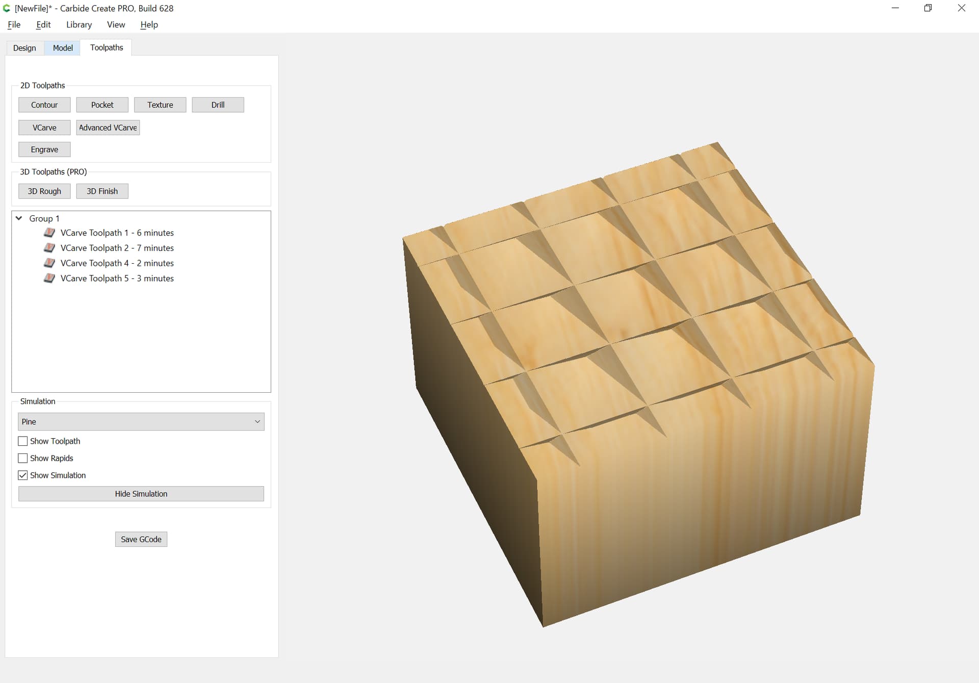

Using the separate rectangles and V carving toolpaths allows for an accurate 3D preview.
