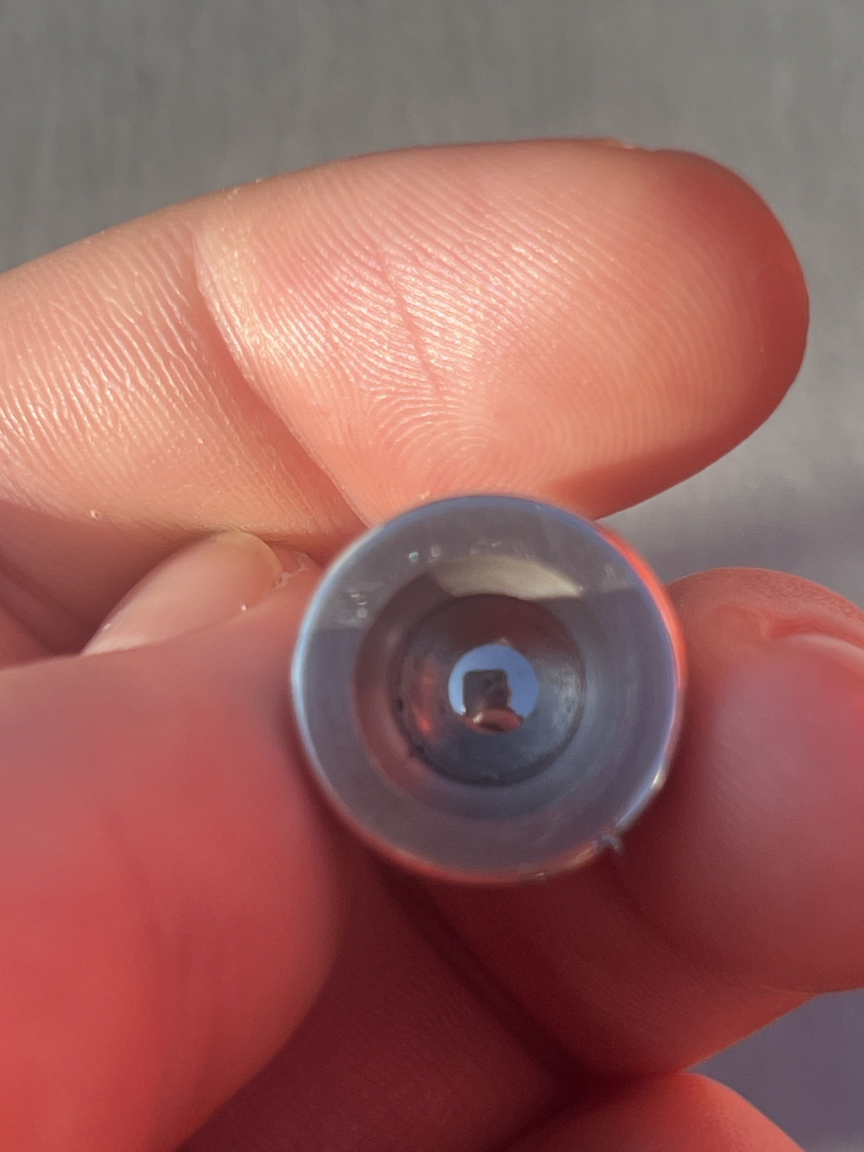

You see, I’ve got a mechanism which requires a really solid connection between a magnet and a ball bearing. Problem is, I can’t find magnets with spherical inset shapes. Plenty of countersunk shapes but no spherical.
After a whole lot of searching and reading so. many. posts. stating that shaping magnets is a fools errand…I gave up and said screw it I’ll do it myself.

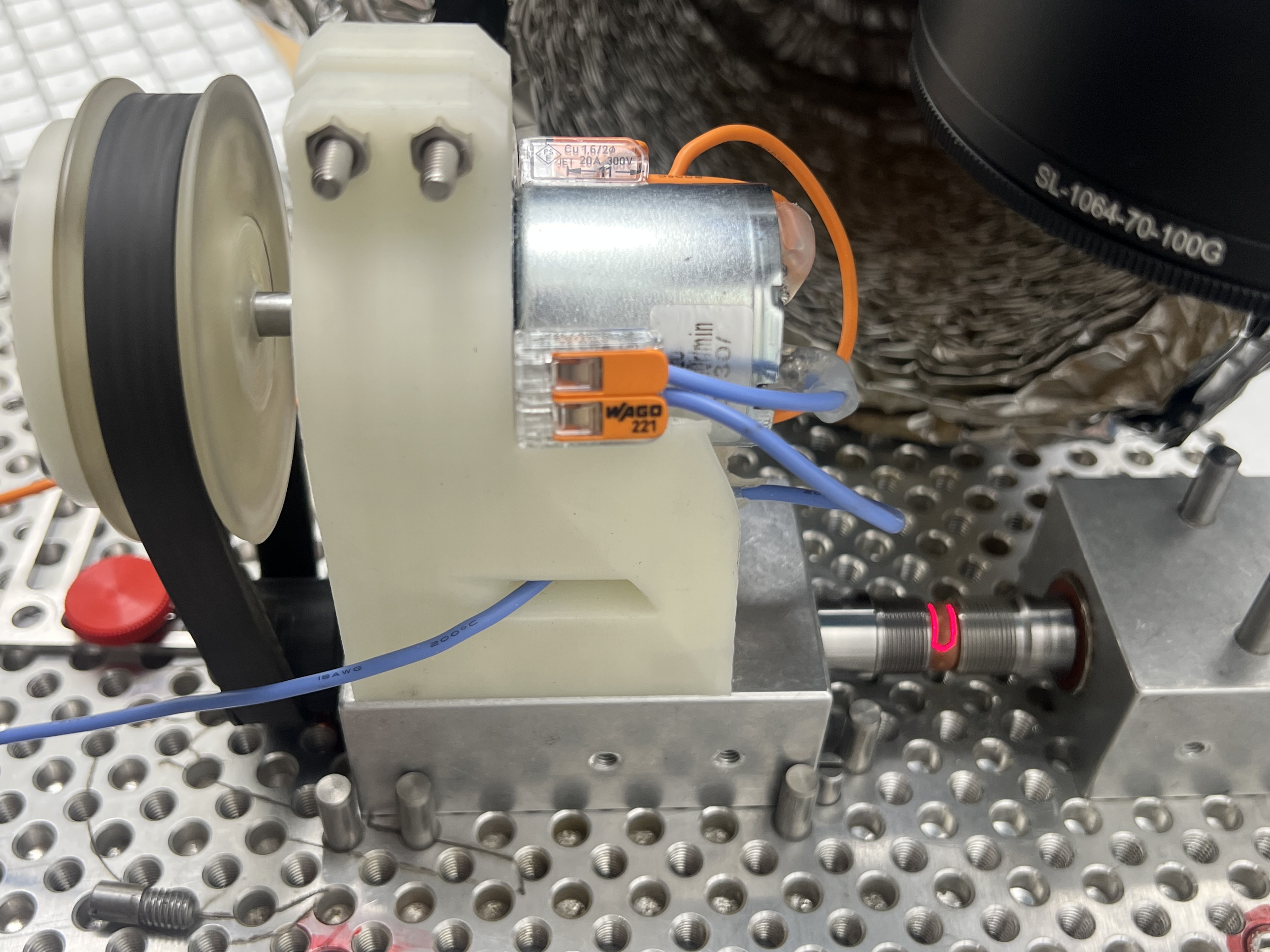

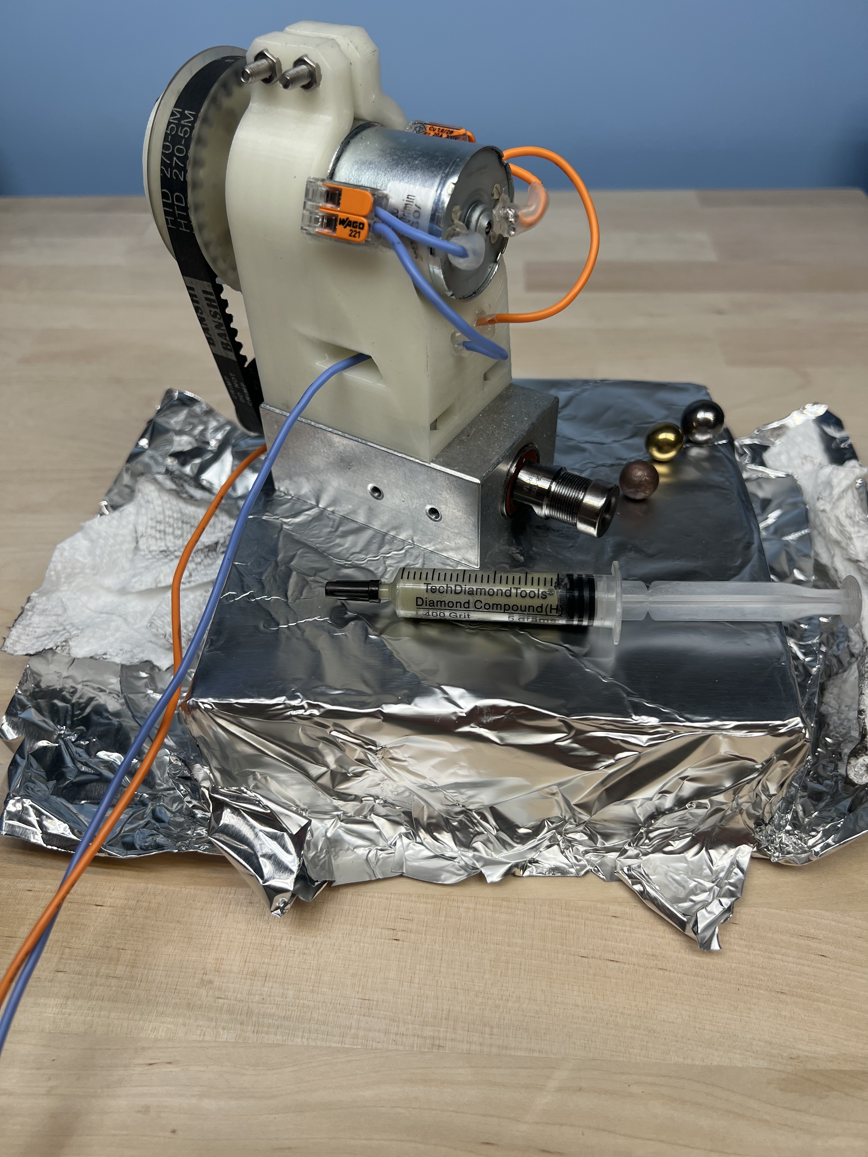

The prototype was made with the first of my blown up nomad 3 spindles. (We’ve seen this little monster a few times before)
Basically just a platform to turn things in a relatively precise way along an axis.
High torque dc motor geared down.

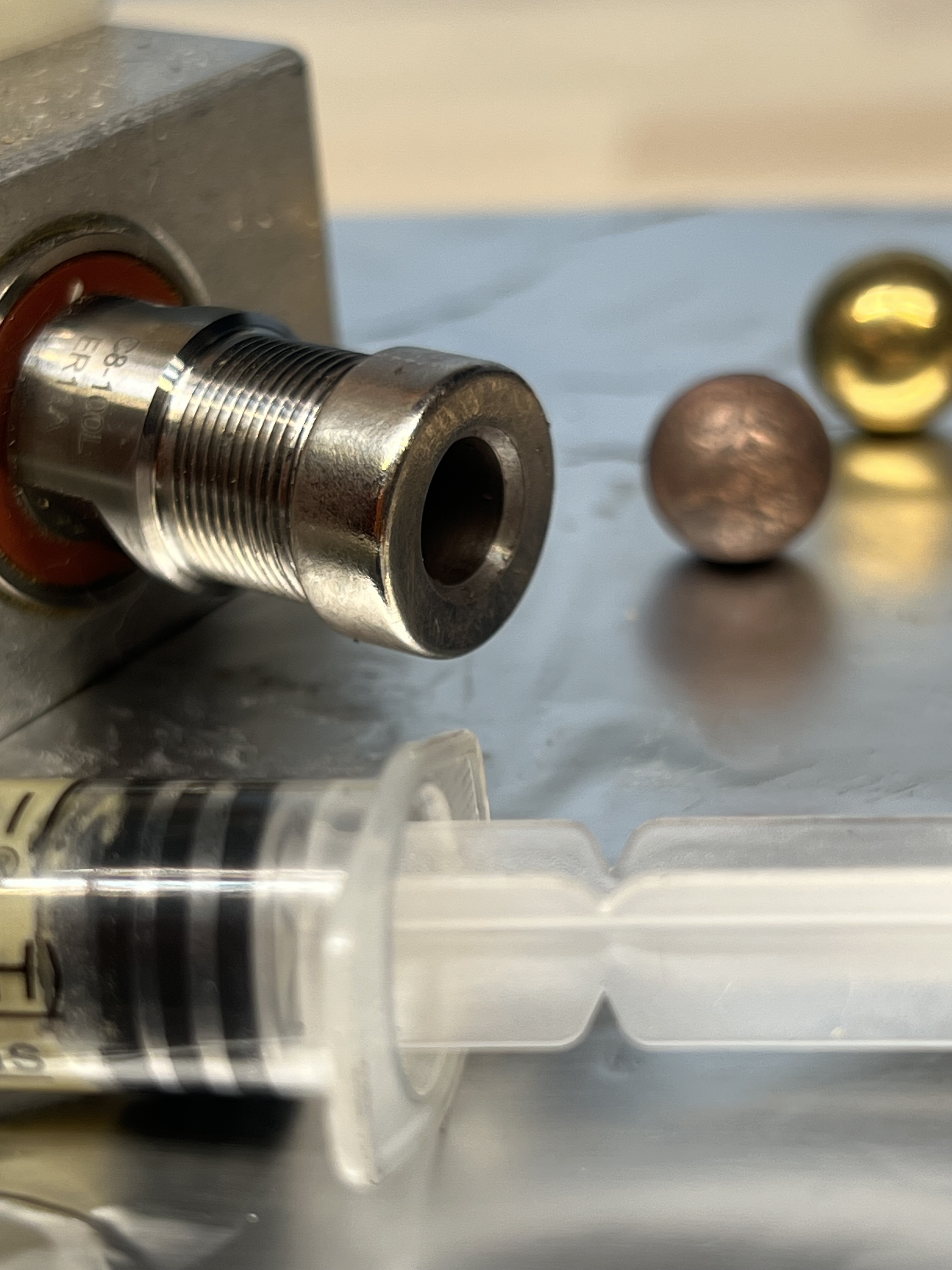

12mm copper ball bearing.
400 grit diamond paste.
Time.
Smother your copper sphere in paste and place it against the magnet, letting it spin freely every few seconds to avoid wearing the copper bearing unevenly. It doesn’t take long for the very hard magnet to charge the copper with the diamond paste which is when some real material removal happens.
I don’t have a force gauge (yet) to measure the increase in force from even this little bit of grinding but I assure you it’s a material improvement.
Once I get the general shape correct, I’ll start bumping to finer grits. The force of a magnet on a lapped surface is incredible, so I figure why not lap the magnet :man_shrugging:

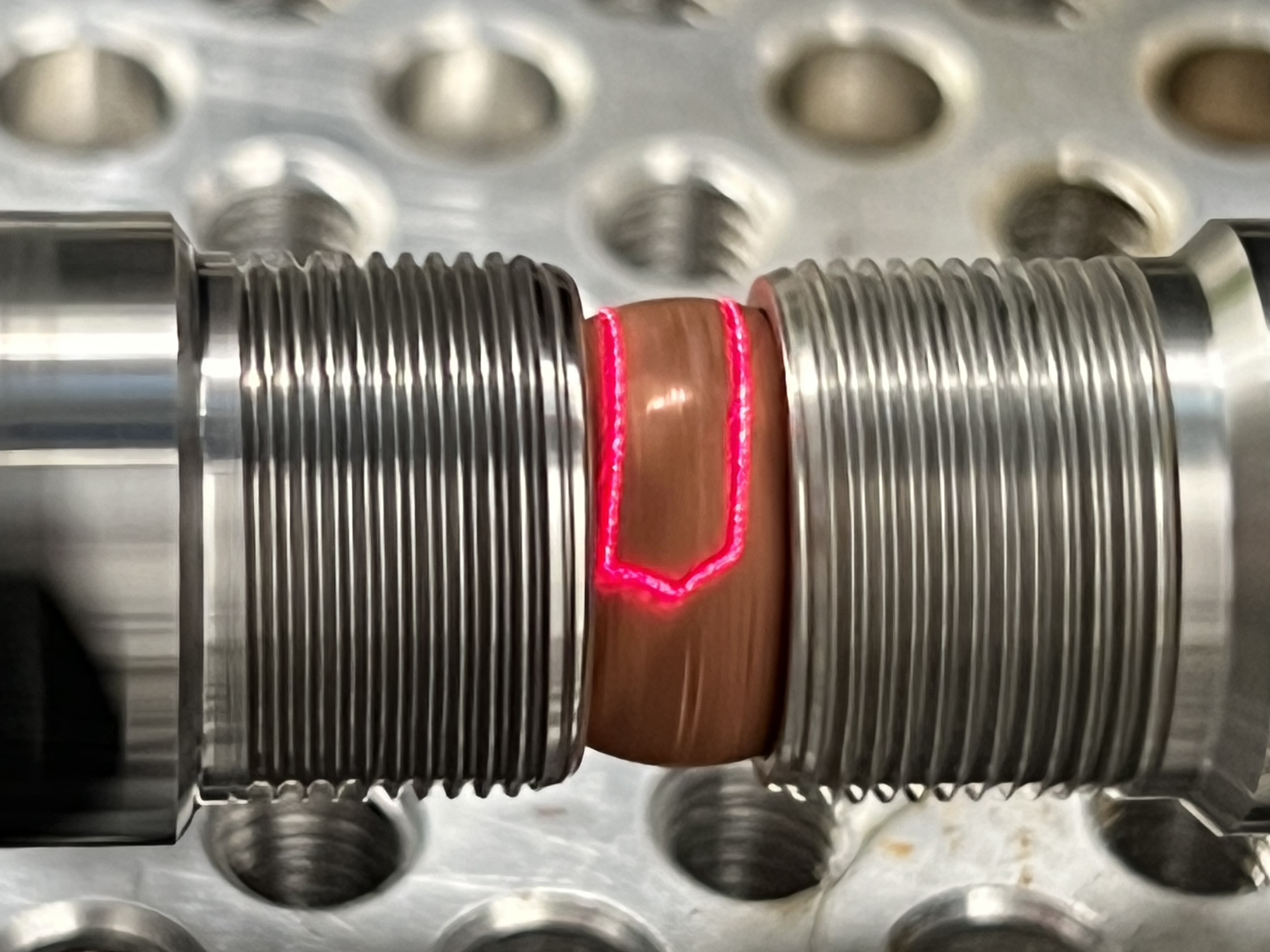

I figure these copper balls can get some grooves to pick up the swarf. Since I don’t have a rotary grinder, I’ll use the next best thing…lasers.
Spin the ball and zap it to get some nice concentric lines that should not materially change the shape of the ball.
Again abusing old blown up and rebuilt spindles :sweat_smile:

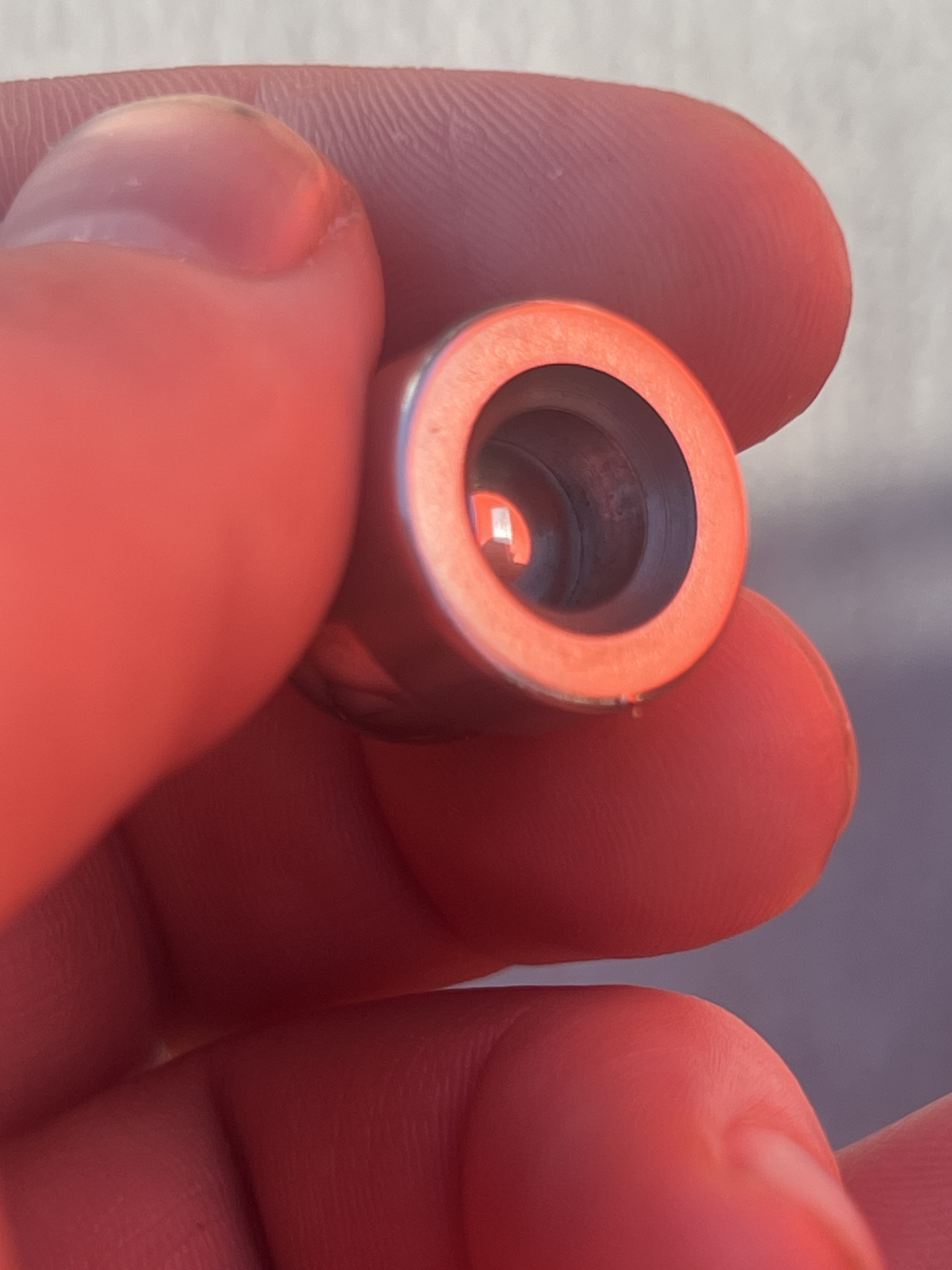

I did end up grinding more with the ball and it’s been awesome so far. I think I can still increase force quite a bit as well if it seems necessary, plenty more material to remove and lapping with higher grits to do.
I’m looking for a decent, reasonably priced force gauge to characterize the forces involved before and after grinding the seat. That should be more interesting that me saying it’s working or not :crossed_fingers:
I am a touch worried about the loss of stiction that I might get from nickel plating the magnet again though.
I might give it a thick layer of copper coating to provide a wear surface that isn’t quite so hard.

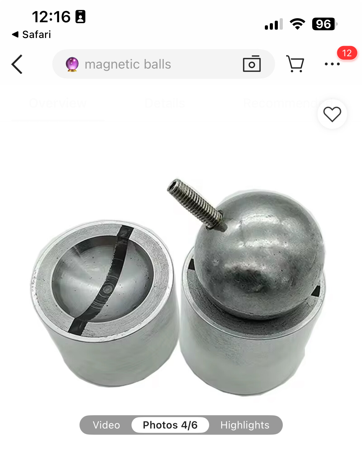

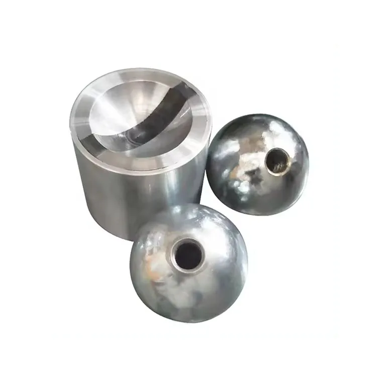

I actually don’t know why this problem is fascinating to me, but I found some COTS set ups for they magnetic ball problem. May be wrong size and a bit too pricey but its some leads. The keywords that seemed to hit the concept was “magnetic ball joint”
https://us.misumi-ec.com/vona2/detail/221000763966/?list=PageCategory
John
These are very similar to what I’m aiming for, I might pick up a couple just to test out :slightly_smiling_face:
I do wonder why they all seem to be split magnets, seems odd:
I’ll also add that at $40 a pop, I’m much more inclined to spend $150 making an automated jig to produce my own. Maybe I’ll be the first US supplier :stuck_out_tongue_winking_eye:

I imagine that each half is magnetized across the thickness, so the magnetic force is concentrated along the gap of the assembly. The tube they’re mounted in completes the magnetic circuit. Think of a transmogrified loudspeaker magnet assembly…
