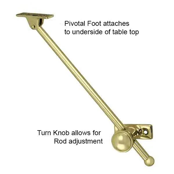

It’s missing the hardware to hold it at an angle, so I’ll need to fabricate that, and there are some other odds-and-ends which I’ll need to make/repair — debating about doing rust removal and re-bluing the hardware…

Fortunately, nothing here is irreversible, so worst case if I just oil and install as-is, I can revisit the hardware at a later date — I’m inclined to hold off a bit, so that I can fabricate and test the new mechanism, then everything which needs to be blued can be in one batch.
Unless I wimp out and just get a pair of the brass mechanisms:

Ah if you’ve got other work to do on it, holding off feels right. Making your own piece might be fun but looking at those features, I’d worry about manufacturing them causing a stall in the entire process.
With my projects, if something stalls I have to evaluate the space impact. In this case, if it means having large pieces if a desk laying about in an unusable state for weeks (bleeding into months…bleeding into years in my experience :melting_face:) then I’d purchase the nice brass pieces and work on manufacturing them yourself after the rest of your plans are completed.
You could design them on the drafting table itself as a nice way to close that loop :slightly_smiling_face:
I don’t mean to dissuade your current plan, just to give my perspective and experience. Though I’m sure you’re a good bit more focused than I tend to be so it may not be relevant :see_no_evil:
