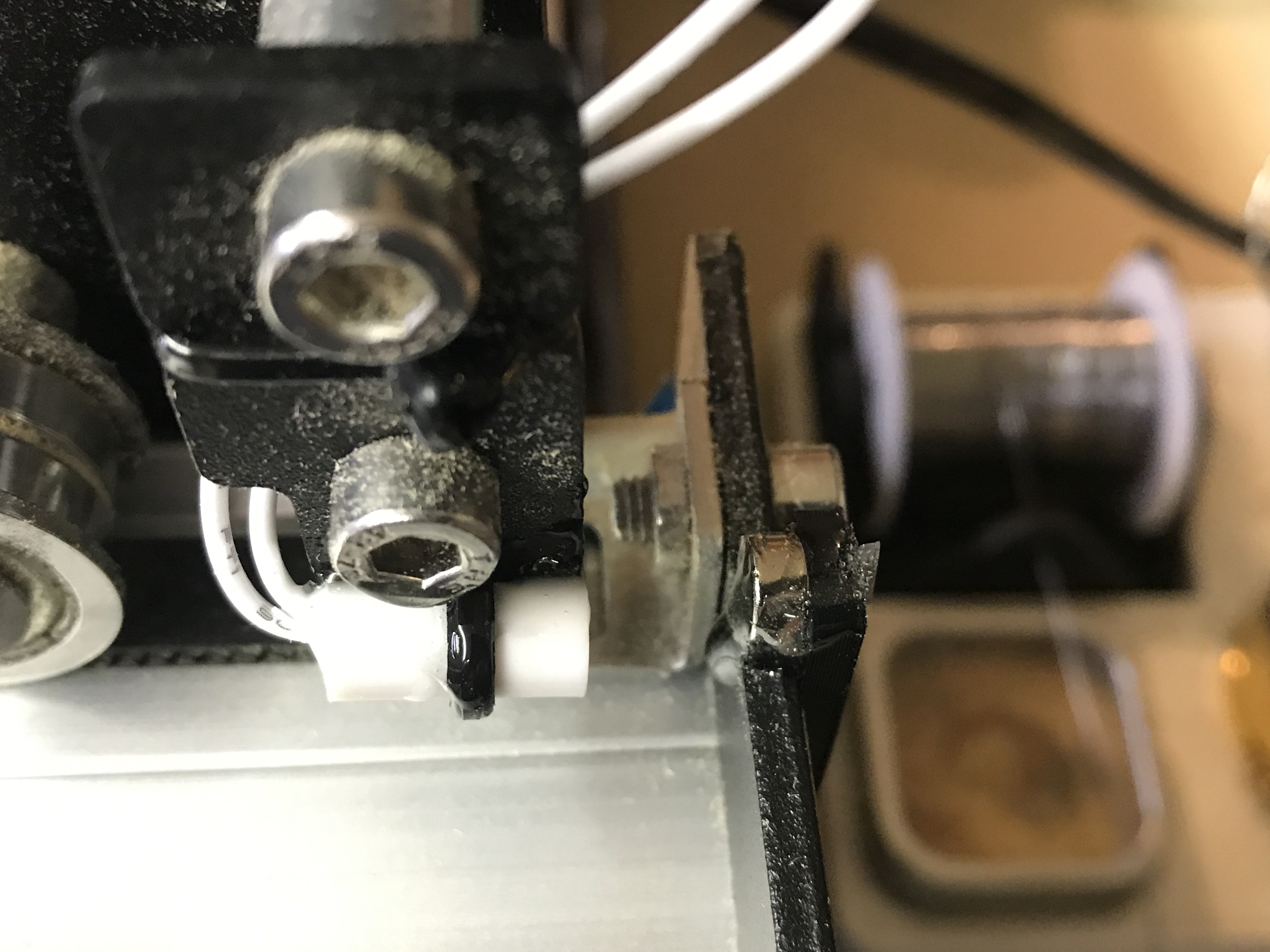

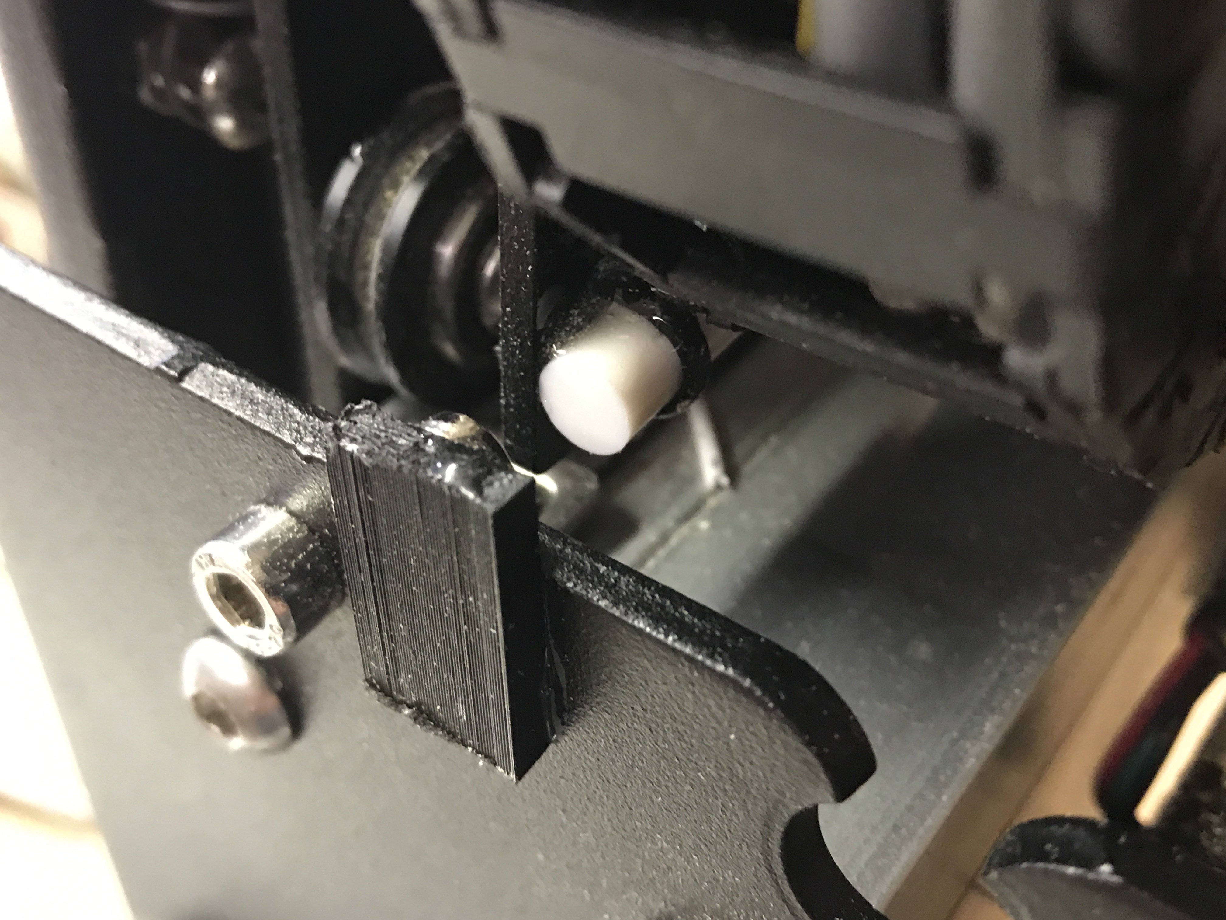

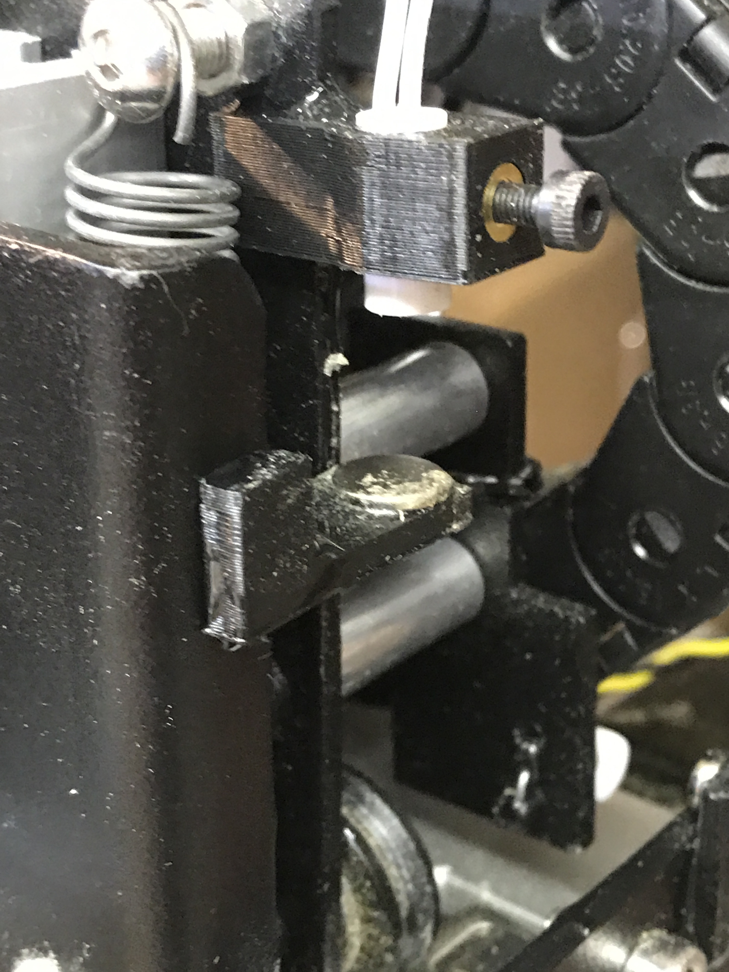

Pack of sub $3 reed switches and $2 worth of magnets and 3D printed mounts and I have got my limit switches working perfectly.
The Z axis was the trickiest but still pretty easy, the X and Y were a cake walk (just zip tied the reed where the original switch was).
When I got done I tested for accuracy (using fast move to the far front / left, placed a bolt just touching the edge of one of the flute ends (sharp pointy bit). Then homed and quick moved a dozen times and it always ended up in exactly the same spot.

Got a pic of the setup?

Here are a few photos. I had to redesign the Z axis mounts just now (turns out if it went down far enough it just touched the V wheel) new ones printing now.
