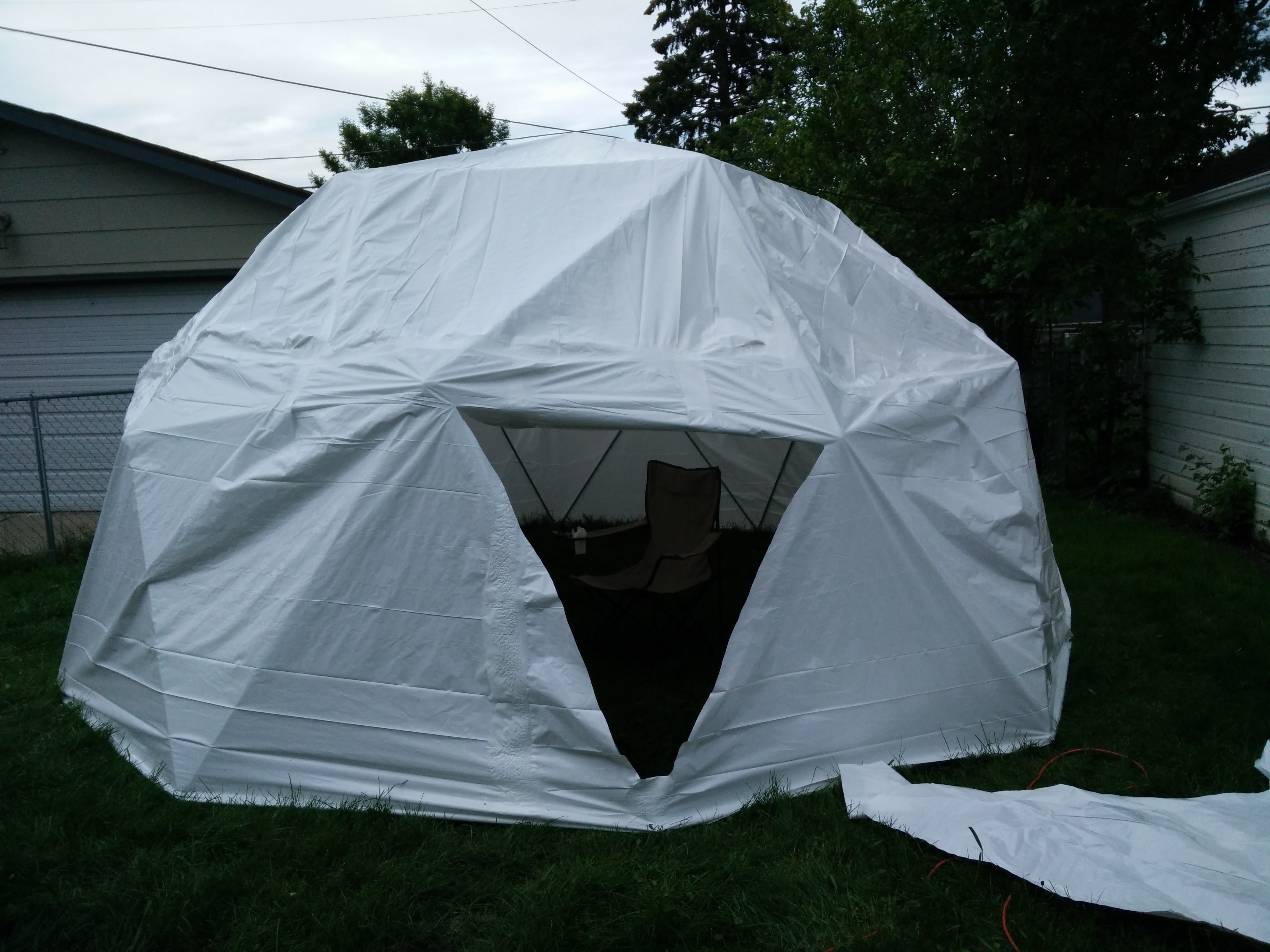

It would be a good idea. I made one for camping at Electric Forest. Crimped ends, bent angles at end, and then drilled holes. Took a while, but well worth the time.
Some sort of hub attachment would have made setup/teardown easier.
The plastic is just construction plastic sheets ironed together.
