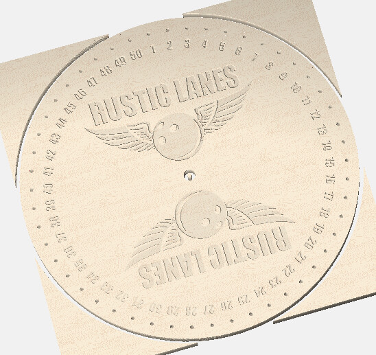

Do you think you can convert that to a CC file for me…board is 36x24inches wide, .75 thick…I used a 1/4" end and 90 degree V Bit, i dont use CC so nto familiar with it fast enough i have to get this job done soon.
Here’s a CC file with the SVG imported, scaled to 24", the holes drilled with 1/4" endmill, and the design advanced V-carved with your 1/4" & 90° at 0.050 deep. The outer trim is a pocket toolpath cutting a 0.300 wide slot, rather than just a simple contour.
Do you have CC Pro? I used ramping to hole mill the center hole.
What is the diameter of the center hole? It scales up to about 0.820"
How close to 24" do you think you can get? Should it be scaled down to maybe 23 7/8"??
