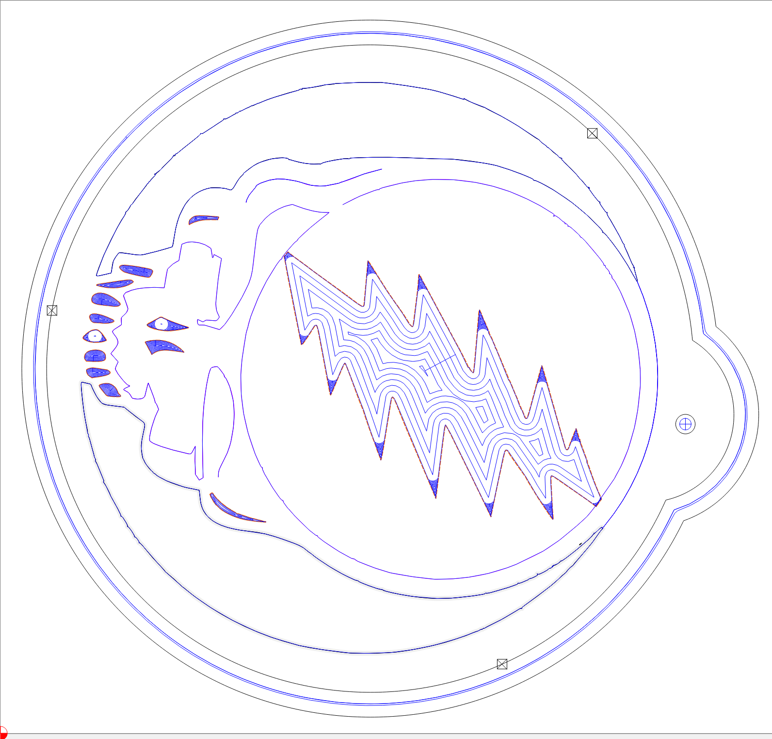

I’m not sure exactly how this is happening, but by the time I make my tool paths and bring them into Carbide motion, they get read as two different tools, causing The machine to shut down and wait for me to tell it I switched tools, even though it has the proper tool on it. I will post a picture, but what it shows is when tool path with tool 10 and the next tool path with tool 20, which are both the same tool, but it still makes me shut down to switch them.
I wanted to add that I tried to make the small teeth in this, which are the ones giving me trouble with the 20 bit and cc won’t carve them as if there isn’t enough room. But in advanced VC if it cuts the pockets, I believe it may have something to do with the advanced VC with the tool switching every tool path. I’m working on the answer now any input would be great thank you.
Here is the carve as you can see there seems to be plenty of room to carve those teeth. The only thing wrong with this Tool path set is that I have to keep changing the bit when it should just run the entire project through after the first bit change until the profile at the end

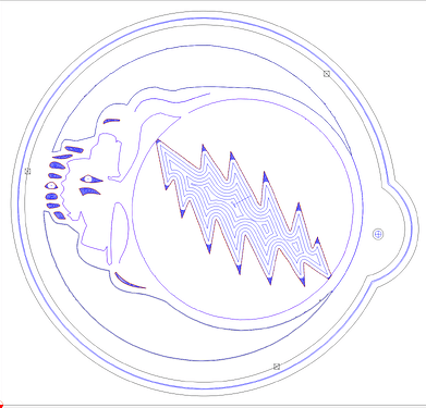

Here is that picture

It looks like you are doing Advanced V-Carve toolpaths, which use 2 cutters.
When you make a custom tool, CM doesn’t know which tool it is. All it knows is the tool number, so that’s all you see. If you use one of the default CC tools, CM references that tool information internally from the same tool database, and can ask for it by the tool name.
Sorry I missed what the answer to That was. What’s the best way to handle the issue?
Also not sure why you have so many toolpaths, based on the image you shared, that should only be a couple to achieve that. 3-4 i would think, not 15+ like you have in that image.
The image you shared doesn’t look vcarved, just looks a profile cut and some pockets.
Can you share the file so we can look at it?

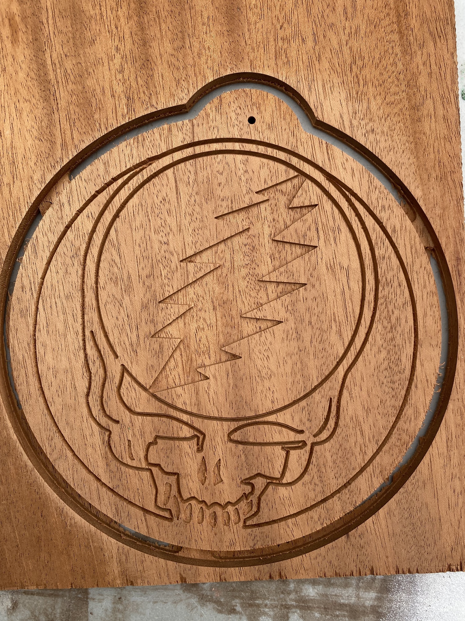

For some reason when I choose all of the teeth and tell it to pocket cut them, which is what I’m actually trying to do it just won’t cut the tool path at all, as if there’s no room there for it then when I choose the exact same set with the Advanced Vcarve command it will carve but it splashes all the teeth up as if its cutting a little too much off and the thin pieces of wood break and look bad.
And when I choose each tooth separately, the result is the piece of wood shown in the picture which is in my opinion pretty good.

Before you do too much work, I just grouped them all together and it looks like it’s gonna work so I will go try to cut it and that would get rid of the tool changing problem. I’m not sure what happened before to make me think it wouldn’t work thanks again for your input. I’ll get back on here and let you know what happened.

You have your McFly cutter set for the Advanced V-Carve clearance bit. This is not going to fit in any of the pockets. I grouped all the Advanced V-Carve object so they could be one tool path and substituted the #102 0.125" endmill for clearance. even with the 0.125" end mill there are only a few feature where it will fit.
Using the 0.0625 #112 for clearance gets more of the features. This is when you could optimize cutting time with more tool changes using the 0.125" for the larger features and the 0.0625" for the smaller ones.
OK, so your Advanced V-Carve path uses tool #20 named “20 DEGREE”. Your Contour path uses tool #10 named “v 20 degree”. 2 different tools with different numbers.
Select the contour path & change the tool to the same (#20) tool. Or just edit the #10 tool & change the tool number to 20.
When you’re selecting the tool from the library, the tool number (along with the vendor & model) are at the very top of the listing.
As for the many toolpaths, you can combine all the Advanced V-Carves into 1 path, and the contours into a single path. Then you just have Drill, Pocket & final contour around the outside. 5 paths total. And only 2 toolchanges.
You also have a bunch of duplicate vectors, and a few really tiny vectors. I would clean those up so you don’t accidentally select them for machining.

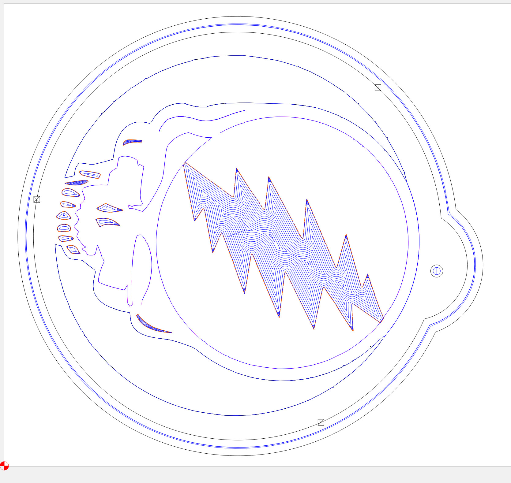

Are these vectors supposed to look that ‘jaggety’??
They are the same tools chosen from the same place in the same menu and then they show up differently every other time I use them
