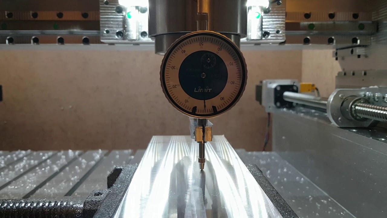

I wanted to start a thread where future HDM owners can share feeds for different tool paths in aluminum as it will be one of it’s primary materials.
Winston’s pumpkin project feeds with 1.5 KW 110v spindle
278-z .25" single flute Zrn coated 6061 Aluminum, Dry, Adaptive clearing
22k RPM
78 IPM / 2000 MM
D.O.C .1" / 2.5 MM
W.O.C .06" / .15 MM
This is conservative and he ended up going 50% faster.

I’m curious if the 2.2kw spindle on the HDM can run a 50mm facing mill like this guys DIY machine can. The build is similar?
If setup properly I’d say yes.
I just have a compact router on my Pro XXL and am very pleased with my results.
Although I do not have a fancy gauge like you have.
