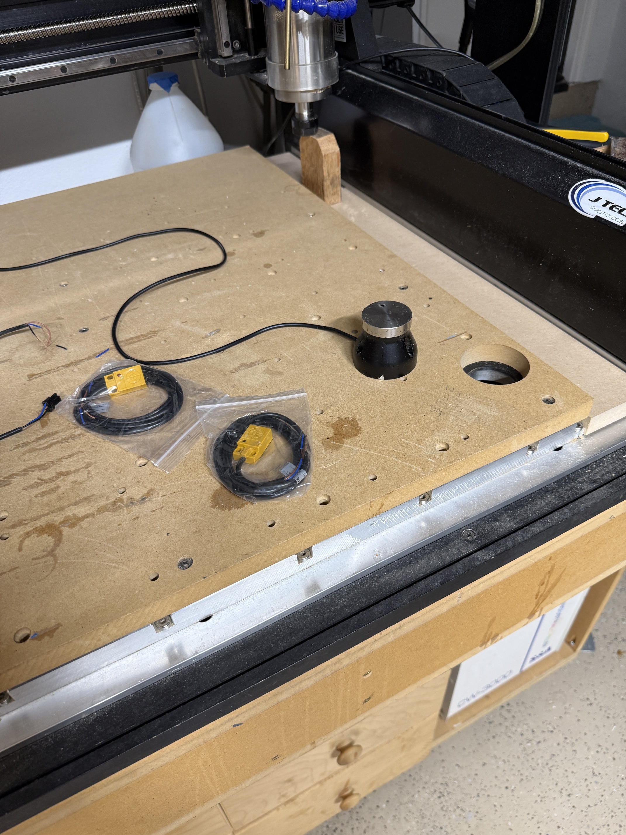

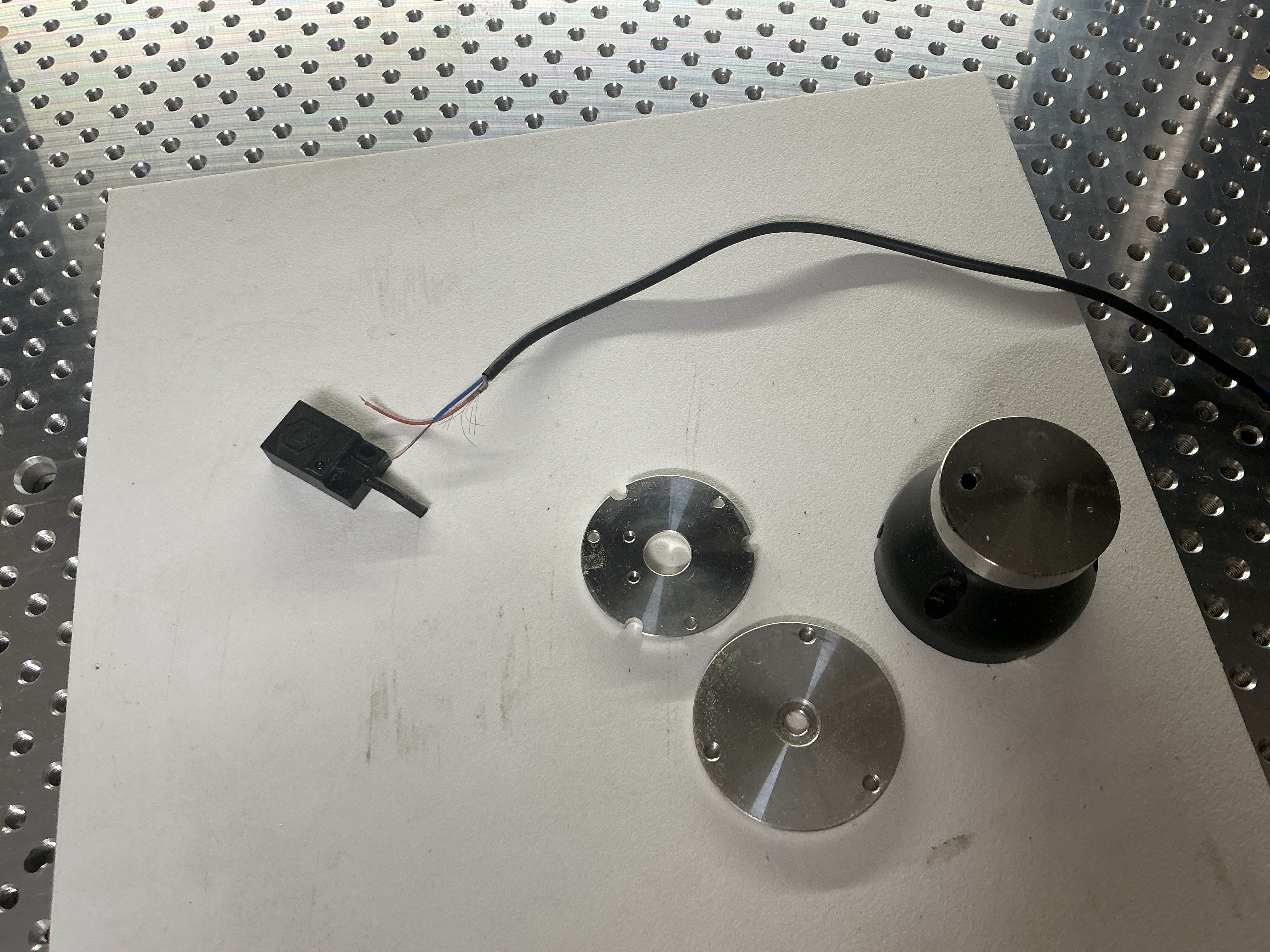

I added insult to previous injury and managed to gut the proximity sensor in my Gen 0 HDM bitsetter.
Anyone know where I can find another sensor? While I wait for a response from C3D sales.

I used these on my S3 and many other projects. Haven’t had a problem with them yet.
https://www.amazon.com/dp/B07V4PR84Y?ref_=ppx_hzsearch_conn_dt_b_fed_asin_title_3

Yeah, plenty of options then.
The sensor is the same (in appearance) as those for x,y,z.
I’ll try the yellow ones linked above. Thanks.
Sales has responded btw. They need to do some digging due to the machines vintage.
Thanks again, back in business…
With two spares.
Just need to reset it under the fixture plate and verify operation.
