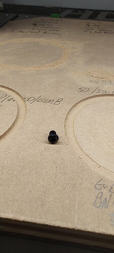

Well been doing several test on my simple circle and all are failures and to make it even worse a screw fell out and no clue where it goes
I’m really having buyers remorse and am hating this machine and I don’t want to be like this. I hope a call will come soon today when they open i did put a request in. Have not tried other computer yet because it’s cc7 and motion is 649 and I was told it won’t recognize these. And I’m not updating it’s working to well.
The screw should be an oil port cover:

Looked all over for location of screw do you do you have a image where they screws are located . I had a feeling it was a port screw. Also did what I could on suggestions and still having the issues. So the main question is Is the 3d program and or latest motion sub standard with the hdm

The folks at support should be able to assist with finding where the screw came from — when one vibrated free from my SO5 Pro I found it necessary to use a bright flashlight and to methodically check all of the linear blocks (still not sure how it got from the left of the gantry to the right of the machine bed…).
