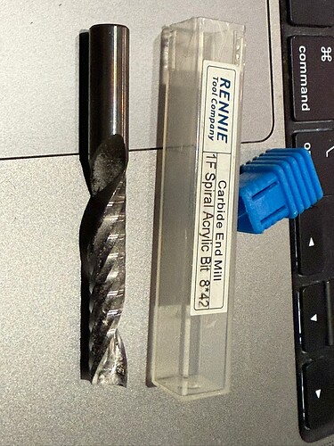

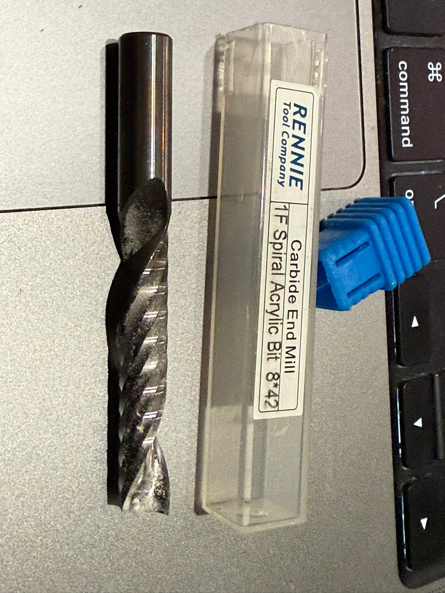

It looks like all my other oflute bits.

SPEtools O-flutes work perfect for UHMWPE which is far more annoying to machine.
That looks like it’s inherently unbalanced, the slot is down one side of the cutter and that puts the mass off centre.
The link I posted was the wrong one anyway, I just went and looked at the bit and it’s from Rennie tool not APT. Anyway the single flute makes one full rotation of the cutter leaving the tool closer to balanced.

Thanks for the picture.
I’m normally a bit of a snob about bit brands. I stick to Amana and Cody’s sir everything that I can. Cody doesn’t offer an o flute larger than 1/4. And frankly I wasn’t interested. In spending Amana money to try a 1/2” bit in plastic for the first time. I’m already loosing money on the first batch of these do to the issues I’ve ran into.
