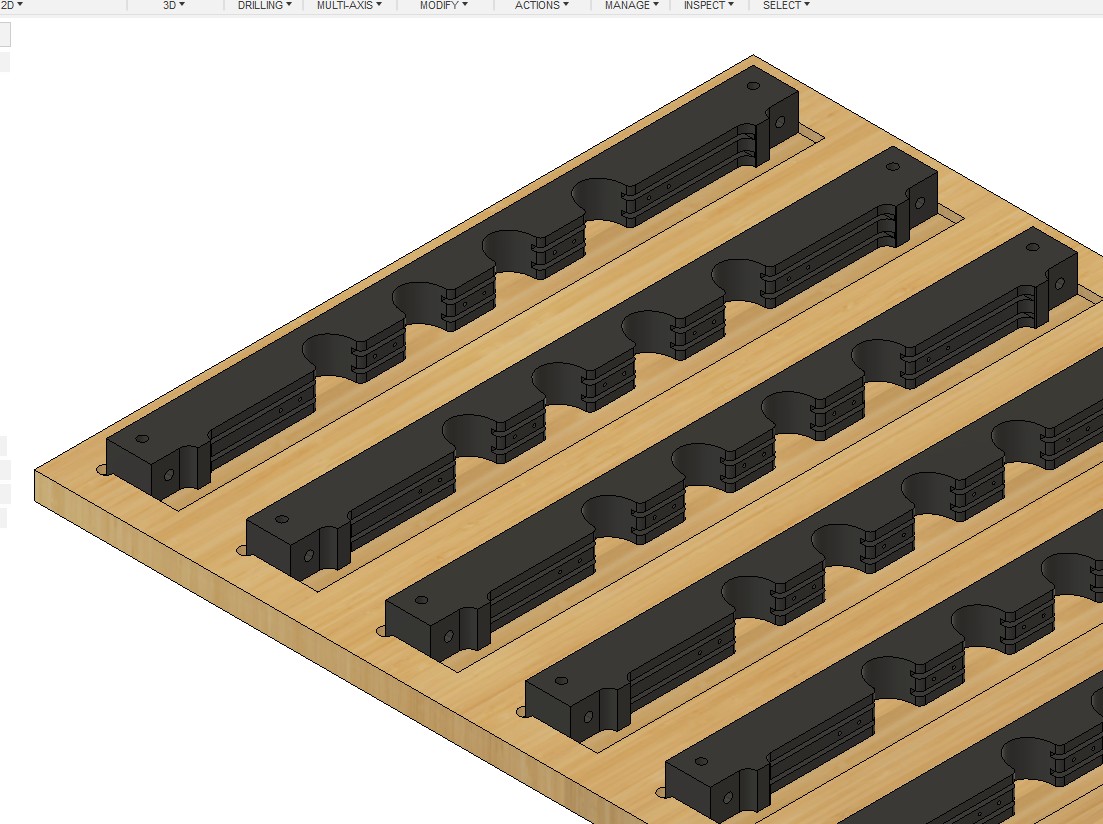

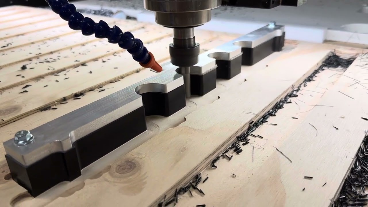

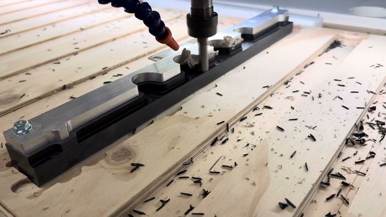

The issue comes when I do my full length finishing pass due to the nature of this part i have a 1/4" hold down bolt on each end with 17" on center. from what i can tell the forces during my light finishing passes are enough to cause a harmonic movement in the plastic itself and if it lifts in one of the concaved areas it digs into the top edge ruining my finish. I am down to 50 ipm at 1100 rpm with the 1/2" bit for finishing pass. I don’t like that chip load but i can get buy with an air blaster.
Ideally I do not want to change bits for this operation. At this point of nearly given up on the jig as pictured. I cant risk 10 failing and i need to baby sit it anyway. I do have a vac table which means I need to make jigs to hold parts like these, which is nothing new to me I use front left corner as my zero with zero ontop of waste board. have bards screwed to the edge to locate on the vac plenum for consistency, I also bore 2 1/4" holes in the jig and engrave or write the absolute location of the holes to check alignment if needed. I use screw inserts in the 3/4" plywood for the hold down bolts, I also use a solid carbide drill to drill the hold down holds in the plastic, I’ve found that carbide drills have the least amount of runout.

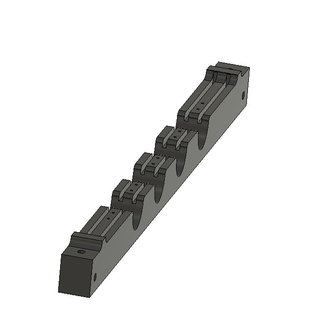

part has two operations, one flat, the other vertical, I’ve got no issues slotting and drilling on the vertical.
jig has a 1/4" deep pocket to support the backside of the part all though I would love to be able to face the other side and have both sides unsupported
stock is 1" thick , 18" long, and 1.625 wide as show below, this leaves me around 1/8" extra material just to make sure.

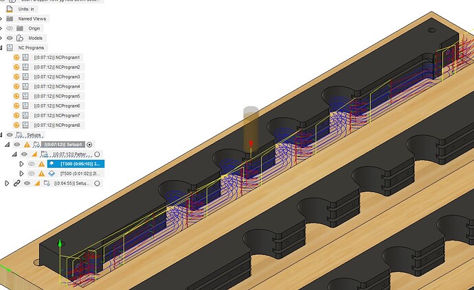

Here is how I’ve been roughing, Haven’t had much of an issue there as long as i keep doc under 3/8 of an inch,

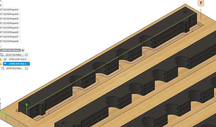

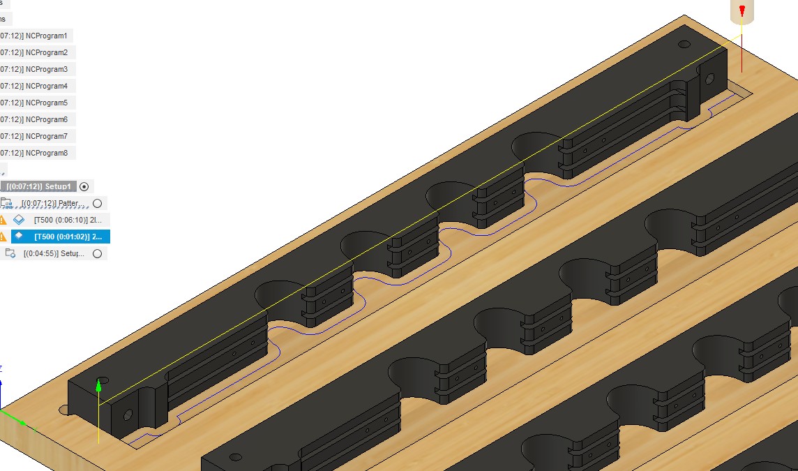

finishing path is simple. the issue happens when entering the concaved areas and getting maximum engagement in the back of the arc.

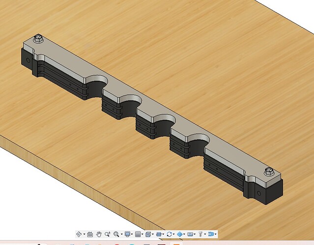

My current Idea is to machine a 3/8" to 1/2" aluminum brace that goes ontop of the material to help prevent it from lifting, Also hopes this gives me enough friction so I don’t need the support on the back side and can machine both edges to remove saw cut marks.

The bar/stiffener may help. I would recommend undersizing it a good bit just to reduce the chance of biting it with your finishing operation.

The stiffener I pictured is .020” smaller in every direction than the finishing pass would be. Which is plenty in my mind. Im going to have to find some flush counter sunk head boots for it. And make sure I can clear my cooler nut before order material. Either way will be Friday before I can play with it some more. Part of me wants to make one out of 1/8” baltic birch and see if it helps.
I’m tempted to rough with the 1/2” , leave 1/4” of stock then finish with the 1/4” taking relatively light and reducing pass depths. If I can get it right without the stiffener or with it out of wood I can make 10 at a time and the bit change becomes worthwhile.
Another option that I’m just now considering is one or two hold down bolts with a z shaped piece putting pressure on the middle of the part. Something to play with tomorrow.

The top brace does exactly what I need it to. I put a piece of card stock in the middle to make sure it had pressure.
I’ve got a couple of bid requests out to make 10 of them with a surface grind to eliminate the need for the card stock.
Current settings are
75 ipm. 9k rpm. .25” doc with a .125” step over.
I’d love to double my feed rate but this Chipload works great and anything over 10k rpms and this bit vibrates crazy.

Yeah I was hopping no one would notice that. I changed the height settings for my roughing but only changed the clearance height and not the feed height for the finishing path.
Chipped the tip of the bit a little. But I polished it out by putting a flat on the bottom. Not a huge deal. Plus it’s a cheap bit. Still cuts well.
I know there’s lots of room to speed up. This bit just has a horrible vibration preventing that from happening. 10k rpm is fine. 11k and it’s going to shake the machine apart. I’ve got to get this first round of parts out, so I’m going to be making them one at a time for now.
