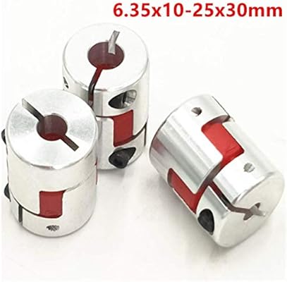

I ended up getting a 10mm x 1/4" shaft coupler from Amazon;
