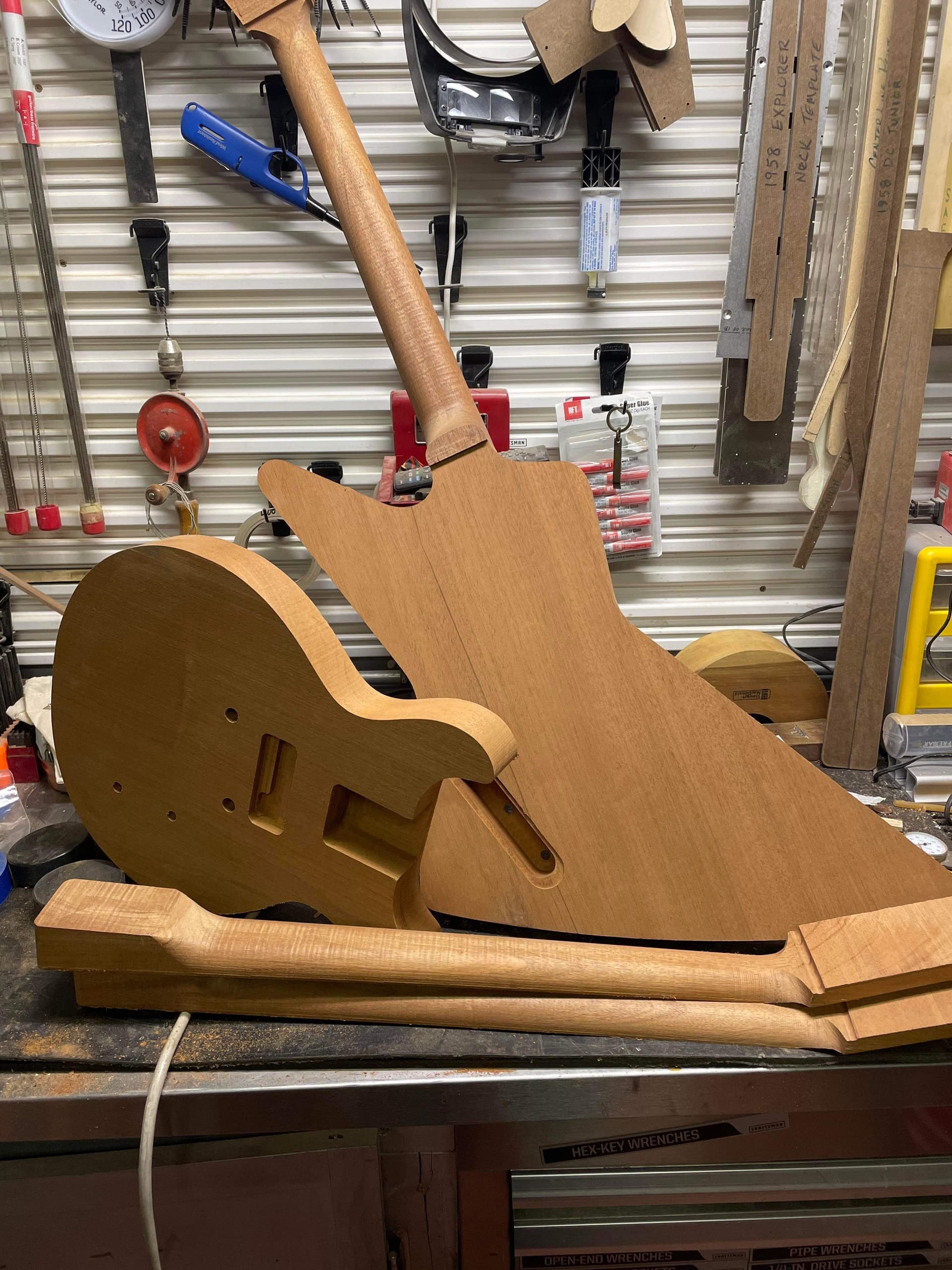

I have the SO4XL (non pro) and cut guitar bodies several times a month. I have whatever Z plate that came with the stock SO4XL. You are absolutely right that for guitar building the 4.5” X travel is a limitation. Theoretically, you can cut all the way through material half the dimensions as the overall Z movement. But in real life, it’s more like (Z- 0.500”). That 0.500” is what is required for clearance. That said, you may gain a bit deeper cut with the HDZ upgrade.
For me, it was a bit of a balancing act. I use a 3” long bit with a 1.75” total cutting flutes but there a few bits available with 2” cutting flutes too. When I set the bit in the collet, I make sure there is 2” below the collet which means 1” inside the collet. That helps ensure the collet has enough to bit on so the bit does not come loose, plus enough bit below to go all the way through the material. With 2” of bit below the collet, I have at least .250 clearance from the collet to my 1.75” bodies but also about .750 clearance above the work when retracting. In Fusion I believe I am set to a .500” clearance above work for moves from one pocket to the next.
Unless your bodies are greater than 2” thick, you should be able to cut with the stock machine. I actually use a sacrificial 1/8” board under my bodies so for me, 1.75” is about my max with nice clearance.
On cutting necks with an angled headstock (3” depth) I end up cutting the headstock angle on a saw. When I machine the back of the neck, I only go just past the headstock transition.

Beautiful necks!

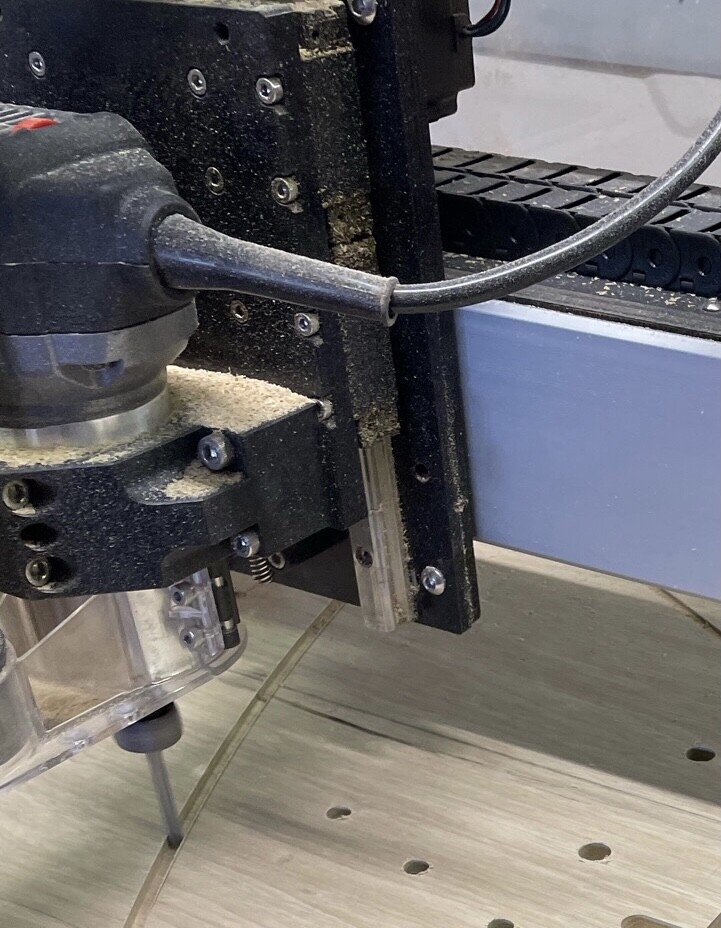

You can see in this picture, I have the Cd3 router lifted about .500” above the motor casing. I can get an exact measurement if needed. It is a balancing act because you still want your 1/8” bits to reach the spoil board.
If you have a BitSetter, changing the height of the router in the mount is also no problem. You can slide it up and down as you desire at any tool change.
