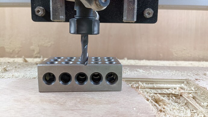

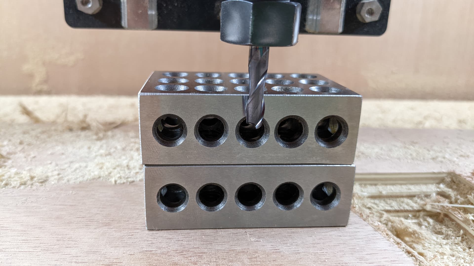

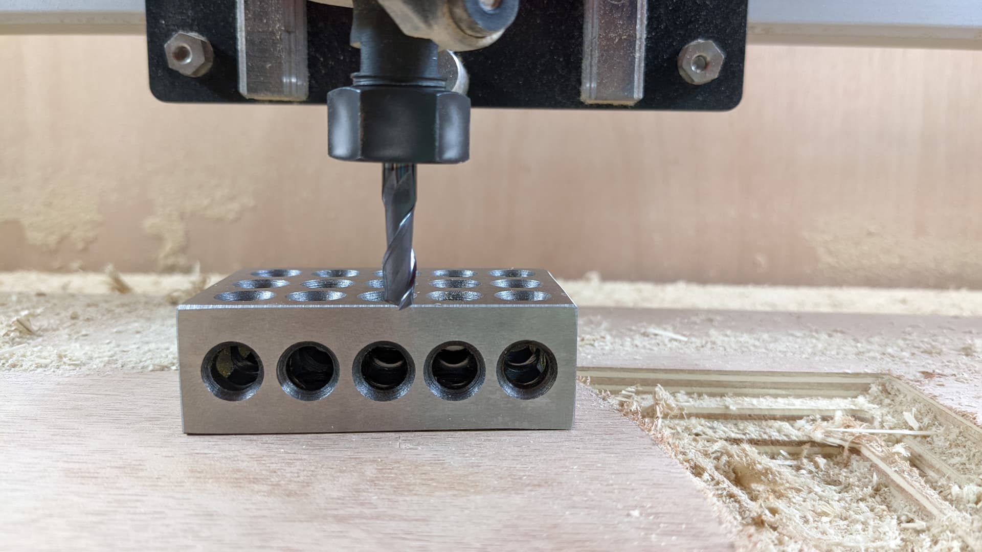

Okay, I figured it out. Silly error on my part. I set the config to HDZ but I in fact do not have the HDZ upgrade, I have the Z-plus. This also explains why the installation instructions I was following did not seem to quite match my reality when rebuilding the head. :upside_down_face:
As soon as I sent the Z-plus config it seems to be working right. The photo with 2 blocks shows a 1-inch jog that actually traveled more like 1.6". The photo with one block is after I set the Z-plus config and you can see it appears 1" dead on by eye.

You want to set $102 = 200 for the Z plus
For the HDZ, it’s 320 steps/mm.
320/200 = 1.6
Don’t mess with the X or Y.

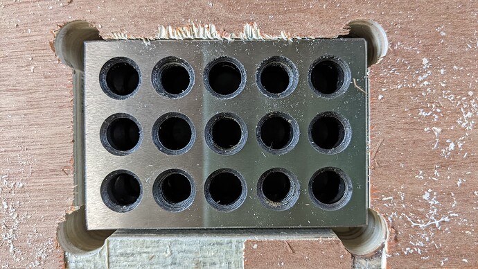

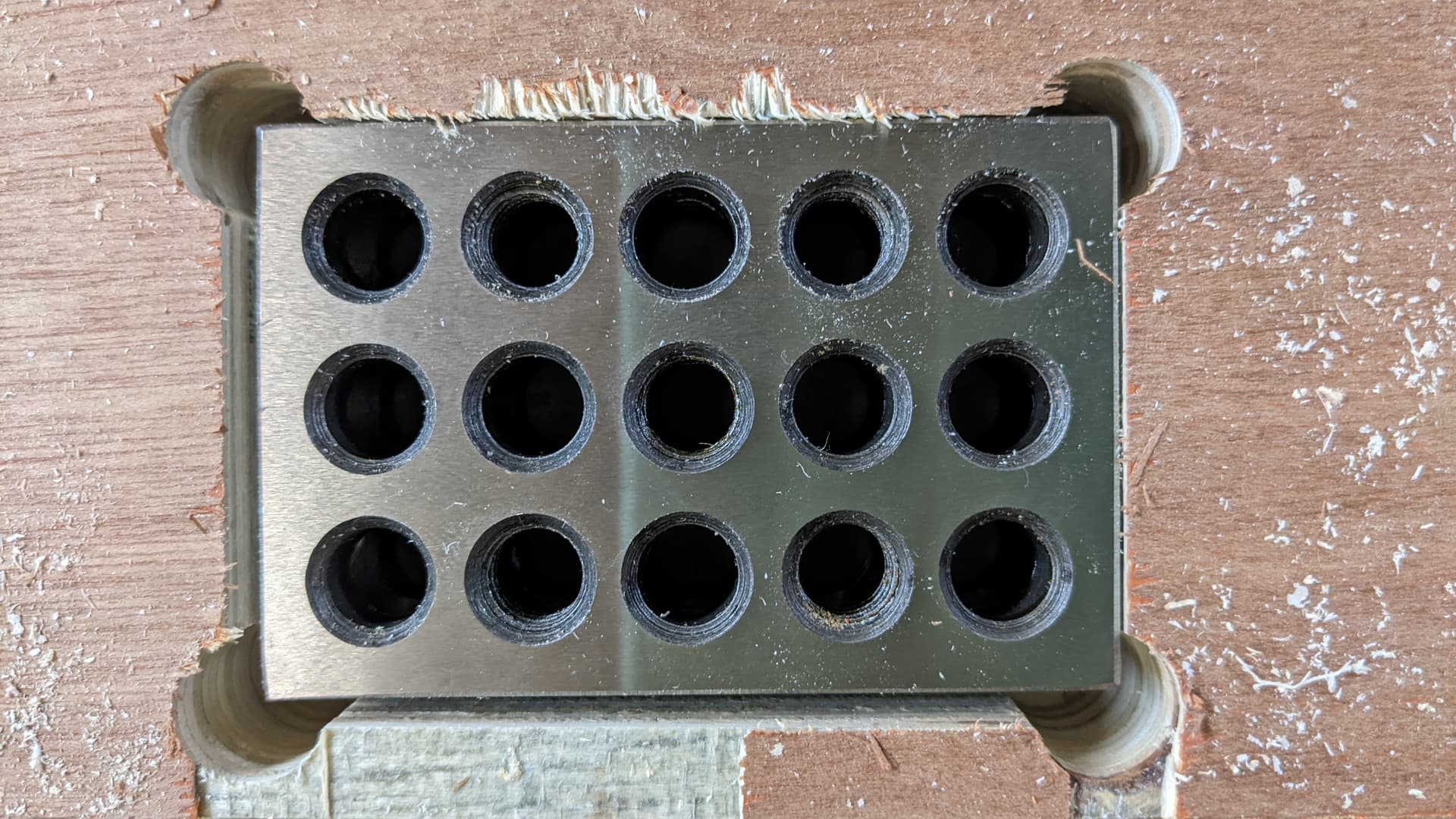

I did the jog test in both the X and Y directions using a couple 1-2-3 blocks. 3" in either direction seemed to be accurate. I then ran a 3" x 2" x 1" deep pocket. When I place the 1-2-3 block in it, it is flush with the surface/z-zero (so hooray, the Z discrepancy fixed!) but the X and Y directions both have about 3/32" gap. See photo. I double checked the design file in Carbide Create and everything looks fine. I checked belt tension and although the X could use a slight tensioning (and I did) it was not too bad and the Y belts were perfect.
You say I should not adjust the $100 and $101 defaults. Any idea what would cause this, on the cut and not the jog?

Is the endmill size accurately measured? What sort of runout are you seeing when cutting w/ it? What is the width of slot which it cuts?
A 2" x 3" pocket is kind of small for calibration — do you have a decently large pair of calipers?
See:
and
That was as advice when you were having issues with your Z depth.
To adjust your Y:
Expected /actual * current steps per mm = new $101
2"./ 2.1875" * 40 = 36.57
That said, 3/16" over on a two inch pocket seems a bit much.
Can you run a shallower test? I’d start, as Will, suggested by just running a shallow slot to measure the width the endmill is cutting.

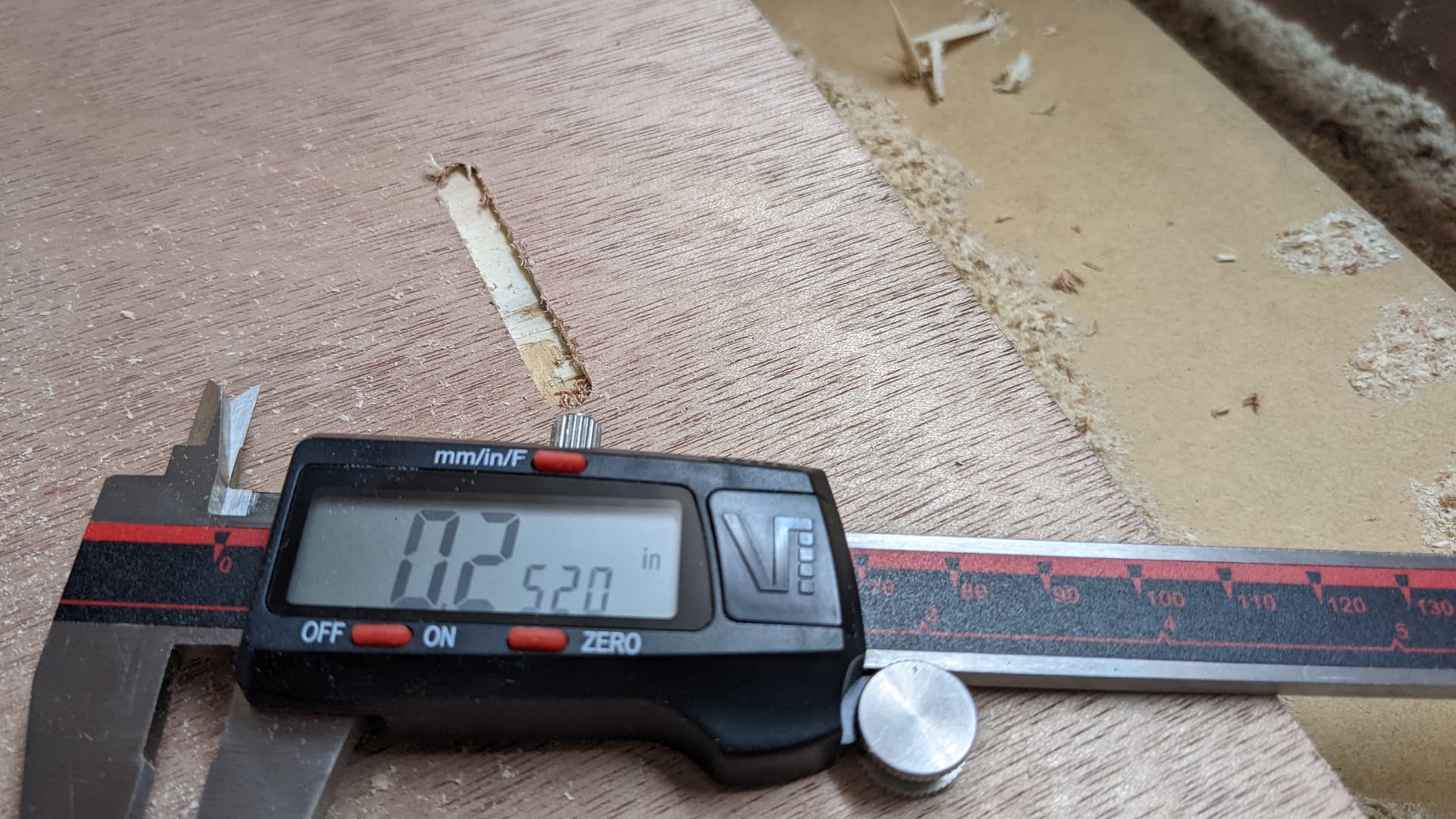

I just ran a shallow slot. Bit is 1/4". The caliper reading is within 2 thousandth of 0.25" on most readings. Worst reading was 0.255".
Here is the bit I’m using right now. (This is my go to for rough passes).
Okay. I am wasting everyone’s time today. I am so sorry. I just checked the defaults I put in for the rough cutter. I put in 0.125. Not 0.25. Mystery solved.
