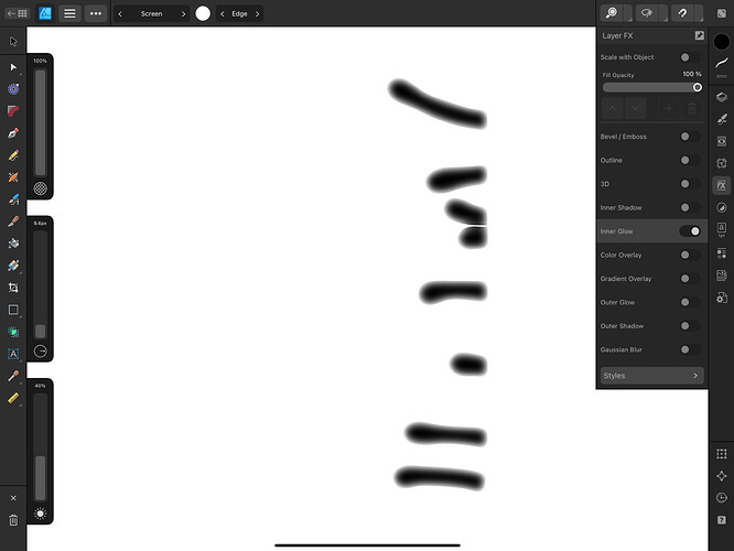

This must be done in layers for proper overlap of the multiple tentacles. Here’s one layer, simply 8 closed vectors filled with black:
An Inner Glow is applied and the parameters set

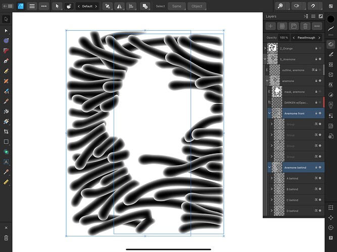

Here’s another layer beneath the first:

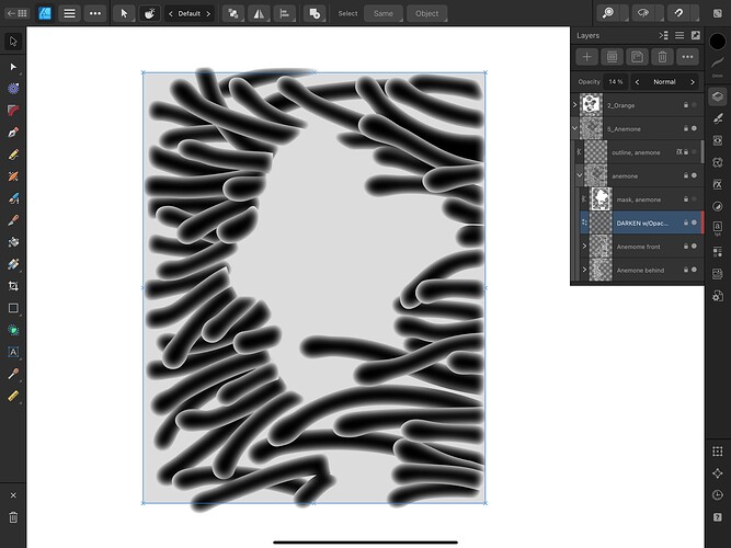

All the layers, same application of Inner Glow:
But this needed tweaking. A trial run showed too much white after the epoxy was placed so the entire map was lowered by superimposing a black rectangle with very low opacity on top:

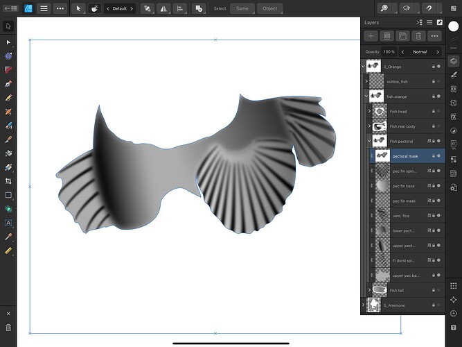

The fish orange detail is somewhat different. In its entirety:

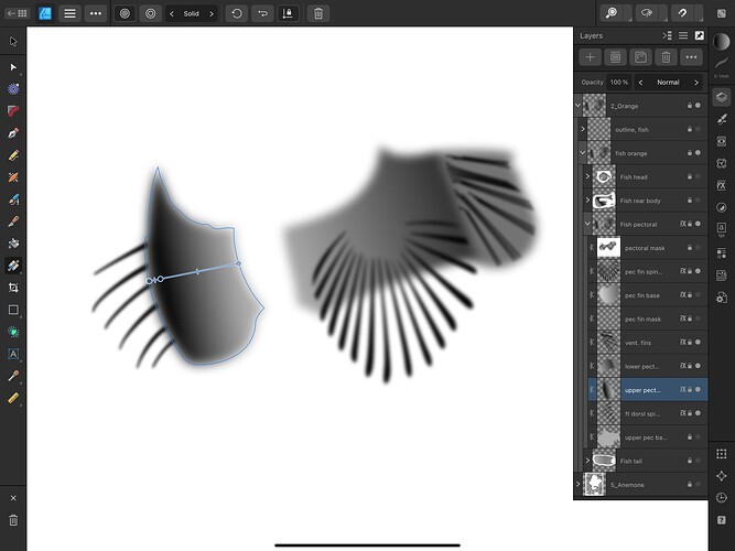

The recesses between the spines are closed vectors with a black fill:
A slight blur is applied:
The body curvature depth is simulated with a gradient fill:
An overall base layer is needed:
All combined together:
And matted:
