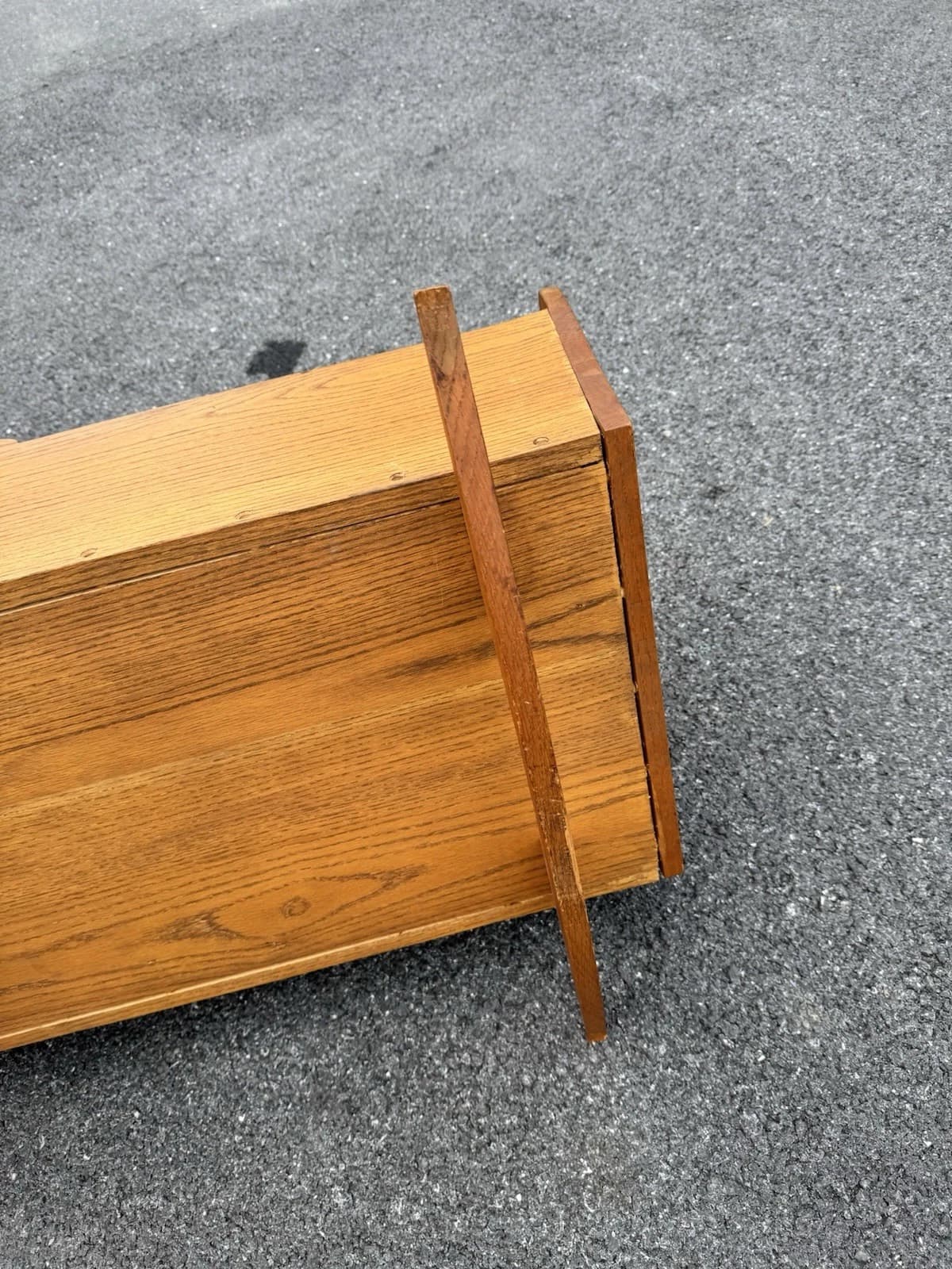

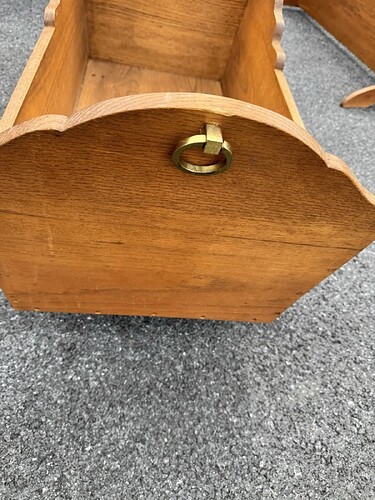

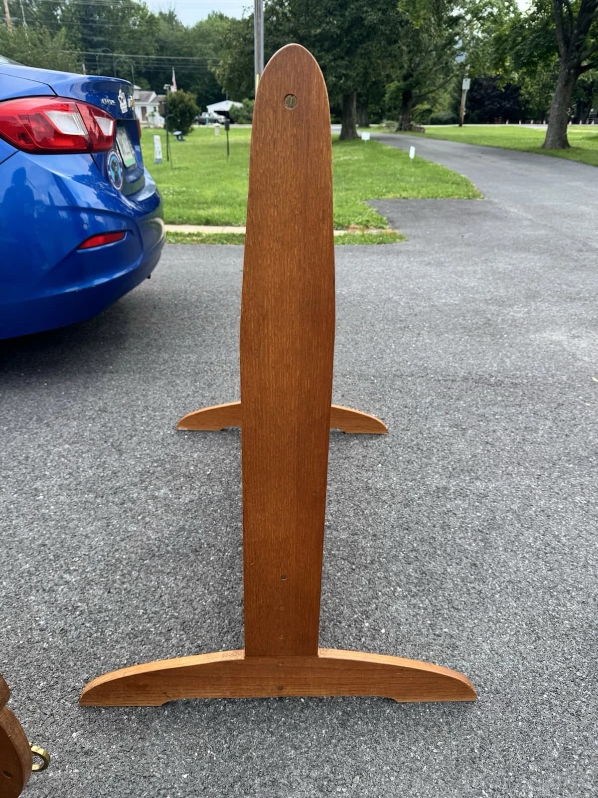

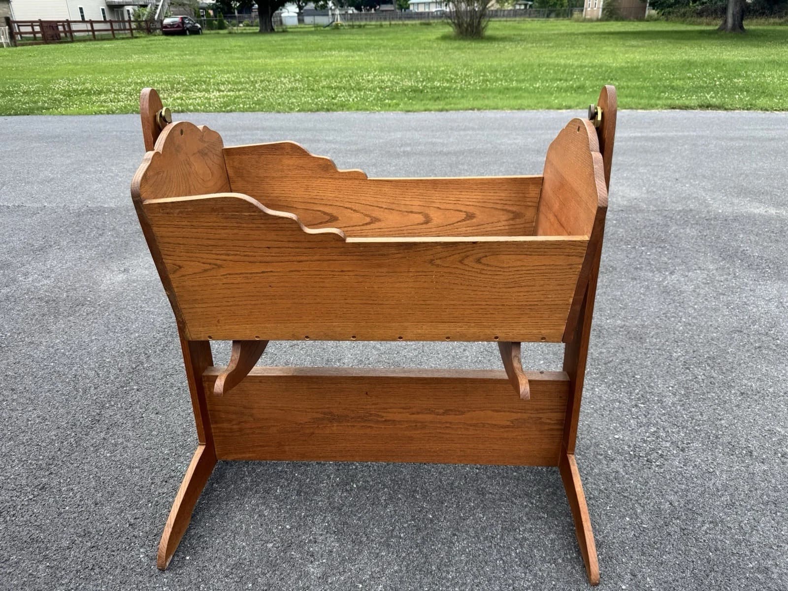

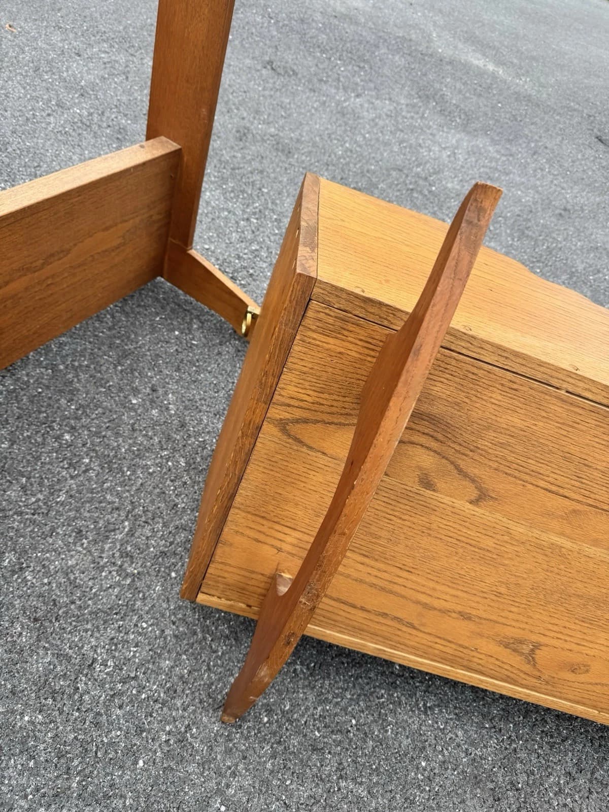

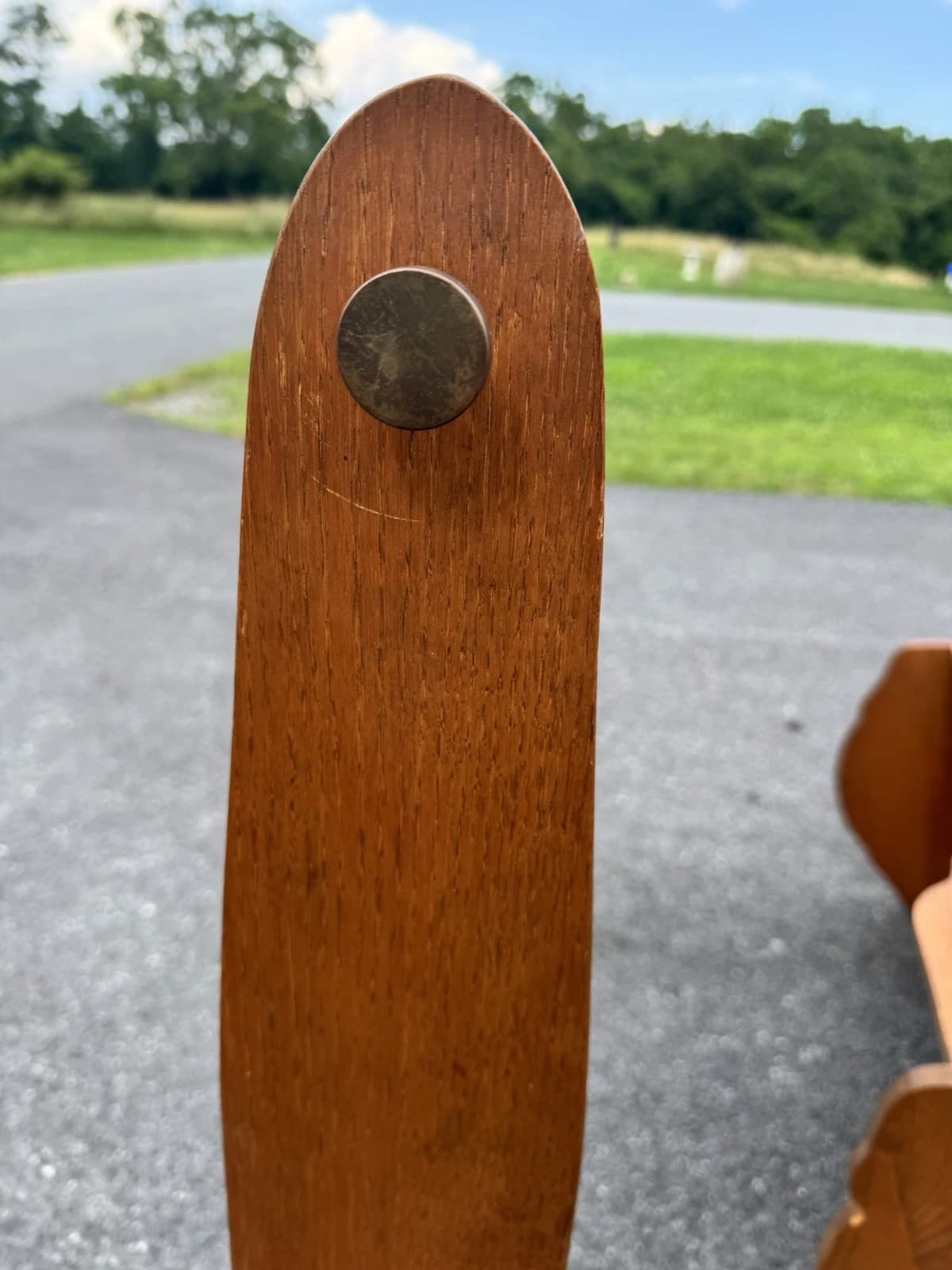

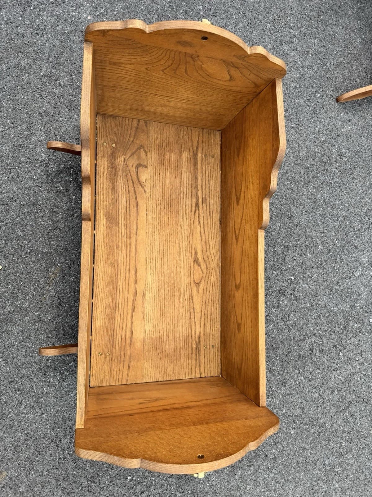

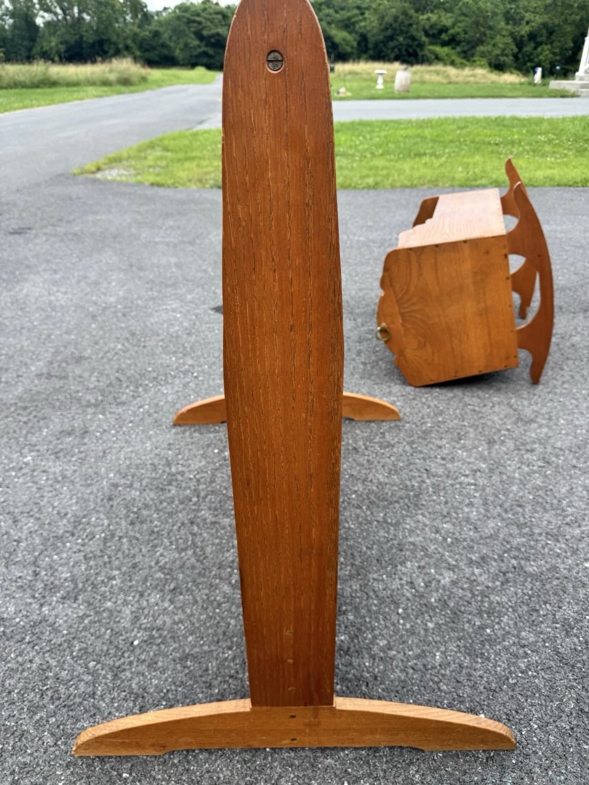

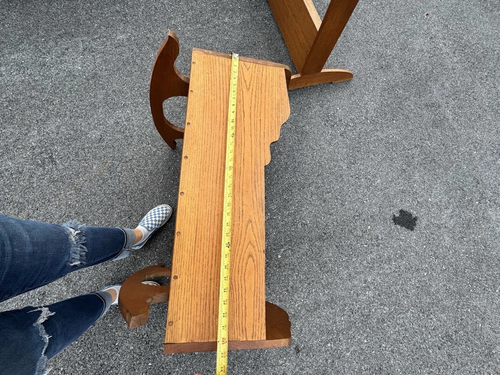

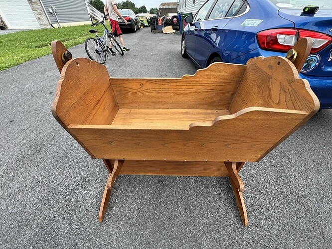

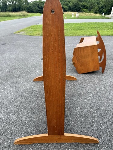

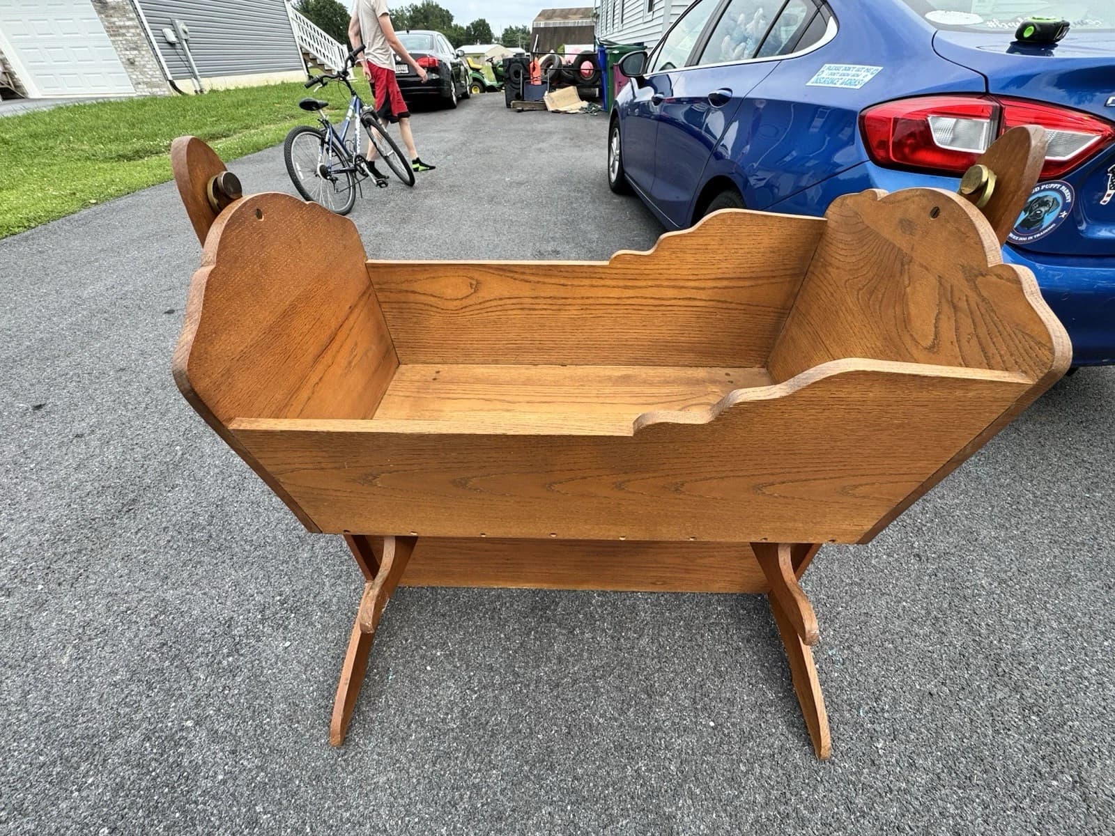

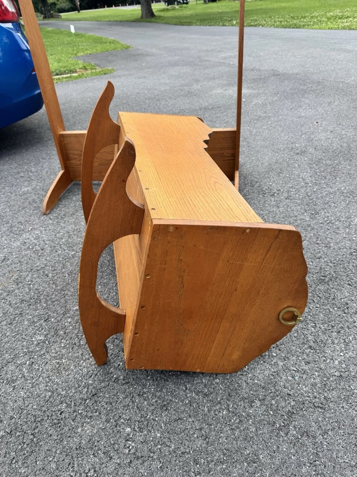

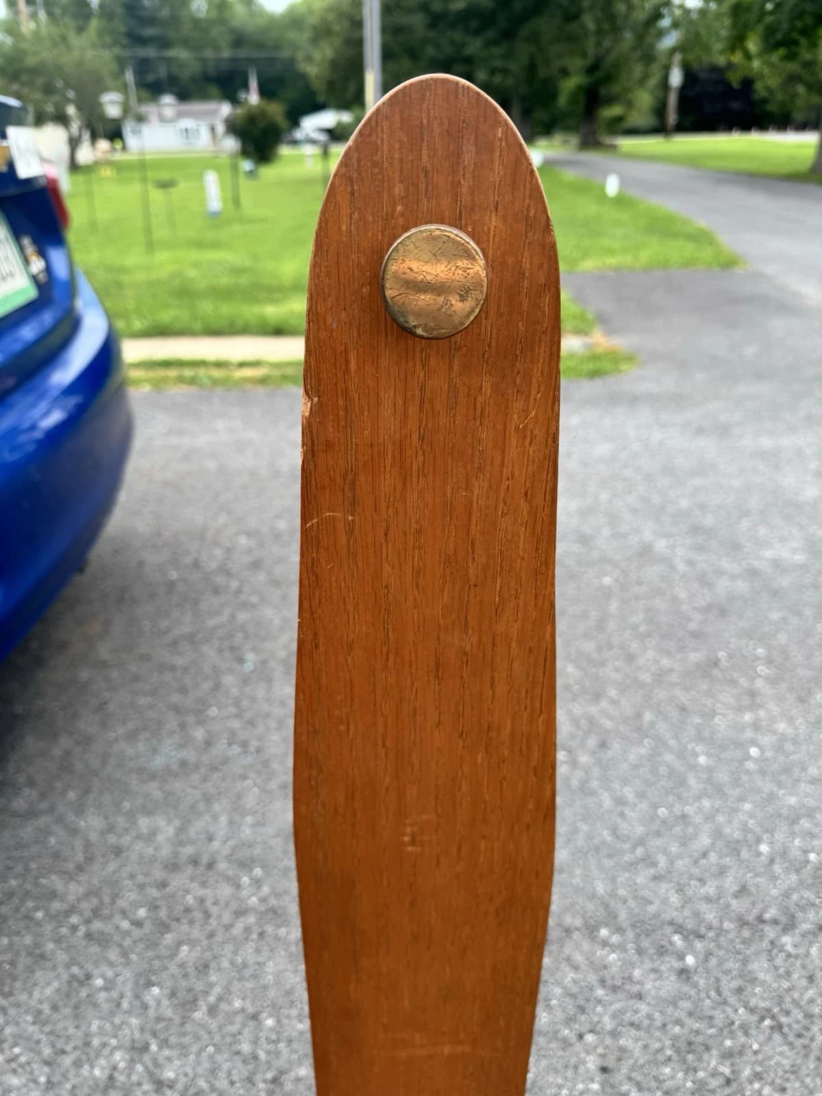

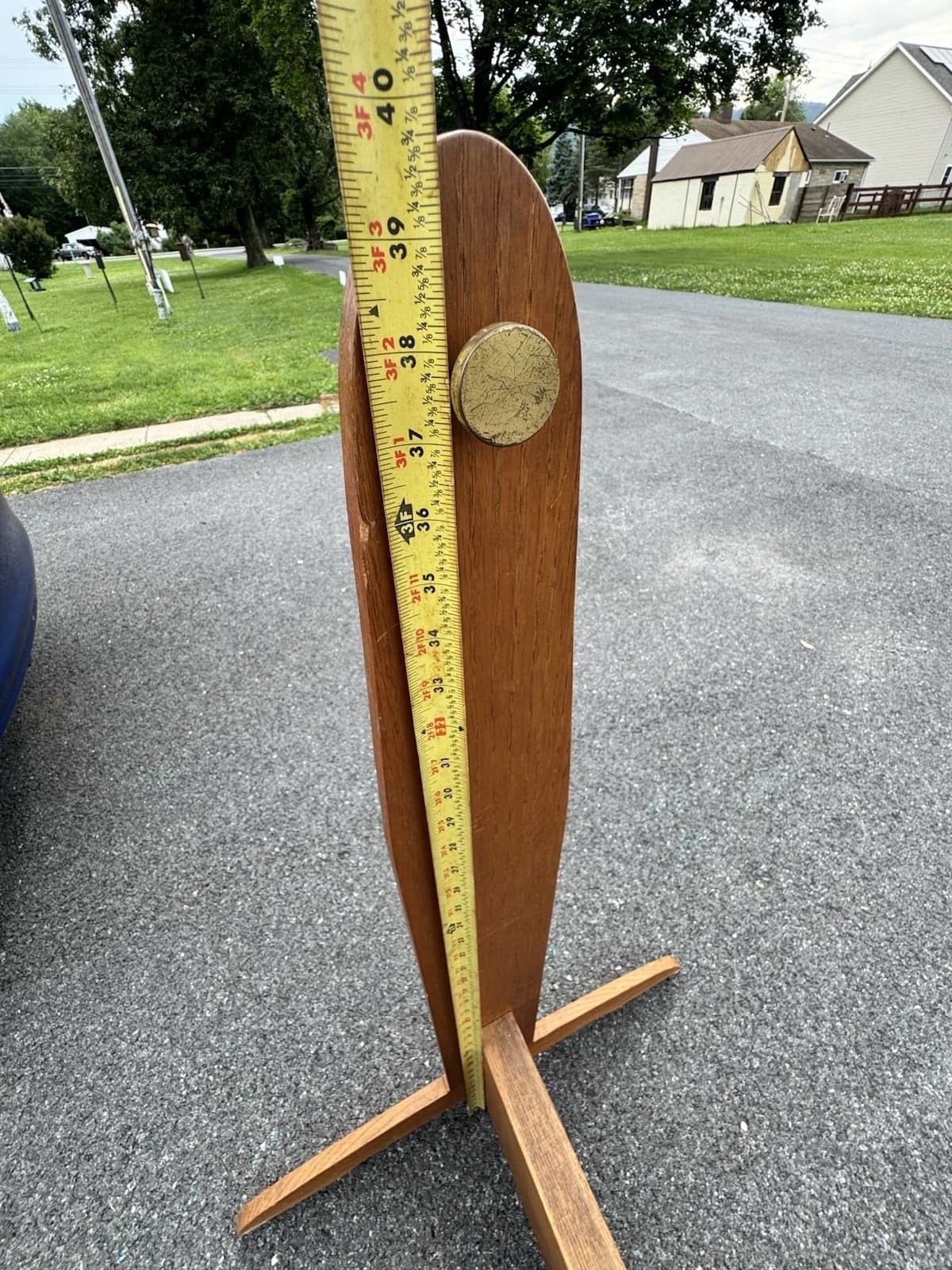

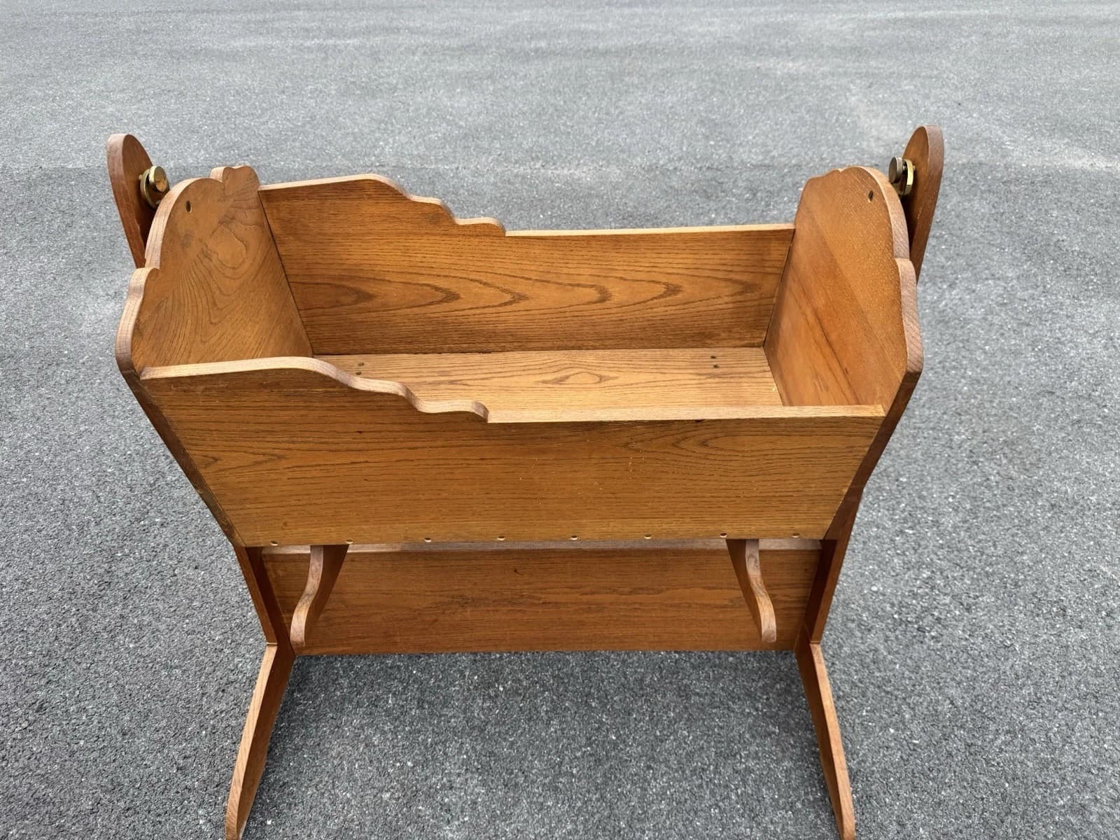

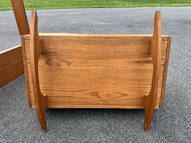

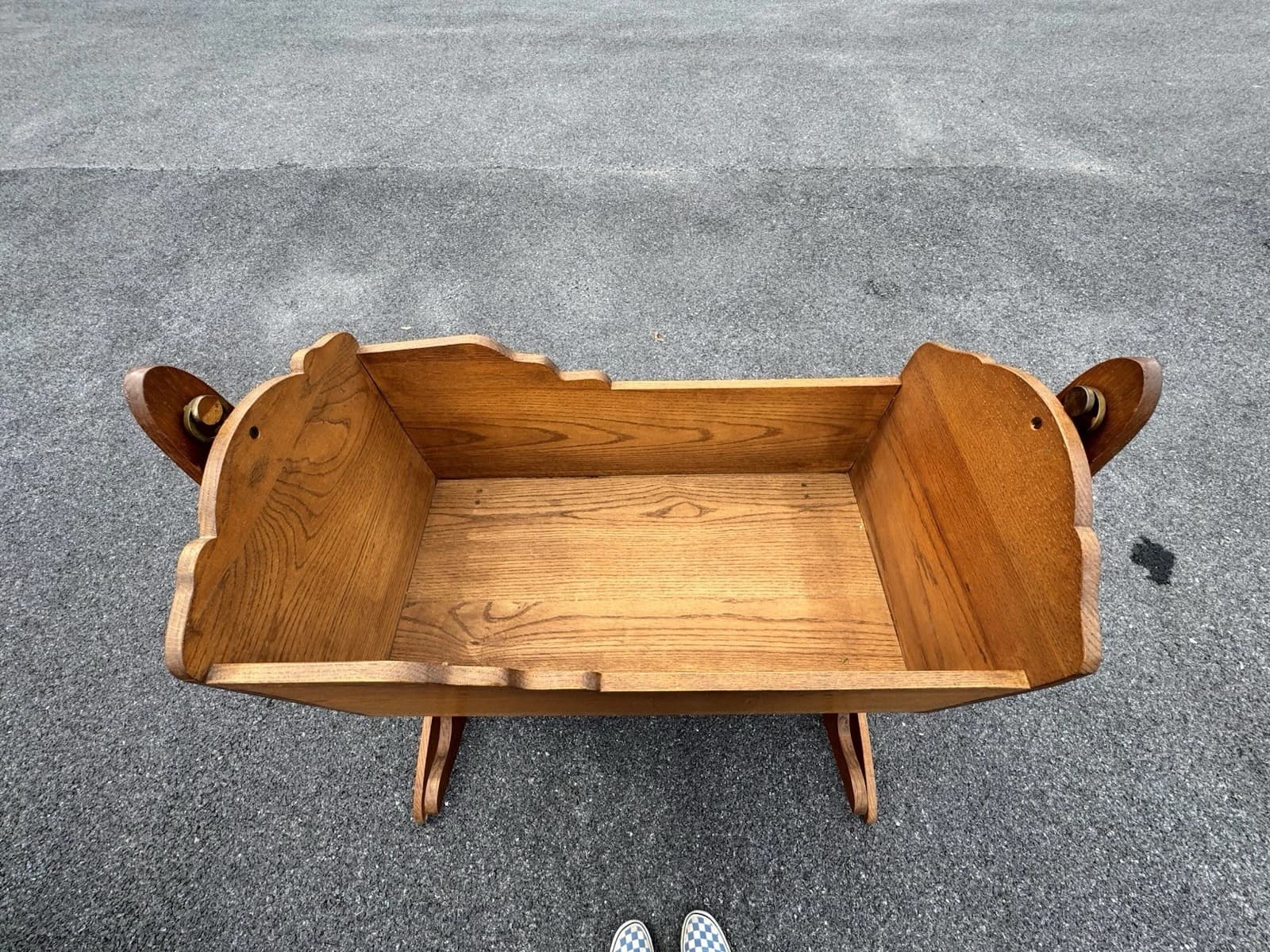

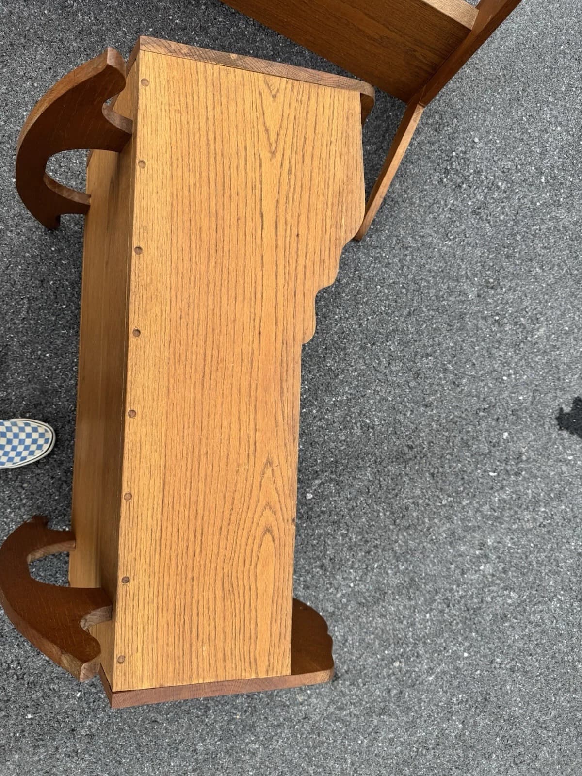

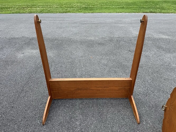

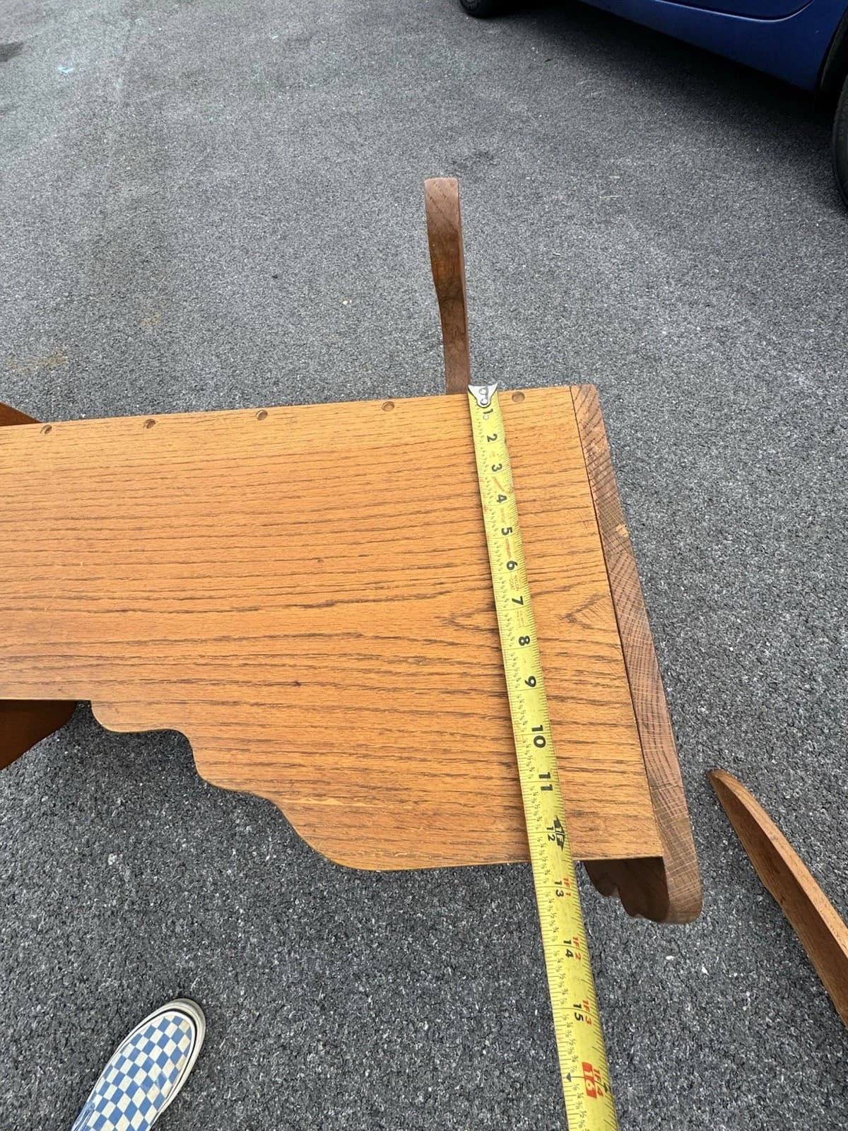

This eBay listing has a number of photos:
several of which include a tape measure, so dimensions and proportions could be easily arrived at:
If that suits, it would be pretty easy to draw up — let us know if you have difficulty doing so — probably the easiest thing to do would be to make a couple of guides for a drill to drill pilot holes and countersinks for screws at the requisite angle and position.
