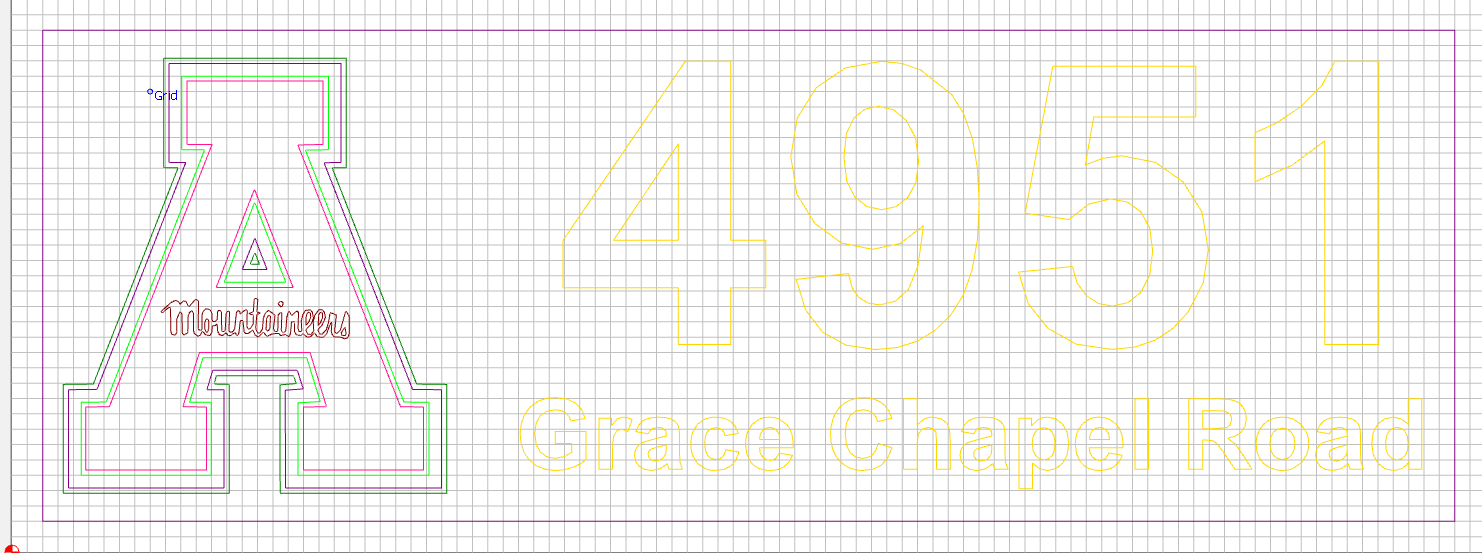

I spent hours yesterday on my first hand built design, getting everything correct. Design, Toolpaths, etc.
Went to open my file on the machine that I run Carbide Motion on and needed to change the stock depth, and everything seems blank.
The files has 1.5M in size… I save often… None of the additional copies will open.

This is the best that can be recovered. It looks like something was funky on your computer as the file was being written, so the data was corrupted. (Network drive, Dropbox/Google Drive, or a thumb drive got removed before the operating system synced everything?)
Thank You… Any thing I can do to fix the files? Looks like all of the ones I saved yesterday have the same issue.

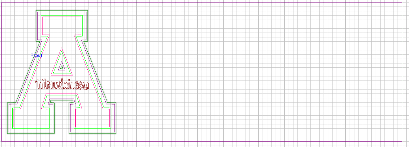

Give you a weird one… When I opened the recovered file in Build 842, I get what you see… Since 843 was released, I updated then was only able to see the “A” image… Looks like a big change in file format between the two versions.
Version From 842:
The only file format change in the last year or two has been to add the Cutout toolpath.
We’re up to 853, though, and it’s worth upgrading.
Sorry The lost info was from the new version… 853… Good news I am really learning the software… :slight_smile:
