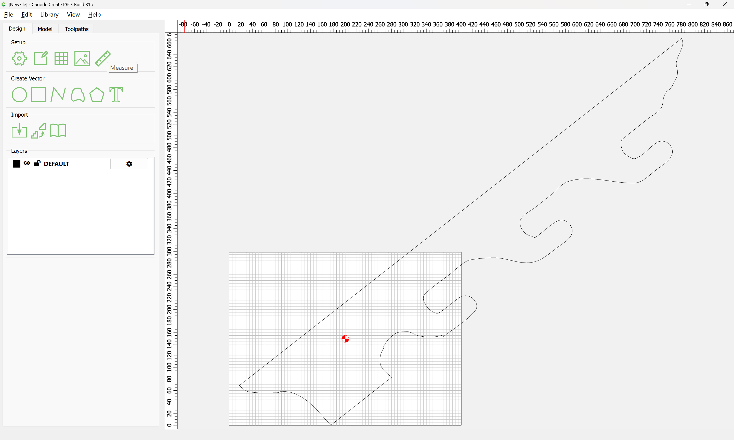

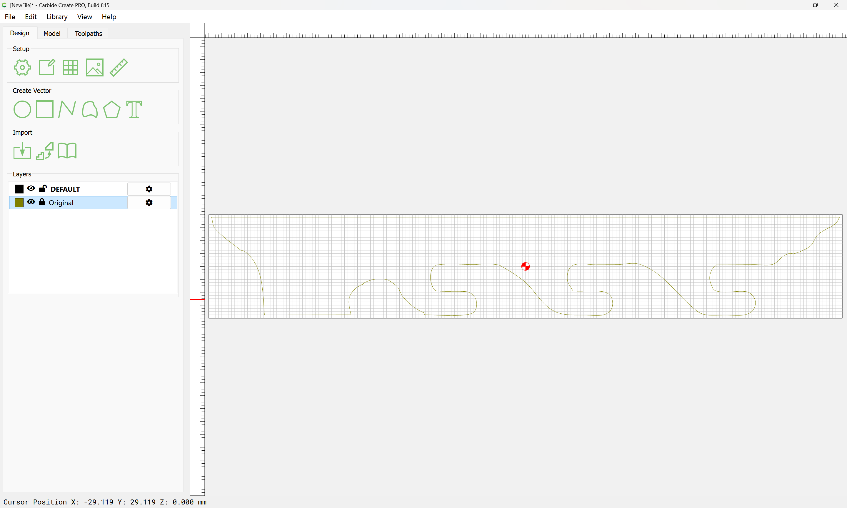

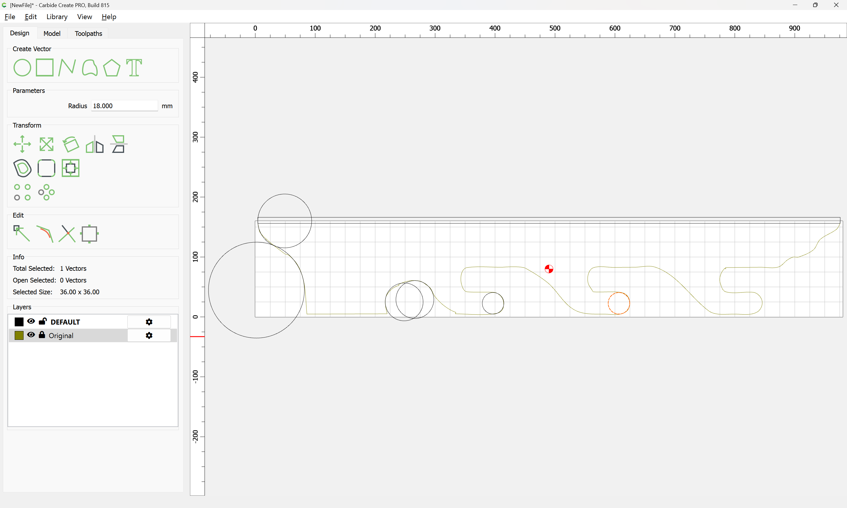

Hello all,

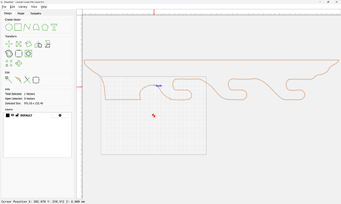

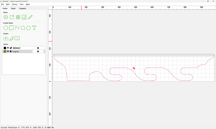

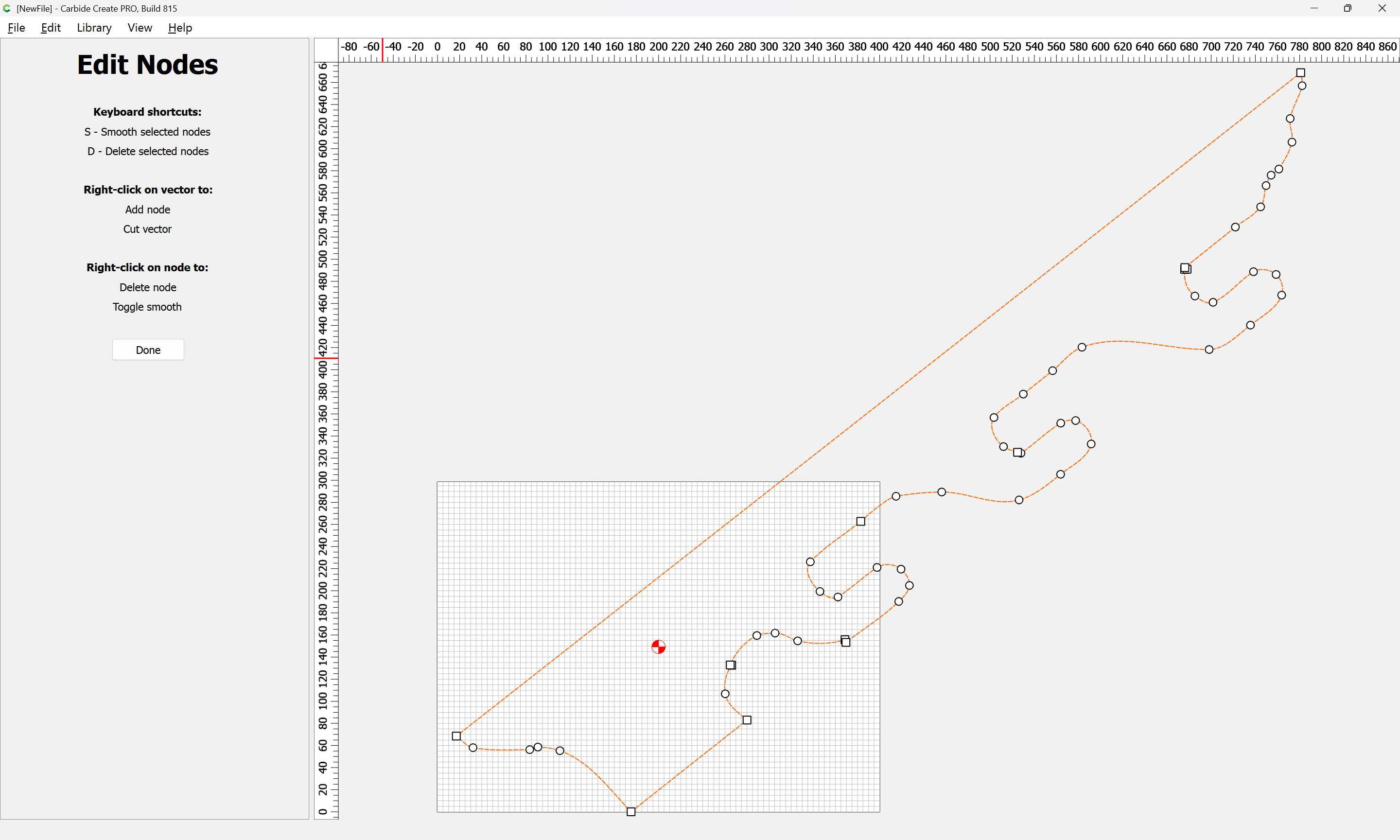

Trying to clean up a file. I was able to copy this file from a JPEG but is has issues after the fact, I was wondering if someone would be so kind as to point me to the command to help me smooth the final vector our or maybe point me to an instructional video using carbide create. Ill upload the file so that you can see what Im trying to accomplish. Its rater ragged after creating it.
thanks,
Tracy

If you’re just looking to smooth out the jags, node editing should do it. Delete a few nodes then nudge the remaining nodes to get the shape you want. If it’s functional & needs specific dimensions I think it’s easier to draw it from scratch.
It is one side of a gun rack that you would hang on a wall. I used the trace fuction to copy the jpg to and svg but it let it kind of ragged. I thought I uploaded a pic…will try again.
thx
If the image is small, the “jaggies” will be worse.
The final product will be large about 38 inches long. Tod got me going. It has been awhile I just needed a reminder that it was node editing that I needed to use. Its been awhile but I think I got it now…thx folks

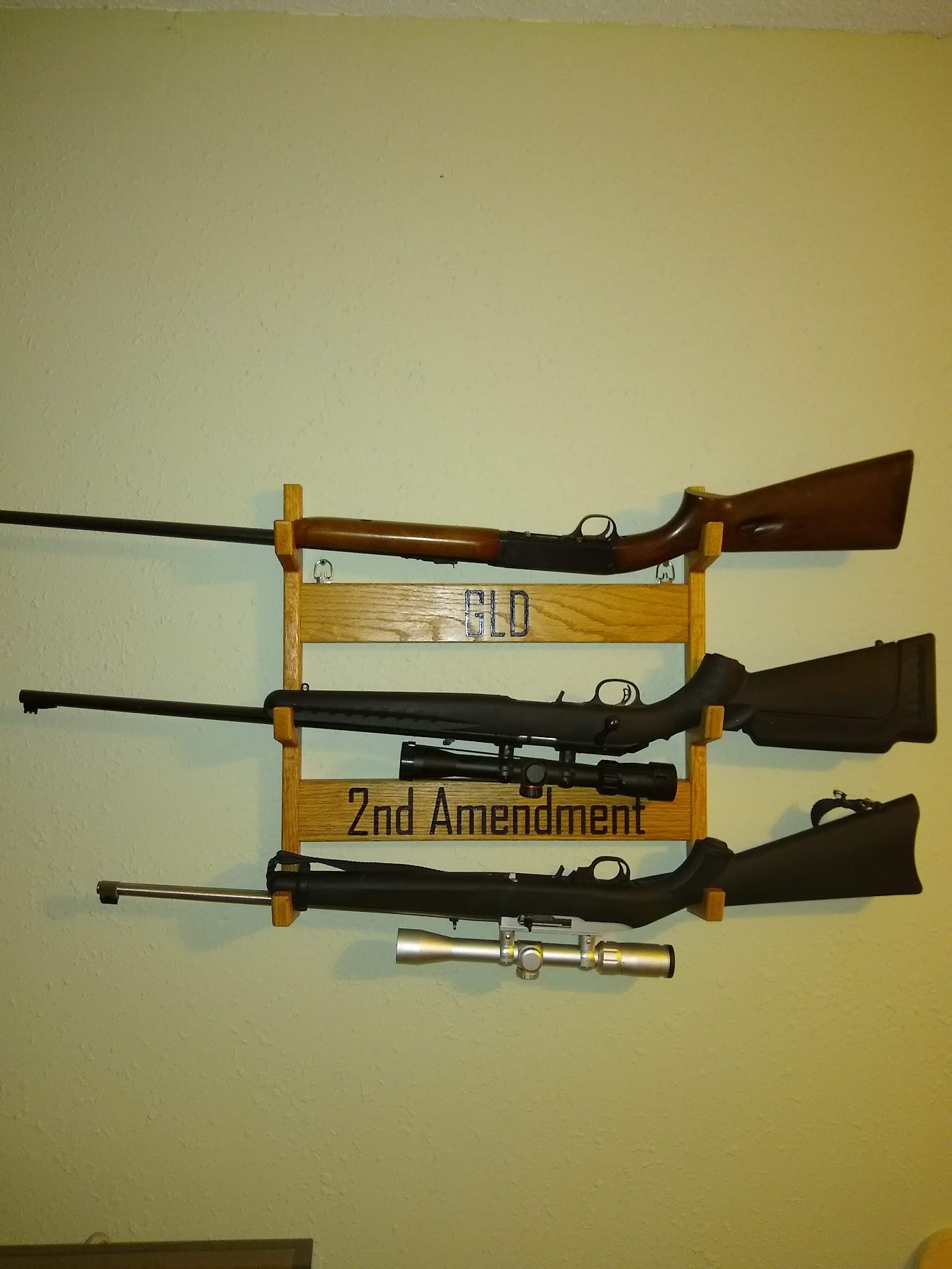

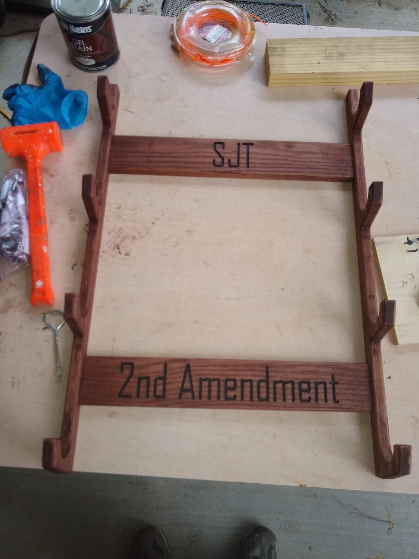

Here are two files for a 3 gun rack and a 4 gun rack. Modify them as you wish. I made these in earlier CC but opened in v7 CC and saved them. You can see my spaces for the gun to hang are much larger than the ones in your picture.
3_gun_rack_v7.c2d (96 KB)
4_gun_rack_v7.c2d (80 KB)

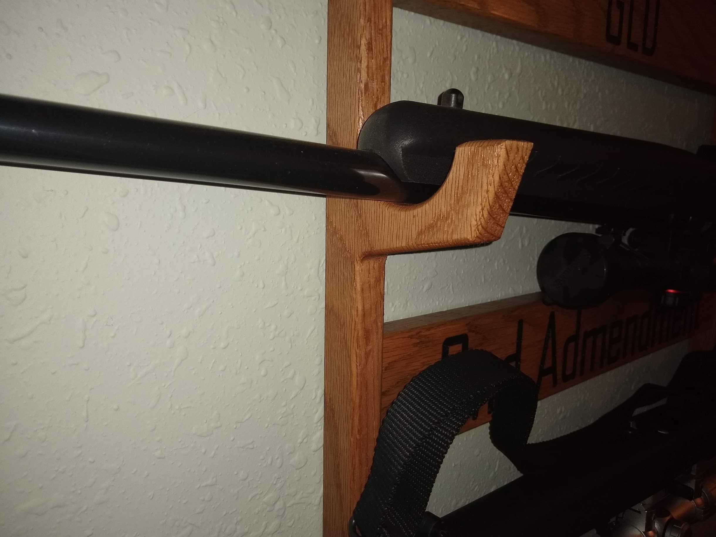

For my gun racks I used pocket screws to hold the pieces between the gun racks.
FYI Guns can be quite heavy. Notice that my hangers are at 16" spacing to match wall studs so I get my gun rack screwed into a stud for maximum weight capacity. So likely a gun rack would be wider than 16" but make sure it is wide enough to hang your gun on the crook of the stock and wide enough to get to the other side.

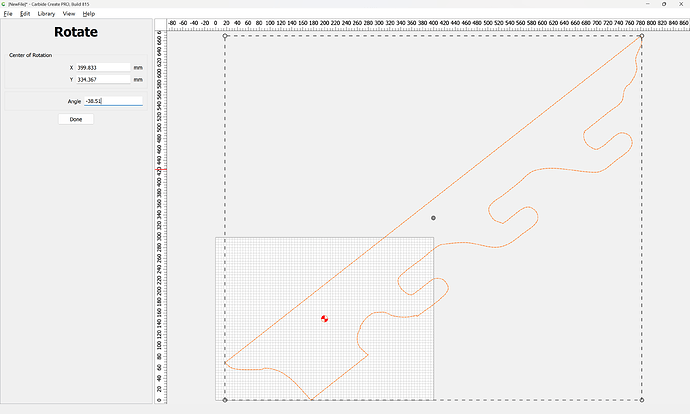

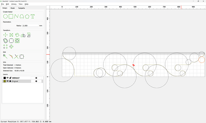

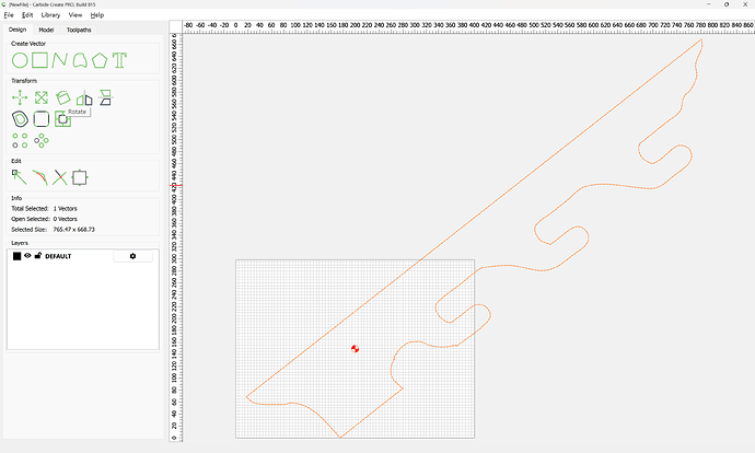

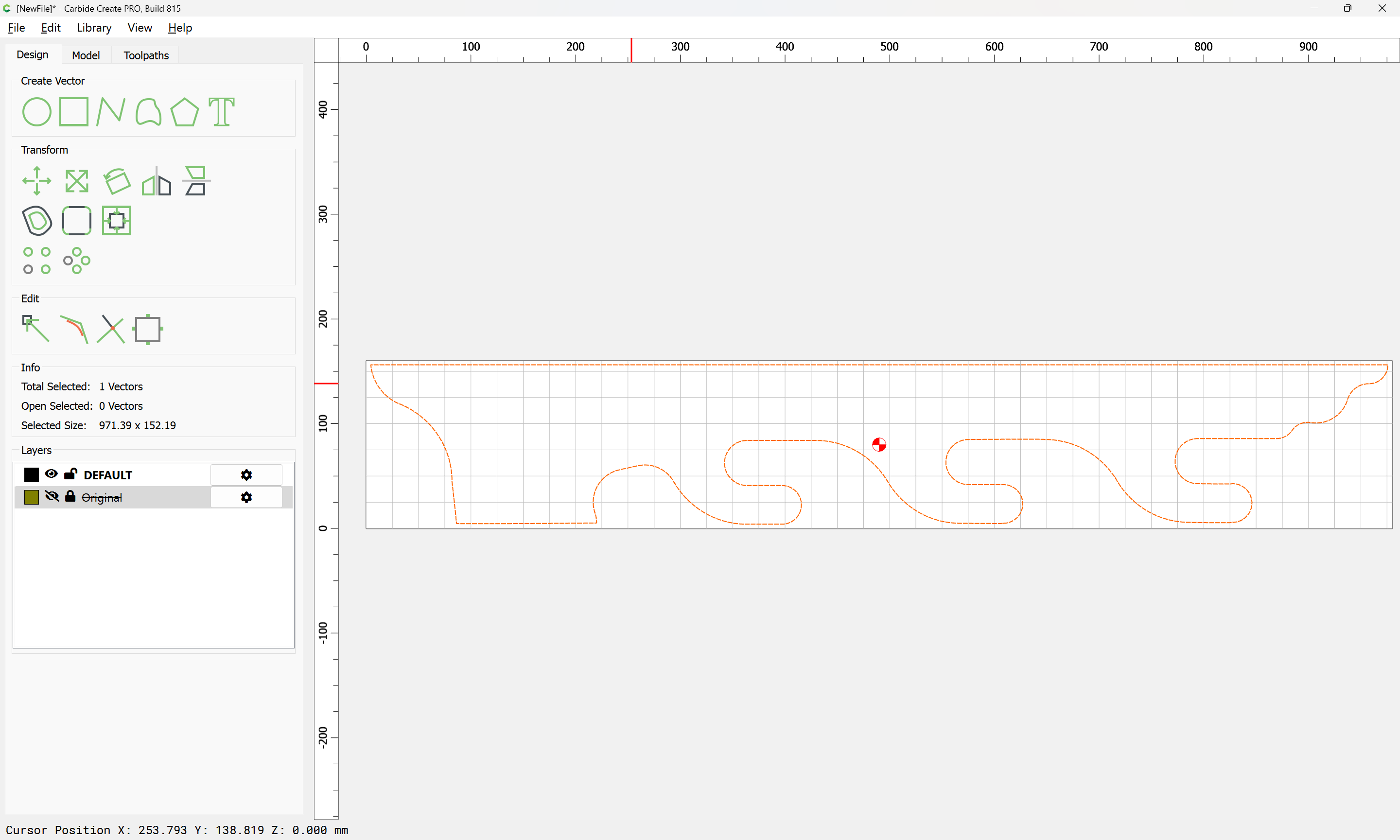

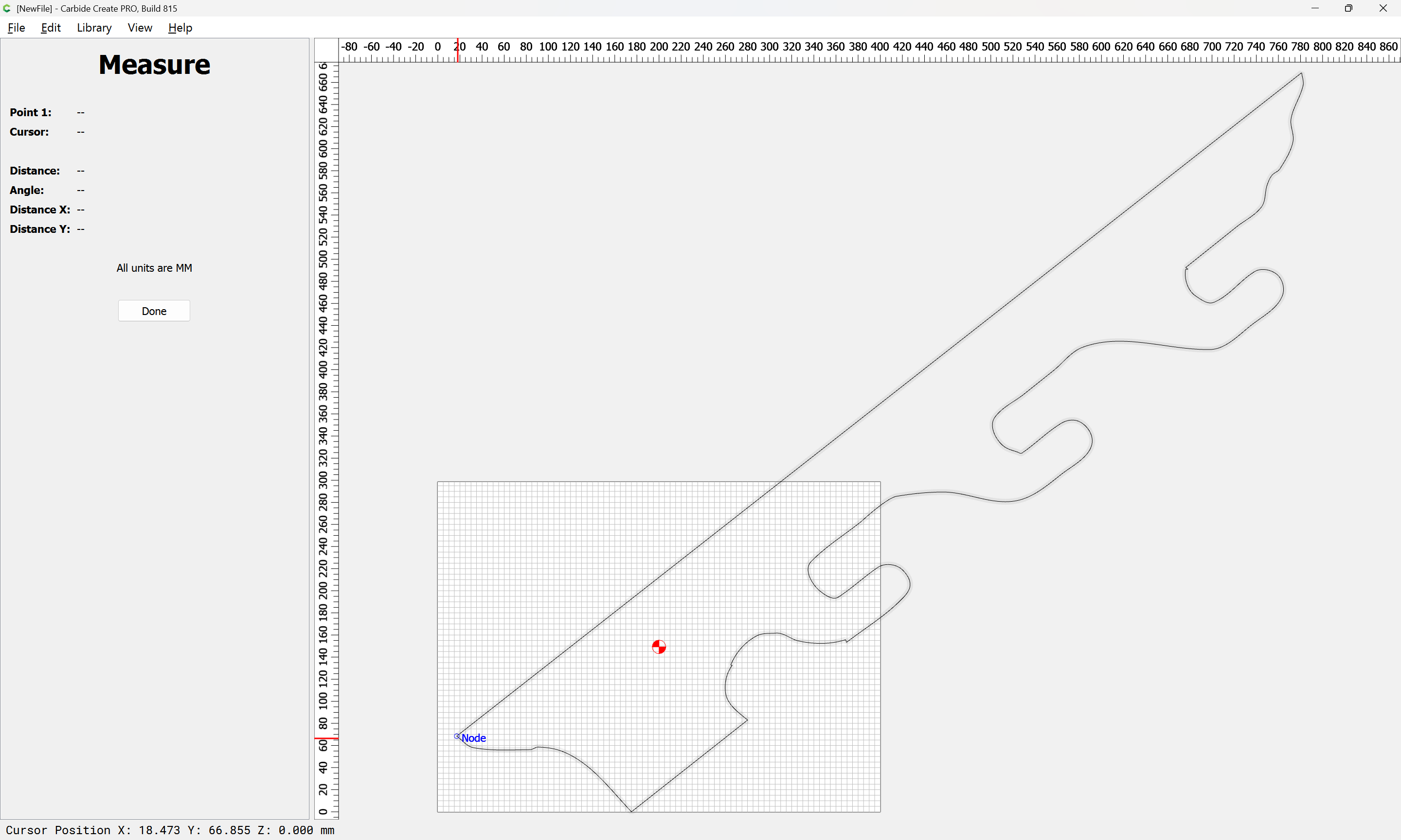

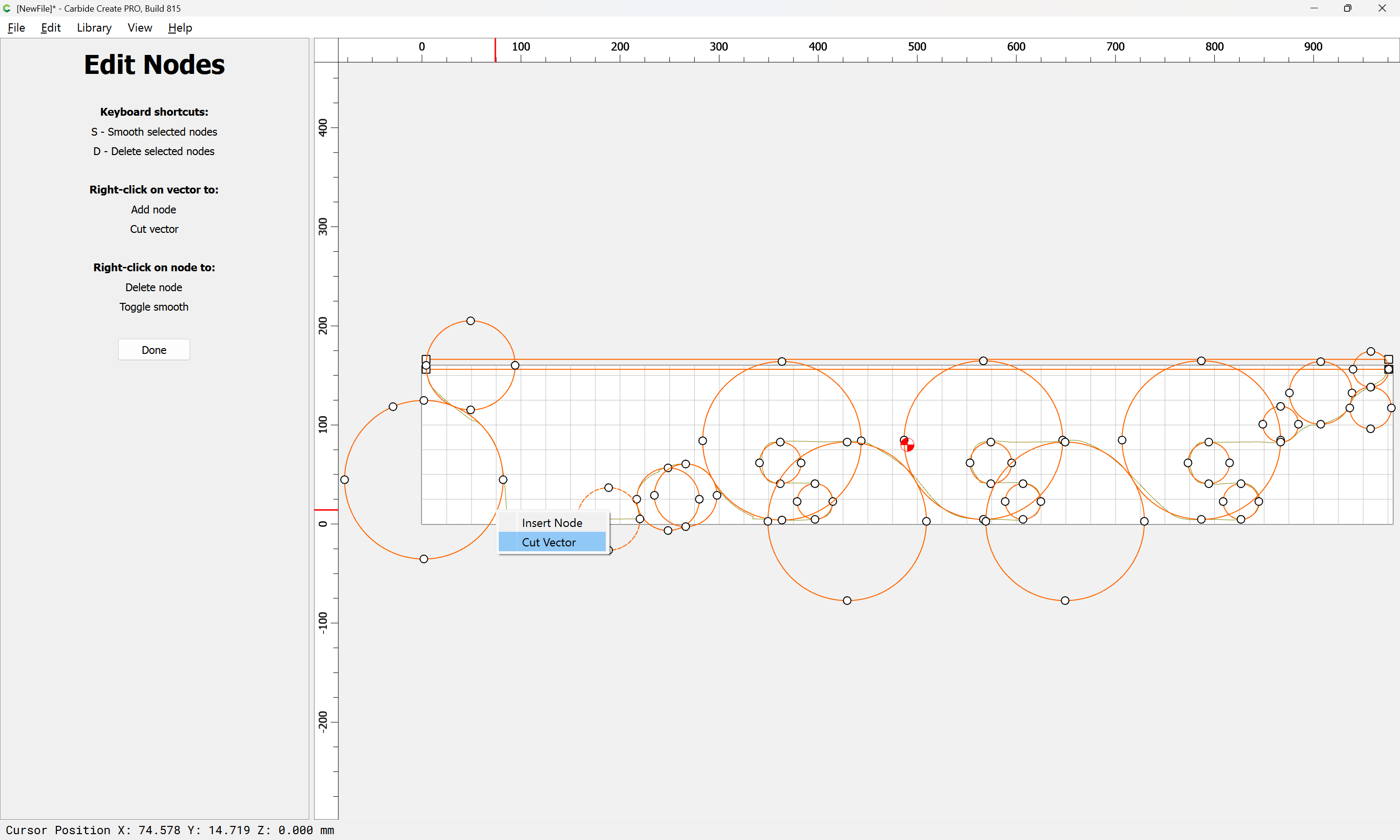

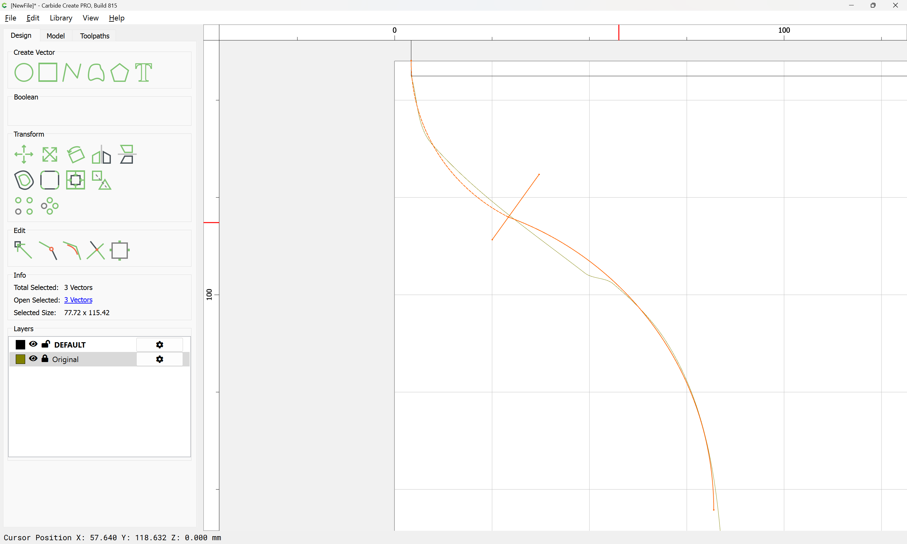

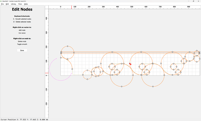

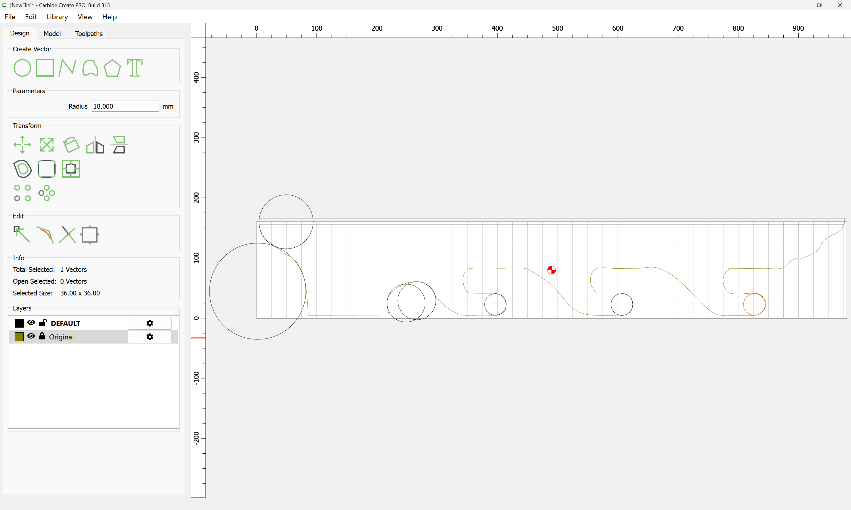

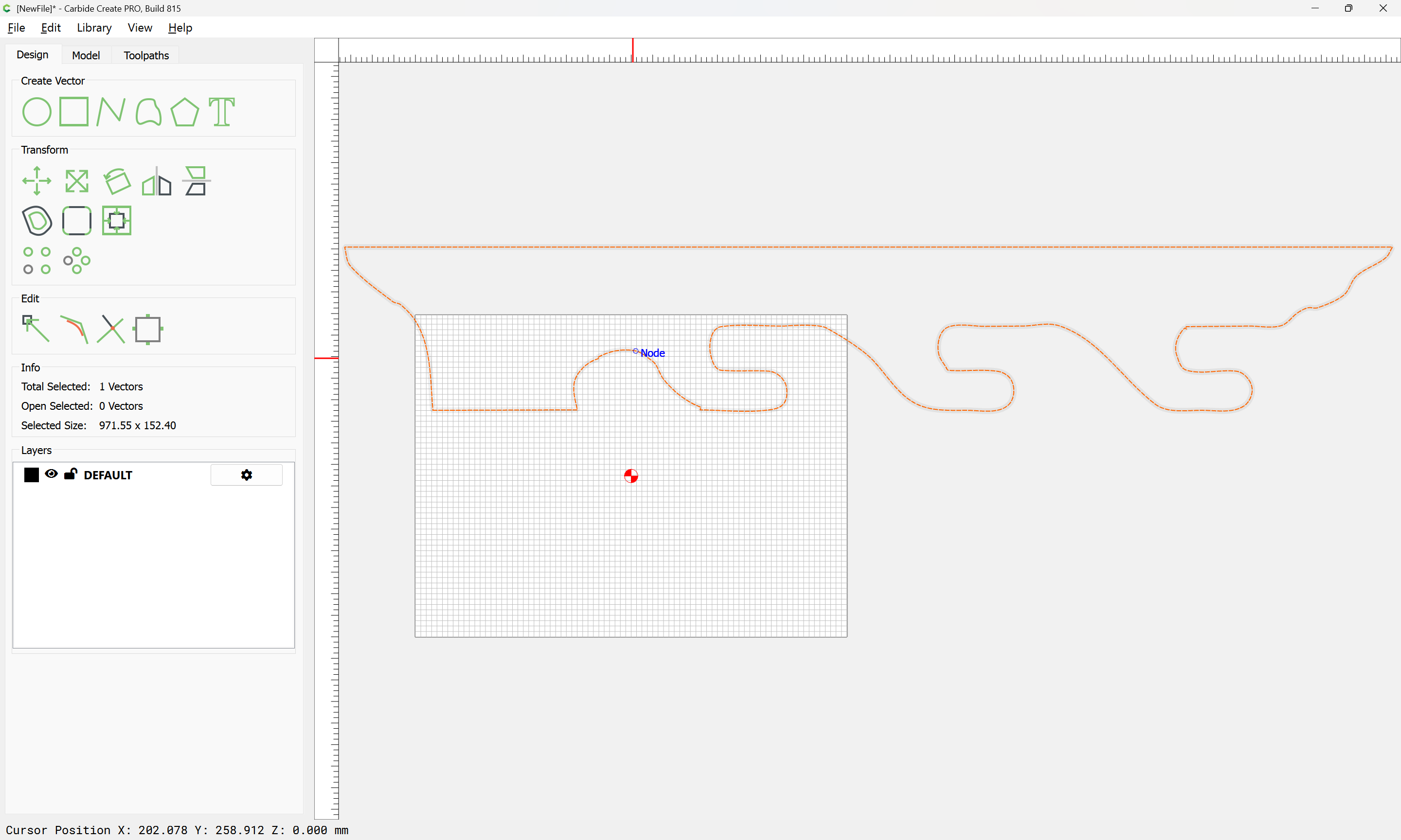

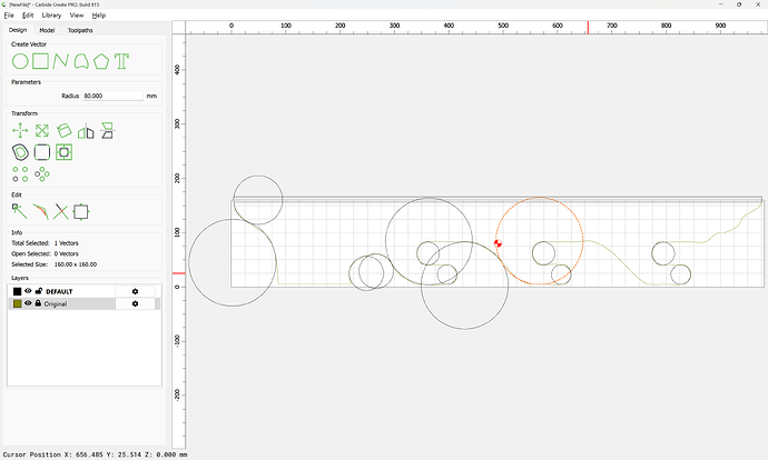

Opening your file we get:

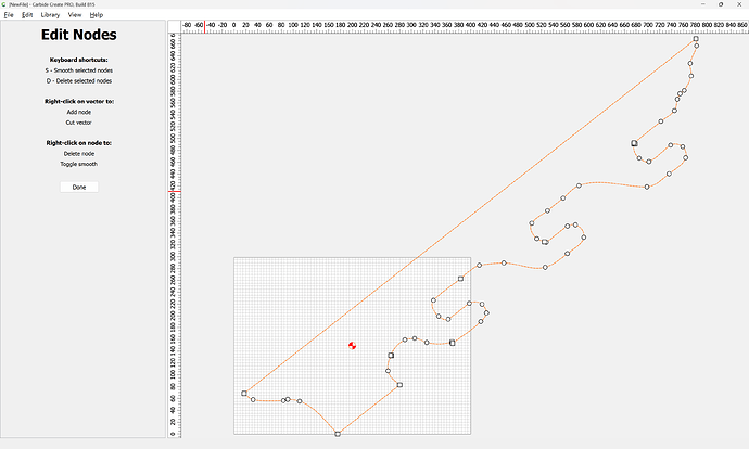

aw(when examined in the Node Editor)

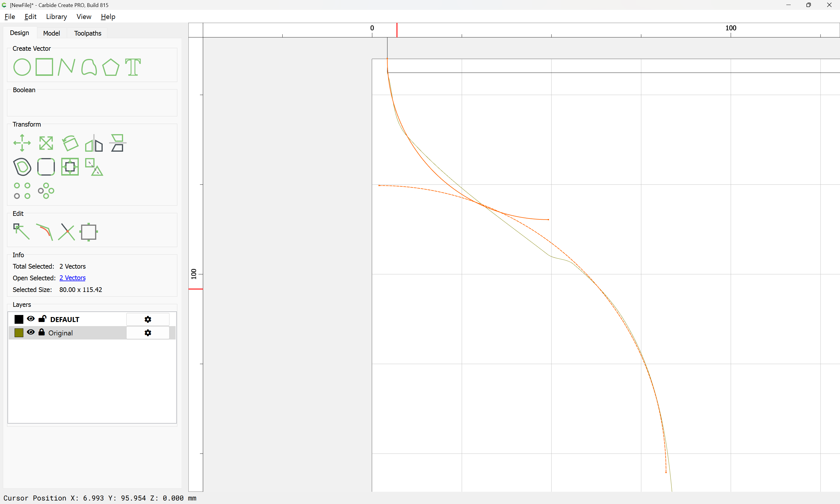

Most things which are geometric in form are best re-drawn…

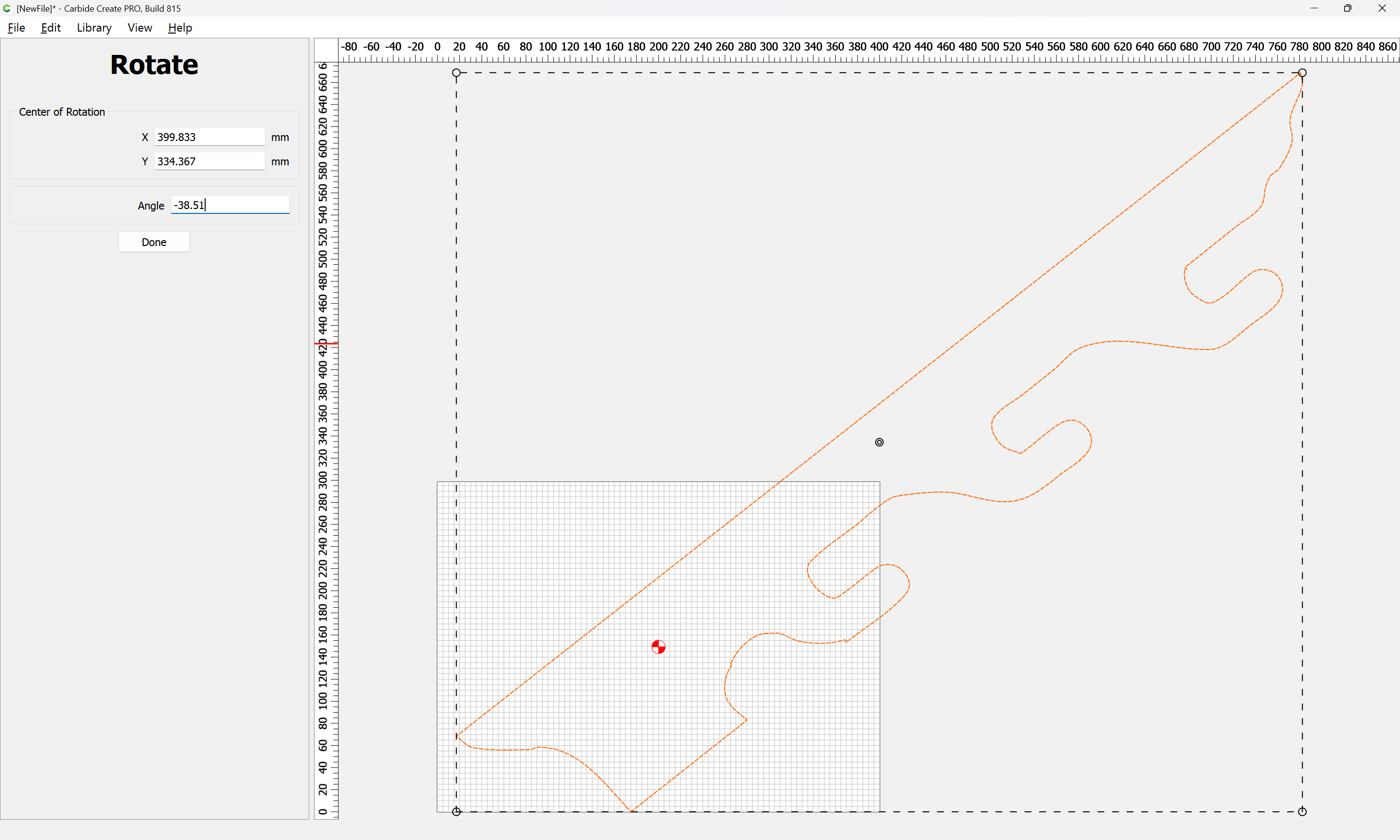

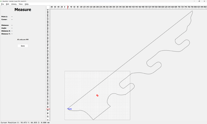

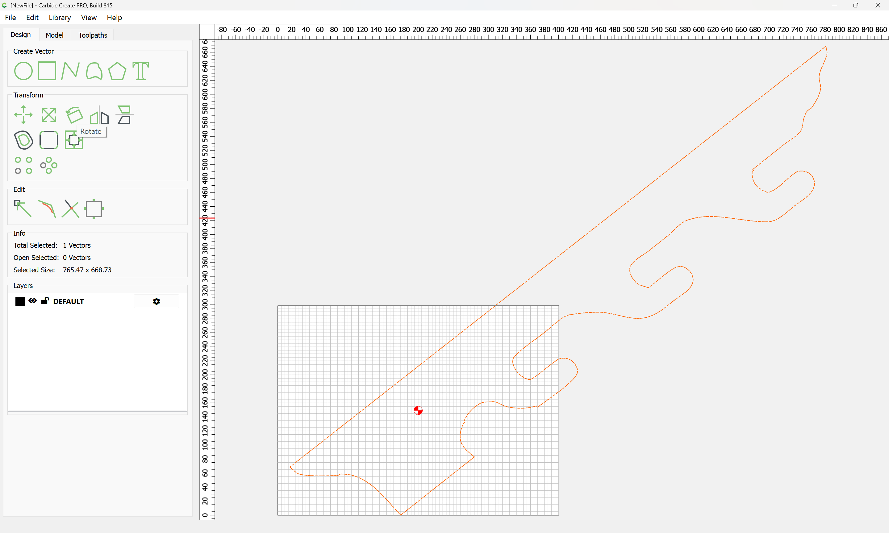

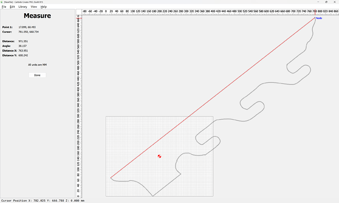

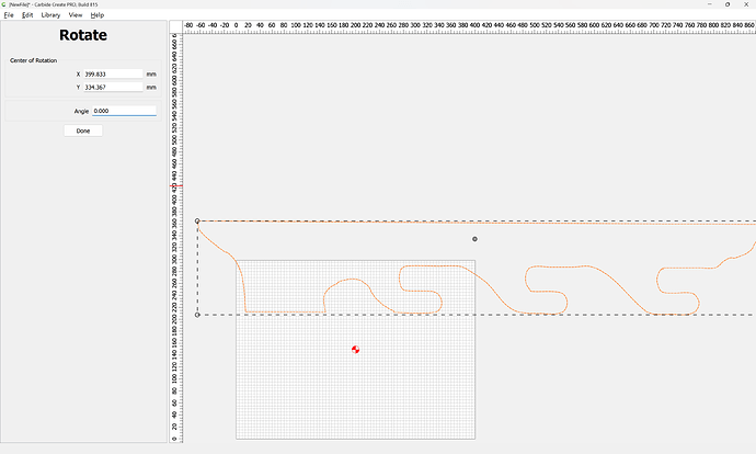

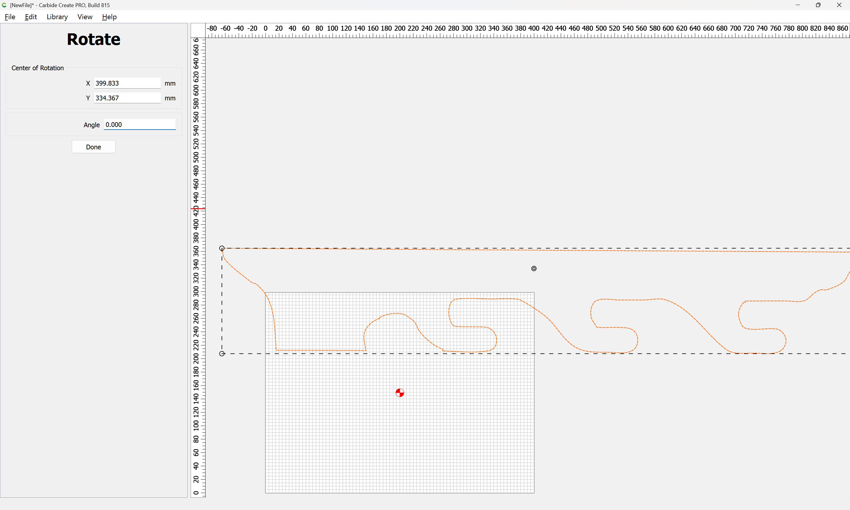

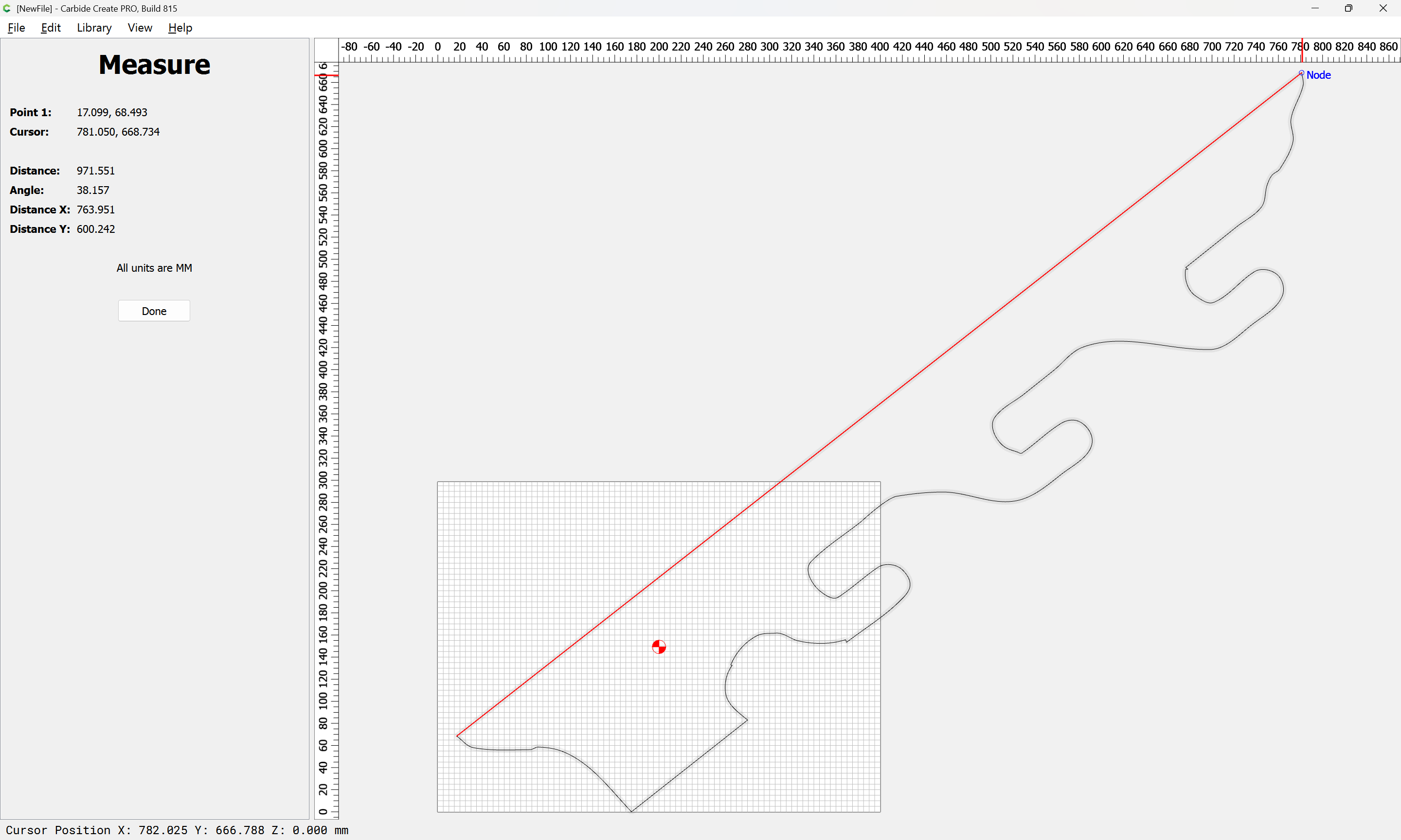

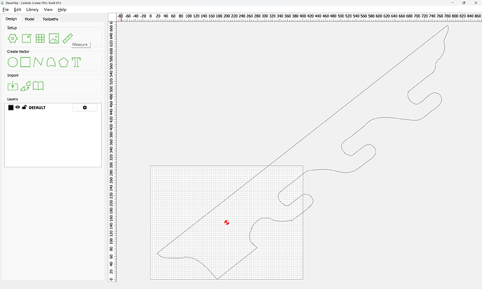

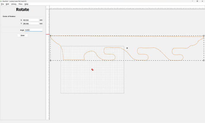

First, measure the angle:

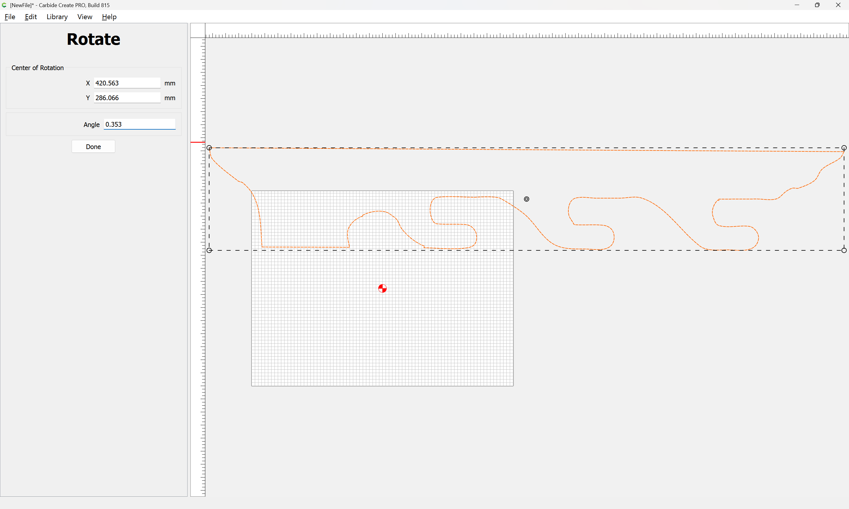

Then rotate it to be orthogonal to the Cartesian coordinate system:
adjusting if need be:

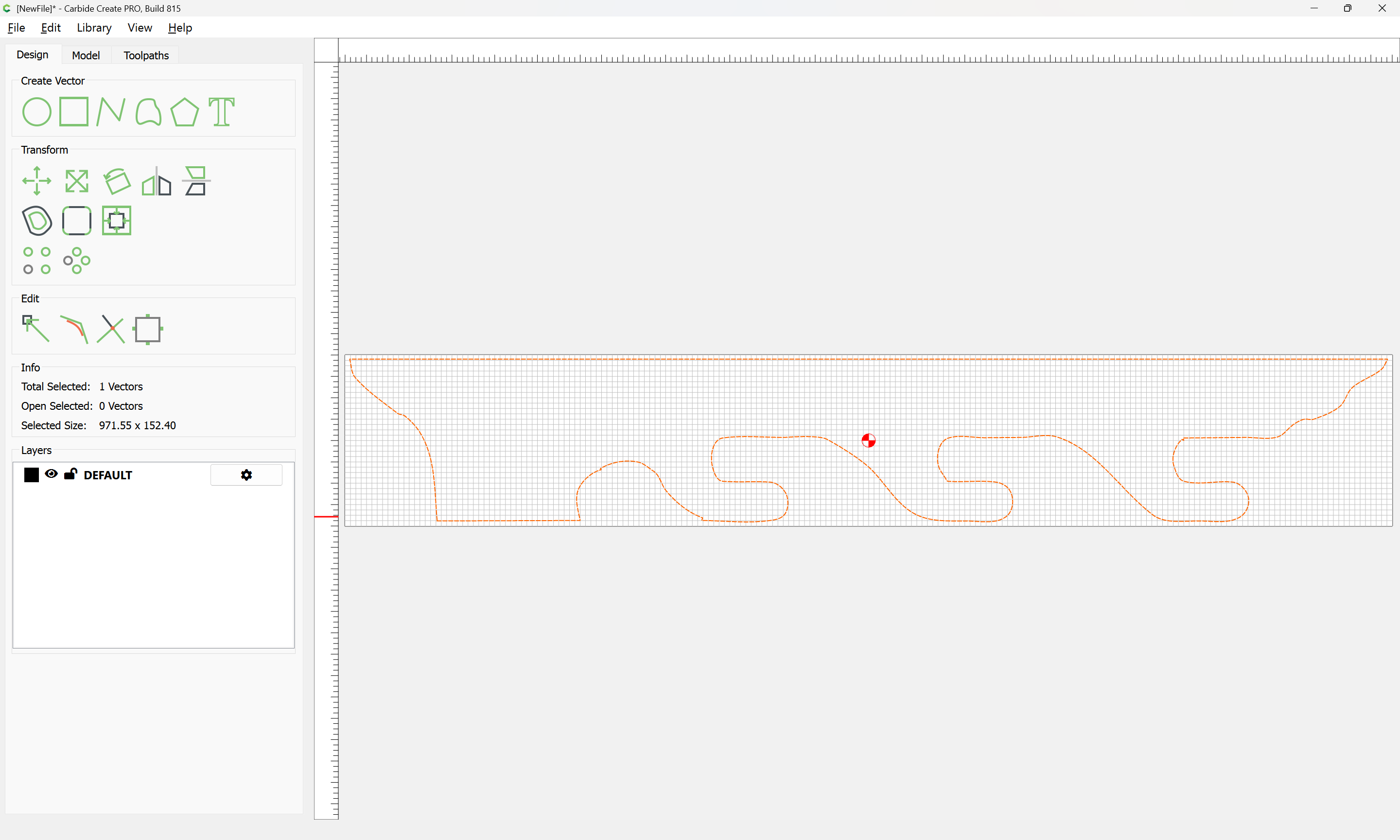

then adjust Job Setup and positioning:

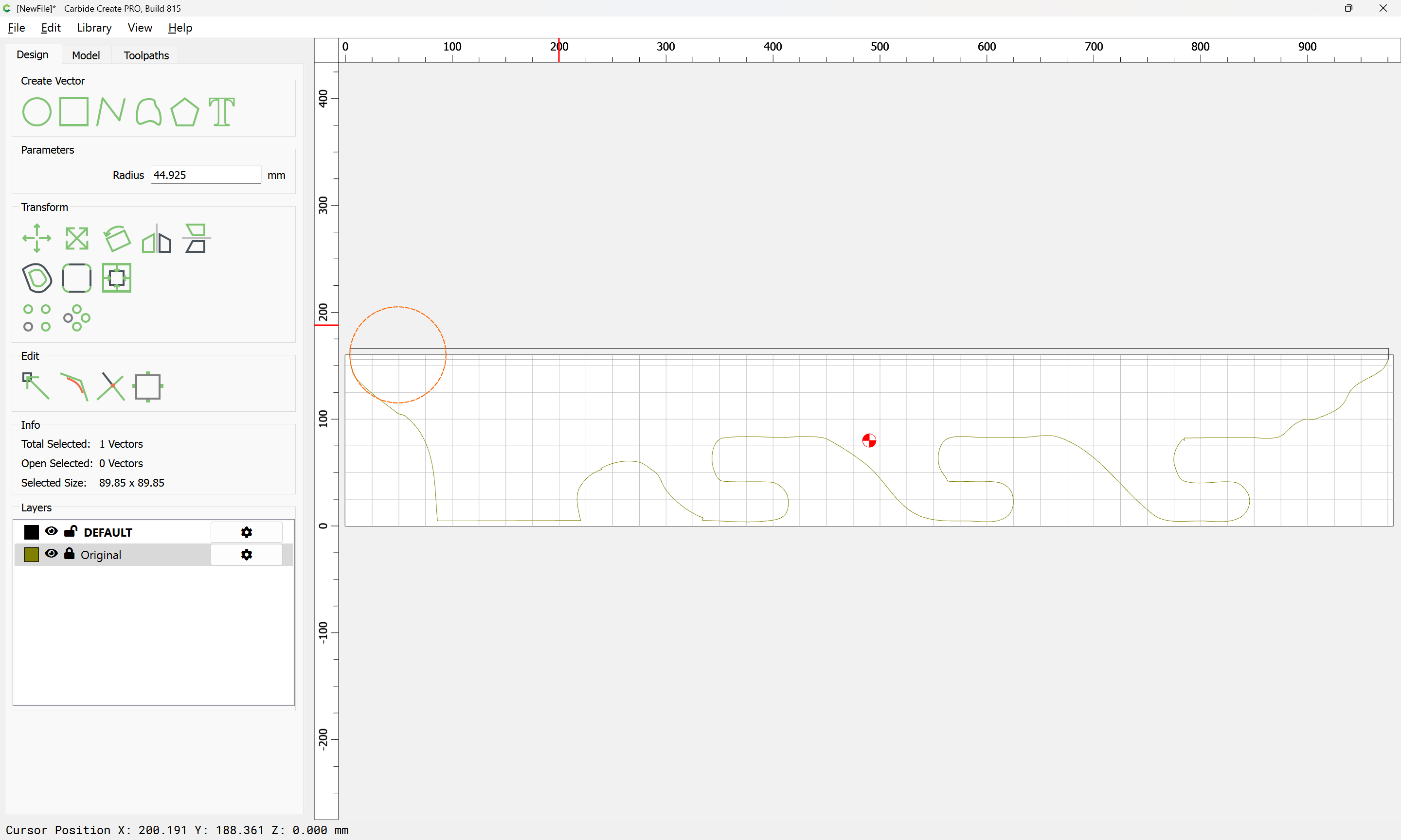

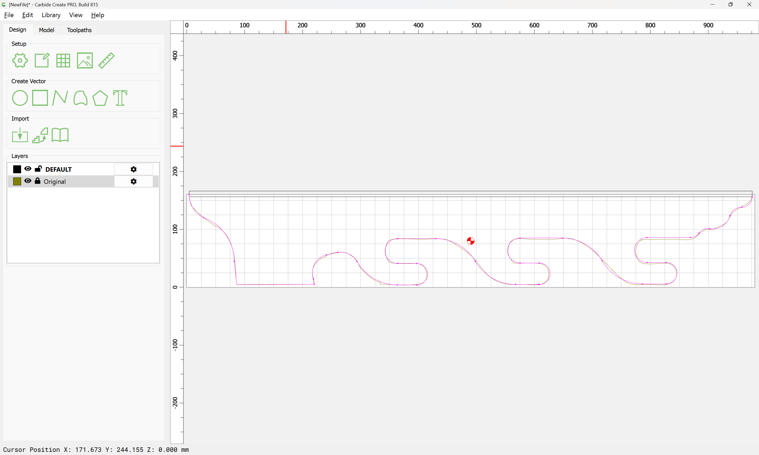

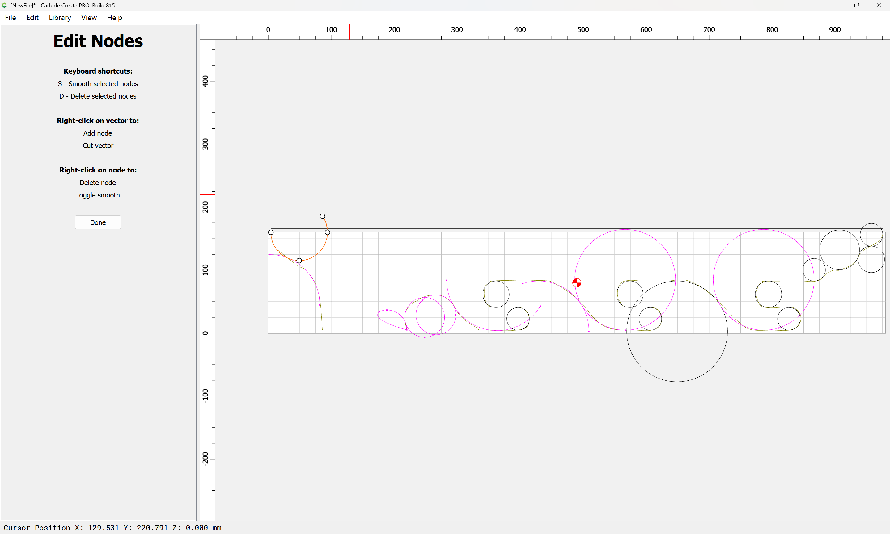

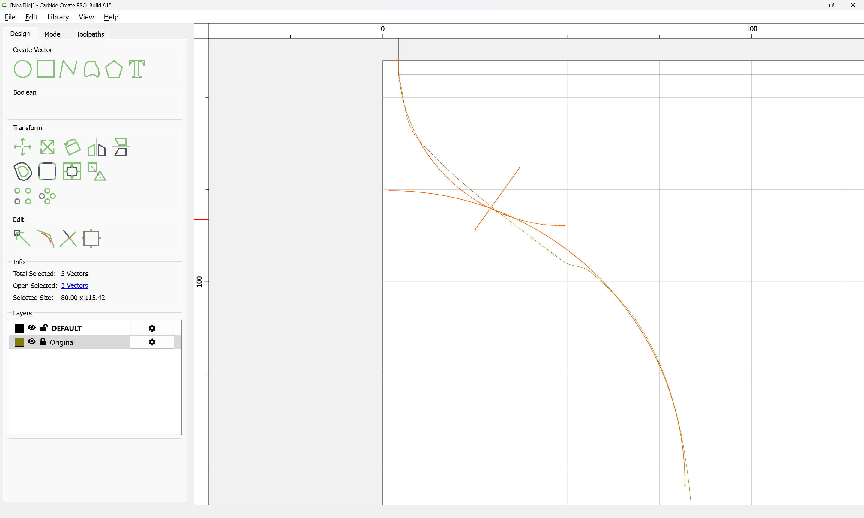

Make a new layer and put the original on it:

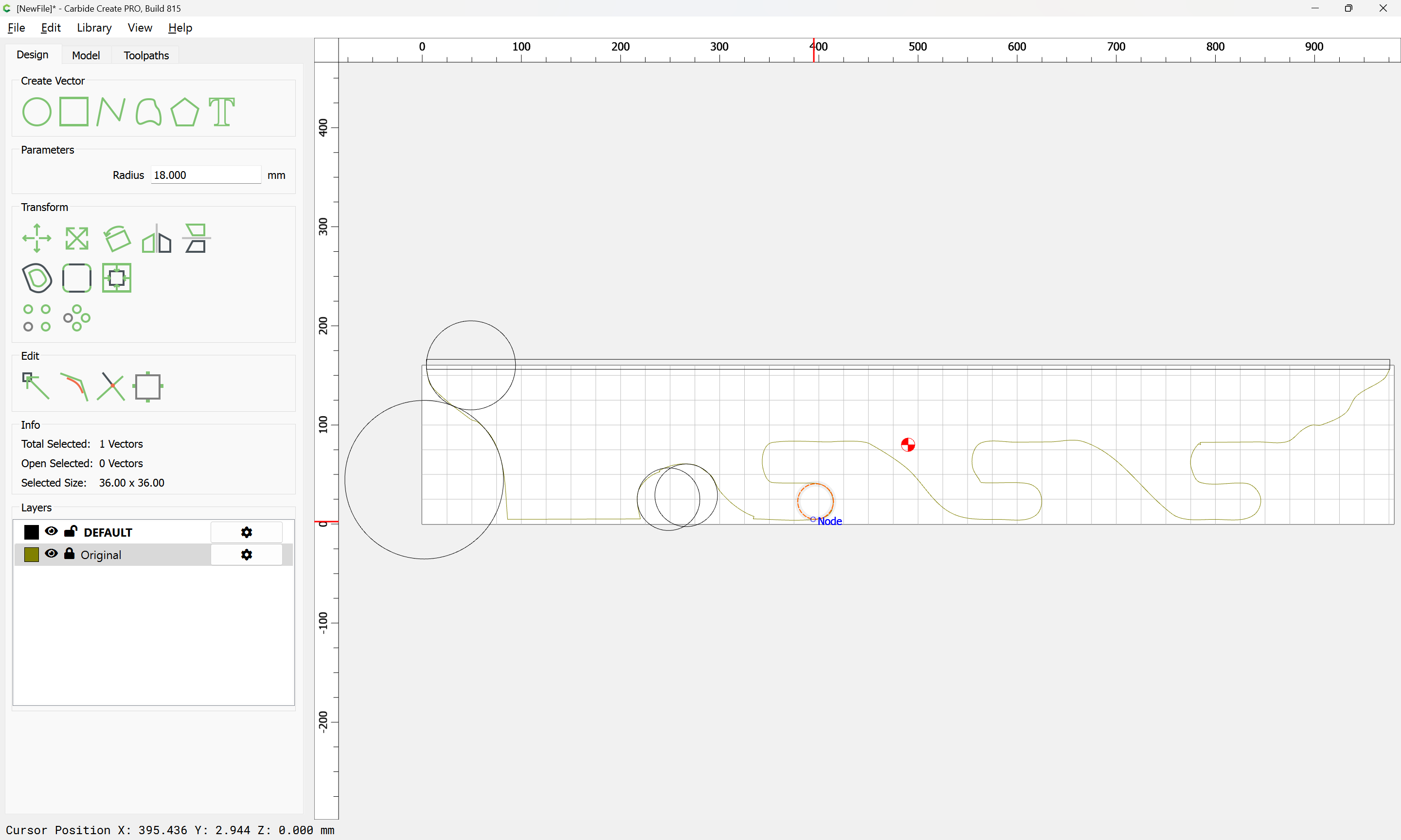

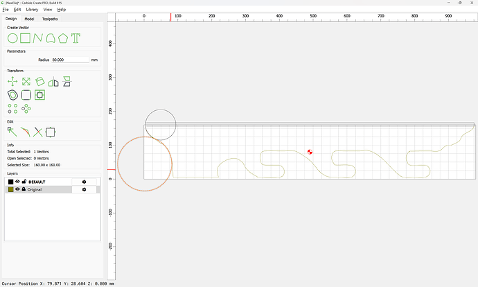

Then re-draw.

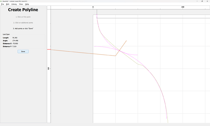

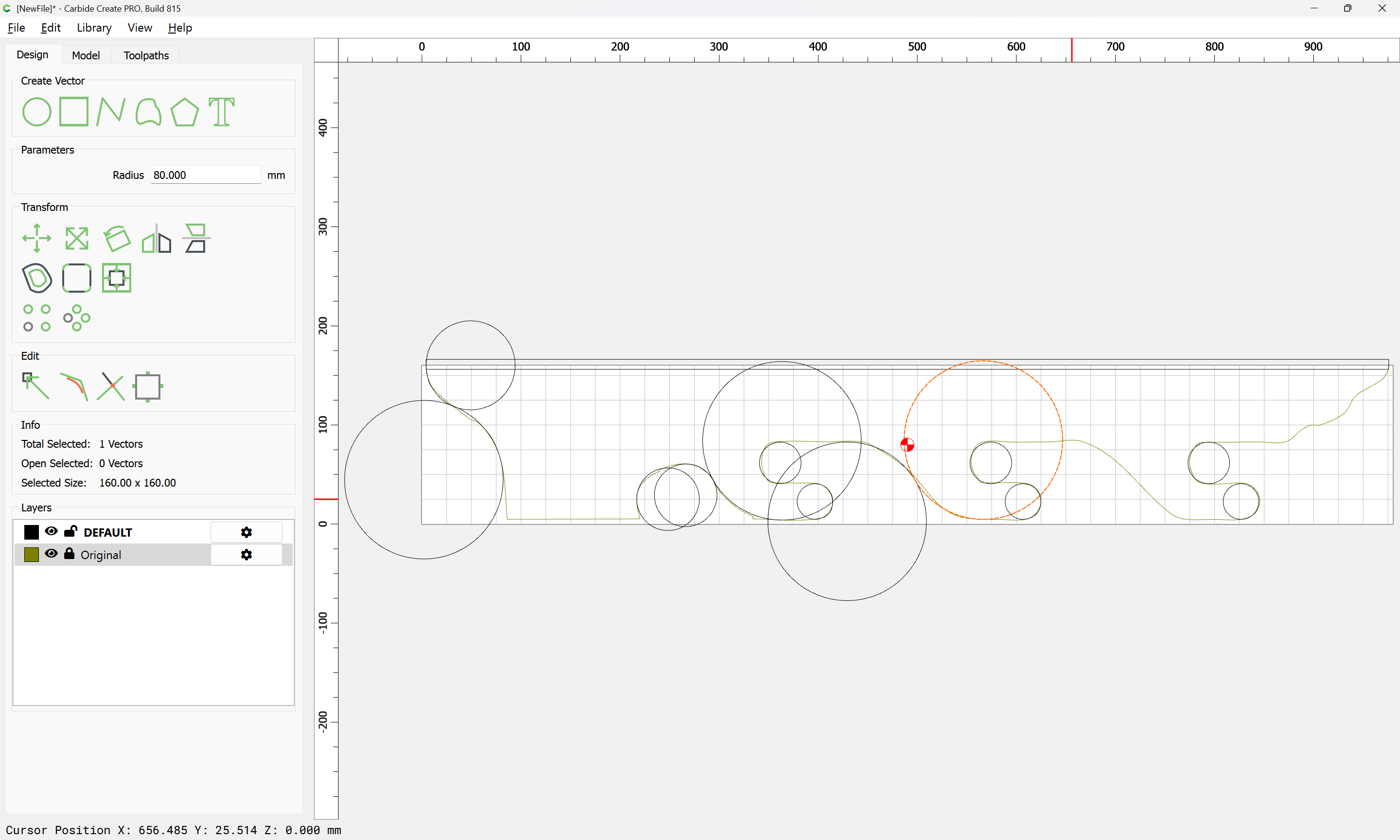

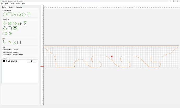

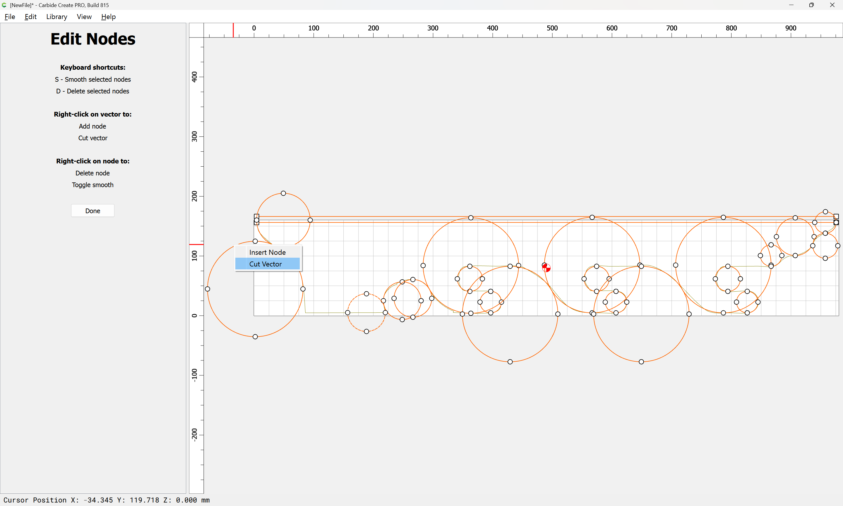

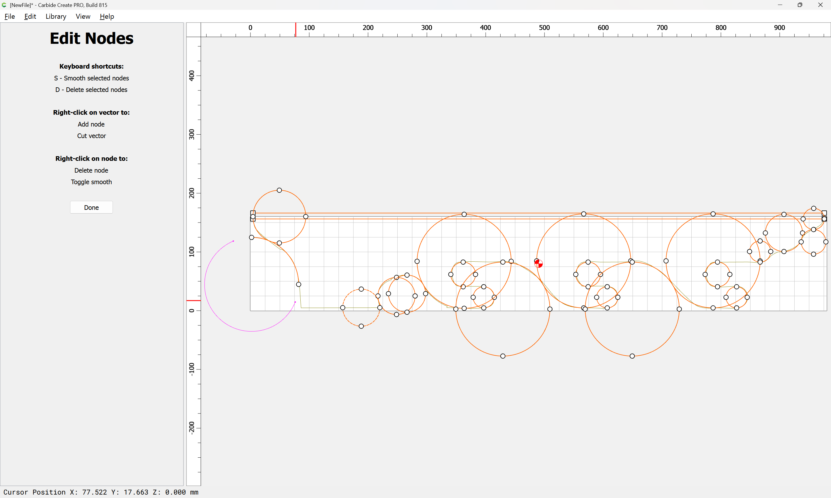

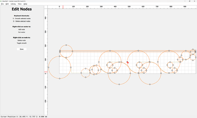

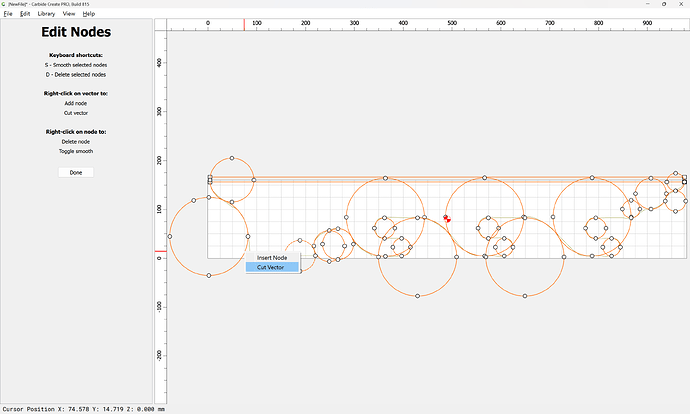

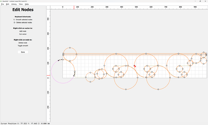

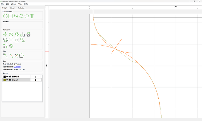

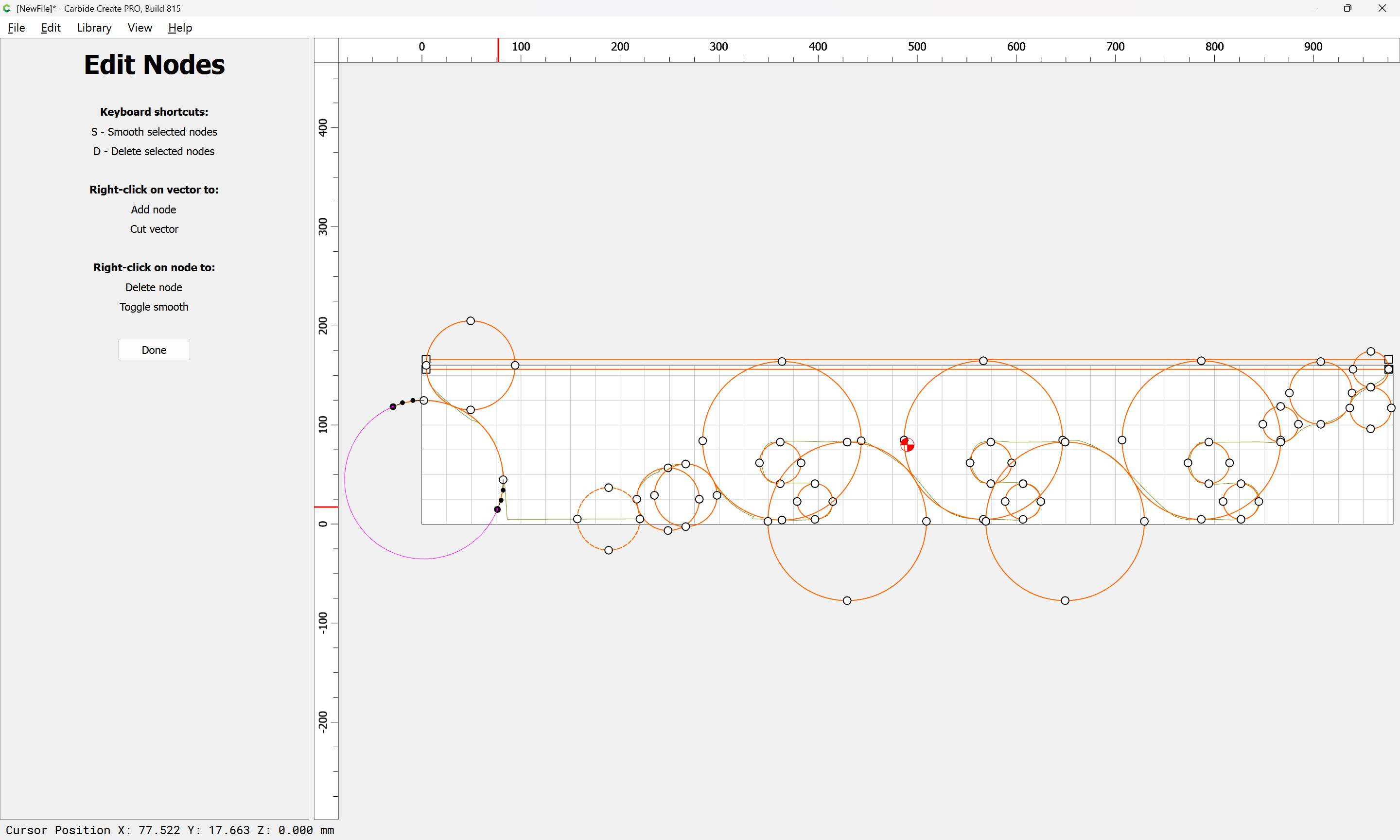

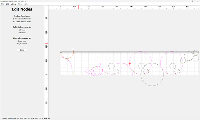

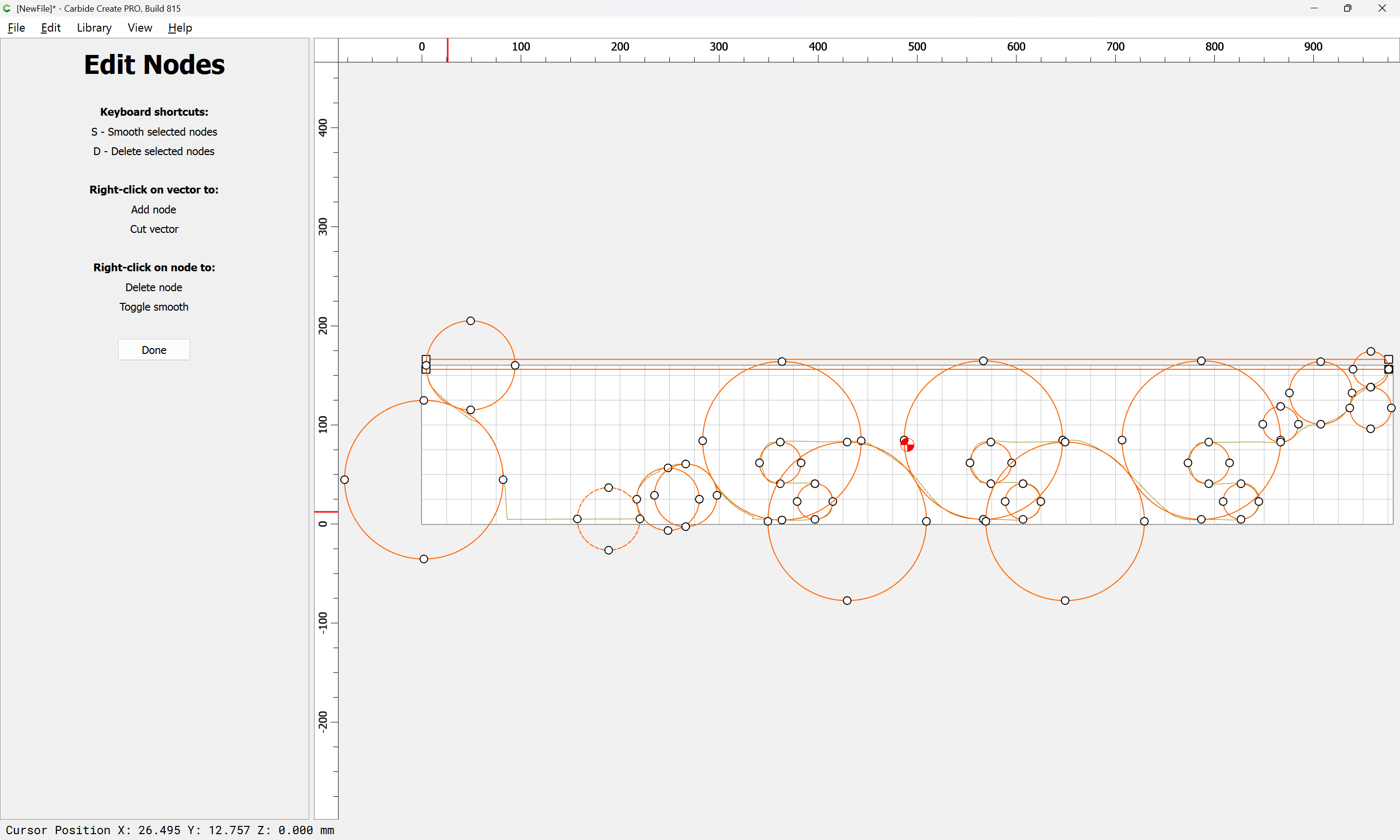

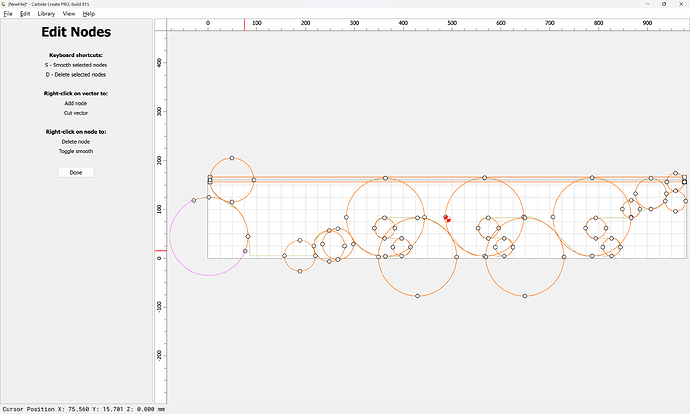

Then, go into Node Edit mode and cut away what is not wanted:
d to delete
Note that it may be necessary to exit and return to Node Editing after making a new selection, depending on which side of a cut operation remains active in the Node Editing operation:

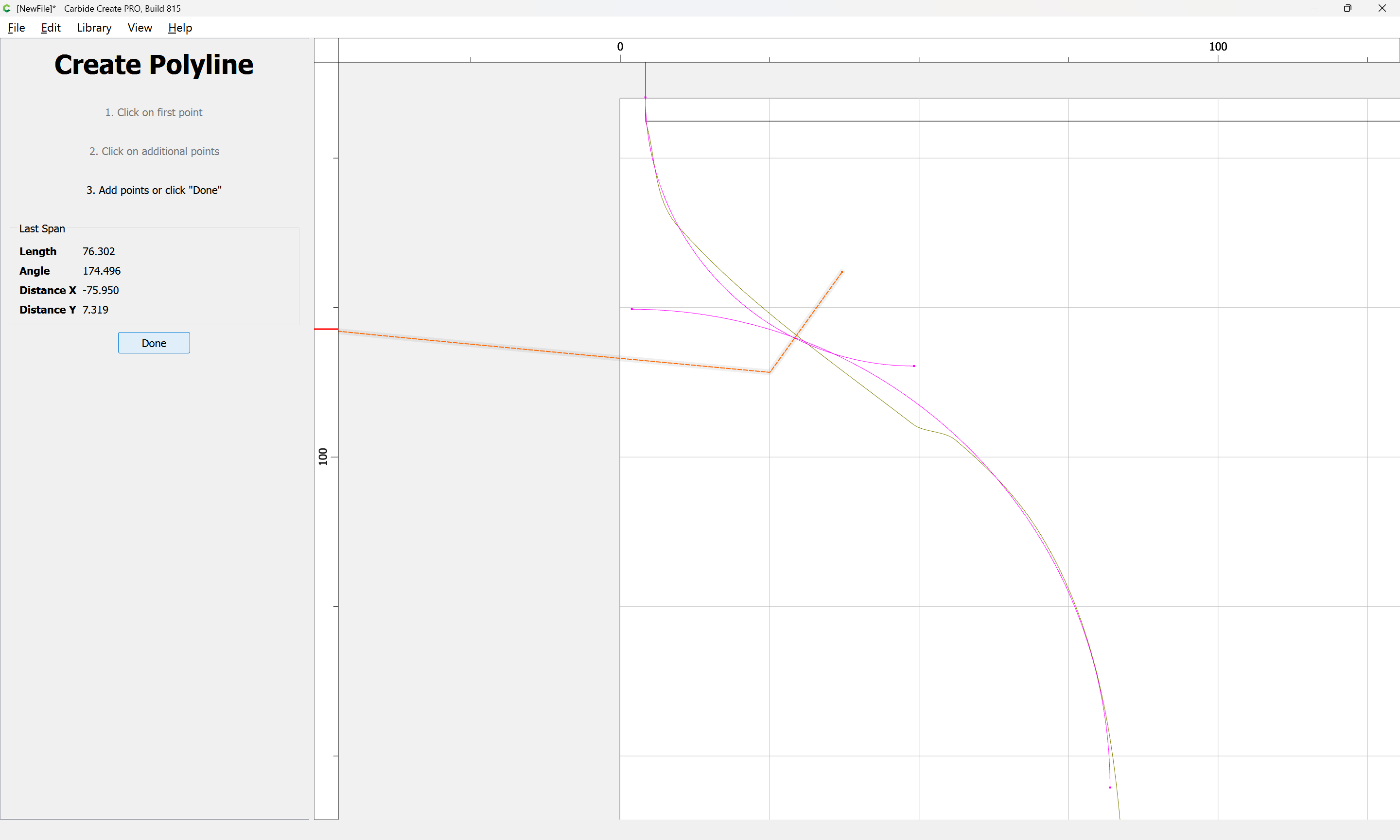

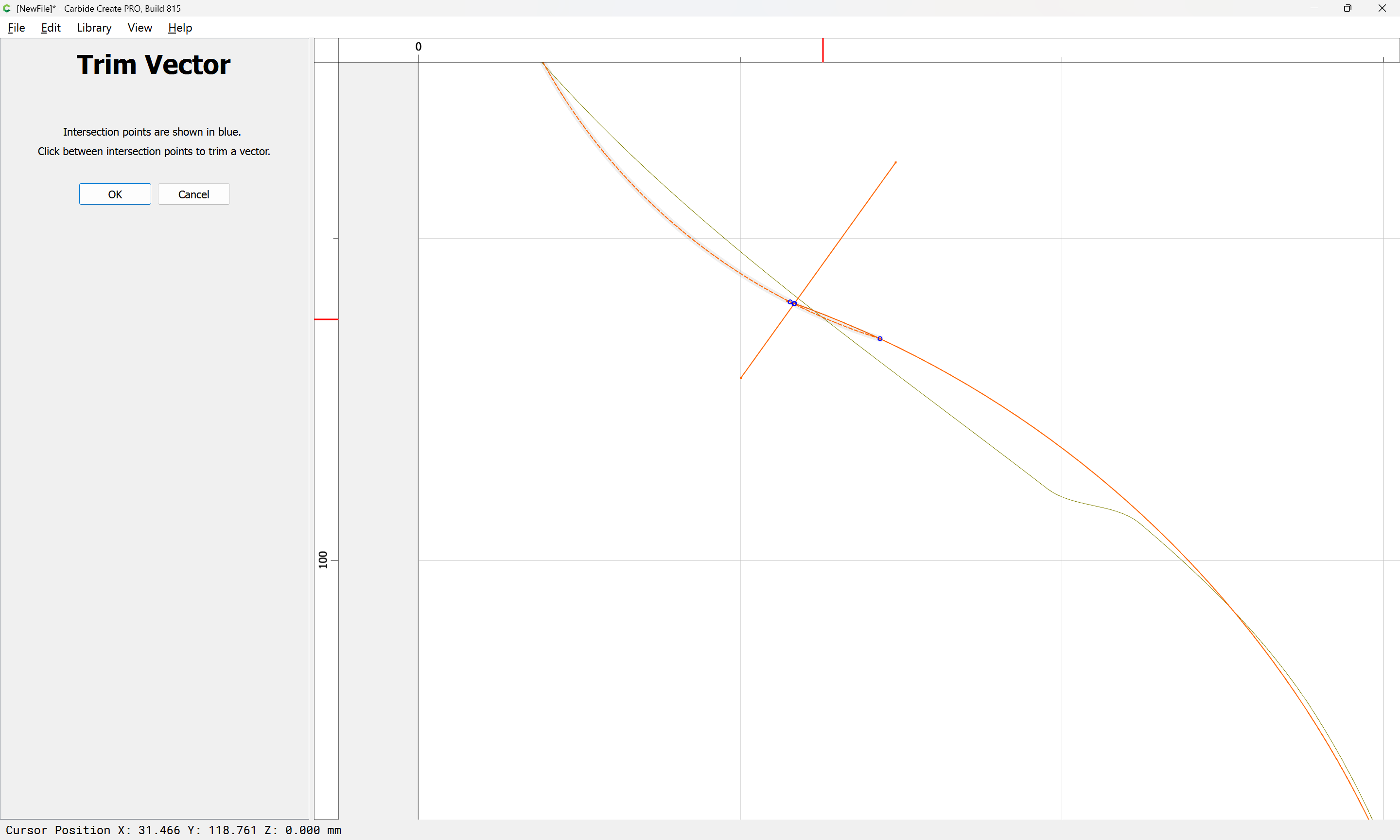

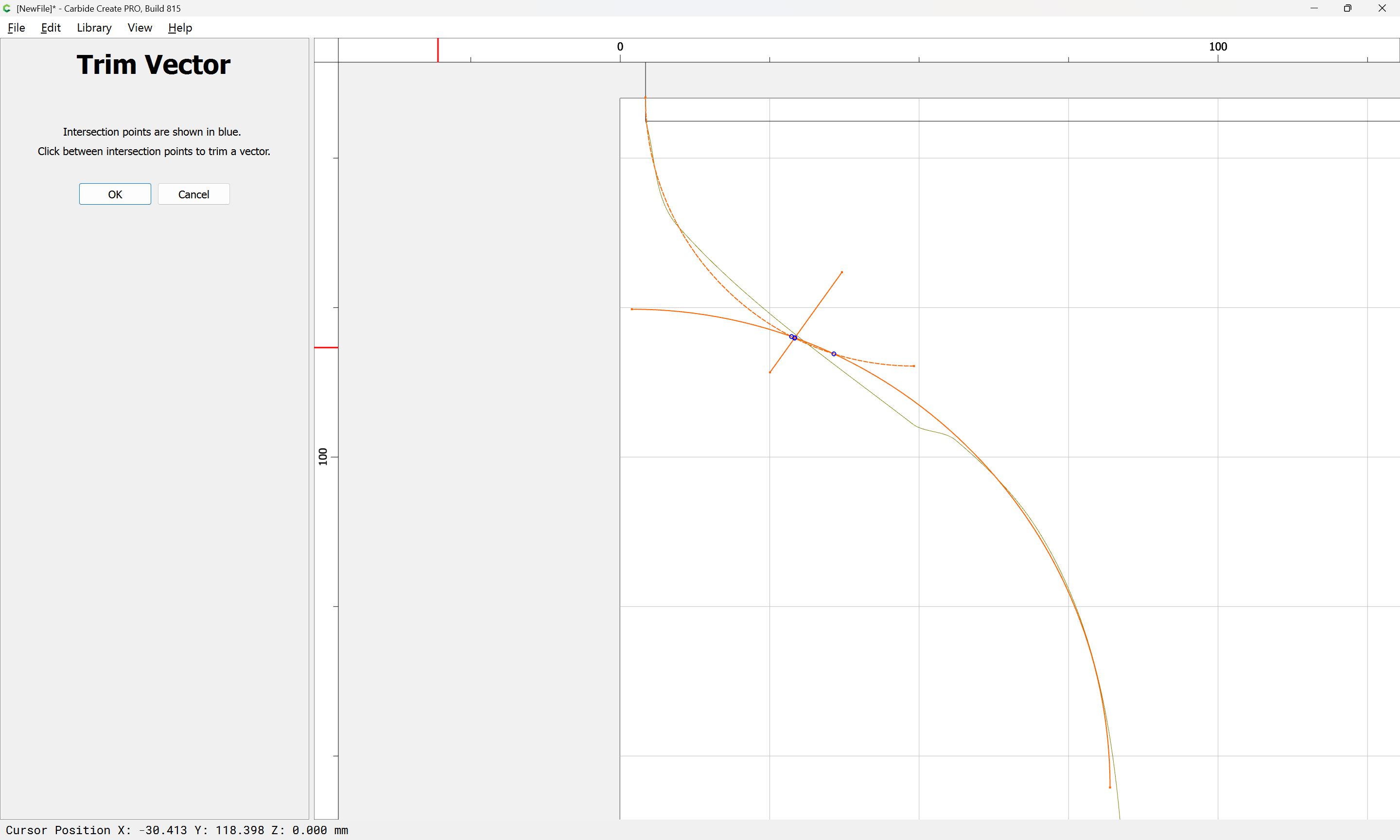

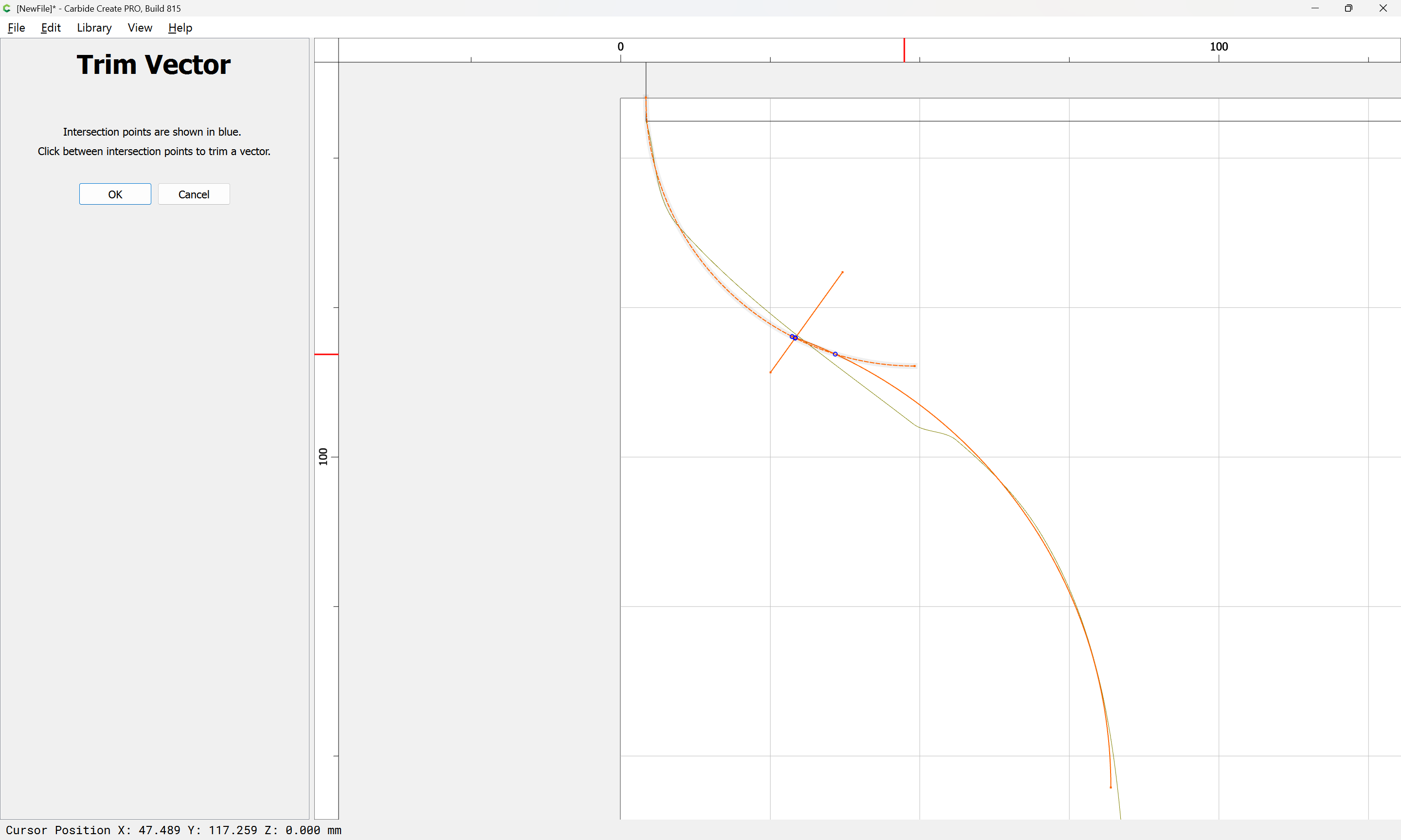

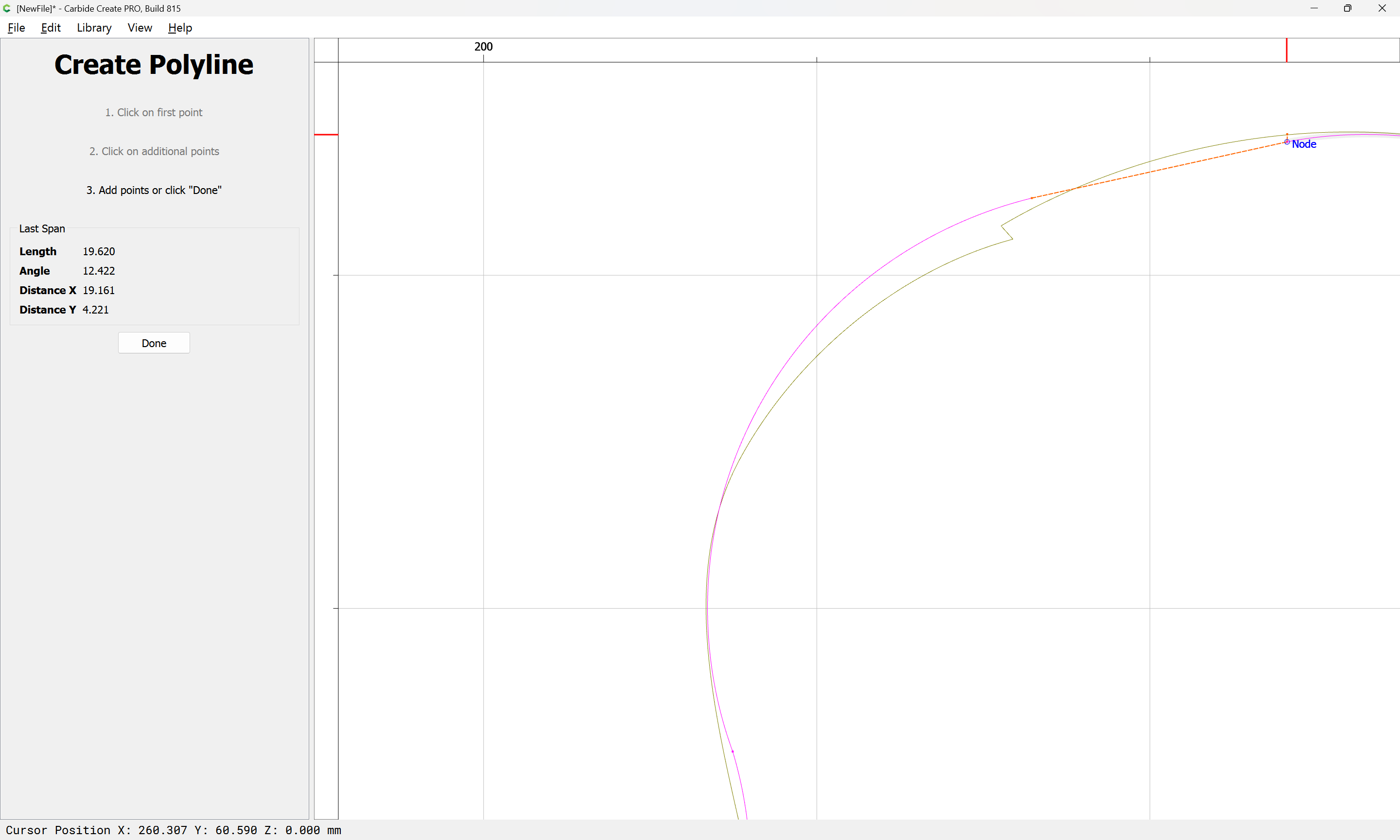

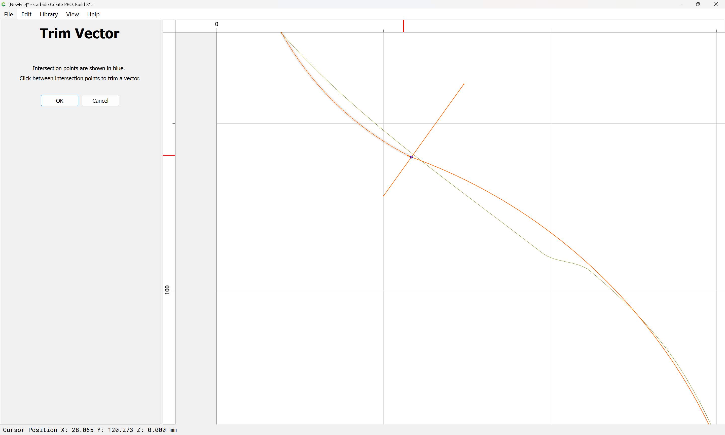

Note that at some places:

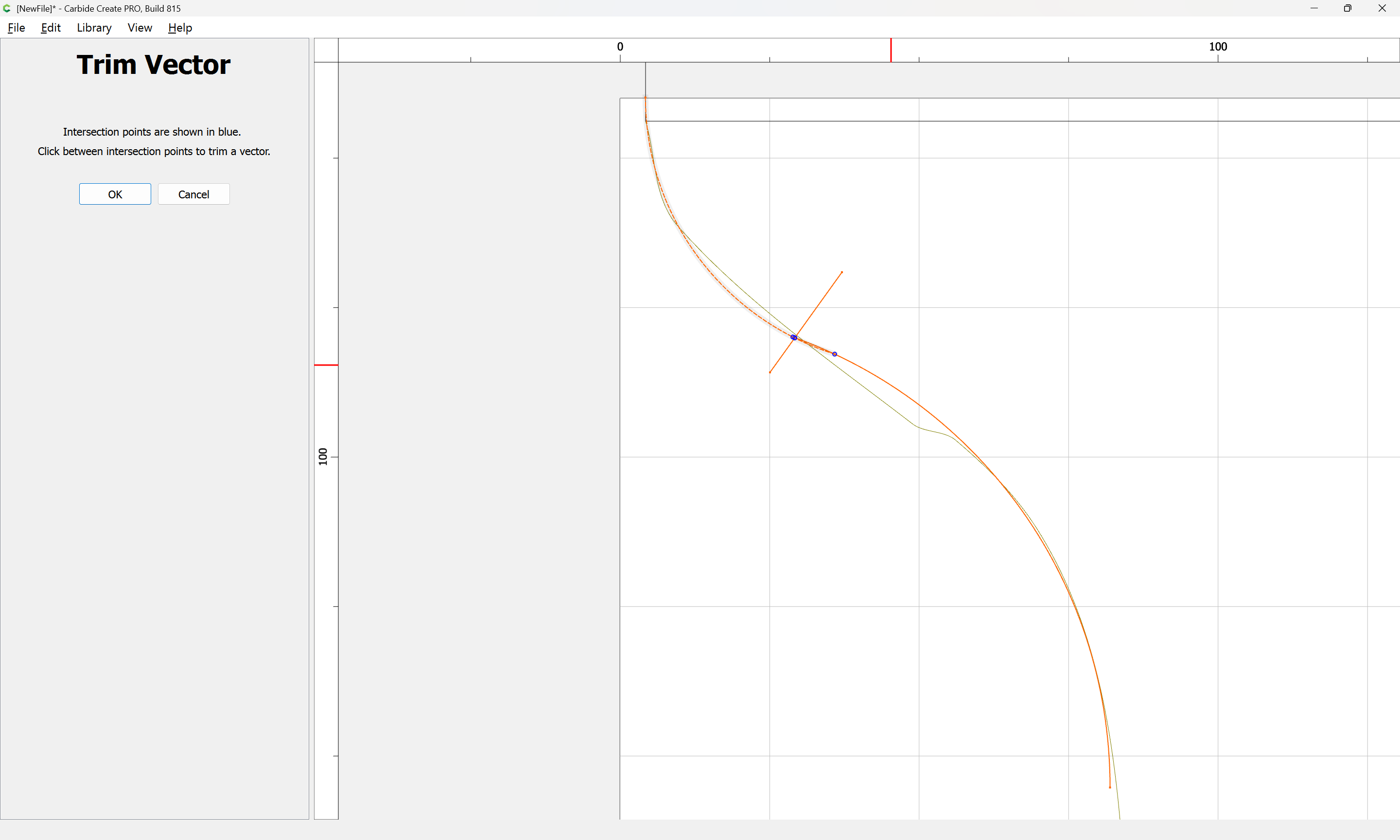

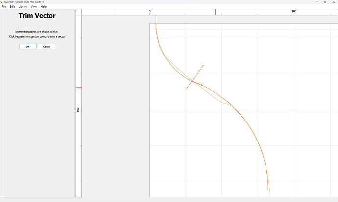

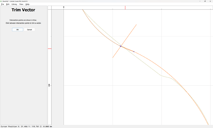

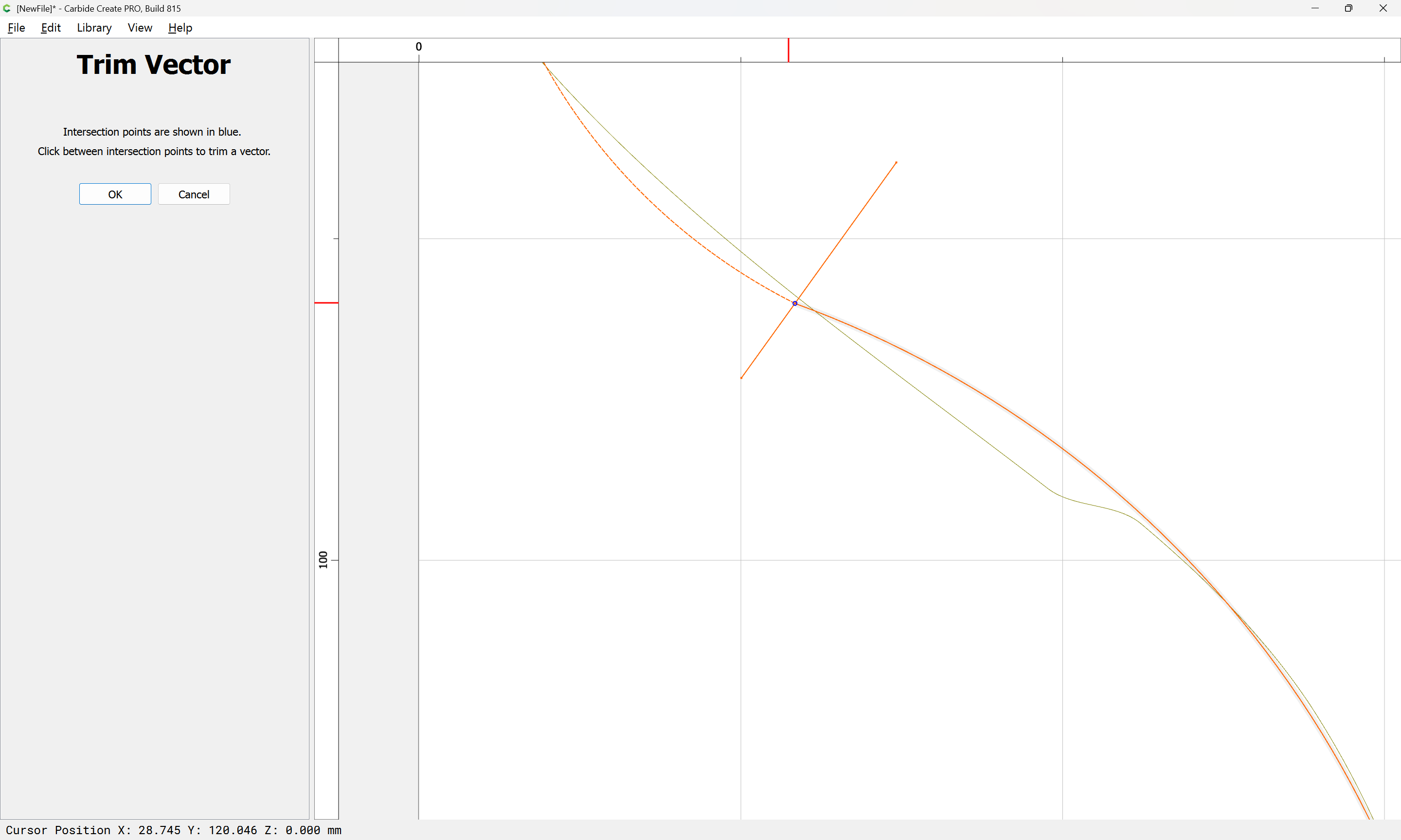

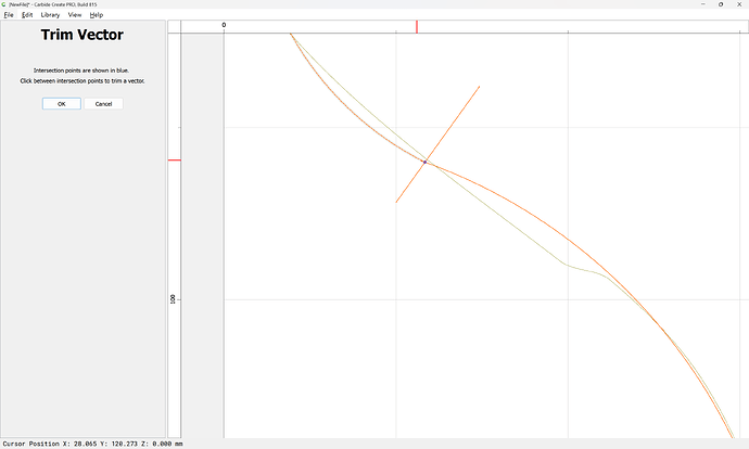

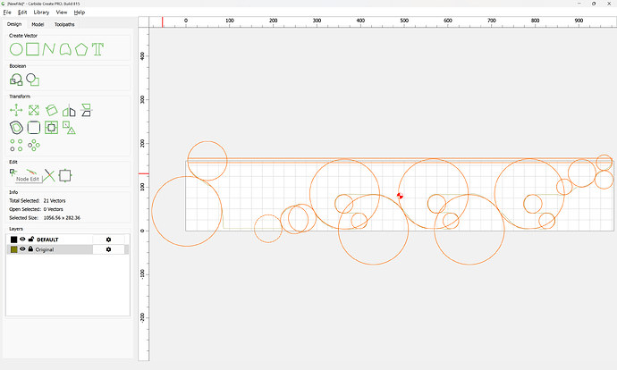

it may be expedient to draw in geometry for a Trim Vectors operation:
Where necessary, draw in lines:

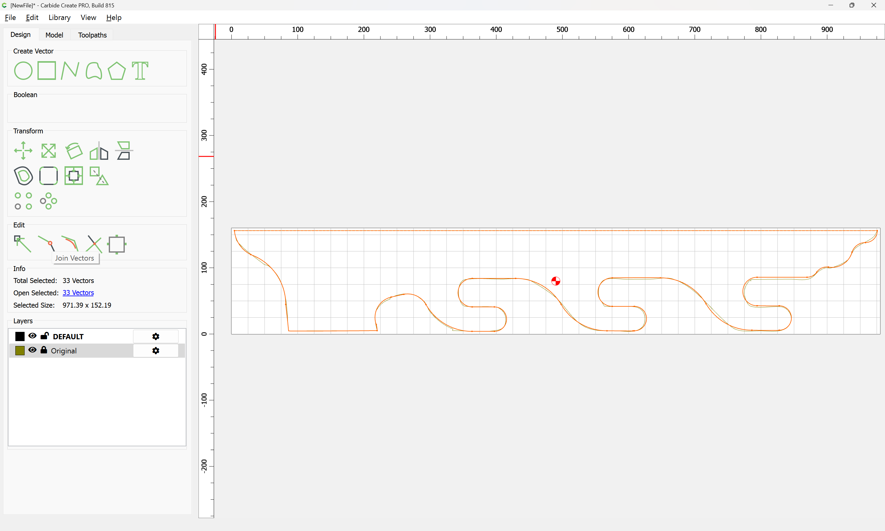

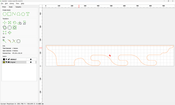

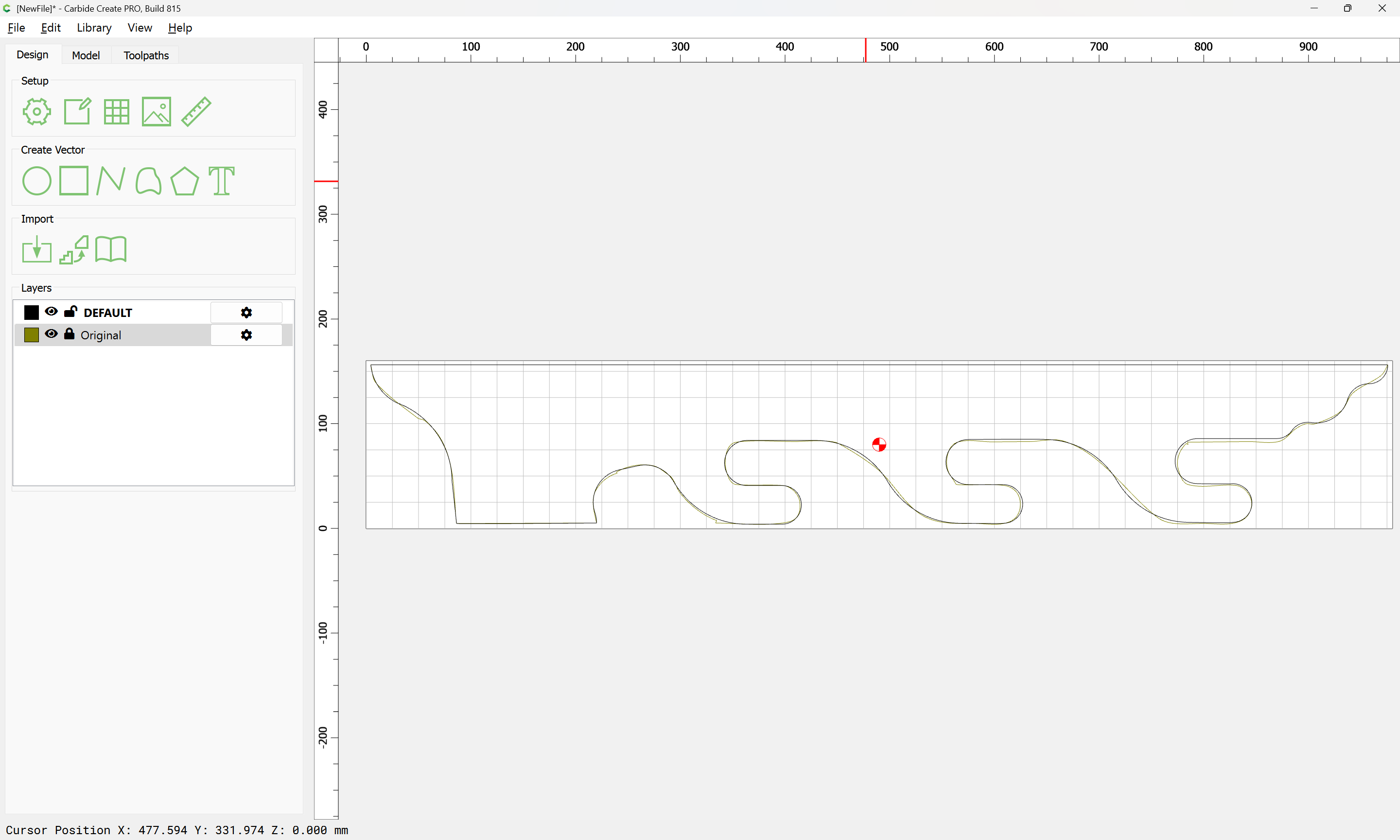

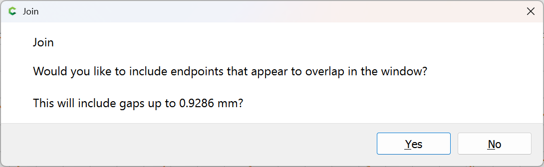

repeat until one arrives at:

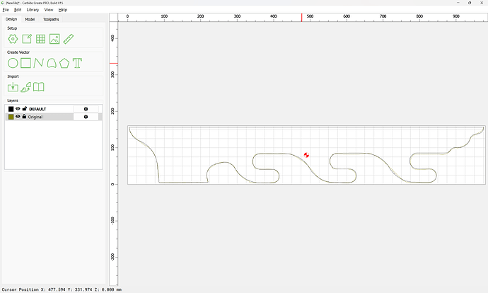

Adjusting a bit one arrives at:
Yes
Adjust as necessary. Attached as a v8 file:
drawn_profile_v8.c2d (48 KB)

I would suggest adding felt to the rung of where the guns will sit in. This will help protect the metal and the stock from getting any unwanted scratches or just any markings on the gun from the hardwood. Just a suggestion.

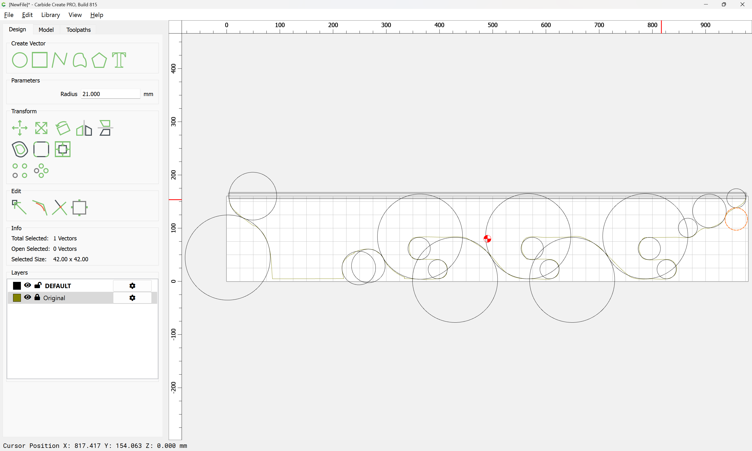

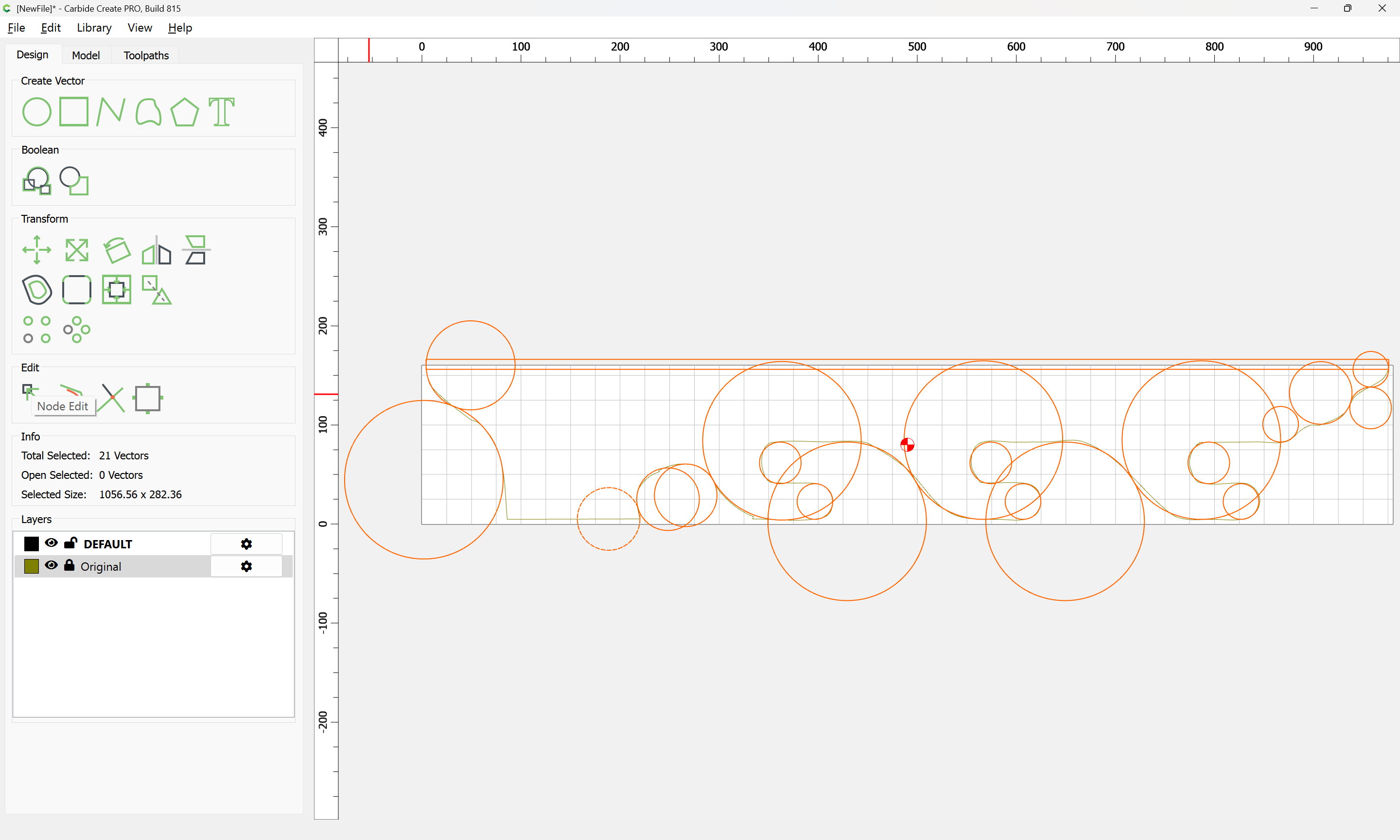

For any complex task, break it down:
- draw circles to define curves
- break down the circles either using Node Editing or by drawing additional geometry to use with Trim Vectors to define what you wish to keep/remove
- draw in lines to connect the arc segments
If you get stuck, upload the file and we can walk through this with you.
Alternately, it can just be done directly using Node Editing, but w/o modifiers for constraint, that’s a bit fiddly (the work-around is to use a fine grid).
