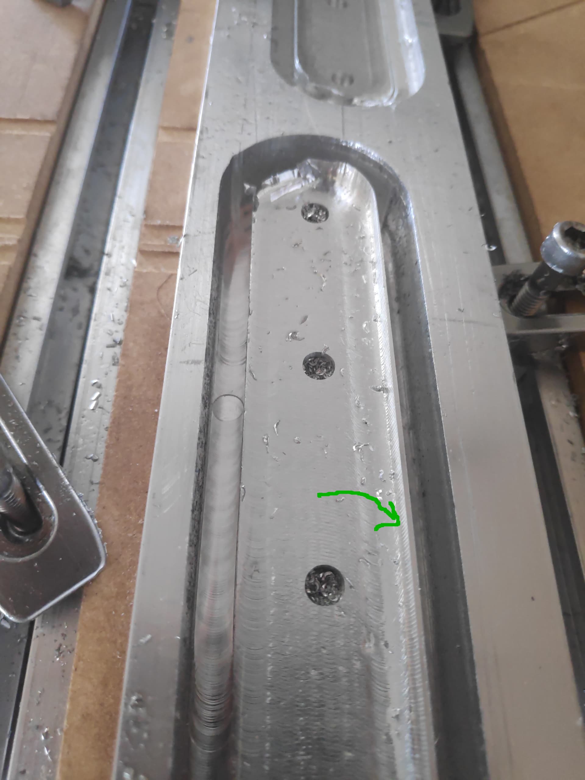

I’m on Shapeoko pro XL, using #278Z .25" Single Flute ZrN and feeds and speeds recomendations from Aluminum Feeds and Speeds for the Shapeoko - #MaterialMonday - YouTube that are for #201Z .25"
18k RPM, 48inch/1220 mm per sec, 0.015’'/0.381 DOC
My machine hates doing the final contouring operation. It can sound very unhappy, has these unclean cut issues and can block entirely

Ok writing this now makes my error obvious, I’m using single flute cutter with 3 flute feeds and speeds, I see other video Machining Aluminum with the 278-Z on the Shapeoko - #MaterialMonday - YouTube recommends 25% slower feed rate. I guess this is my mistake?

The grade of aluminum can make quite a difference. For 6061-T6 with a 1/4 single O-flute ZrN coated, I use about 9000 RPM & ~15 IPM. I can usually sneak the feedrate up a bit unless it’s burying the cutter more than the WOC.
I think your 18000 RPM may be generating too much heat. Are you using coolant/lube?
You can calculate angle from hole dia., tool dia., and pitch. Pitch should be the same as your depth of cut.

Consider pre-drilling the holes with an 1/8" stub drill first then bore to final dimension. On the contour I would use a roughing pass so the end mill has extra room to clear chips and is only cutting one side on the finishing pass.

This is super helpful and I think it will solve most of my deep alu contouring issues, I didn’t notice this contouring roughing passes option.

Also an update after today, this contouring roughing op helped resolve my most serious issues and videos made me more brave to experiment.

I (accidentally) pulled off 20mm :sweat_smile: To my surprise chips were nice and machine sounded good. I started with very low loads (0.2mm for 1/4th’ endmill and 600mm/sec) and haven’t tweaked further since high DOC is so fast anyway. Don’t think I’ll be doing 20mm much more since it’s so extreme, but now I’m confident at like 5mm
Part just came off the machine, this is without any postprocessing
