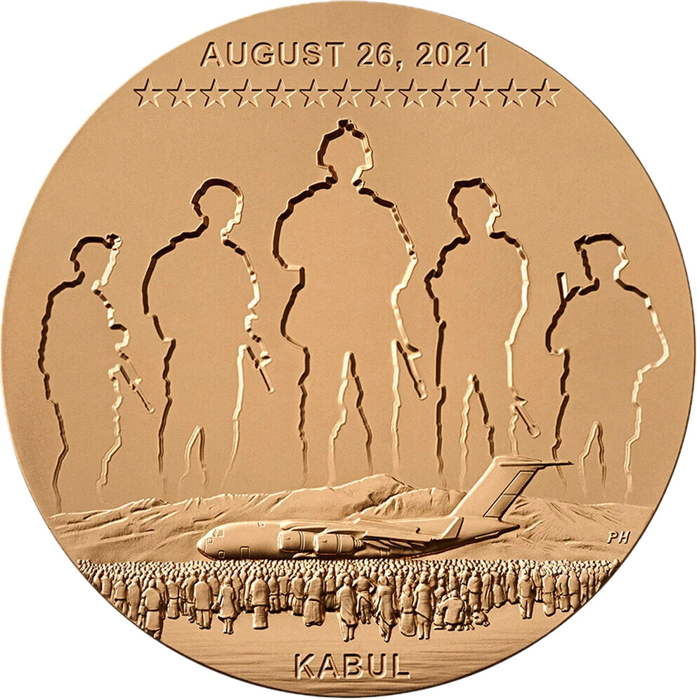

Help guys doing this big coin
I am trying to make this on my nomad3 no idea how to start do you guys have any advice I’ll be tremendously appreciated coin is about 110 x 110 mm

You will certainly need access to the file, otherwise you’re in for quite a long and tedious process to recreate it…and that’s assuming you already know how to do much of it.
If you have access to the file, I’m assuming it’s a digitally sculpted stl? It looks sculpted anyway, given all of the gentle curves and folds everywhere. In that case you can probably use carbide create pro (Will is the wizard, I won’t attempt an explanation)
The most difficult part will be smooth detail work, I’d guess a good bit of hand finishing and polishing will be required. I’d probably try a very small tapered ball nose as a rough pass, then use a v-bit of some kind to finish it.
If you have fusion 360, I’d do a pencil tool path on the deepest parts to really try and define them.
At 110mm I think it’s all achievable, maybe practice with machinable wax to ensure your strategies work as expected without blowing up a bunch of expensive metal blanks while you figure things out.
All that said, this thing screams to be done on a fiber laser. A laser will leave little topographic lines but they can be buffed out pretty quickly in most metals leaving a beautiful surface that’s very satisfying to the touch. I have a fiber laser and can tell you from posts in that community, there seem to plenty of folks in Texas who do commission work…folks love marking up their firearms for some reason :man_shrugging:

The best option would probably be to purchase such a coin and then scan it. EDIT: assuming of course that there isn’t a legal obstacle as noted by @CrookedWoodTex

Maybe 15 years ago (sadly, it might have been more), I was doing a project for a company in the coin/medal space. I was told they usually machined them on a rotary with a spiral toolpath, going outside in, so they never had an axis reversal where backlash could cause an artifact. I suspect that doesn’t matter as much now that higher-end motion components are commonly available, but that one always stuck with me.
