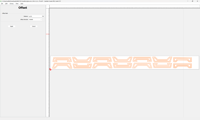

i think this is a file that you can see the issue
BAD FILE handle styles ect x3 44 x 5.2 x .79.c2d (196 KB)
sorry first time posting a file
You are cutting a slot to a depth greater than the length of the cutting flutes:
Offset to the outside by endmill diameter plus 10%:
and cut as a pocket down to tab height or the penultimate pass:
and modify the contour toolpath to start at the bottom:
Note that you need to ensure that workholding will hold the parts in place as they are cut out — if it won’t, add tabs.

I don’t think the machine reversed the cuts. I think what happened is the machine got bound up on the first cut on the right, lost steps, then finished that shape in the wrong position. Then it tried to cut the shape 2 to the left of that shape, and was off by the same amount.

Less aggressive cuts, and use Will’s solution to cut the outside profiles as a pocket rather than a slot.
