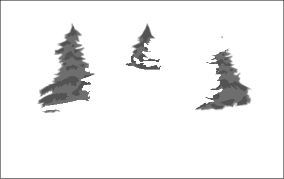

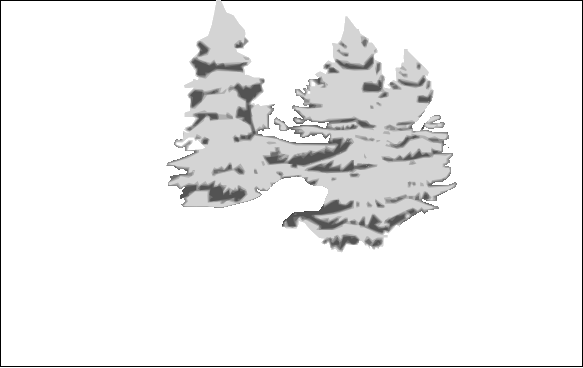

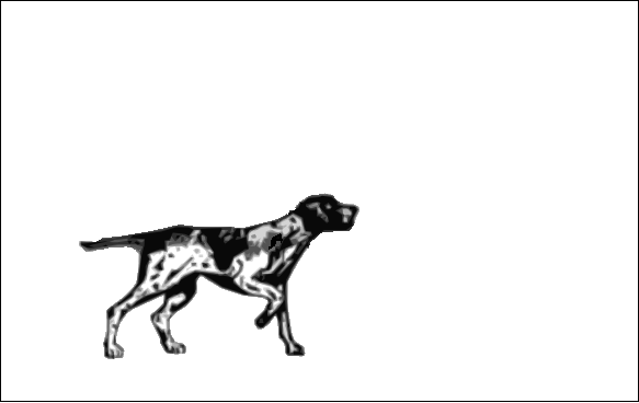

Here’s my attempt.
Separate PNG files per subject.
Each image has a Black rectangle at the extents, so when you import to CC it will align correctly.
I suggest a CC layer for each image.
I found that Paint.net does not export PNG or TIFF with the multiple layers. Dang !
BnewFrontTree
BnewBackTree

BnewDog
Here is the composite image. No border
BnewFix
